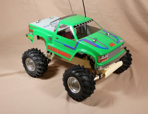

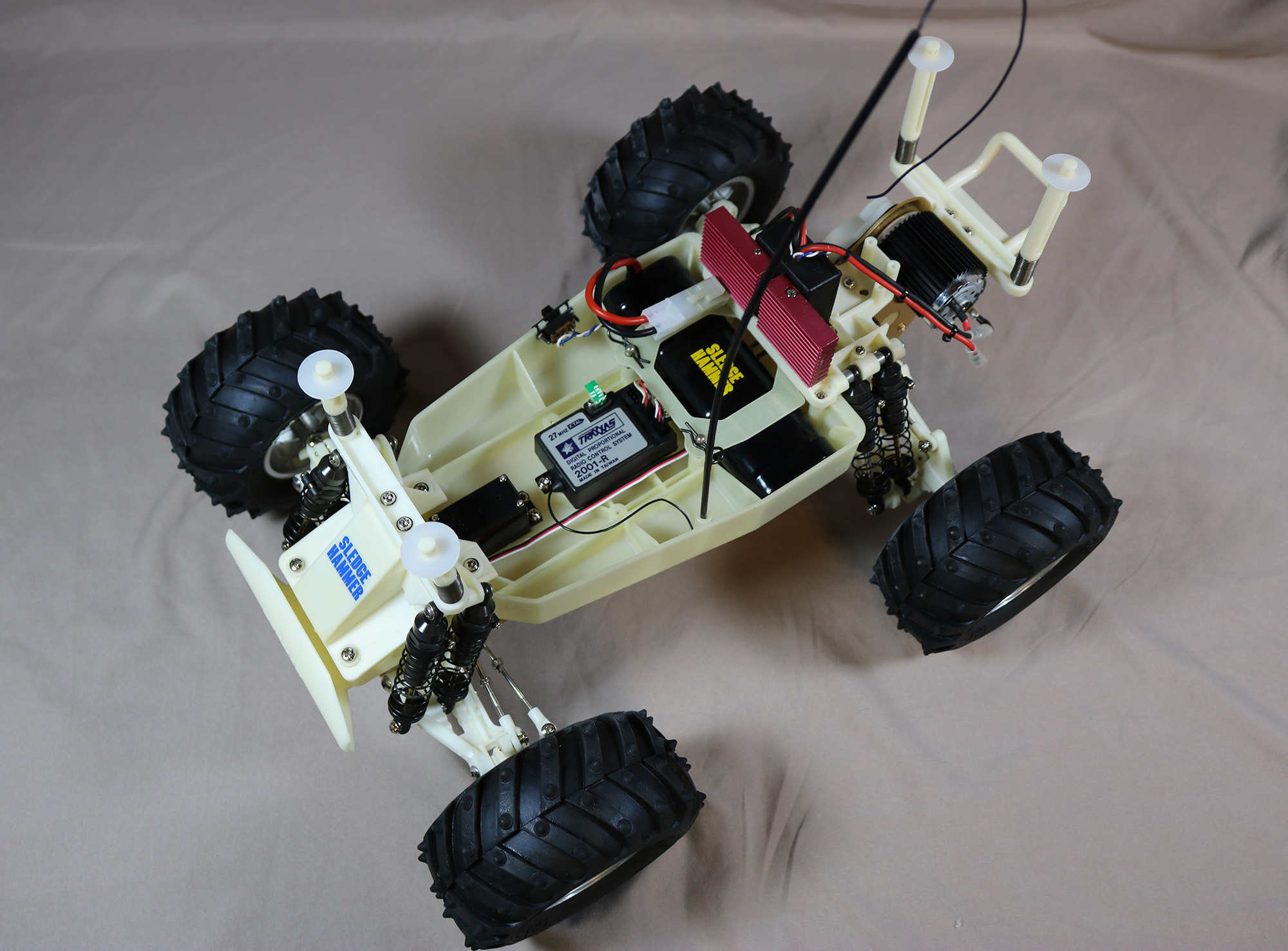

Traxxas Sledgehammer V1 (V2 shocks)
Stock original type motor with original type heatsink. New XL-1 ESC with Sledgehammer / Boat heatsink. Rx case is original to truck with more modern guts inside. Servo is a more modern Traxxas unit made to look like original. Tub, bottom braces, front chassis bumper, tires, and shocks are new. All other nylon restored. TBG / MCI body and graphics.
Build Thread: https://www.rc10talk.com/viewtopic.php?p=537757#p537757
Click for larger pics.

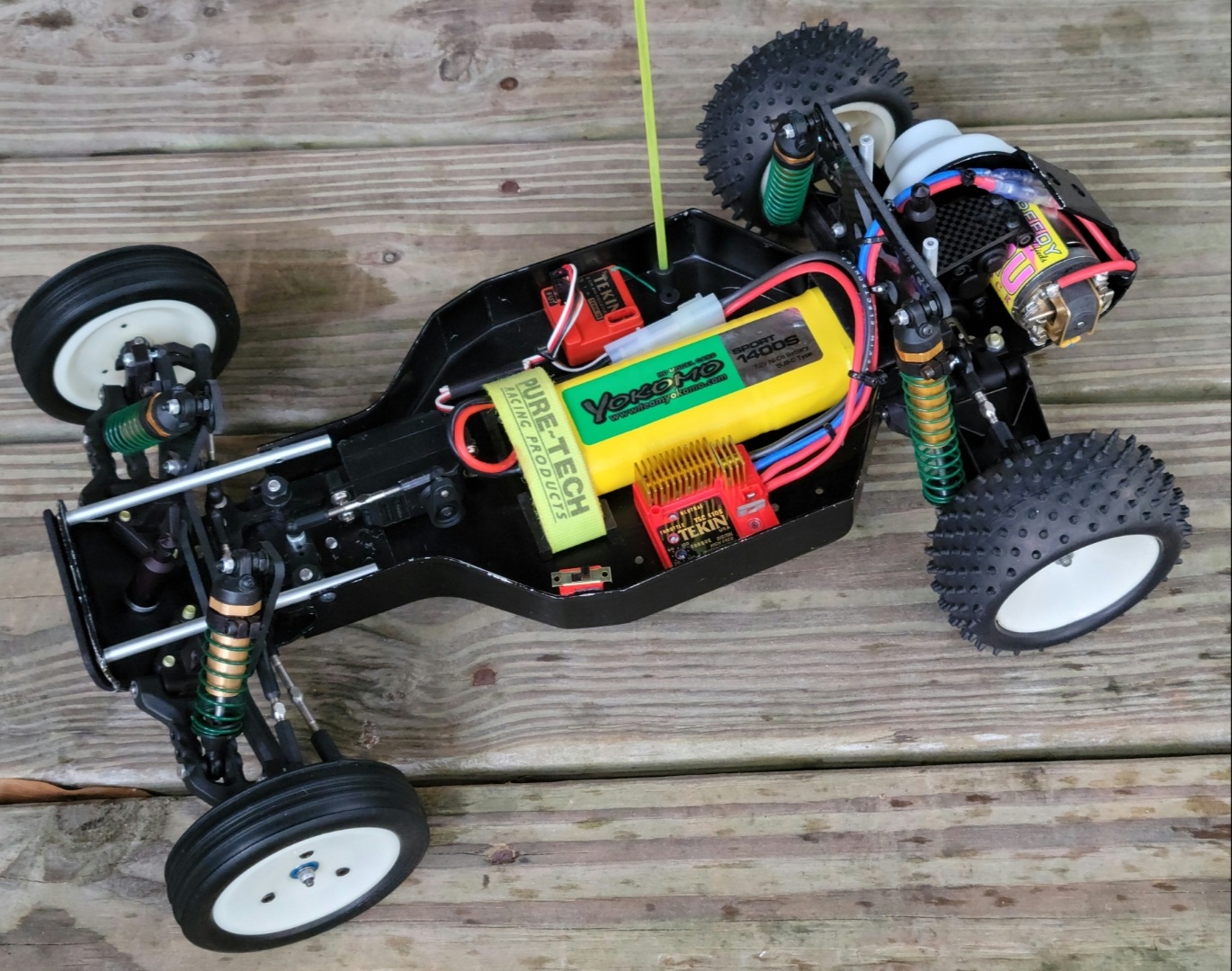

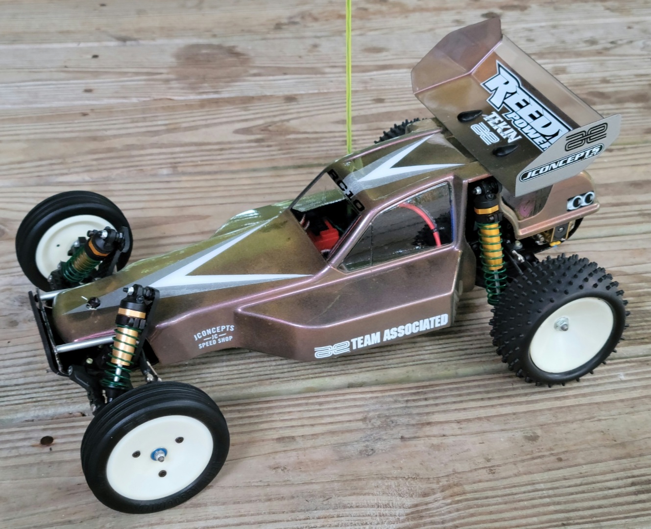

This is my parts lot Team Car.
https://www.rc10talk.com/viewtopic.php?f=35&t=46399
Mods are limited to RPM front arms, GT rear carriers, T3 slipper, and Vintage RC towers.
Electronic consists of Tekin esc and receiver, Futaba S132 servo, and a Reedy Tru Stock motor.
The body is a JConcepts Protector and reproduction AE wing. A single picture doesn't do the metallic color change paint justice, but here it is:
Click on pics for better resolution.

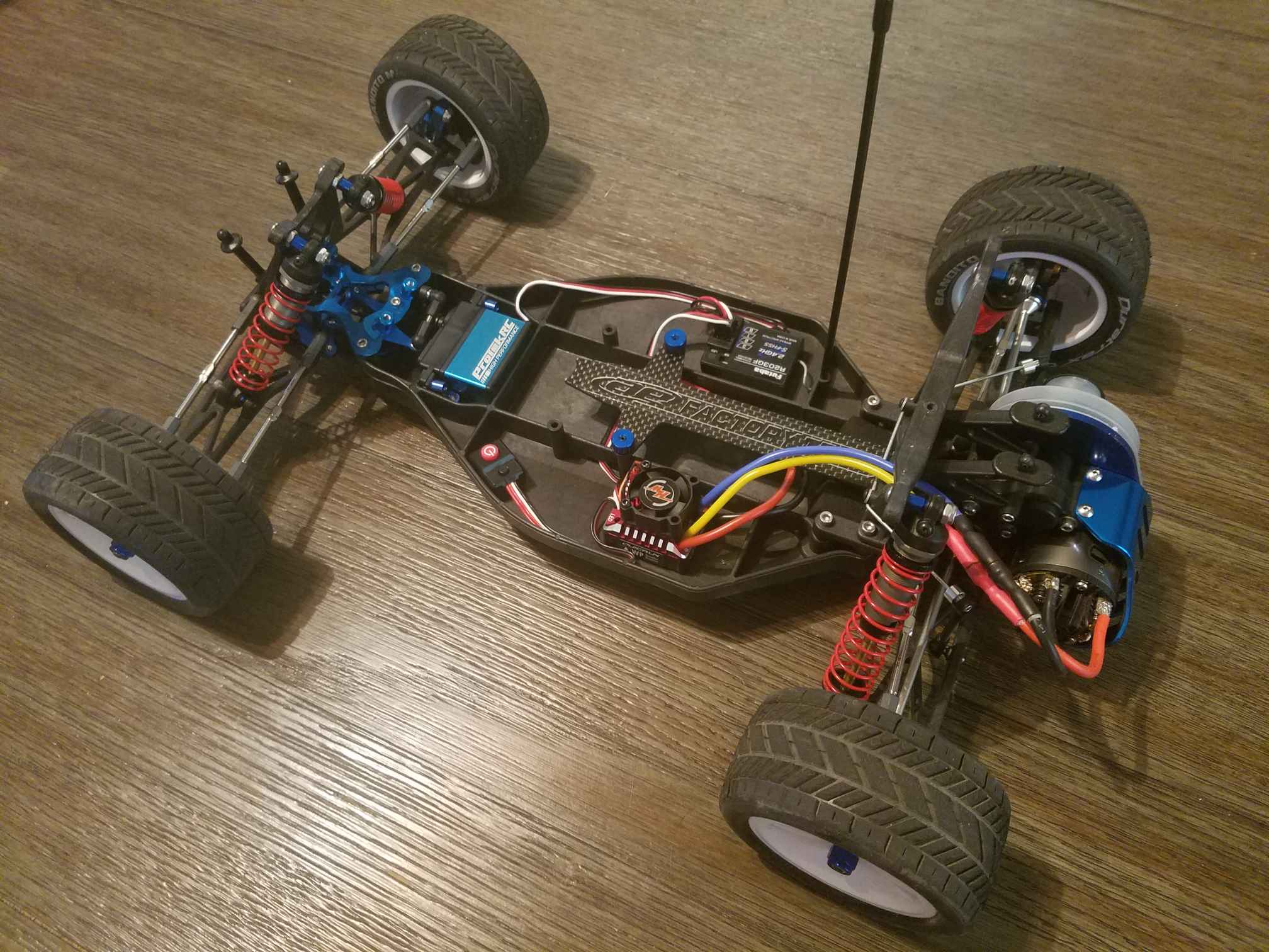

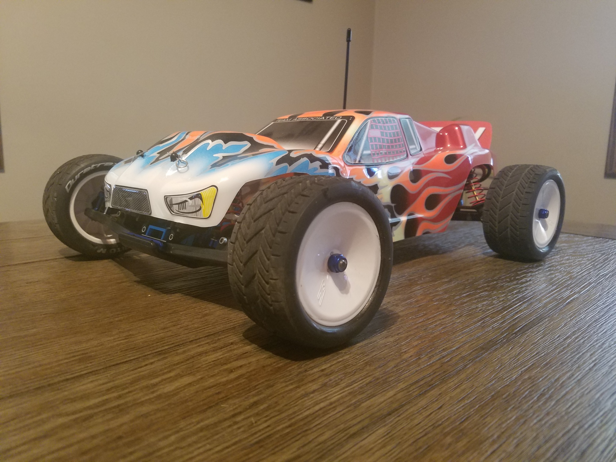

This is my RC10 FT on-road T4.
It started off as an original first version T4 RTR roller with carbon chassis, A-arms & shock towers and no body. I then added AE factory team blue aluminum rear 0* hubs, motor plate, shock bushings & front hinge pin brace. Along with threaded AE FT buggy shocks (front & rear) w/ red springs, titanium turnbuckles, rear sway bar and carbon fiber battery strap. Body is a pre-painted RC10T4 RS body.
Aftermarket mods consist of polished MIP CVD's; DE Racing front chassis brace; GPM blue aluminum front hubs, bulkhead, steering rack, bellcrank, servo mounts & rear A-arm mount; Integy blue aluminum rear chassis plate, motor guard & top chassis plate.
Currently has Jconcepts 2.2" buggy wheels (front & rear) and Duratrax Bandito tires.
Electronics are; ProTek 100SS servo, Futaba R203GF receiver, Hobbywing 1080 brushed ESC, and Reedy KR Krypton 10T double brushed motor (tested at 46,100 rpm at 7.2V with 12* timing).
In it's current configuration with a 26T pinion, 78T spur and 3.4" dia. tire, it's done 45mph with a 3300mah 2S lipo and is a handful to keep straight under throttle. It's a ton of fun in a large parking lot.

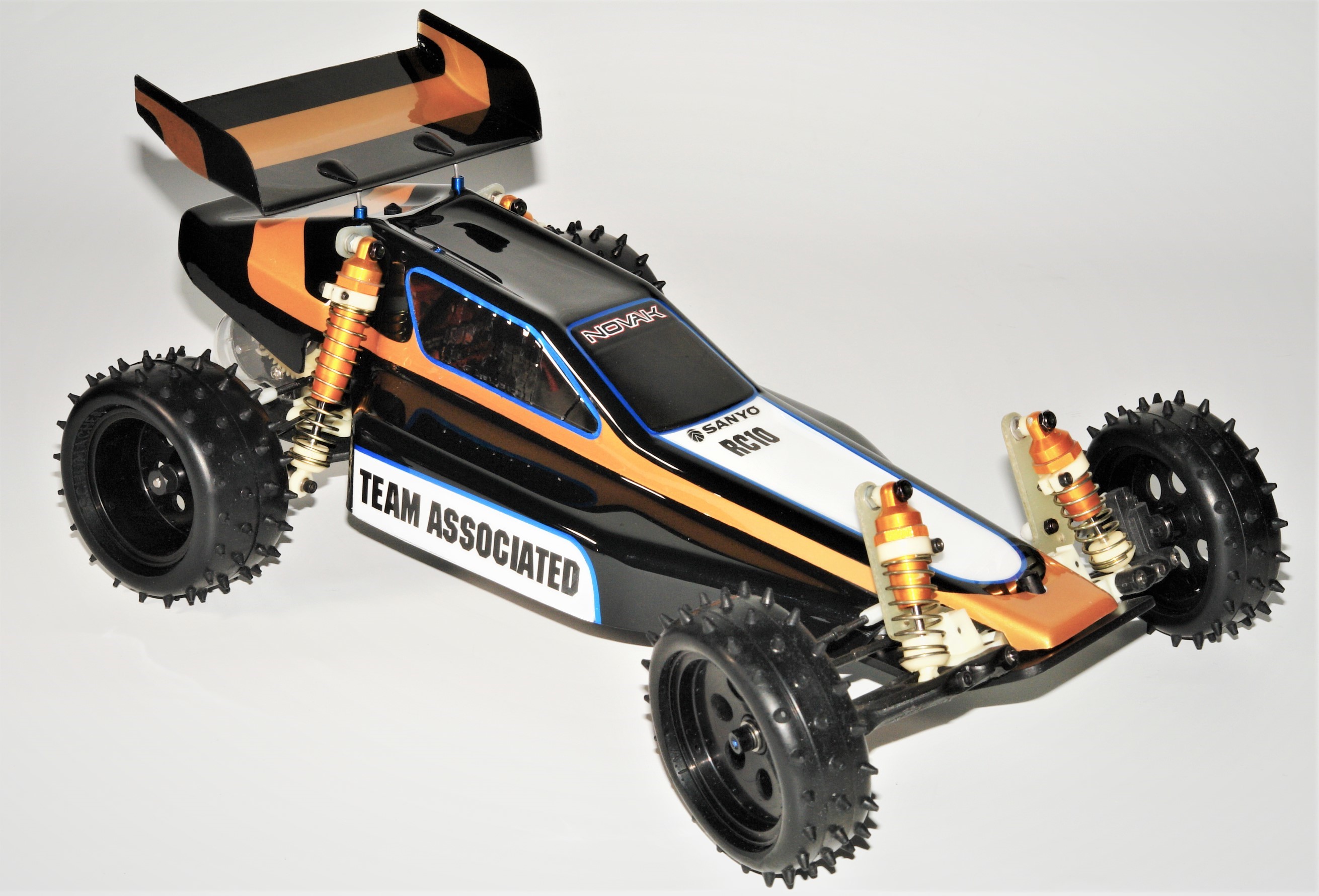

I had this car for quite a while. Last year I stripped it down to the chassis and completely rebuilt from there.
Build thread https://www.rc10talk.com/viewtopic.php?f=35&t=46632
Chuck
Chuck
