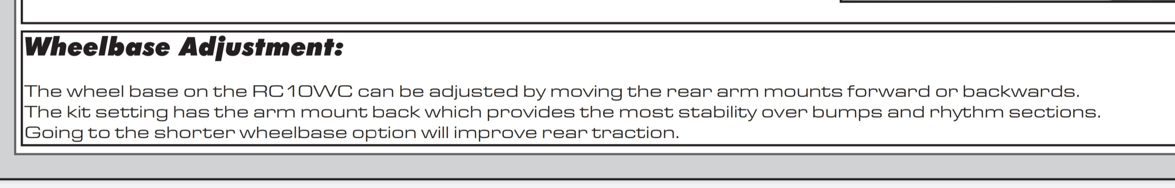

I put in some significant time today prepping one of the RC10 models I plan to take to VONats this year.
The particular model I am working on, I bought as used/good condition - while taking it apart I notice the previous owner had it in the long wheelbase configuration.
- My instinct was to rebuild as short wheelbase (i.e. the rearward holes on rear arm mounts)
- Then I thought, is there any tuning science that would support using one wheelbase option over the other?
Well, it looks like the original RC10 Worlds manual recommended the short wheelbase configuration.
BUT, the Worlds ReRe manual recommends the long wheelbase...
Above thread seems like there are opinions to support both options?
- Certainly the funky shock/dog-bone angles are one reason to go short.
Any new or different thoughts on this wheelbase question??

If you look in the setup pages on AE's site, you will see that BK still used the short wheelbase at that time.
