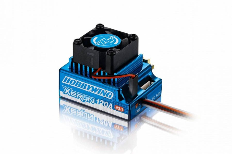

For the ESC I have both the quickrun and the justock esc's. I can recommend both but for the motors you are running the justock has reverse polarity protection. If you aren't going to be running lower than 13 turn brush-less you won't see much performance difference between them.roor wrote: ↑Tue Sep 20, 2022 7:15 pm I just got a rc10b4 centro roller and need some electronic recommendations. Something about older buggies, or the cheaper ebay price draws me in. The b3 running a sensorless reedy 3300kv motor makes me happy with its speed on the the tracks but not the motor pauses after rough jumps. I’m pretty sure that’s cuz it’s sensorless and a sensor motor would be a lot smoother on the carpet.

I run hobbywing justock and 17.5 reedy S+ motor in my b6.3d and hobbywing justock and 13.5 reedy S+ in my b74.1d and they work great.

If you are running in specific classes, they will dictate what kind of motor you will run. And yes, 1/10 scale 2s is plenty.
I'll say for 17.5 blinky class, I'm loving the reedy s+ motor. It's gots tons of power, plenty to allow you to create some decent damage if you crash.
As for esc, I have a couple of turnigy trackstar ones that work great, and I've scored a few used tekin rs controllers that work great.
I hear nothing but good things about the hobbywing escs also.

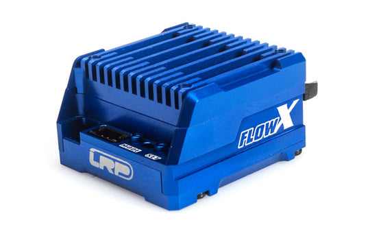

Blue would look good in that buggy.

Thanks for all these tips! time to get a ruler and paper to mock up space requirements. I am a bit hesitant at least with cheaper hobbywing esc. I have heard reviews of them being good enough for 90% of people, to other reviews saying cheap and upgrade to something better. I'd rather buy once cry once, but damn for a "simple" blinky roar approved esc is kind of a lot. I can definitely look at used eBay. The justock combo is tempting! If anything maybe paired the ESC with the reedy sonic 17.5. I then looked up the roar list and made my way to this guy https://r1wurks.com/products/r1-super-stock-digital-3-esc-040013-pre-order-now?variant=29212930343006 and this https://www.amainhobbies.com/tekin-rs-gen3-spec-sensored-brushless-esc-tektt1157/p972038
seems to fit my list of stuff with good features and just at the end of my budget but again ebay has been my friend to try and keep cost down on the ESC. The motor I want new. It shall only know my recklessness
