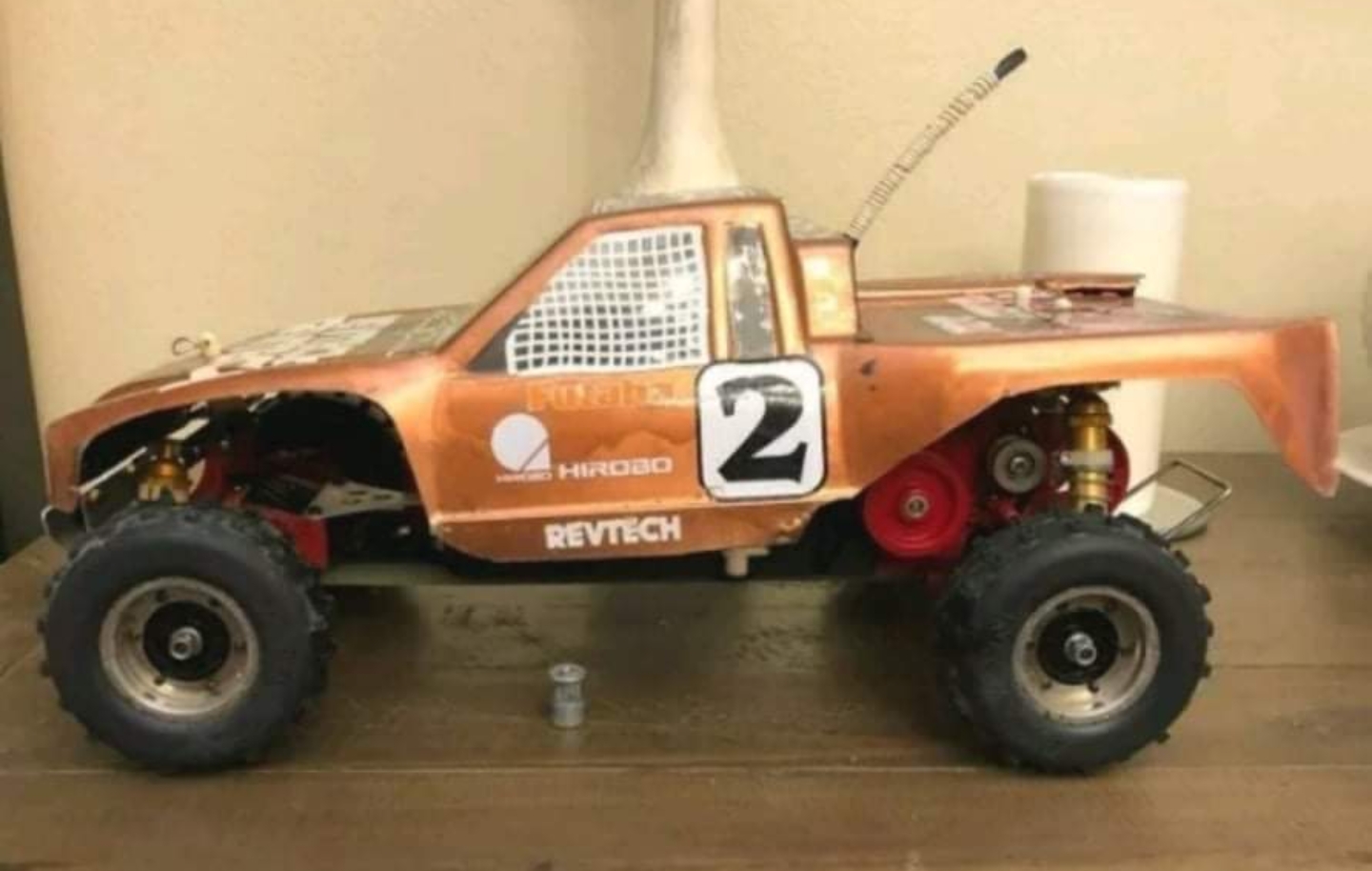

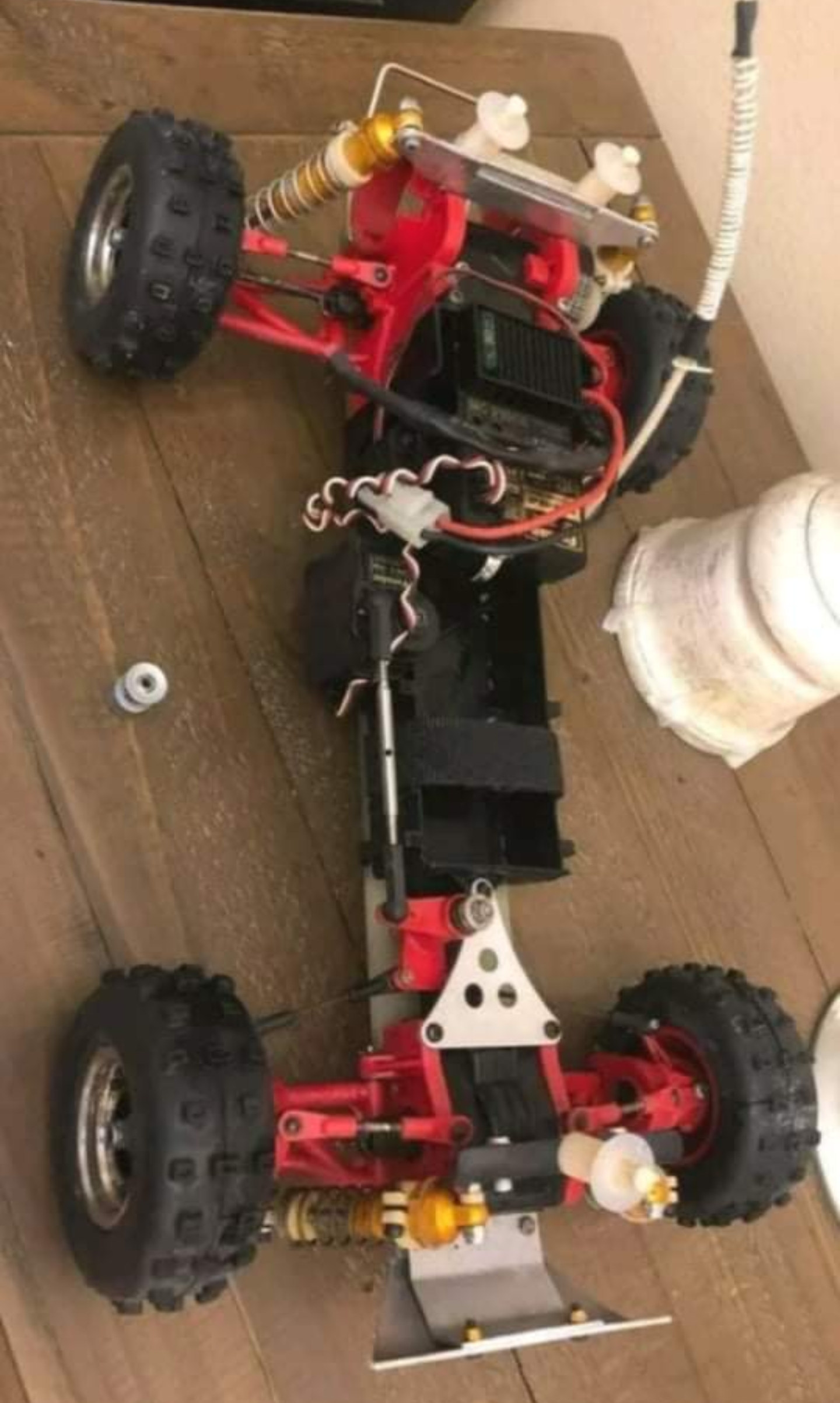

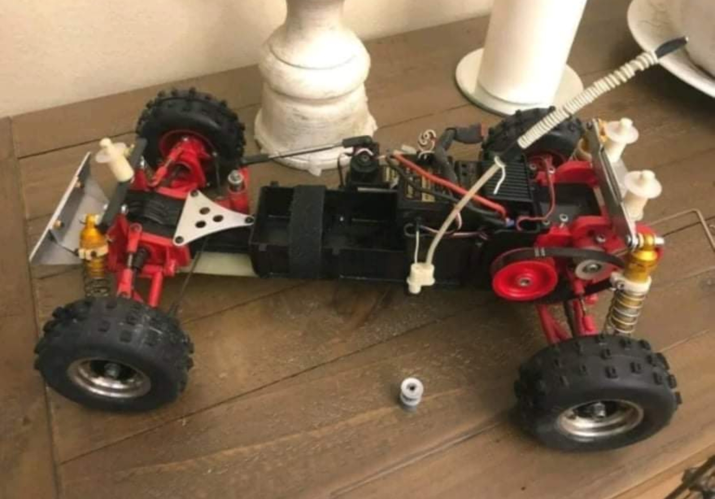

I picked up one of these last year, but haven't done anything with it. It was too cool to pass up, especially with the Associated shocks, CRP chassis plate and stadium truck bodyshell. Wheels and tyres look good too, plus it also has a new pair of rims and some new in packet red ball joints as well. I can't see me doing much with it though if i'm honest.

Well if it's on the market I'm sure there'll be takers. I might be tempted and silvertriple too? I can think of other competition.
Good tyres etc but obviously a few bodges to get a shell on it etc. You may have seen my 44b which I've had to put a "wrong" shell on. Rockn' city rhyming slang....
I got a grp chassis plate which I intend to fit sometime.
I got new tyres from Australia a while ago. And a few spares in an eBay lot
Truck body is interesting I've been wondering how one would look
Ta for pics
Ta for pics

Hi Martin,dinglem wrote: ↑Sat Oct 15, 2022 7:38 am I picked up one of these last year, but haven't done anything with it. It was too cool to pass up, especially with the Associated shocks, CRP chassis plate and stadium truck bodyshell. Wheels and tyres look good too, plus it also has a new pair of rims and some new in packet red ball joints as well. I can't see me doing much with it though if i'm honest.
I would be very interested as I intend to model the 44B chassis (and in their differnet variants)... But i'm short in cash right now due to some recent ventures (including one not even disclosed yet in Marui area as the cars are not yet there)...
Nice set you have here, in anycase...
