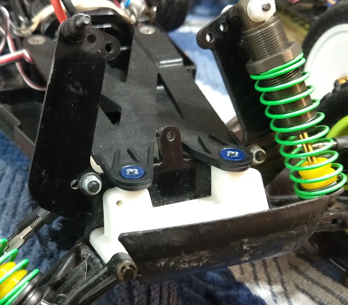

While I was taking it apart I noticed something odd. LXT apparently changed the front shock tower design for the camber links at some point during the LXT/GTX/NXT production run. Same part number but different holes.
Other observation about the LXT is both the donor LXTs I bought for different projects had similar issues with their build, the builders built the front body mounts incorrectly. I'm actually astonished these held together for any kinda driving being that he screws were attempting to thread into a part that was meant to be a through hole.
Lets fix that before I toss them in the spares bin

Nice restoration from a crusty truck! Interesting seeing the front shock tower variations.. I think that darker, blue tinted anodizing was late ProSE/LXT. I have some shock bodies with the same color too.
https://www.rc10talk.com/viewtopic.php?f=27&t=3171

BattleTrak wrote: Mon Nov 07, 2022 2:26 am Nice restoration from a crusty truck! Interesting seeing the front shock tower variations.. I think that darker, blue tinted anodizing was late ProSE/LXT. I have some shock bodies with the same color too.
I put a post up on that thread for these ones. I'll probably toss this later model tower on my LXT.

I was looking at the old Losi Tech Talks and saw this mention of the LXT shock tower change.

RogueIV wrote: Sun Nov 06, 2022 10:34 pm
I wonder if it corresponds to the release of the "Jammin' Jay Steering Enhancement Kit" for the Pro SE. I can't find my original shock tower at the moment to do a good side-by-side, but here is what the hole pattern on that looks like. The kit, if I recall, moved the camber link to the inner hole. The kit also came with LXT uprights which I've patterned my hex conversion uprights after. I was no good at chassis setup so I don't recall if it made much of a difference.
I think you're on the right track,It's probably in response to how tracks were evolving into better groomed and smoother at the time.
