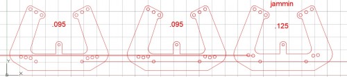

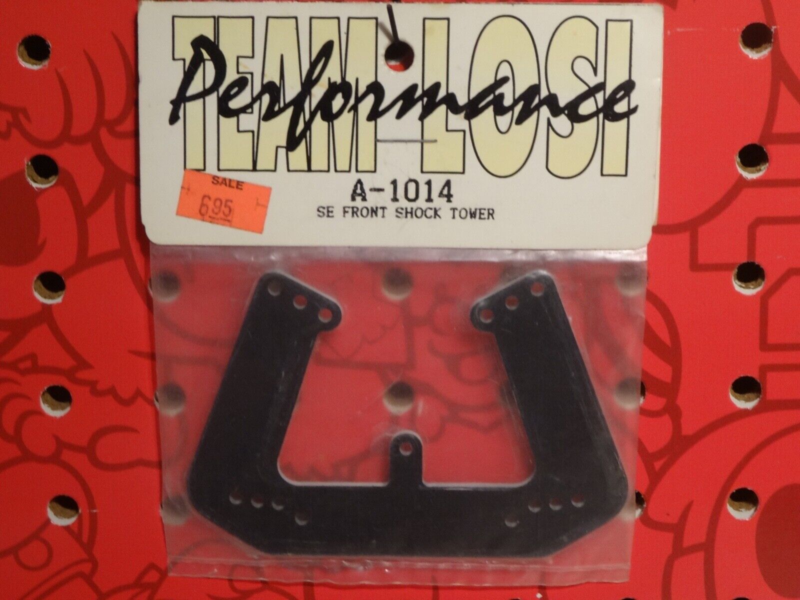

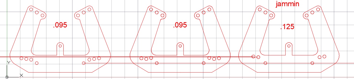

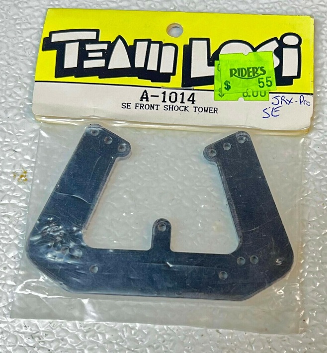

Posts: 12335
Been thanked: 3917 times
Re: LXT Front Shock Towers A-1015 variation
RogueIV wrote: Mon Nov 07, 2022 5:28 pm Found this out while tearing down a parts truck. It appears later on in the production cycle Losi modified the LXT camber link locations on the front shock tower.
A1014 for the Pro SE had running changes as well. Here are the three camber link versions that I know of. I have compared it to the Jammin steering enhancement tower and none have holes matching the Jammin

BattleTrak
Posts: 731
Location: Ill-Noise, USA
Has thanked: 1153 times
Been thanked: 624 times
Post by BattleTrak »
GoMachV wrote: Sat Nov 19, 2022 11:20 am
I never noticed that before! I went through my stash and have the bottom ones. That top one with the 2 holes looks a lot like both of my Jammin ones though. I wonder what the thickness is because my Jammin are 3mm vs 2.5mm of the Losi ones.
-Brad
RogueIV
Posts: 1163
Location: W. Mass
Has thanked: 2133 times
Been thanked: 1099 times
Post by RogueIV »
My guess is that the 2nd one is the closest to the Jammin' one as far as the inner position is concerned.
Posts: 12335
Re: Some losi parts variations
The Jammin I have on file has camber link holes higher than the highest one on the two of the three variations I have
