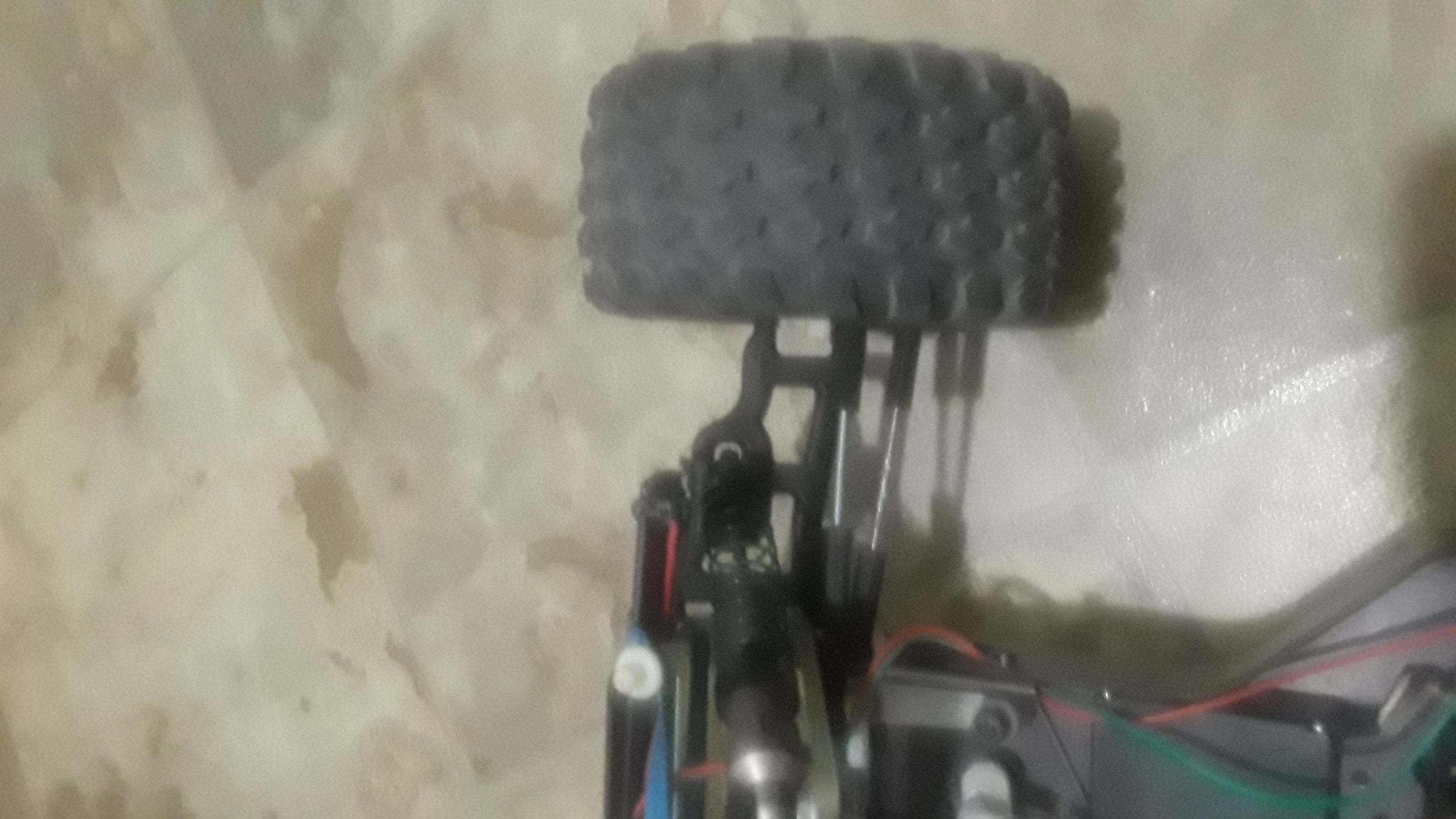

Re: RC10 buggy with long RPM arms
Currently been testing RPM Part 80242 (If you check the photos the wheelbase on this part is shorter than the original).
I may be mistaken but I believe Part 80242 (The one I'm testing now) is shorter than #80492 and I've mounted it and am in the process of trying to find shorter Camber links and shorter turnbuckles to keep the toe similar. I used a 4-40 no head screw and chopped it to size to get camber / castor / toe under control.
The arms on RC10GT are the same make as RC10T2 and same length as RC10T and the measure in at around 3.5 inches in length maybe a tad more.
I got Part 80242 to work but it is Not long enough to create the same wheel base as the original RC10GT arm.
I'll post a picture here using Part 80242. I'm kinda just working on finding a readily available arm that doesn't break easy and that I can replace at a reasonable price.
I have some 3d printed GT arms but the cost of 3d printing in Carbon/Nylon is just as much as buying an original set off ebay.
So my OEM aren't really something I wanna be bashing or practicing with.
Mind ya I'm technically a beginner who once raced a bit in the 90's and I love love my RC10T (So I'm finishing a restore and shelving it.)
The RC10GT basher project is a mid motor config that I'm putting a VTS slipper on and will hop up as needed.
It will end up on a track for a bit of fun later on.
Anyway, I know you know your stuff but here's where I'm at so far on my Front Bulkhead on My Franken 10T.
I'm working on the front arms problem while i wait for the rest of my GTE parts to come in the mail.
If there's one that's a bit wider than 80242 I'm open to mess a set up to get the build right.

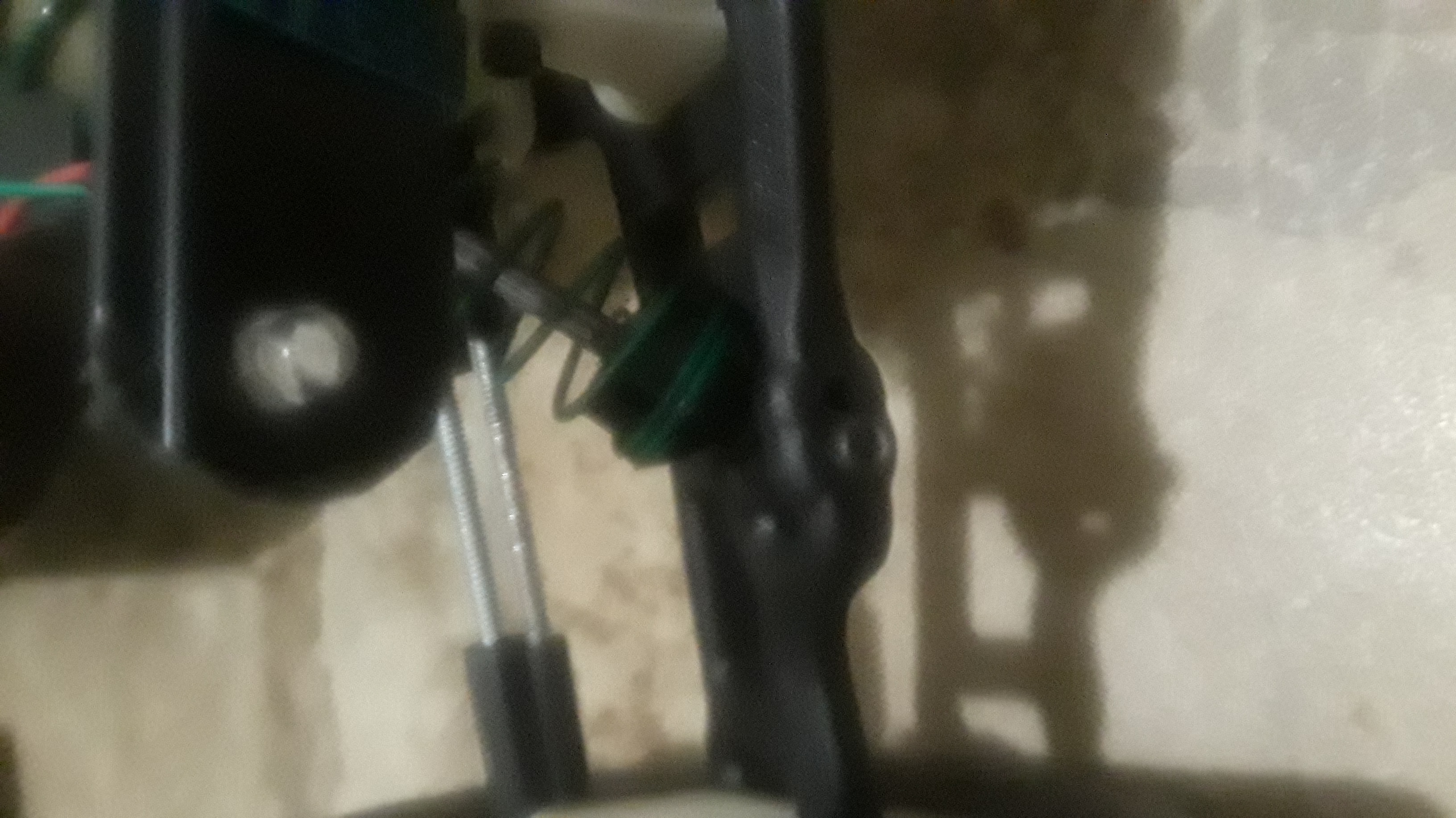

I actually have an original arm on it's way.juicedcoupe wrote: ↑Thu Nov 25, 2021 5:42 am The newer (T2 style) arms have the raised shock mounts.
You can still adjust the ride height with limiters and spring adjustments.
Thing I notice I got the RPM Rustler Long arms but as you stated the Associated arms have a tab that runs up.
Without the tab the ride height gets borked. The other option was to snag a set of back shocks from my busted up T2.
I will probably just build a tab for the RPM arm for my basher.
I'm not gonna put em on the Original T (OT) I just feel bad messing it up.
Gonna replace it and clean this one up and shelve it because it hurts my heart to beat on it.
I moved on to a RC10GTE basher I'm building.

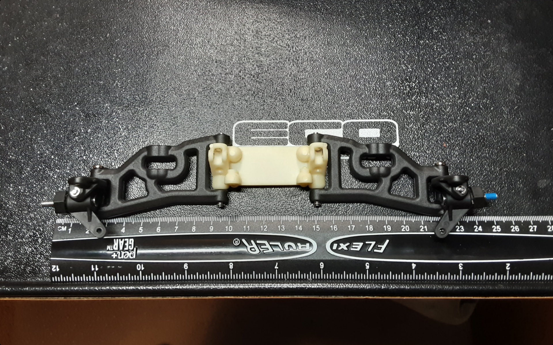

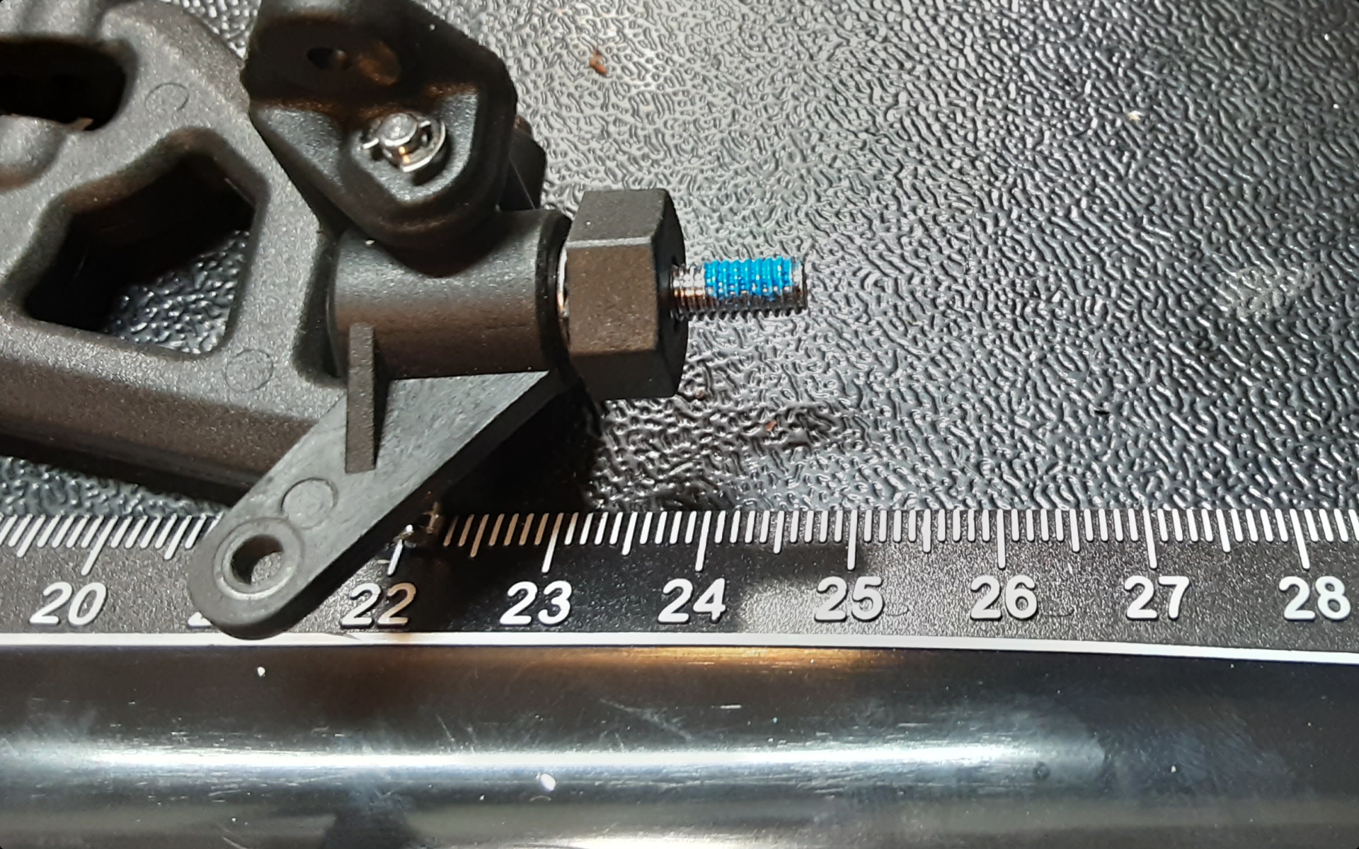

I went ahead and bought some. By my measurements, I see ~71mm.juicedcoupe wrote: ↑Mon Jan 03, 2022 8:35 am Anybody mind checking the length of the 80492 arms, pin to pin?
Anyway. For my project, I wanted hex fronts. I went with Traxxas parts, as they are narrower than AE and more readily available.
The overall width comes in just shy of 250mm. With 5mm hexes, the hex to hex width is 230mm.
I think that B5 offset wheels should work. Maybe I'll experiment with different hexes as well.
BTW, those are RPM caster blocks, modified to fit. Regular Bandit or Drag Slash parts should be a direct fit.
