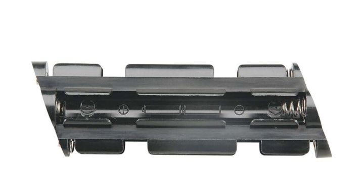

Just an idea, but since each battery has a label, there is a seam where the two sides meet. This makes each battery a slightly elliptical form. Try rotating the cells to line up the seams along the batteries and see if this gives you the necessary half millimeter or so of wiggle room. The only other option would be to remove the labels on the cells, but that could lead to a potential short.
- Posts: 302
- Joined: Tue Nov 08, 2022 10:04 am
- Location: Maryland
- Has thanked: 234 times
- Been thanked: 211 times
Re: AA batteries in vintage transmitters
Final thought, if your battery tray has the raised polarity indicators pictured above, you might Dremel them down to buy you a half millimeter per row. I'm assuming you wont mix up the cell polarity at that point...
