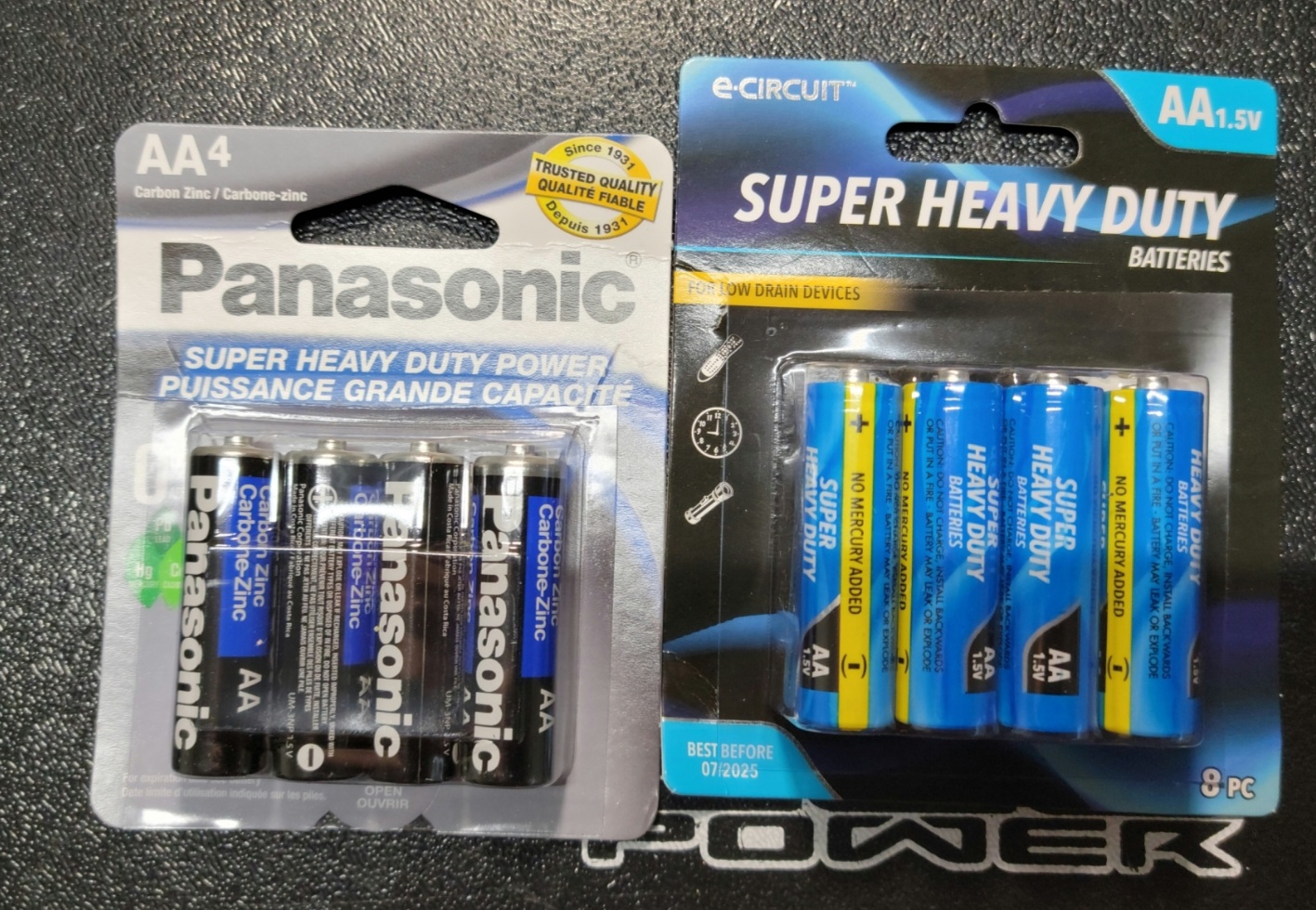

I'm still working on the AAA adapters but I did find some that fit.
Went by Dollar Tree and bought some cheap HD batteries.
The Panasonic Heavy Duty (not alkaline!) are 13.8mm
The E-Circuit Heavy Duty are 13.7mm. Looking at the display, I think that these are the same as the Sunbeam batteries.
These did fit the battery holder easily and didn't bind with the transmitter case.
