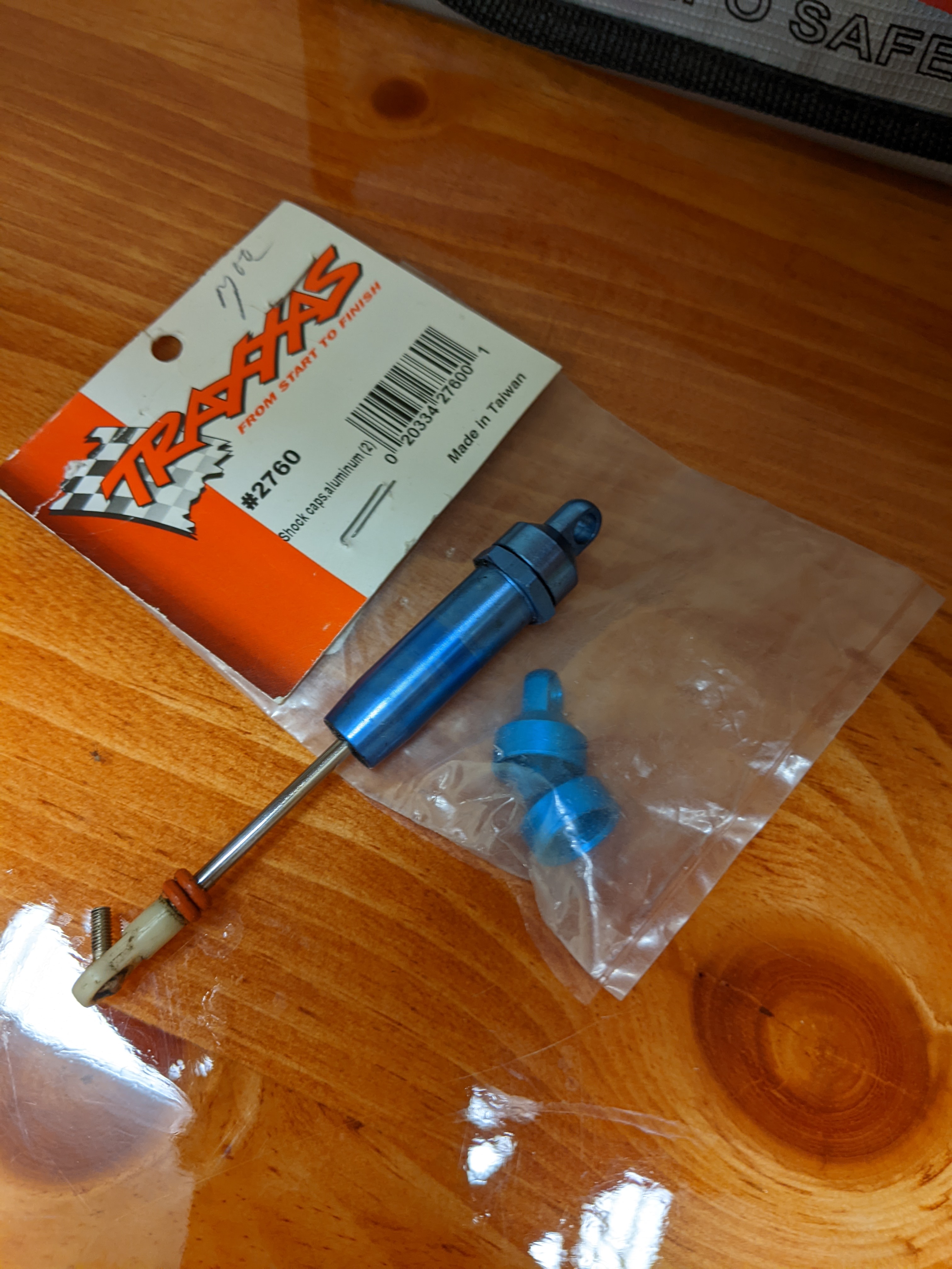

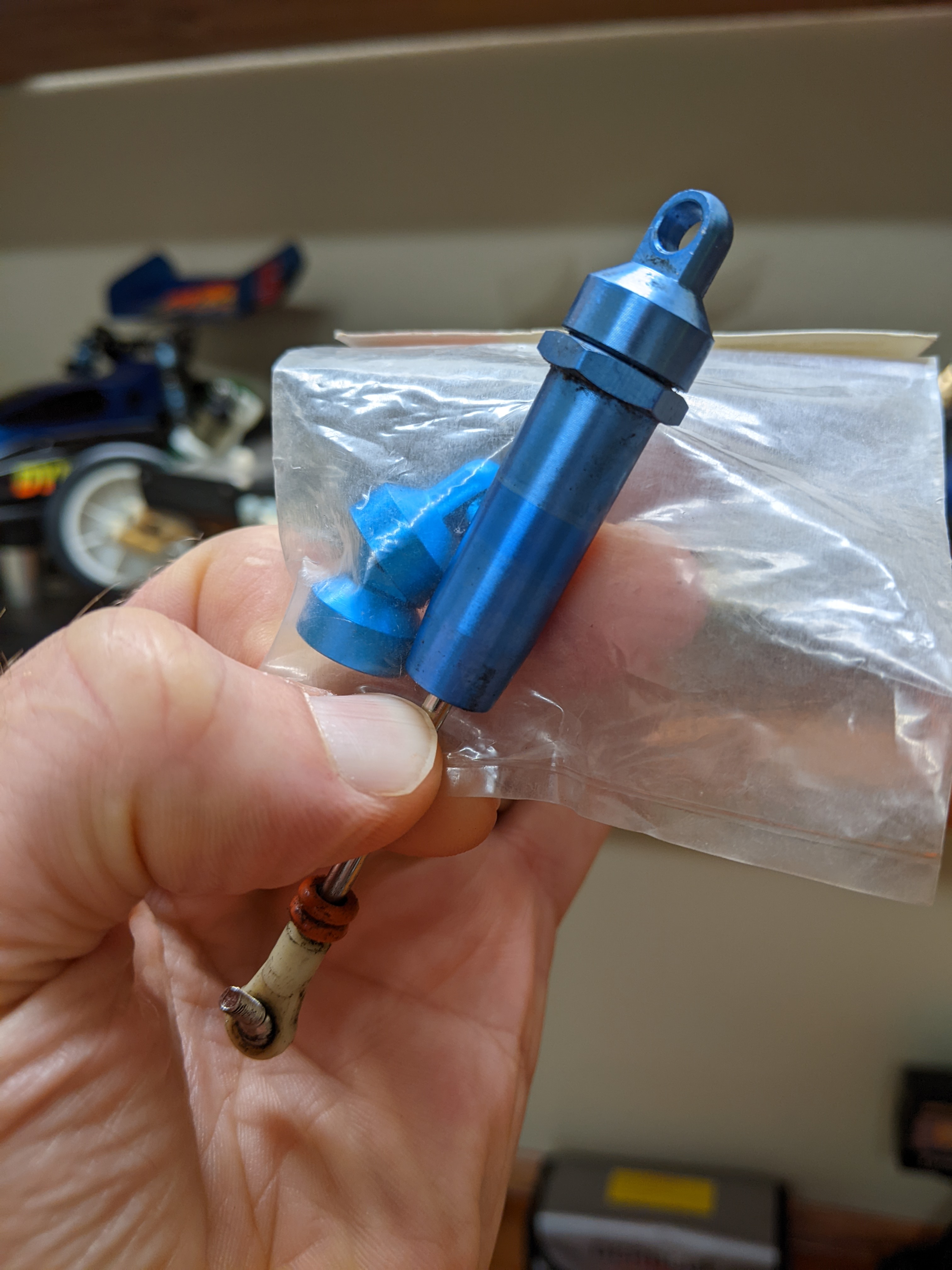

Here are some pics of my early gen (faded) blue, teal 'electric blue' caps, and modern dark blue caps. Maybe hard to tell in the pictures with the lighting, but there's a clear difference.
Hopefully the anodizing shop has a blue tint closer to the original.

Interesting. That teal doesn't look too far off. The three I have show a definite green hue to them. I'll dig them out and take some pics to show the difference. I have seen pics of a nitro hawk in white this shade of teal.
