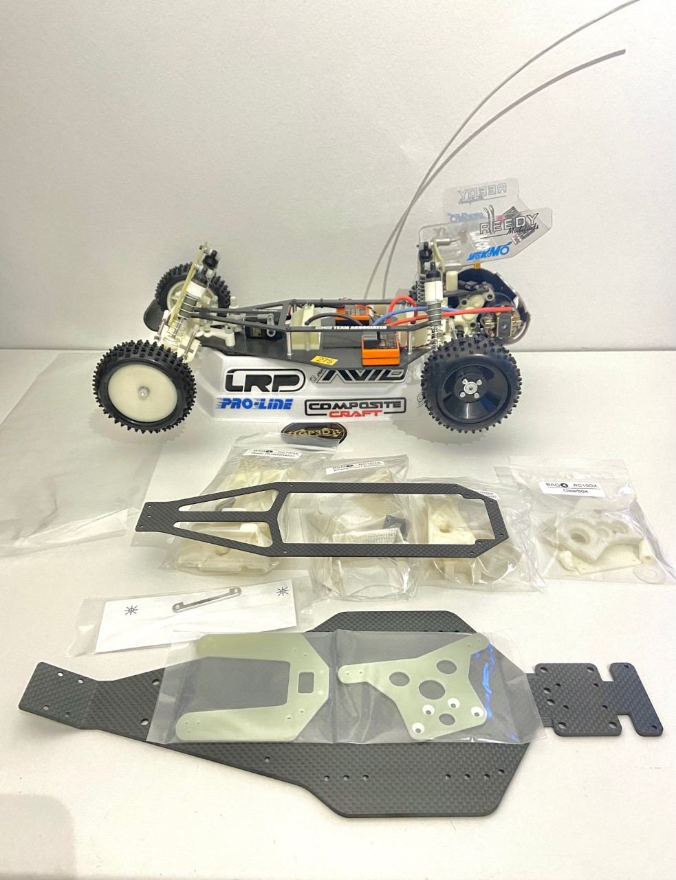

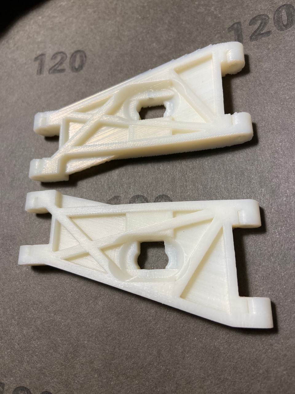

Conversion kit from GrandPrix3D has arrived and the inventory for parts has begun.

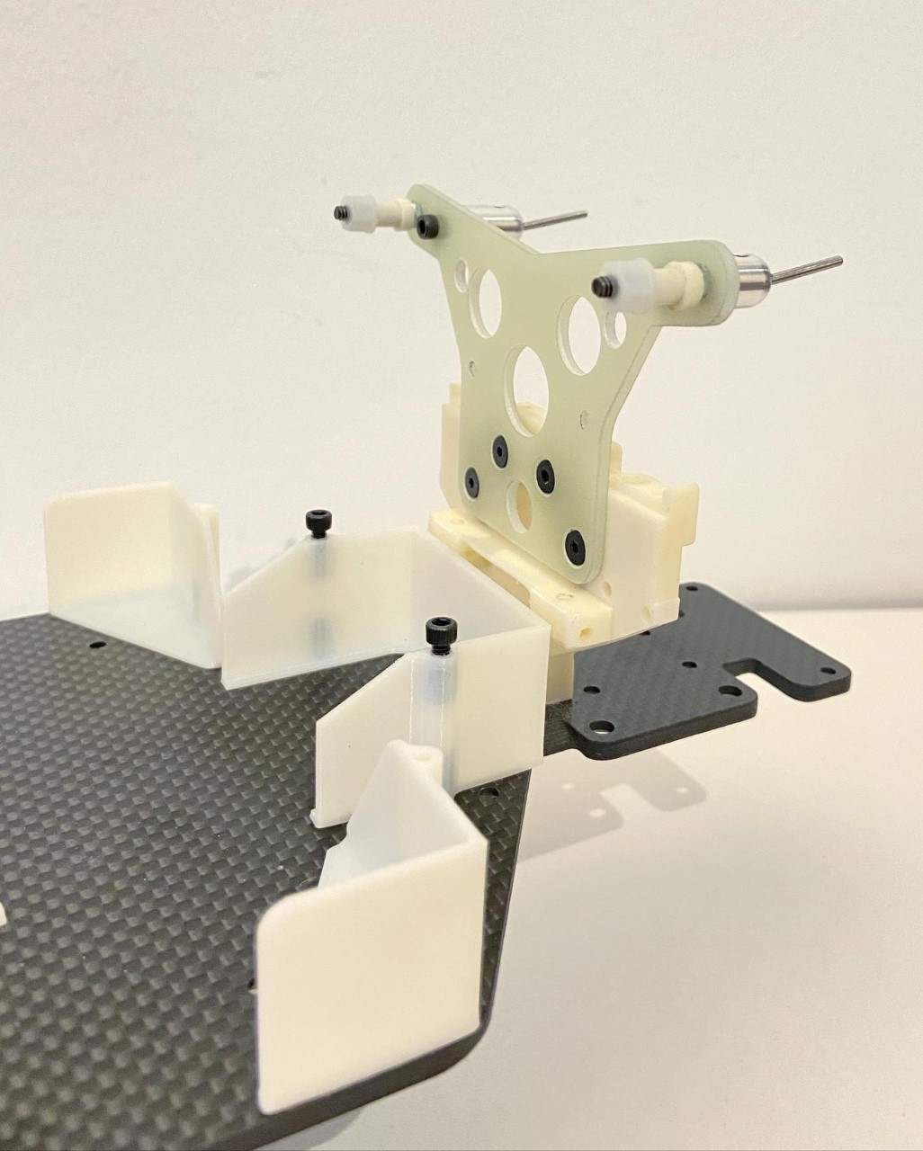

Printed parts feels strong, but there's alot of work to be done to them befor they look representable.
A-arms are first sanded with 120 grit, then 800 grit. Finnishing of with a lite dremel 511S Abrasive Buffs 280. Unfortunately there is no way of reaching the nooks and crannies.
I will also Dremle out the front A-arms around the shock mounting points once I receive the carbide cutter.

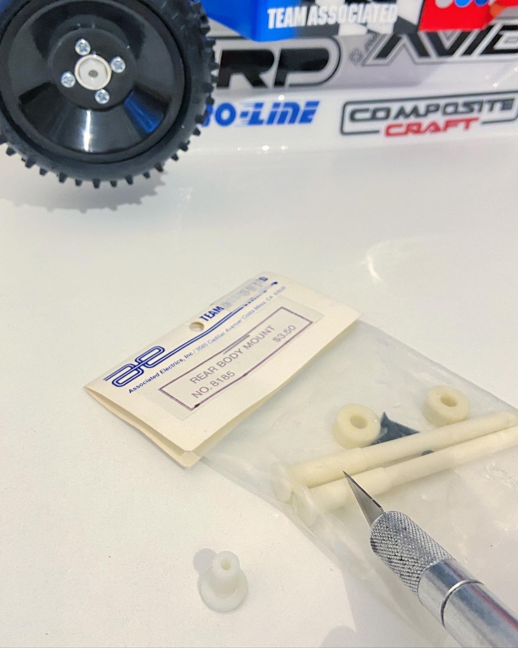

I will use as much original parts as i have at hand and will also go for Evergreen 9060 - .060" (1.5MM) plain opaque white polystyrene sheet for the battery hold down and ESC shelf.
I apologize to all pan car fanatics, but I'm cutting up this set of Associated 8185 for both the NIX91 and GX. Masami used these as front body posts.

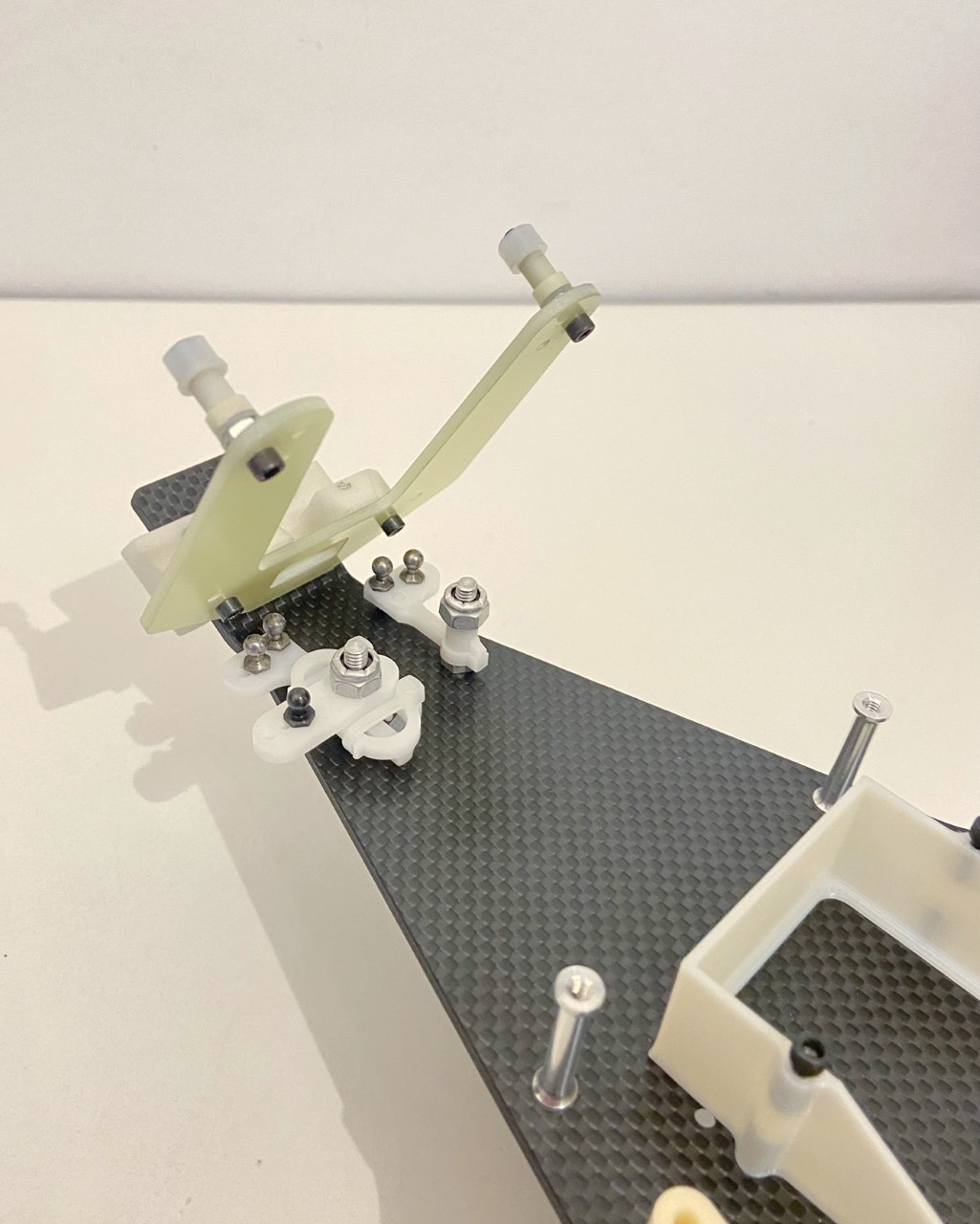

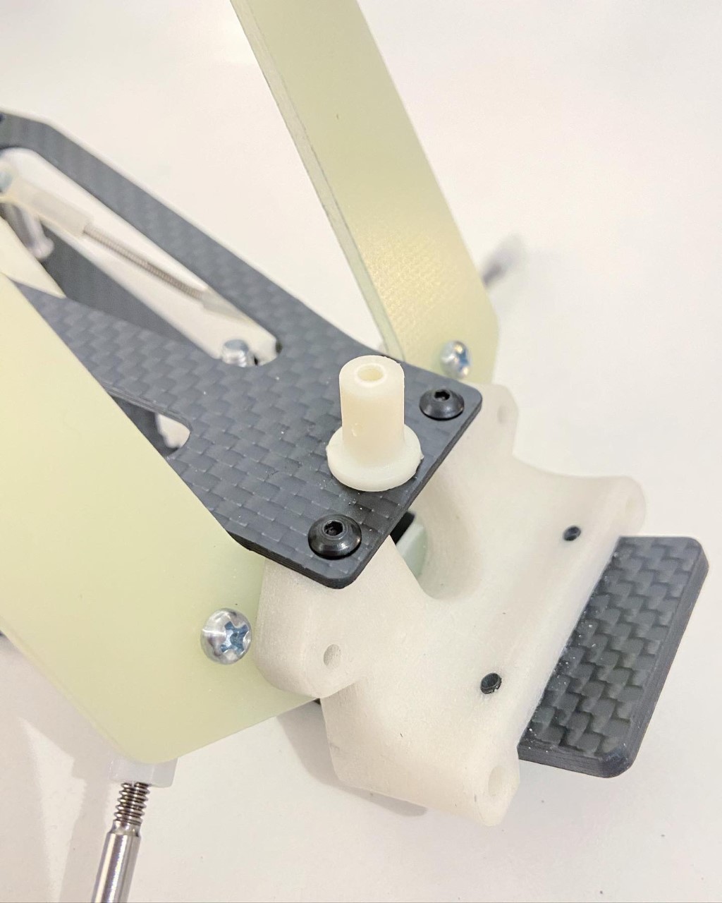

When studying the pictures of Masami’s car I found a couple of additional holes drilled in the rear shock tower.
Also cut an original bulkhead to shape.
Cut, shaped and drilled the steering bell crank as per pics of Masami's car.

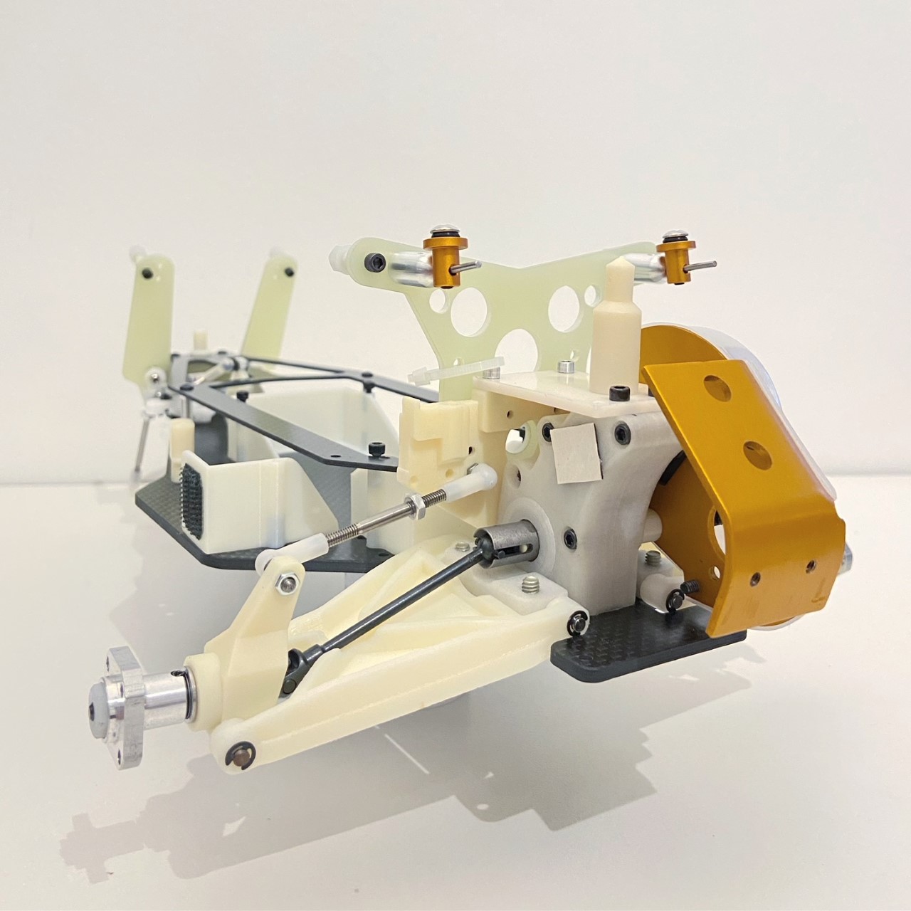

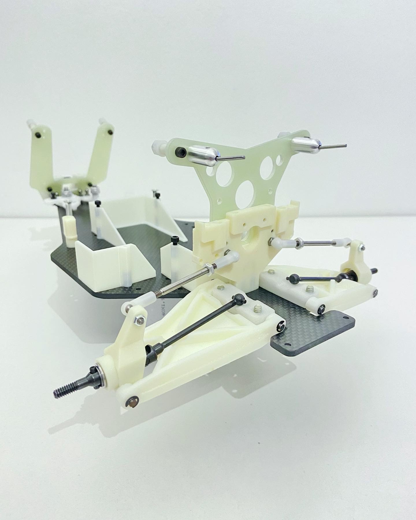

Got some work done on the rear a-arms, universals and links.
I can't talk enough abut these aftermarket injection molded ball cups. Absolutely stunning and just as original. They are the later version with hex all the way.

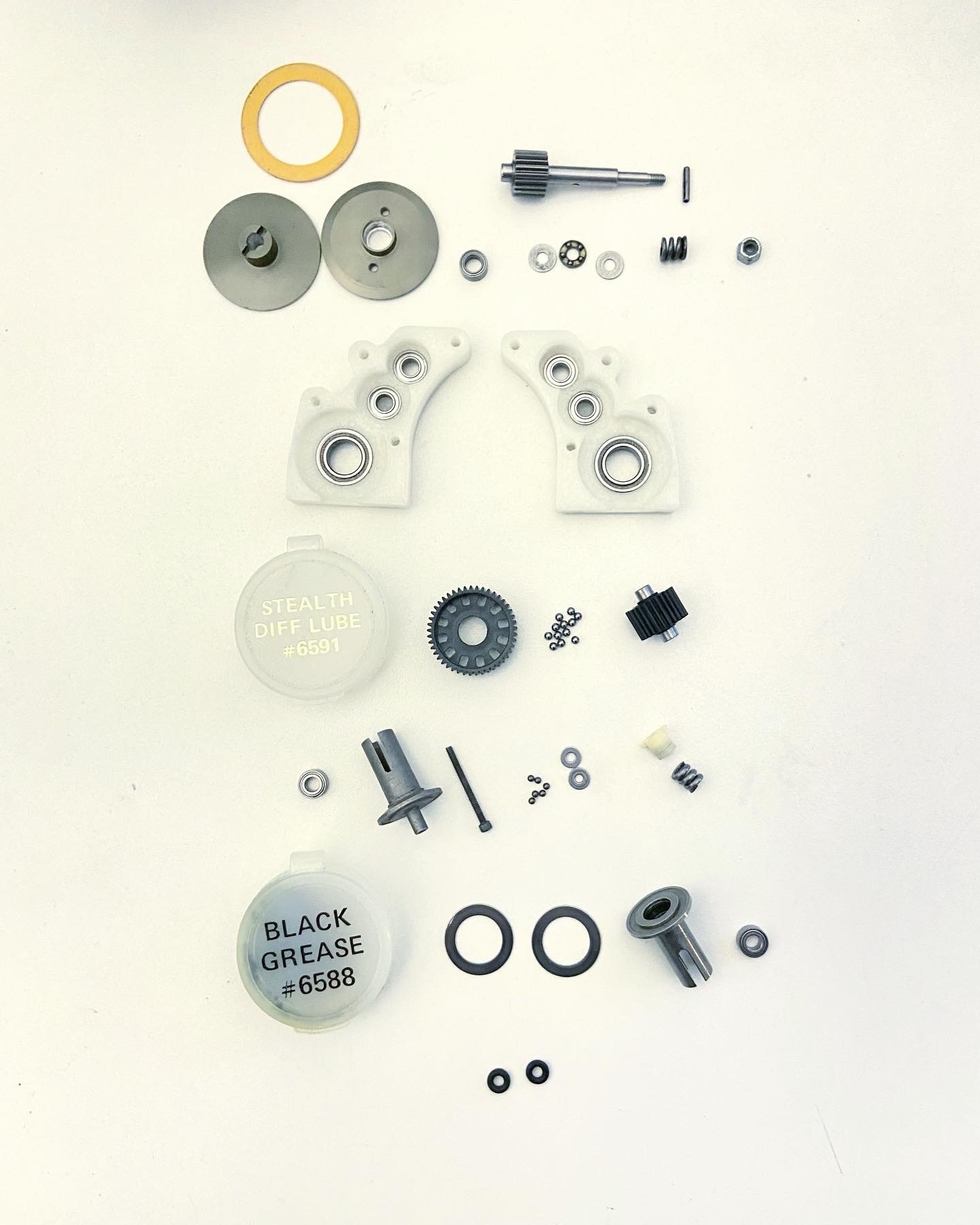

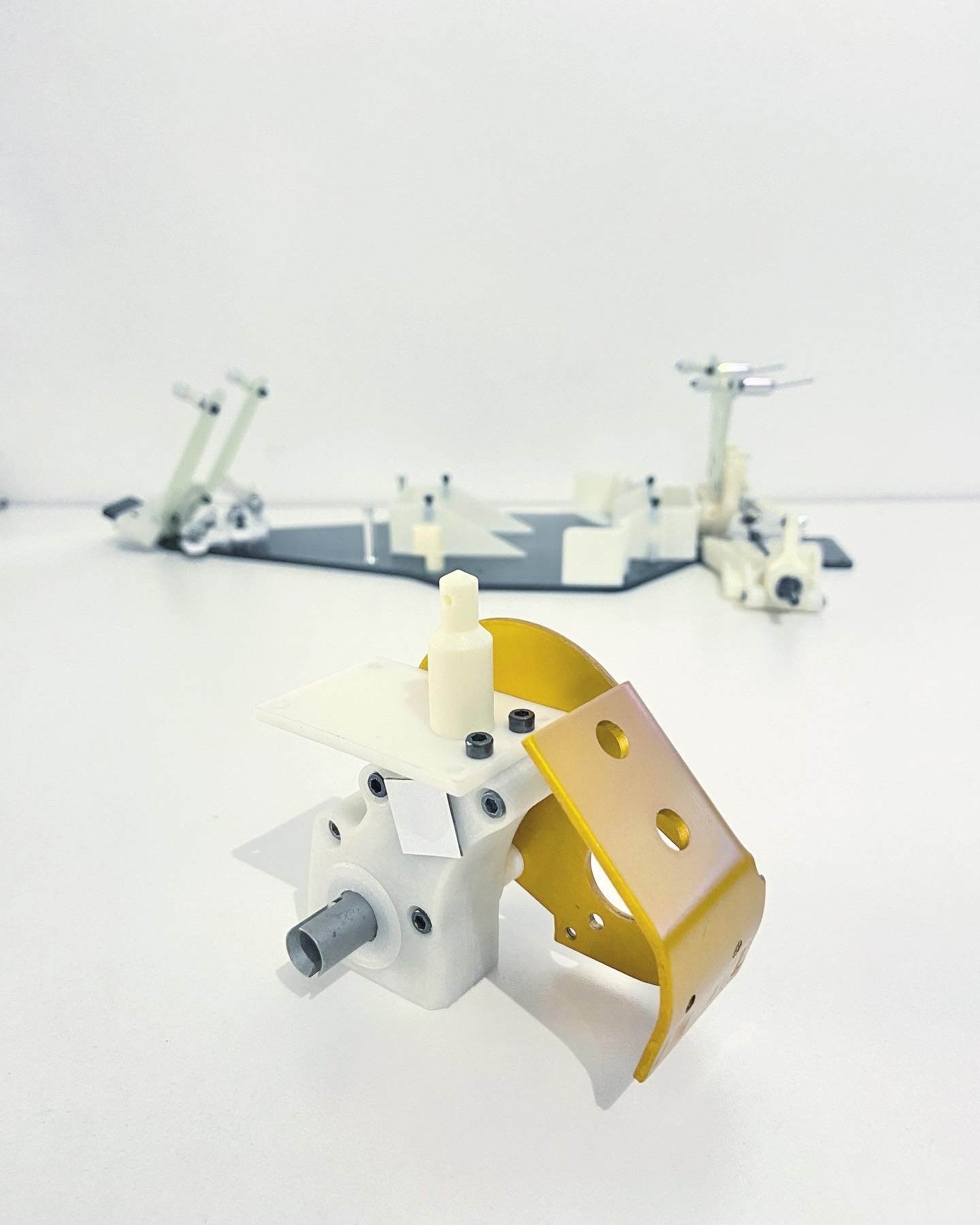

Transmission done.

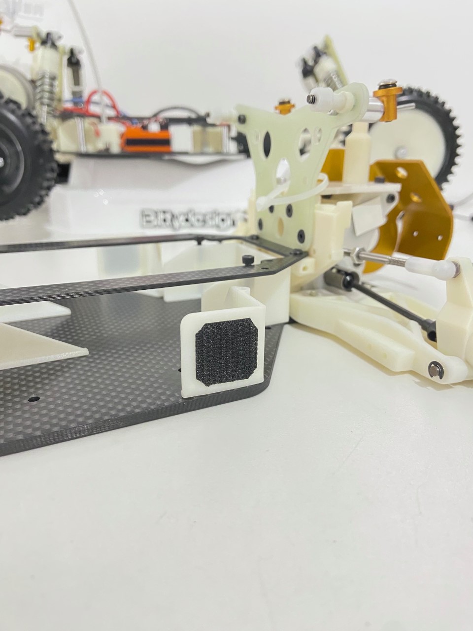

Small steps. Waiting on parts...
Just noticed that I need to source aluminum M3 phillips screws for the front turnbuckles.
