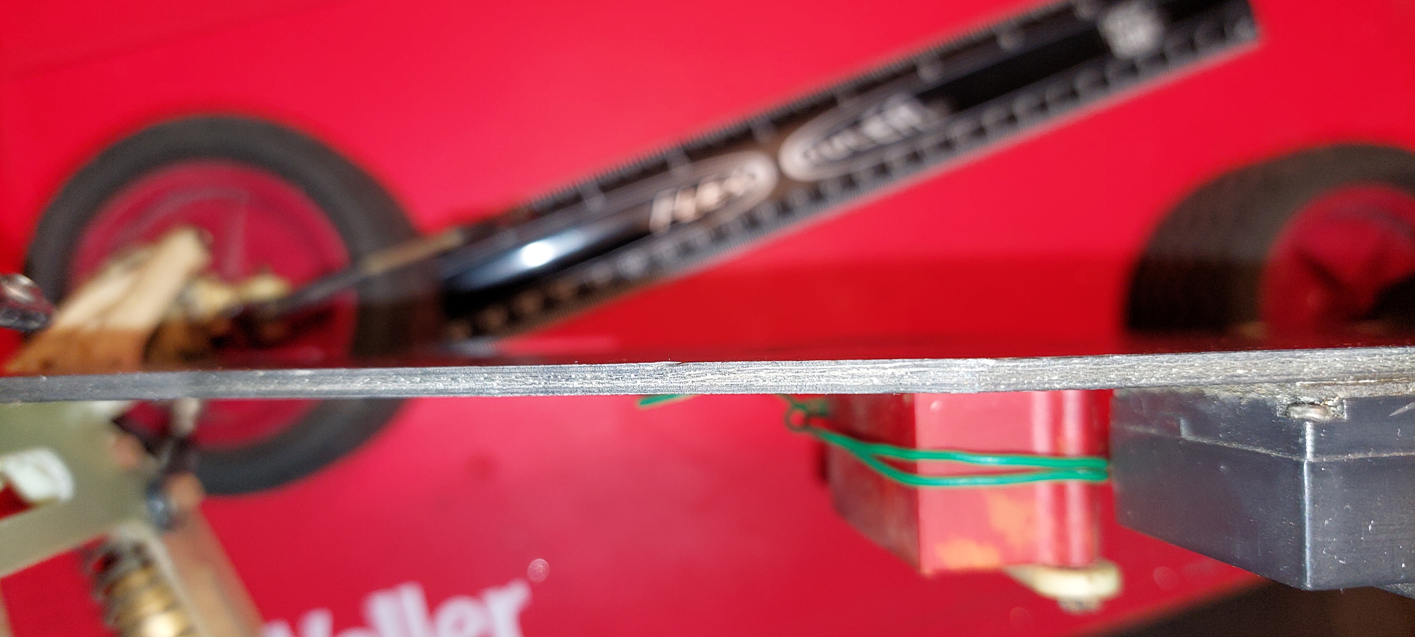

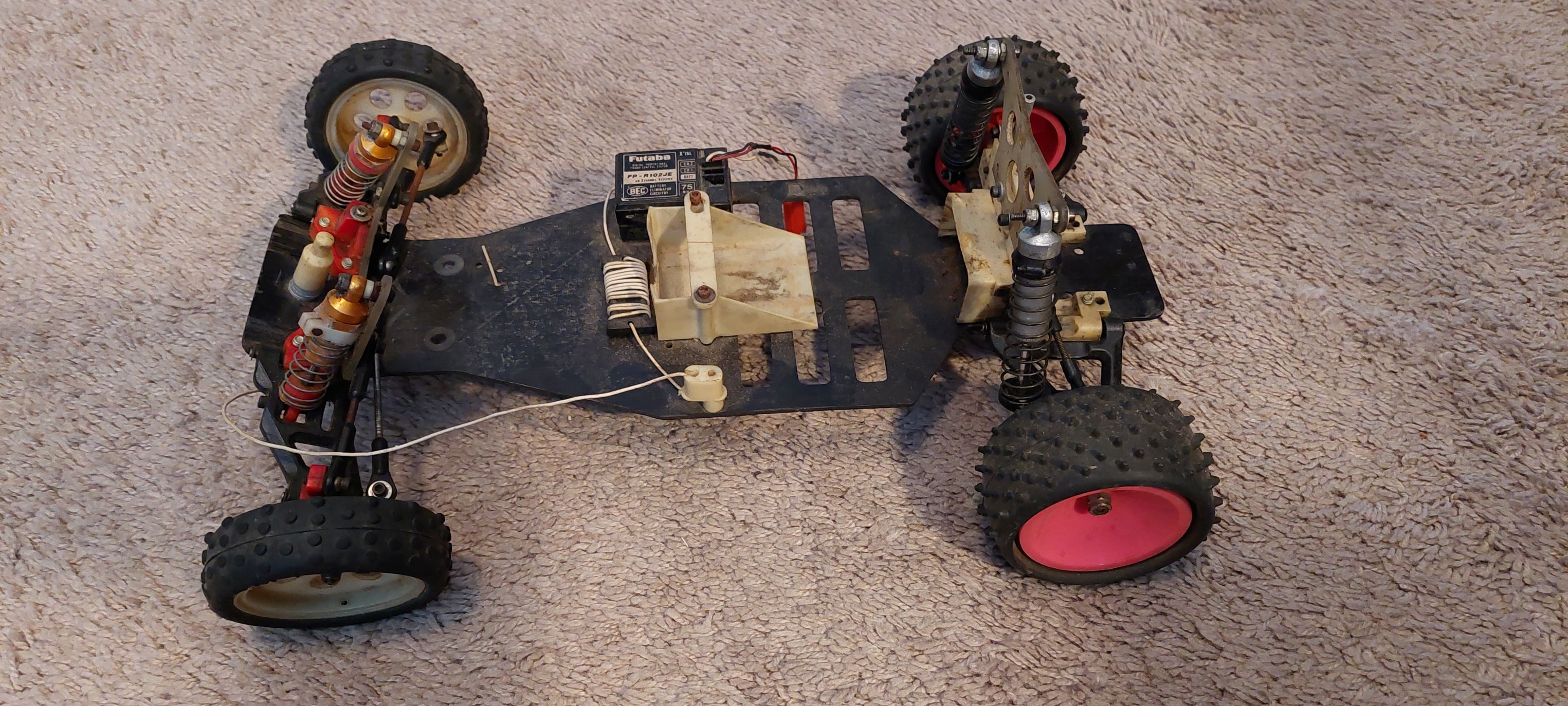

Red wheel chassis has Andy's front and "Houge* Enterprise" rear arms. Does this one have the RC10 Stealth front shock tower? Can't seem to ID the shocks as they are not the typical gold of the RC10-more of a bronze color. Rear bulkhead and shock tower seem standard RC10, but I am not the authority on these parts. Out of my price range as a 12yo.
Pink Wheel ("Trinity") chassis has Andy's on front and back. Fronts tires embossed with "Dynamite Racing". Front wheels have no markings so am assuming it was a tire/wheel combo. Front shows appear typical RC10 where rears are idk what. do you?
Seems both have some sort of carbon composite chassis. Neither have the graphite texture.

Got a couple nice projects there
the red wheeled rc10 looks like maybe someone started a truck conversion. Looks like front tower may be a JG truck conversion tower. Shocks look like kyosho golds but could be duratrax golds. The duratrax will have a bevel on the bottom of the shock body and usually a darker color gold. Chassis could be composite craft, duratrax, trinity. Can't tell by the pictures of what the edge looks like for what its made out of.
the 'trinity' car I'm assuming you're talking shocks when you ask about them. The reats look like someone tried de-annodizing kyosho golds or duratrax golds once again. Better pix of the shocks will answer that. front wheels are proline or trinity.
both are worth tearing down, cleaning and finishing. A seperate build thread for each will get more information for you.

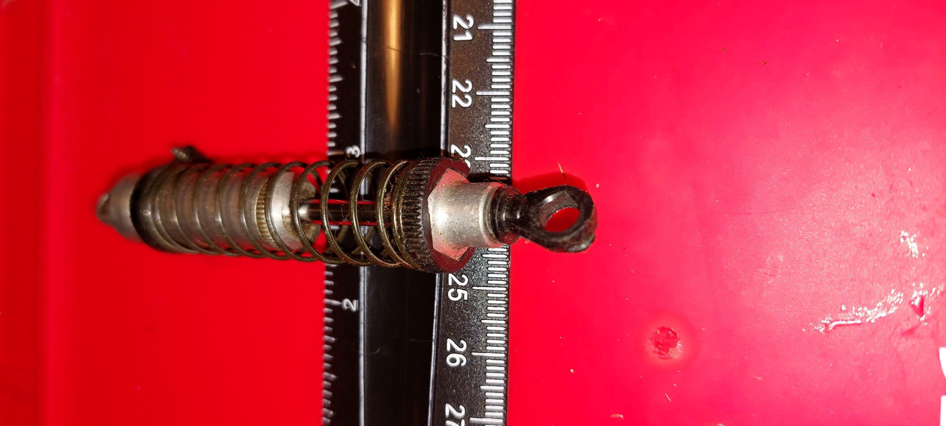

Yep shocks on the truck are definitely kyosho golds,
The rear shocks on the buggy look to be kyosho platinums with different ball joints/ spring cups on the bottom

The trailing arm chassis is Houge, the arms and the chassis. The slotted chassis most likely Composite craft.

Thanks for the replies! Took a few more specific pics to help better determine. Will do some digging and see if they are Kyosho or Duratrax golds. Lower spring retainers on the bottom of the gold shocks do match the W5002 Kyosho Golds and the silvers do seem to match the Kyosho W5004s. OK, the chassis on the car does match the Composite Craft 10026 RC-10 Slotted Chassis. Truck tires on red rims are proline Striker II 22AC50.

The silver shocks look to be the kyosho platinums as mentioned above.

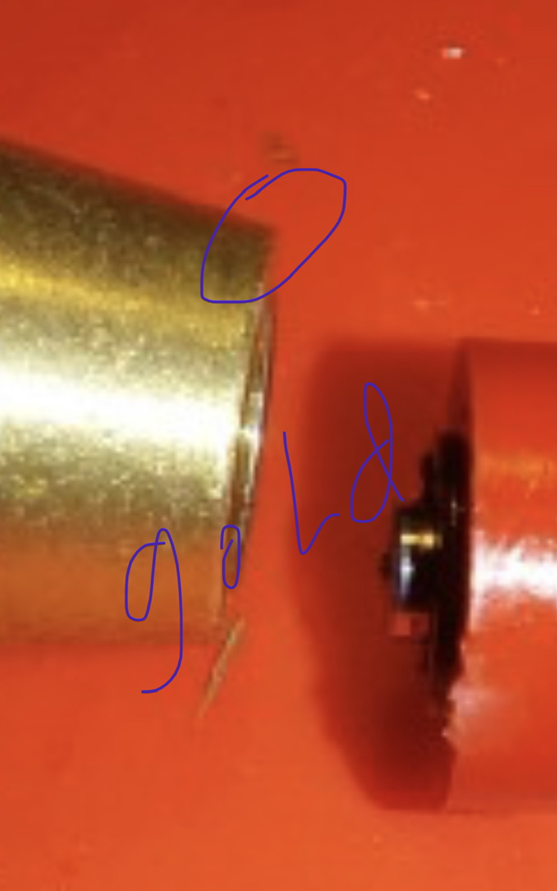

But yeah, the gold shocks look like they got the bevel/chamfer on the bottom of the shock body. That would make them duratrax. The bottom of a kyosho shock body will be sharp where the duratrax shock will have a slight bevel. The duratrax shocks when you take them apart only have one o-ring where the kyoshos are 2 o-ring setups. I can't get my pix to load but there are some definite pictures on the site here somewhere. But the more I look at your pictures the more my eyes are messing with me. If it has a chamfer on the bottom edge it would be a duratrax though...

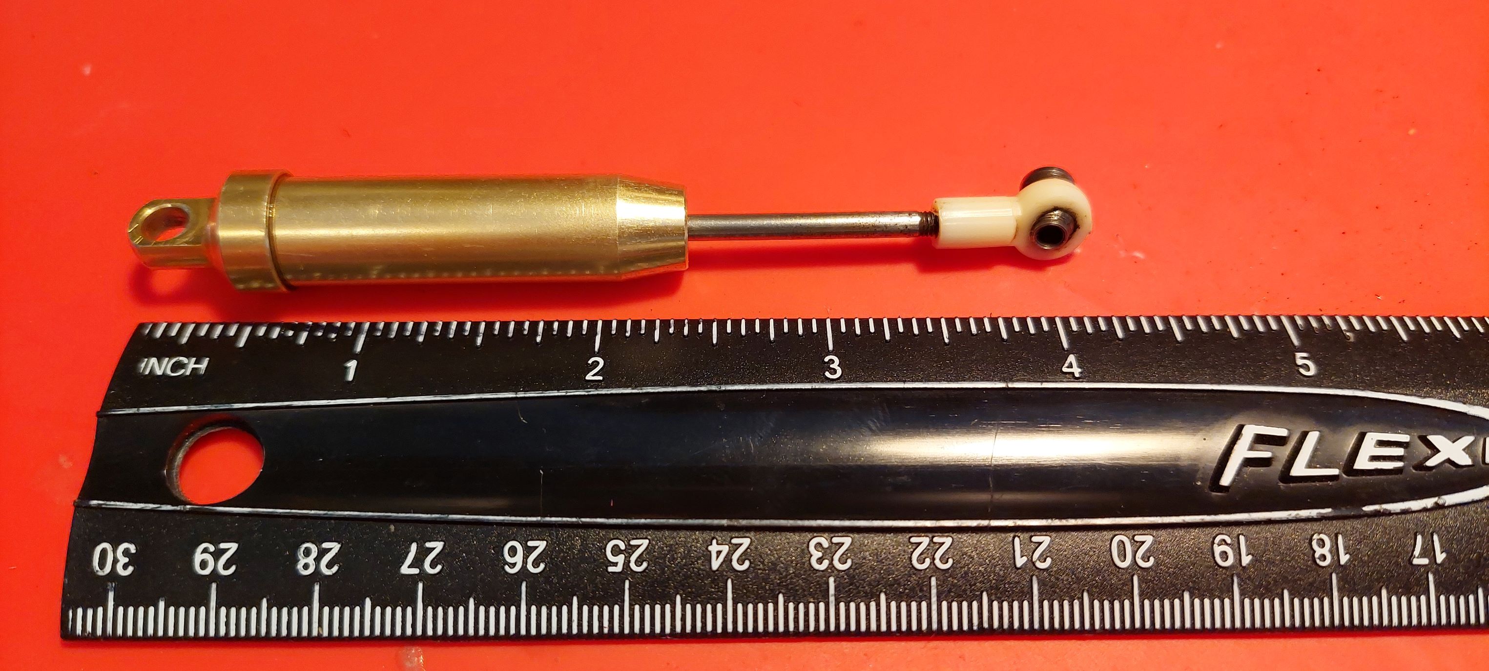

Easy enough so I tore one down to see 1 or 2 seals and...klavy69 wrote: ↑Wed Feb 08, 2023 12:32 am The silver shocks look to be the kyosho platinums as mentioned above.
NOTE: FR
Although I did get a tighter shot... The tapering extends about 6.92mm.

Had to get my phone out to get the picture enlarged enuf to see that its duratrax.

This is the chamfer…

Shock 3 (RL)- This one was actually complete when I tore it down:
Not tearing down the fourth shock as I am quite clear now on which is which. It has Duratrax on the front and Kyosho Gold on the rear.
Duratrax shafts are 3.05mm and the Kyosho shafts are 2.96mm.
I wonder if the depth is different in the two shocks for the seals since Duratrax seal compartment only uses one rubber o-ring and Kyosho uses 2 o-rings. I didn't think of checking until after I put it all back together. This third shock body kinda forces the question since it appears to have a bit of bevel at the bottom,but perfectly accommodates the seals as shown this post.
