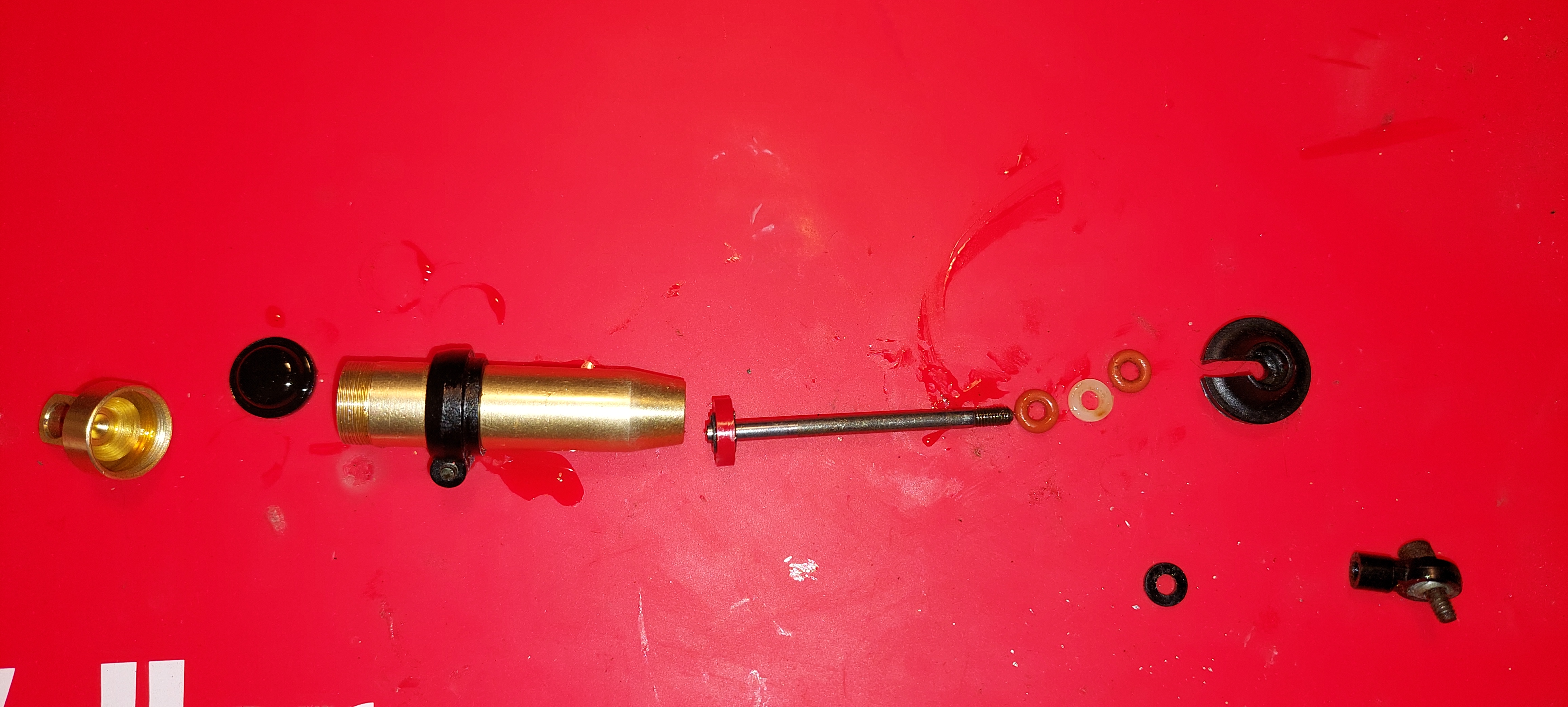

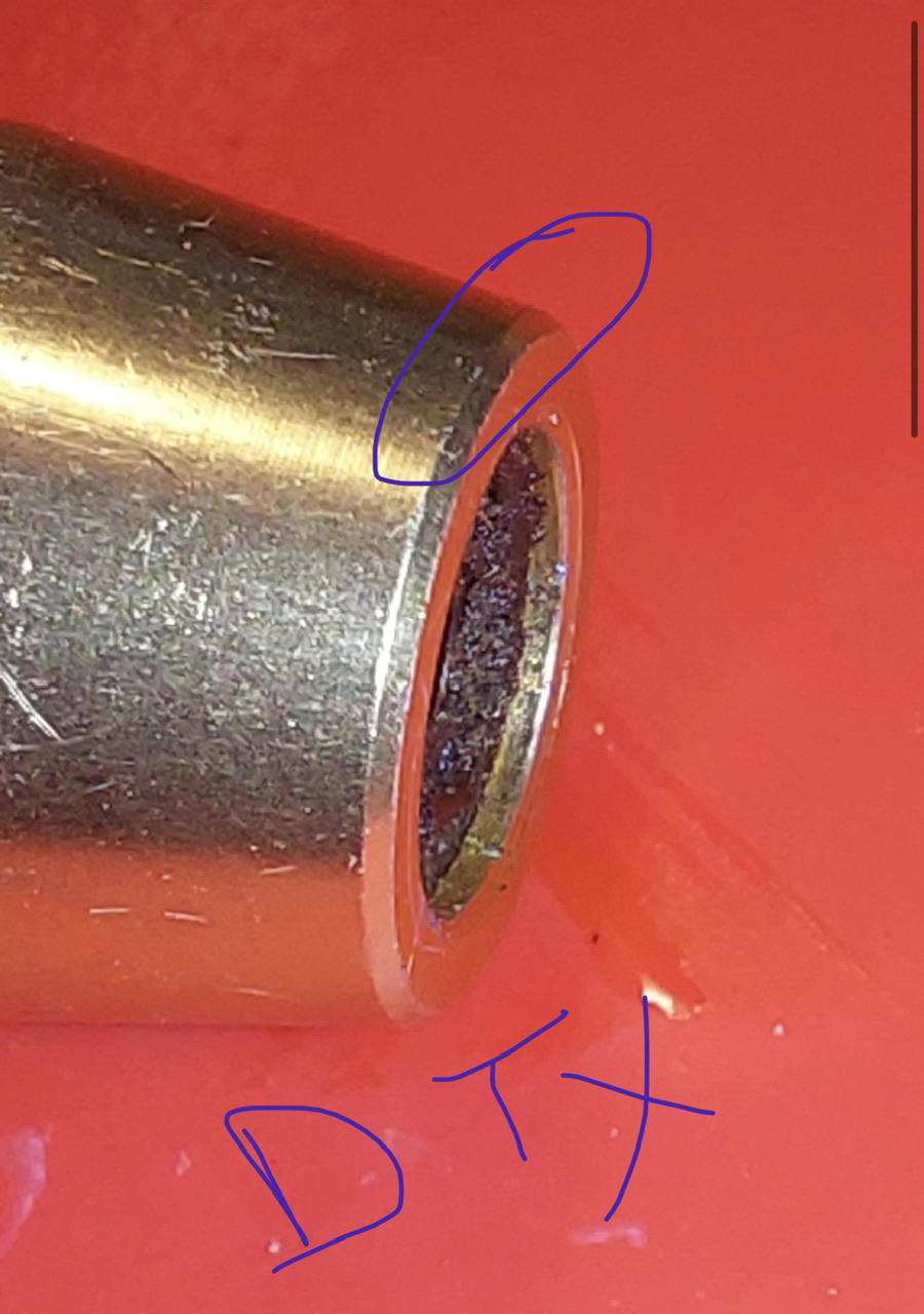

Easy enough so I tore one down to see 1 or 2 seals and...klavy69 wrote: ↑Tue Feb 07, 2023 7:32 pm The silver shocks look to be the kyosho platinums as mentioned above.
But yeah, the gold shocks look like they got the bevel/chamfer on the bottom of the shock body. That would make them duratrax. The bottom of a kyosho shock body will be sharp where the duratrax shock will have a slight bevel. The duratrax shocks when you take them apart only have one o-ring where the kyoshos are 2 o-ring setups. I can't get my pix to load but there are some definite pictures on the site here somewhere. But the more I look at your pictures the more my eyes are messing with me. If it has a chamfer on the bottom edge it would be a duratrax though...
NOTE: FR

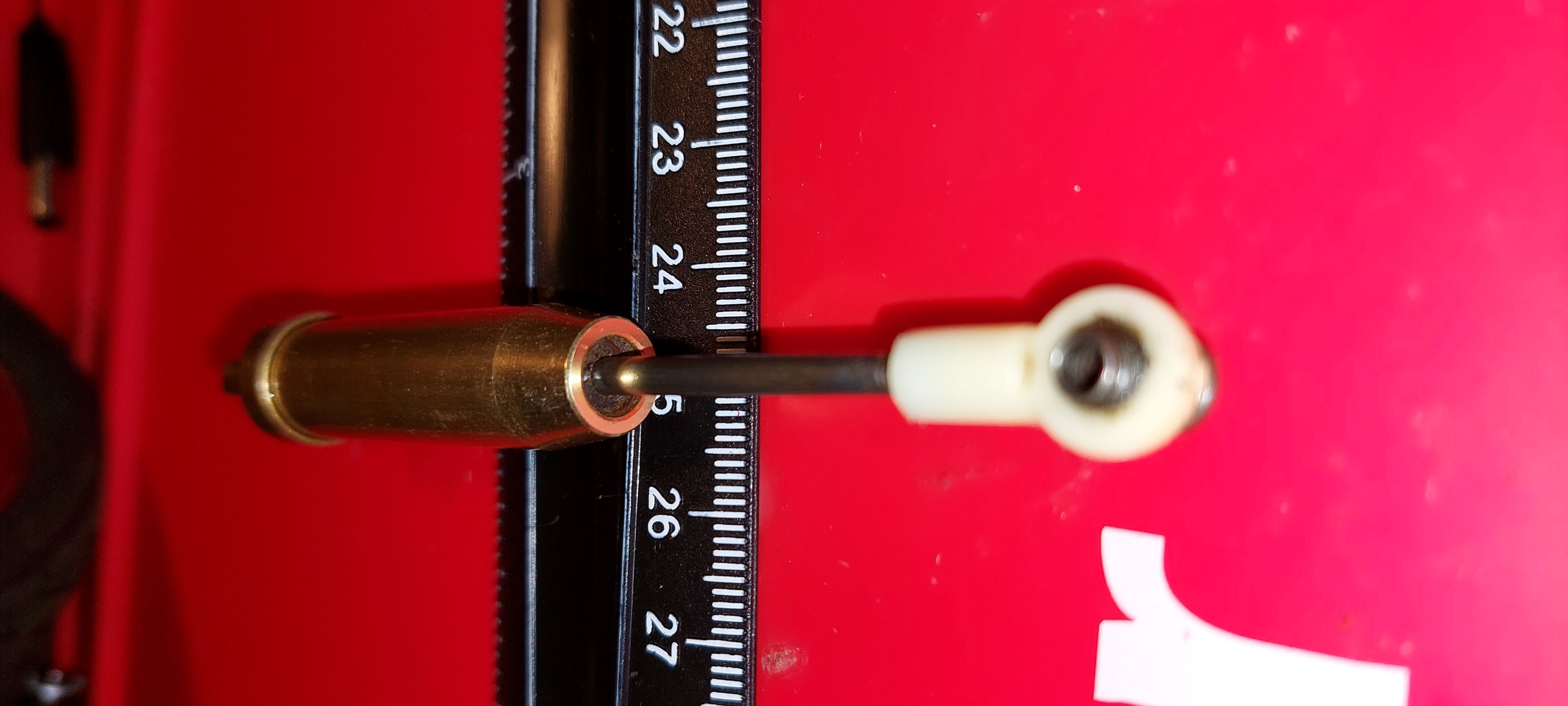

Although I did get a tighter shot... The tapering extends about 6.92mm.

Lol. About the seals but not surprised.
Had to get my phone out to get the picture enlarged enuf to see that its duratrax.

Shock 3 (RL)- This one was actually complete when I tore it down:
Not tearing down the fourth shock as I am quite clear now on which is which. It has Duratrax on the front and Kyosho Gold on the rear.
Duratrax shafts are 3.05mm and the Kyosho shafts are 2.96mm.
I wonder if the depth is different in the two shocks for the seals since Duratrax seal compartment only uses one rubber o-ring and Kyosho uses 2 o-rings. I didn't think of checking until after I put it all back together. This third shock body kinda forces the question since it appears to have a bit of bevel at the bottom,but perfectly accommodates the seals as shown this post.
