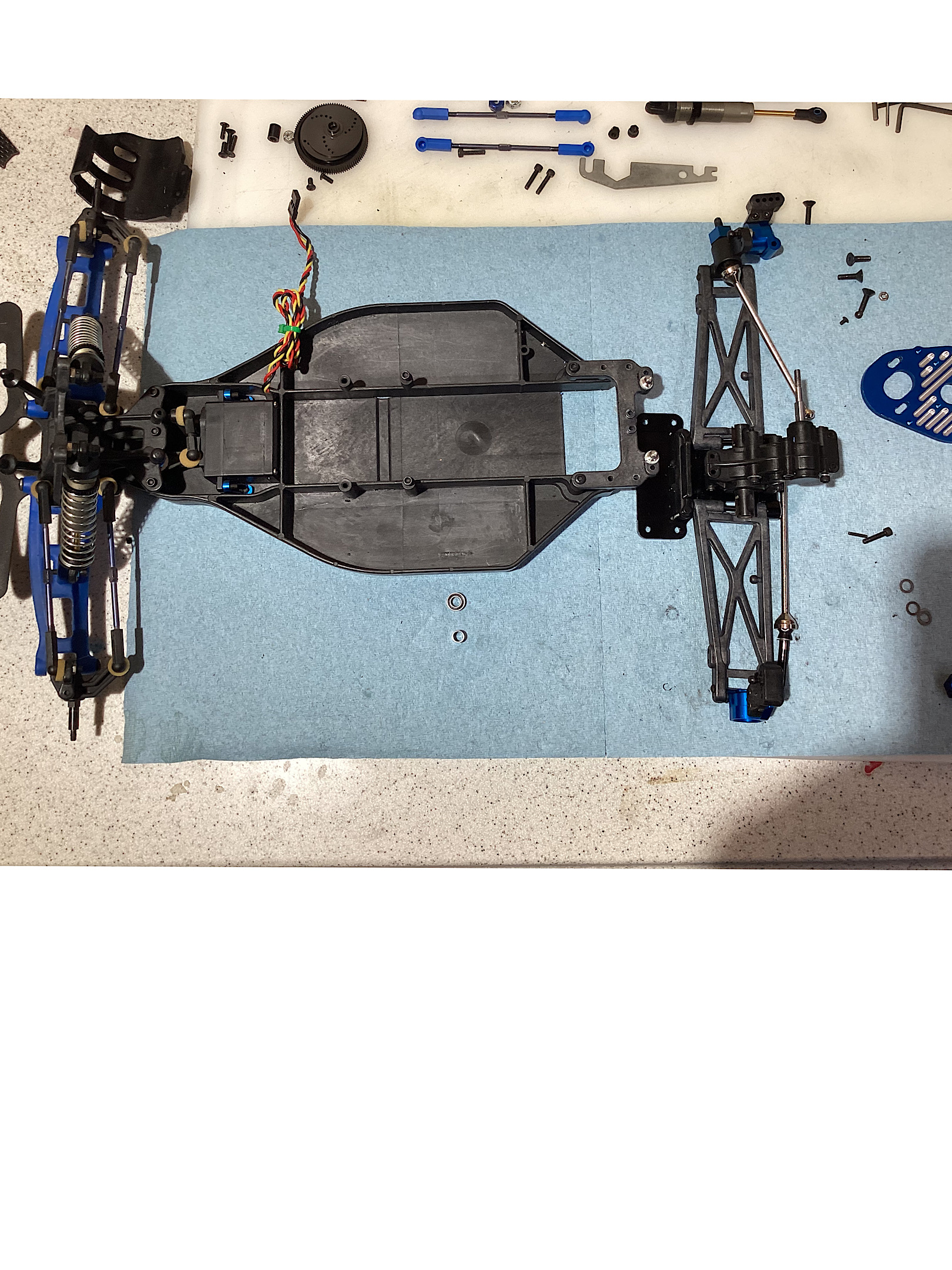

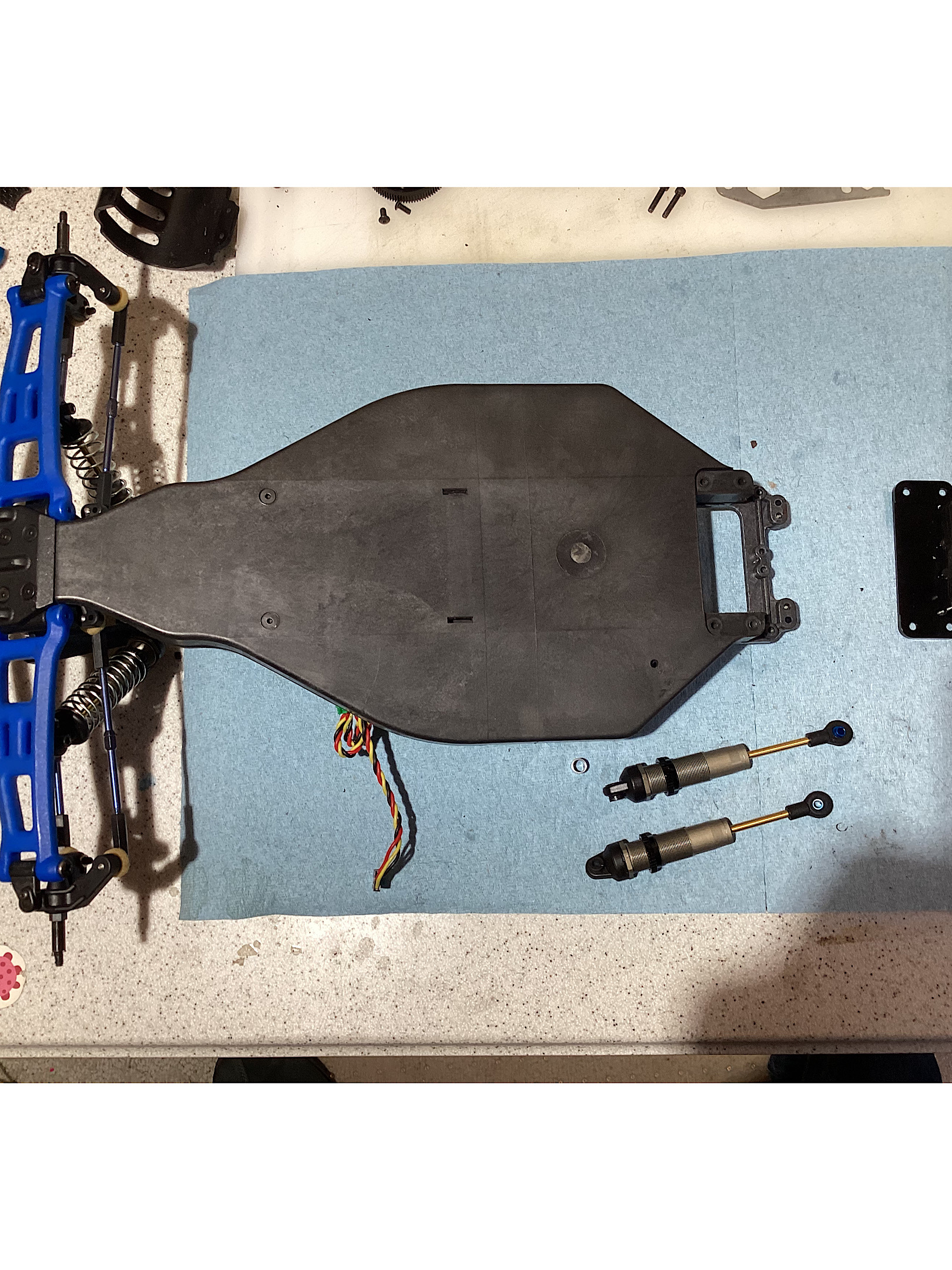

Rlayman
Posts: 95
Joined: Sun Oct 25, 2020 9:12 pm
Location: Hubertus, Wisconsin
Has thanked: 7 times
Been thanked: 10 times
Re: T4 shock question
Post by Rlayman »
The blue arms will go. Going to install the new carbon arms, but the shocks are kind of a stumper right now. May ditch the blue ball cups as well. See how this evolves.
