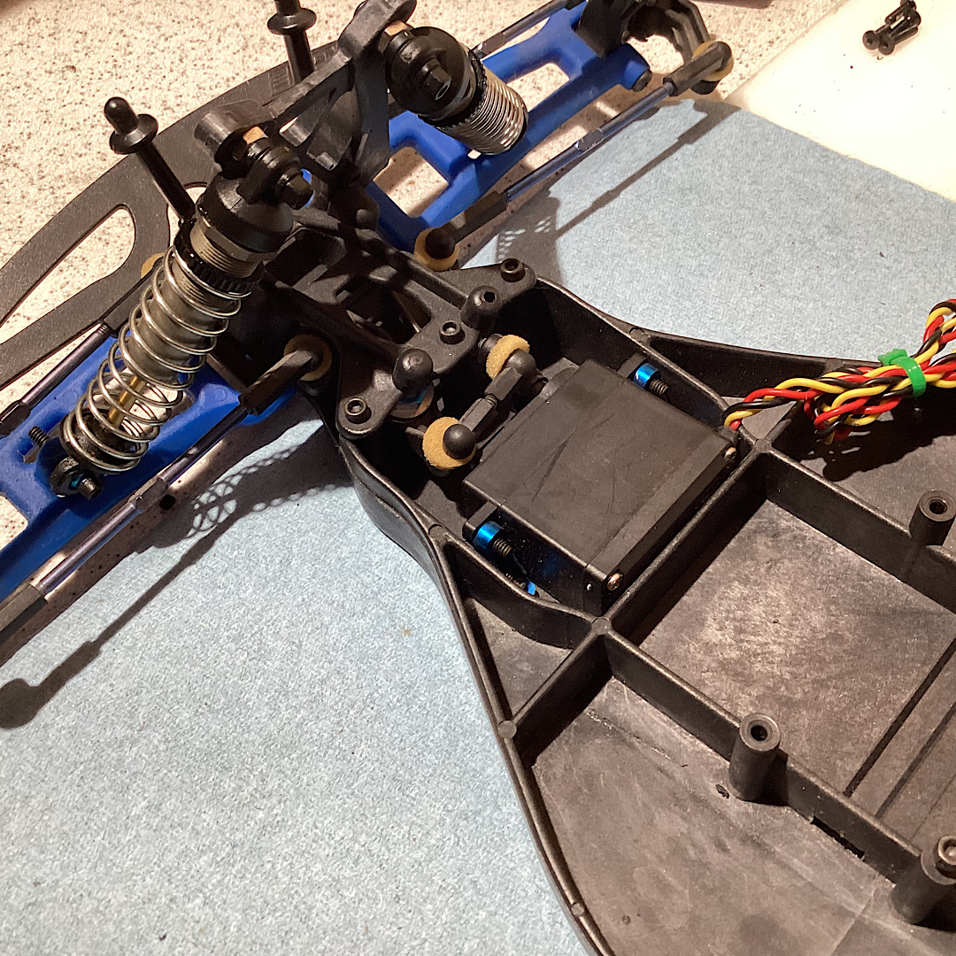

So, I got a nice t4 that was run on road from what I could tell. Been sourcing some decent stuff to get it into “truck” form again. So, it came with the stock shocks. Not bad units, but I was hoping to add some newer big bores possibly. I could not find the factory team v2 shocks. Did a little searching to see what parts are “compatible” with the t4. Any suggestions would be much appreciated.

The blue arms will go. Going to install the new carbon arms, but the shocks are kind of a stumper right now. May ditch the blue ball cups as well. See how this evolves.

Pretty much all of the short course truck shocks will be around the same length as the T4 shocks.

Looks like you’ve got some nice shocks already….
Why change them ??

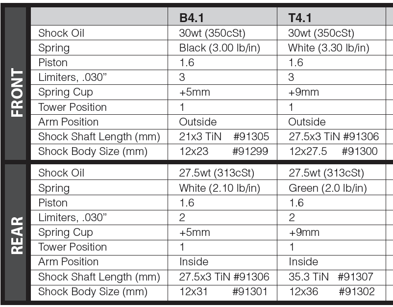

This page has a link to how to convert the t4 to big bore shocks
https://www.associatedelectrics.com/news/latest_products/984-12mm_big_bore_shocks_for_the_b5_b4_2_b44_2_t4_2_sc10_sc10b_and_others_/
The associate parts links are
https://www.associatedelectrics.com/teamassociated/parts/details/72032/
https://www.associatedelectrics.com/teamassociated/parts/details/91483-ASC91483-12x36_mm_v2_shock_bodies/
