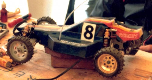

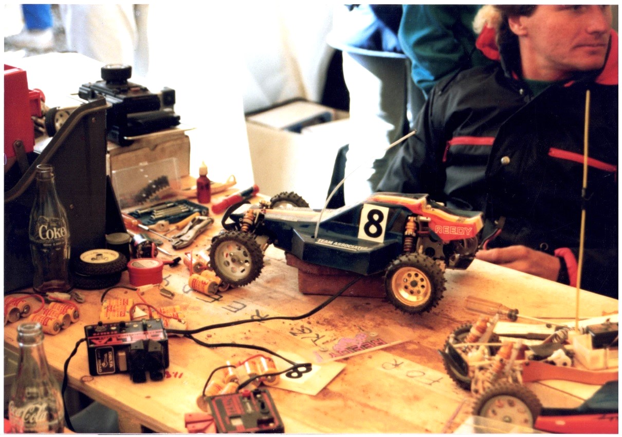

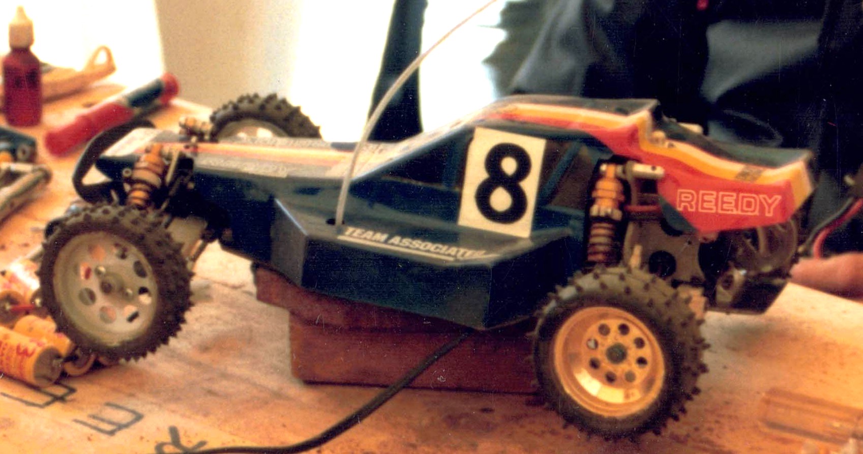

I have posted this up on a couple of Fb group pages earlier today and I was rather surprised at how many people studied and comment upon it.
A friend of mine was a freelance journalist who wrote for the two big RC magazines in the UK, and was at the Reedy Spring International held at Romsey in 1987.... basically a practice run for the Worlds later that summer. The event itself was dominated by the then new LWB Schumacher CAT, and British driver Glyn Peglar seemingly ran away with the event and won it. This was a fairly controversial result as he had not been selected for the British team for the up-coming Worlds event at the same venue.
Anyway - both UK mags mentioned that Jay Halsey and Cliff Lett were running a very secretive prototype 4wd RC10, which was not seen without the bodyshell it seems. They were also not allowing photographs to be taken, but it turns out he managed to take this one, albeit with the bodyshell in place. The mag pictures were of much worse quality, so i thought this might be of interest to folks on here..... there is more than a hint of Optima from what I can see(!)

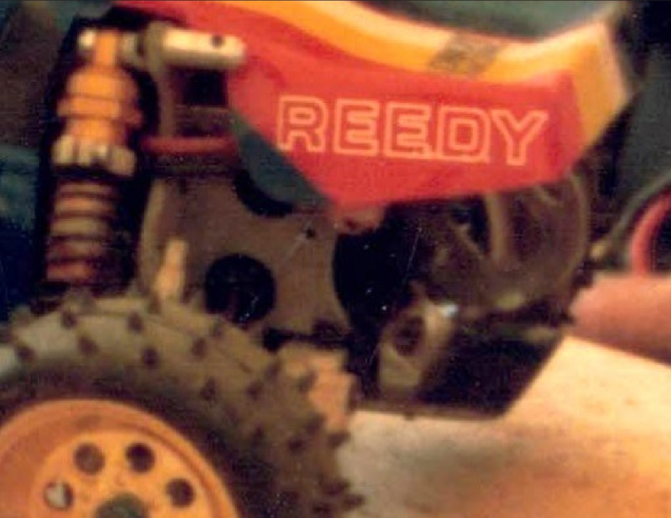

Re: Cliff Lett 'prototype 4wd RC10 'picture - early 1987
Lol looks more like he put rc10 rear arms on a optima and a custom chassis, whole front end and rear gearbox look to be optimaFrankentruck wrote: ↑Fri Mar 24, 2023 5:31 pm Hmmmm... using an Optima donor car could be an interesting way to make a 4wd RC10
The Trinity and Hot Trick chassis for the Optima were flat plates like that Associated car. A lot of conversions for the re-release Optima change it to a flat plate chassis.
The photo of Cliff Lett holding the two cars shows it has the Optima front bumper brace, the underside view shows it has a complete Optima front end. The side view shows it has an Optima rear gearbox with RC10 rear arms.
It's an Optima with a flat plate chassis added so that RC10 rear suspension mounts can be fitted to it.
It is interesting that Cliff ultimately raced an XL at the 87 Worlds instead of an Optima or the AE/Optima prototype.
