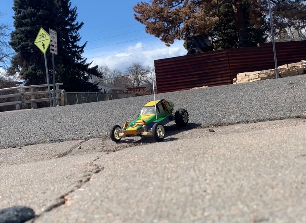

Hello everyone - I'm new here (as you can probably tell) so forgive me if I commit any infractions to unspoken rules. I read the forum rules and I think I've got everything down correctly.
The background to this is that my dad gave me his RC10 buggy that we had last ran about a decade ago and I gave it a bit of a refresh (a new speed controller, battery, motor, and fresh fluids were all it needed). I believe it's an early Edinger model since the chassis has no stamp and it still has the original gear cover that's so thin I'm afraid ever to touch it. The car is in beautiful condition with all of the original non-electrical parts except the wing and tires. In order to protect it I whipped up some scrape bars in CAD that I was able to 3D print which attach to the bottom of the chassis and the nose and don't require any modifications to the car. I'm a mechanical engineer so making these things and finding odd solutions to save money comes naturally to me.
The problem - and the reason that I'm making this topic - is that the 40-year-old RC10 just isn't something that I want to drive like a maniac. I managed to burn out the brand-new brushed motor that I put in within 48 hours of purchasing it (checked to see if I made mistakes that lead to its early demise but didn't find anything). I'm more used to brushless systems and higher voltages so I figured I could make a similar car with parts that I wouldn't care about breaking and could drive the way I wanted. I realized that with a few key parts being pre-made, there were still a lot of injection-molded parts that I might be able to 3D print. So - I decided to take a crack at it.

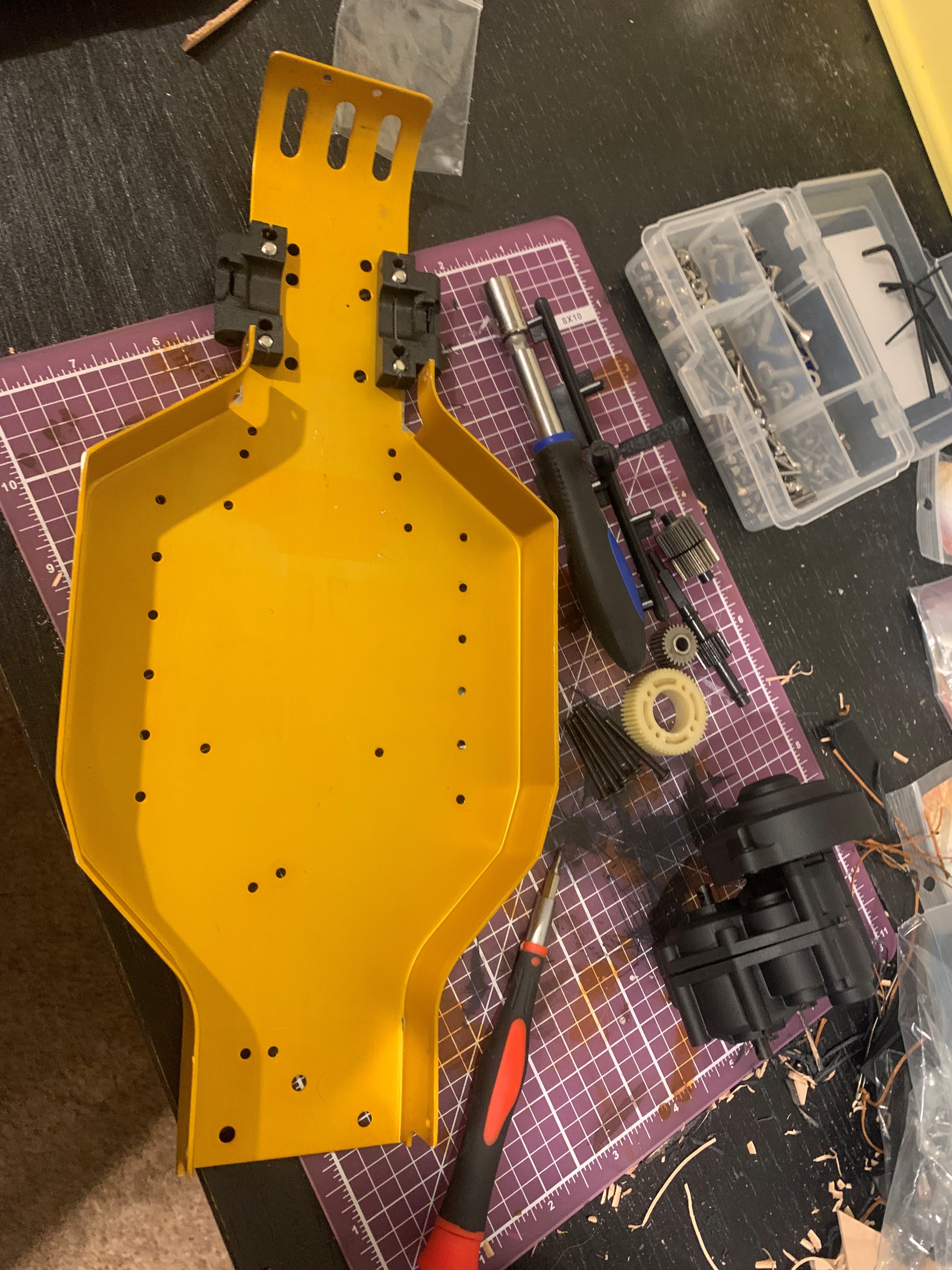

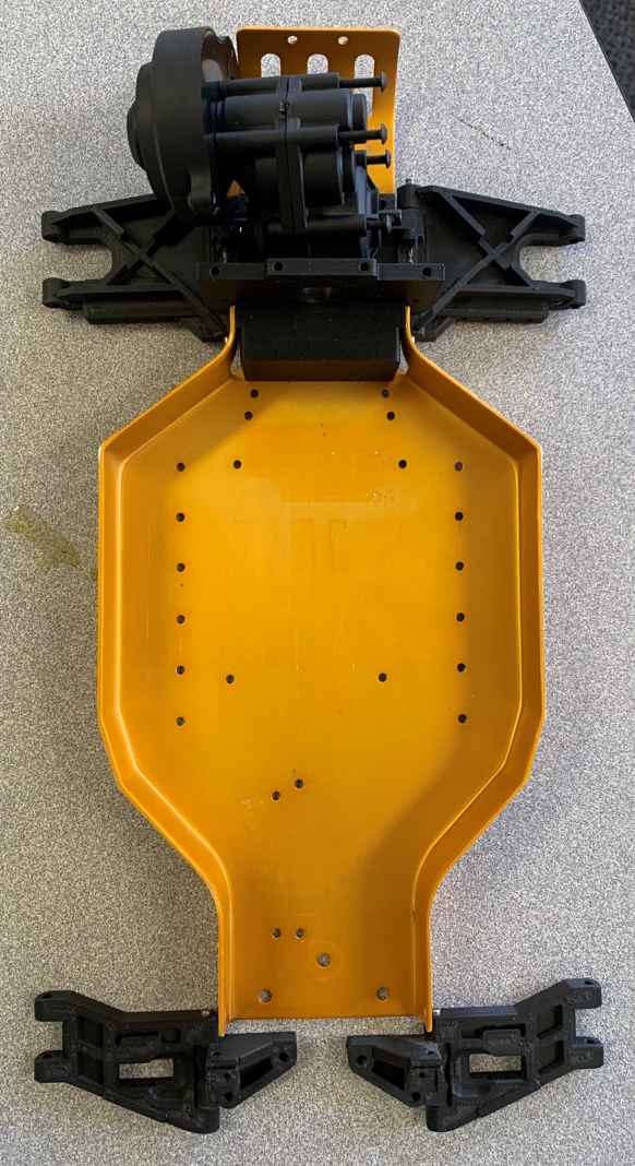

Initial Progress & Where I'm Headed
I've managed to model a lot of the key parts that I want and adapt them to be 3D printable. The rear bulkhead has been the most challenging part to print properly so far so I'll likely modify that more than other components. Here are the parts that I've bought or already had so far:
-A-stamp chassis scratched to hell on the bottom
-Stealth X transmission (I believe this is meant for trucks, not buggies)
-Protector shell from Jconcepts
-2.2" wheels for 3/16 axles from Jconcepts
-Shock Towers from Ebay
-Shocks from Ebay
-Hinge Pins from Ebay
-Focbox VESC Speed Controller (I come from the electric skateboarding world where these are common)
The next step is to 3D print all of the other parts I can which is anything that was injection molded from the original car with the exception being the transmission. I think with some strategically modeled adapters I can make that transmission work, though it will be lacking a differential which isn't a big deal to me. I also need to buy a few more parts like a remote (2.4GHz, right?). I have access to a machine shop and may end up just making my own axles, dogbones, and front nose (along with nose tubes). The goal for this is to go gold, black, and silver but I'm not married to the idea. As you can see below I’ve had some challenges getting the parts to work with screws without layer delamination. My solution to that will likely be copper inserts - that’ll come soon.

1) Early Edinger RC10
2) 3D Printed RC10 (In Progress)

Are you drilling and tapping the holes? Print pilot holes then drill and tap. What material are you printing with?

I'm running PLA. I have access to other materials but sadly the printers I can use are limited in their abilities. For the first go I had tried to slightly overcut the holes and tap using the screw itself - clearly this was a mistake. I will try pre-tapping next and if that doesn't work then I'll purchase some copper inserts.Frankentruck wrote: ↑Mon Apr 17, 2023 7:57 pm There's a lot of scuffed up chassis out there to use for runners. (oops, I missed that you already got one)

I don't think PLA is going to give you the strength and flexibility properties you need for the suspension parts, for a runner that might get used enthusiastically.

I've had good luck with tapping holes in printed parts , if your stuck with pla then use lube and cut slowly or the friction will soften or melt the plastic , generally if I'm tapping PLA ill do several holes at a time cutting only one turn in a hole then moving to the next to let it cool , it's laborious and time consuming but it works , otherwise you'll feel the plastic turning gooey as it gets hot .

If the gold chassis you show is from the car you are referring to you can see the A stamp at the back of the chassis so I wouldn't worry to much about running it.

Printing with PLA is like working with Portland Cement in the real world. As a base, it is easy to work with, but is not strong and does not have any other real redeeming qualities. But if you take that base material, and mix it with great fillers/strengtheners, it can become quite a great product overall. I work with a "tough" PLA material all the time, and I love it, and it is my go-to filament.
You can thread into the filament, but if there is enough surrounding material, you can use brass inserts and your threads will be super strong. In my experience, as long as there is about 6mm of material around a hole (3m in all directions), I can design a 4mm hole in the middle, and insert a brass insert for 3mm hardware.

Tried your strategy with tapping - it worked like a charm! I have had a lot of parts arriving yesterday and today so this should be continuing to come together this week. Below is a photo of progress so far - the hinge pins are playing nice with the 3d prints which is wonderful. I still have to order 1/8 c-clips though. I also modified the bulkhead design to print better and that has showed major improvements in durability compared to the first run. I don't intend to use this with a rear wing so the new design is great for me.Dadio wrote: ↑Tue Apr 18, 2023 11:27 am I've had good luck with tapping holes in printed parts , if your stuck with pla then use lube and cut slowly or the friction will soften or melt the plastic , generally if I'm tapping PLA ill do several holes at a time cutting only one turn in a hole then moving to the next to let it cool , it's laborious and time consuming but it works , otherwise you'll feel the plastic turning gooey as it gets hot .
Thing's I've noticed that have helped with print stability:
- Using at least 4 perimeter walls on everything
- Printing in layer orientations that won't split when threaded
- Using 20-40% infill
- Using organic supports where needed

Minimum 4 walls is good , I often go to 7 or more as well as similar numbers of top and bottom layers , infill generally does not add any strength , the void space is actually what helps , in structural terms a tube is often more robust than a solid rod as it can flex better , the semi hollow space of infill makes a part act like tube as it can flex rather than snap , hard to get you're head around some of the structural stuff but as you've noticed like wood grain it's all about correct orientation on the build plate .
