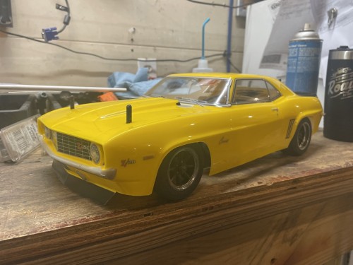

Anyway, decals aren't done and I have a different set of wheels yet but the car in question...

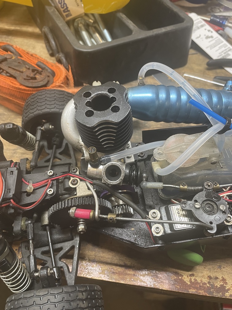

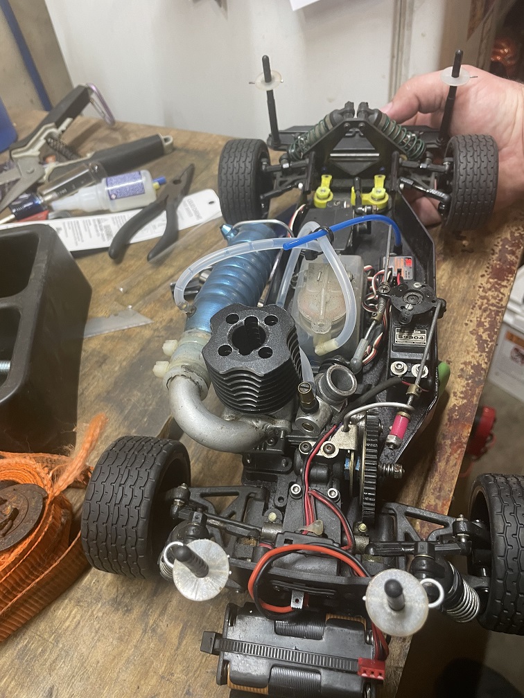

A picture of the engine would help which could be from a different manufacturer than the carb. Also, if you want to add a pull start you may need to replace the crank as well. Sometimes the boss on them is removed to clear the cap that's put on in place of one.

Here are a few pics of the engine, it does say TOP on the block as well... I took a glance at ebay and didn't see anything for it, but i haven't looked hard. I also haven't gotten around to messing with the starter box more yet either.

well, was happy to see the TOP as a Novarossi motor but that doesn't help you since all of mine are still non-pull start.

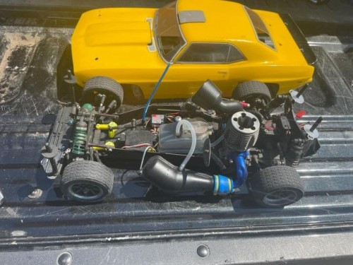

This project isn't dead, just adult life in the way as usual. Anyway, a friend had a traxxas 2.5 laying around so I have it in the car. Still working out the exhaust situation but getting there, this pic shows it with a Jato header which is all the way against the body.. I have a Rustler header coming for it that looks like it will tuck better, otherwise I will modify as needed. I do have an easy start sitting here as well and I honestly think it could work with a little rearranging of the fuel tank and receiver position but I'm just going with the pull start for now.
Re: Nitro RC10ds engine questions
This is the final setup. Rustler pipe and header, the exhaust blows under the chassis to the center.
The car is an animal to drive on the HPI Vintage tires, the Traxxas 2.5 is way to much for it, geared 24/58 and I feel like it is on par or faster than my Slayer Pro.
I have a set of normal low profile touring car tires I'm going to try on it, maybe then I can control it and stay in the throttle long enough to see how fast it is..
