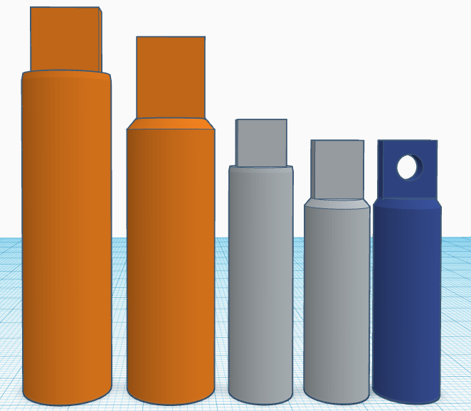

The rear shocks on the se are the xl shocks and not the long shocks. The same as the pro and lxt rear shocks, only the juniors and the x2 and xT have the standard long shocks on the back.

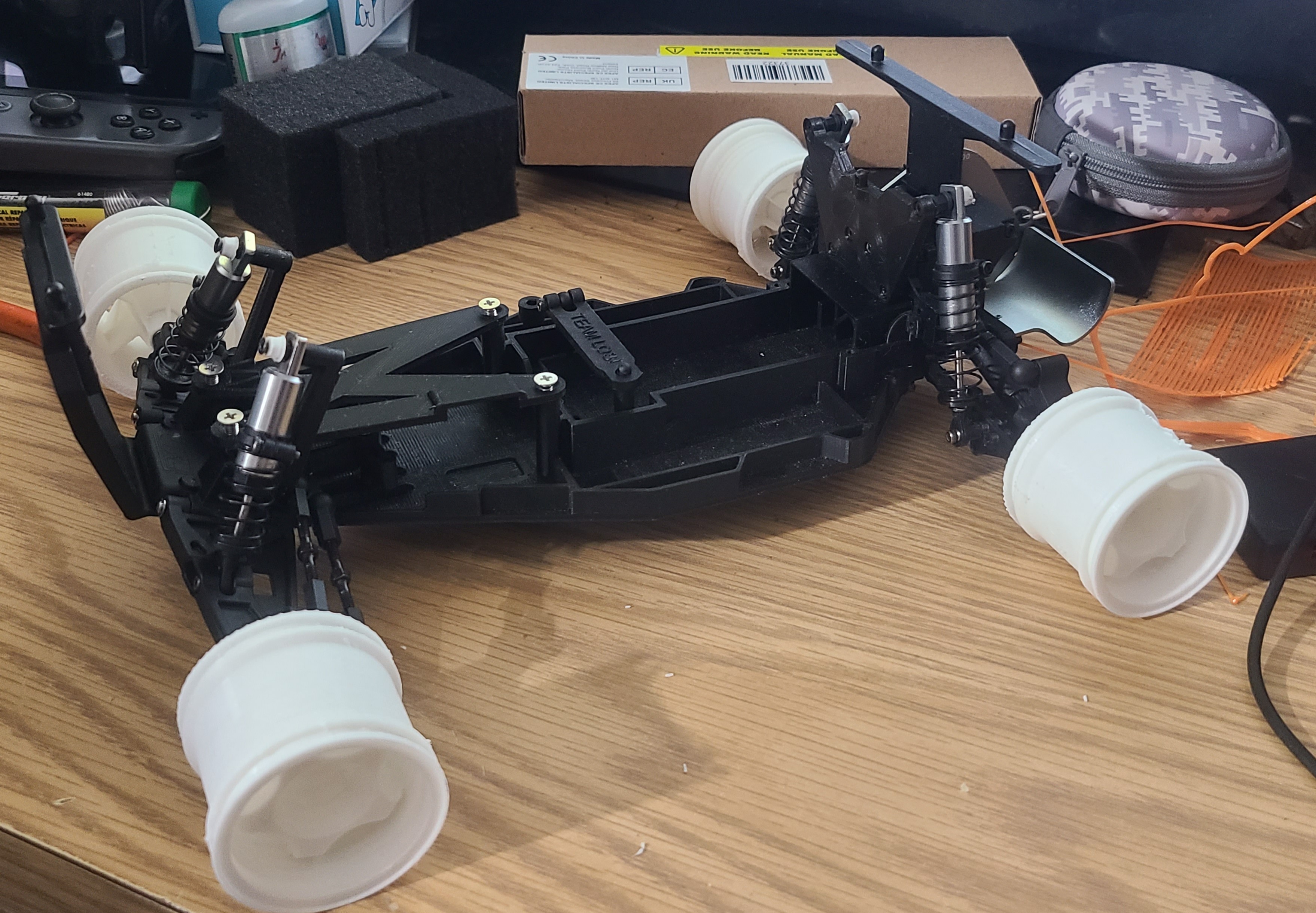

I did up a quick modeling of the long and xlong shock bodies in Tinkercad as well as a model of the long mini shock body to compare them, notice the different top profile to get more volume. The shaft is also going to be longer but should be easier to create then the bodies.
Blue is modeled off the mini shock, orange modeled off the full sized long and xlong bodies. I then scaled them to the dimensions of the mini shock to get the grey ones.

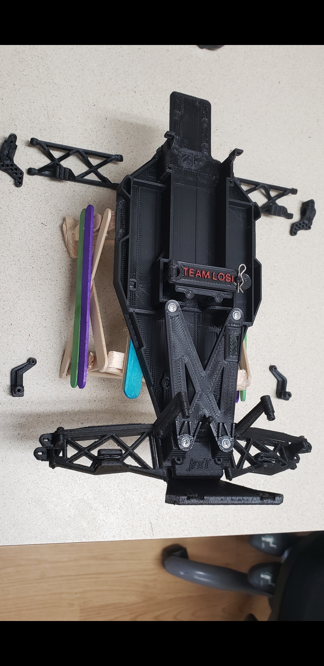

I now own 1/2500 of them... one of them is being turned into a jrx pro...
was worth it when tires are $25 a pair and backordered, chassis is $28 and backordered, shocks are $20 a pair, driveline is $24, building a transmission is on the far side of $60, and all the hardware... now I will have 3 batteries I have never charged :p

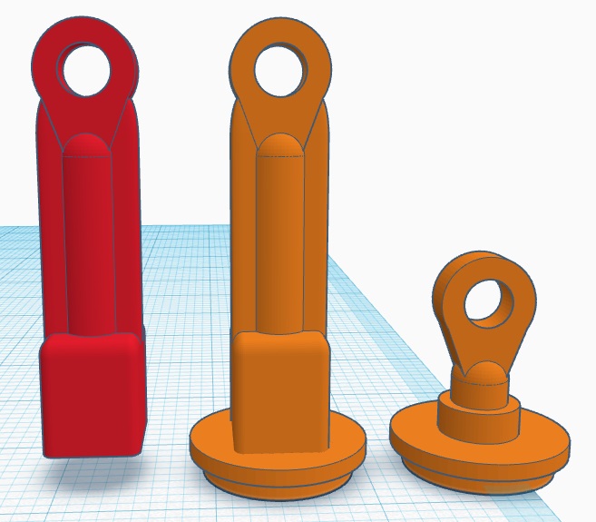

Update to the shock length dilemma, I have designed some stand-in shock rod ends that extend Losi long shocks to XL shock eye to eye length difference as calculated off of full sized Losi cars then scaled to the minis... it is surprising how much longer they need to be. I am test printing a couple experimental parts, one with integrated shock cup and one without.
edit: hmm looks like that is right for the lxt but I need to pull the shocks off the prose to measure them, they are limited differently.

Keep in mind, the shocks are scaled differently than the chassis on these cars and are actually oversized. You could easily use slightly smaller shocks and it'd look and work fine.clm wrote: ↑Sat Jul 22, 2023 5:58 am Update to the shock length dilemma, I have designed some stand-in shock rod ends that extend Losi long shocks to XL shock eye to eye length difference as calculated off of full sized Losi cars then scaled to the minis... it is surprising how much longer they need to be. I am test printing a couple experimental parts, one with integrated shock cup and one without.
My measured conversion factor was .7666 for the shock length and .6844 for the chassis.

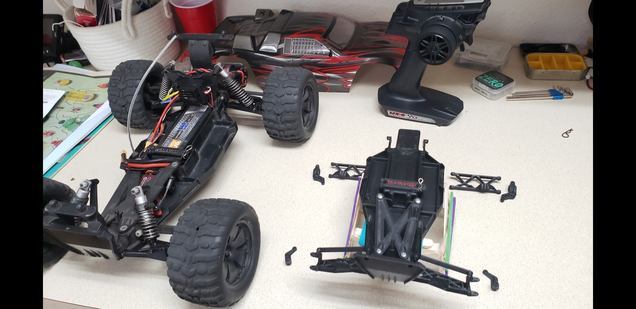

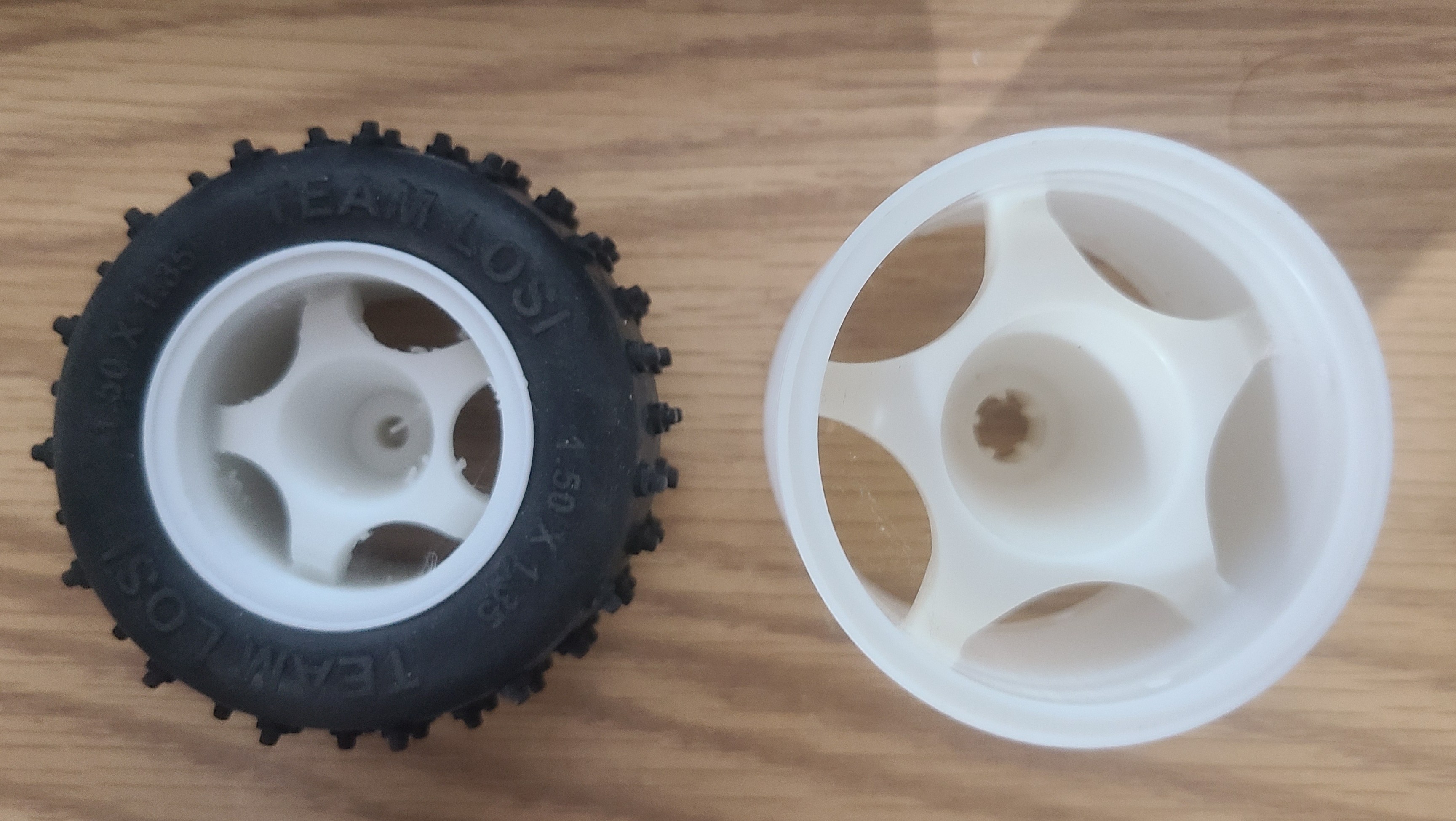

I can't help but think it looks sweet as it slowly goes together... need to print some of Rogues logo wheels for it, but I know it will print badly because the yellow is old and stringy heh

Oh my goodness, it is sized perfectly for the tire

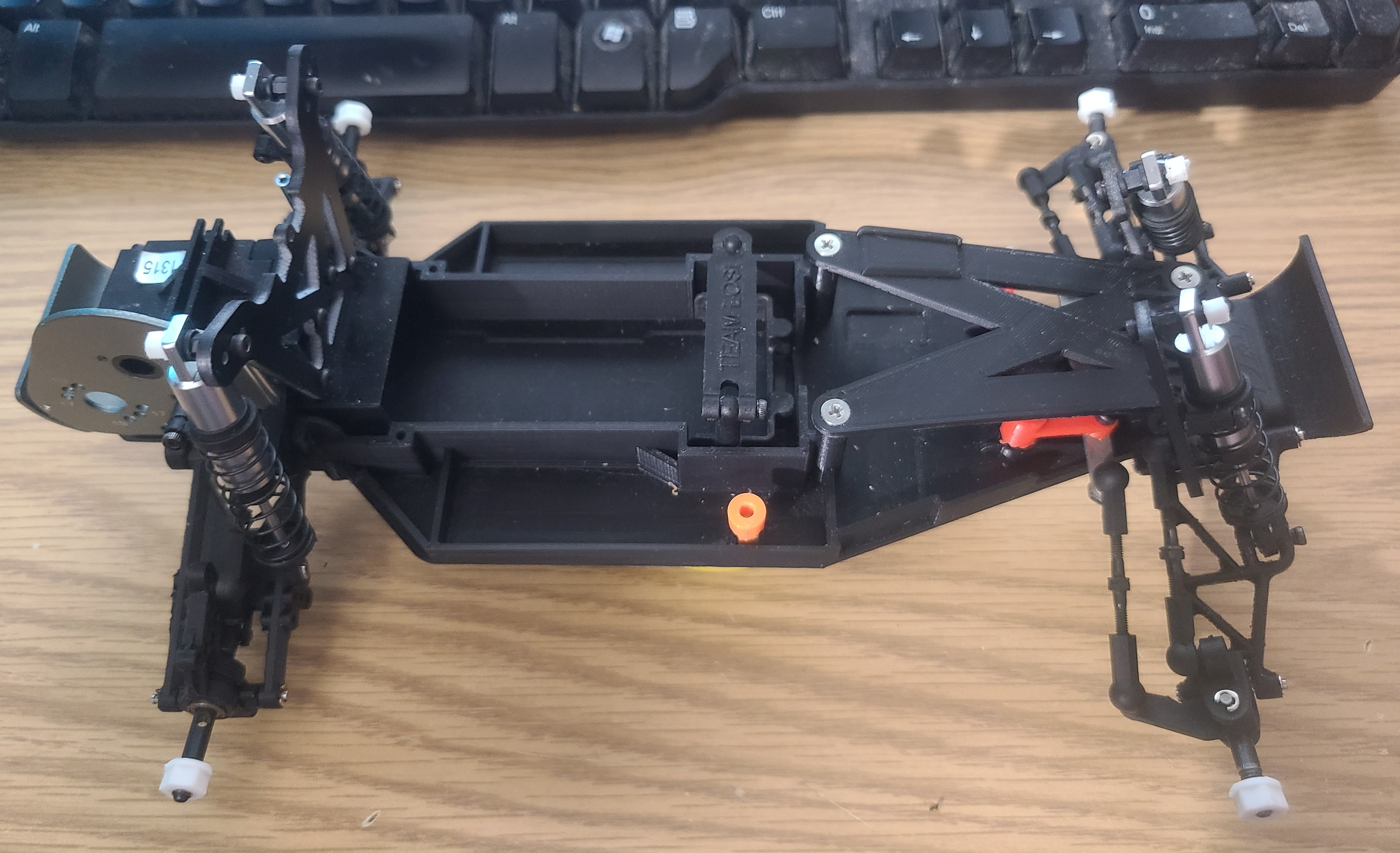

Honey, I shrunk the Junior T....

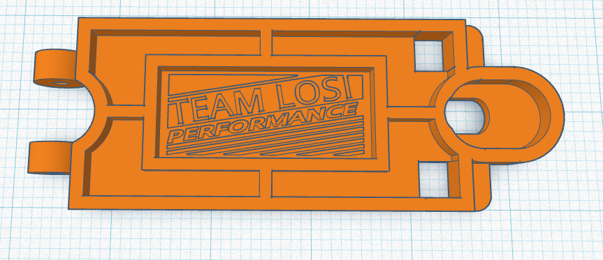

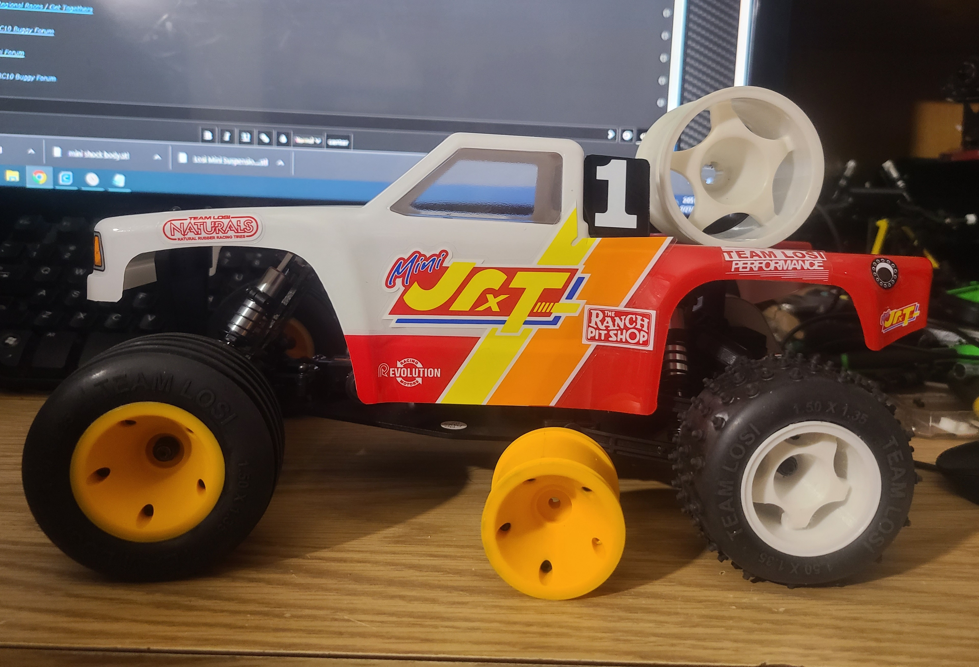

decided to try my hand at the logo on the battery cup, good luck printing it without a resin printer lol

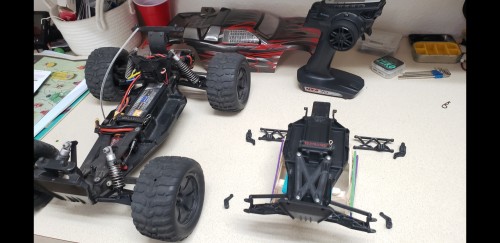

I've bent the head of mine up a bit to ease install/removal. Also if it's the buggy you don't really need the 2 side ones
