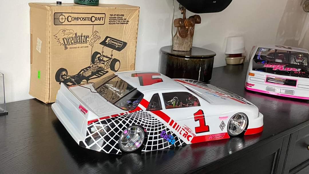

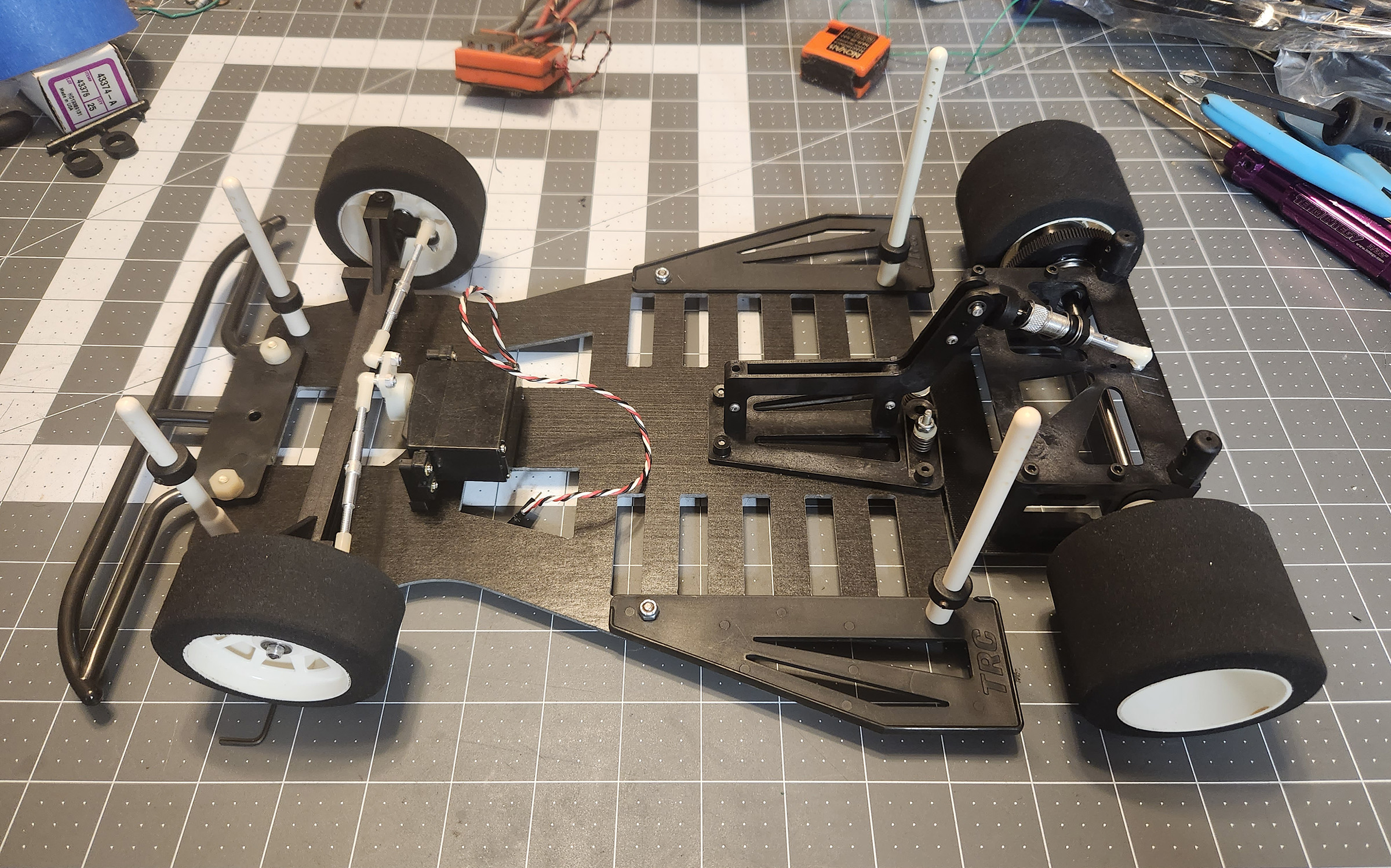

I am quarantining at the moment, so today's stay-at-home project was to put together an almost-NIB Pro 10x (non Elite). It was complete except for most of the contents of Bag 5 (rear drive shaft / diff components) were missing. Not a biggie, just gathered up some Bolink components and it is good enough.
I am thinking about taking a whack at making this a box art car, with cut vinyl making up the grid portion, and just making my own decals for majority of the rest. I was hoping that I would have a body sitting around that would work, but no such luck. So, if I have to order something, I might as well get it as close to the box body as possible.
My best guess for the body is a ~90ish, maybe 92ish, Pontiac Grand Prix Nascar body? The lower air intakes on the front kinda stick out. Bolink made (and Sabula sells) multiple versions of the "Pointer" variant of body, based on bodies from from 1988 - 1997. The '88 version lines up the best with the CC box IMO. But the issue I run into is dimensions. Most of the Bolink bodies are ~9" wide, and the rear of my car is 9.25" at the wheels and the chassis side pods. The '97 Pointer gets close to that, but the front end design is too far off.
So, anyone have recommendations for a body that would fit, preferably a Pontiac Nascar variant? I know some of the kits came with a body, but I think CC only refers to it as a Nascar body, so a bit too generic. I also haven't seen, what I know to be, a body that came with the kit, so I can't confirm how much of the front design details actually match the box body.

Pro Fess on Facebook posted up his a while back, he used a Parma Lebaron body. With Parma coming back under Mid American slot car you might be able to get this body if you like it

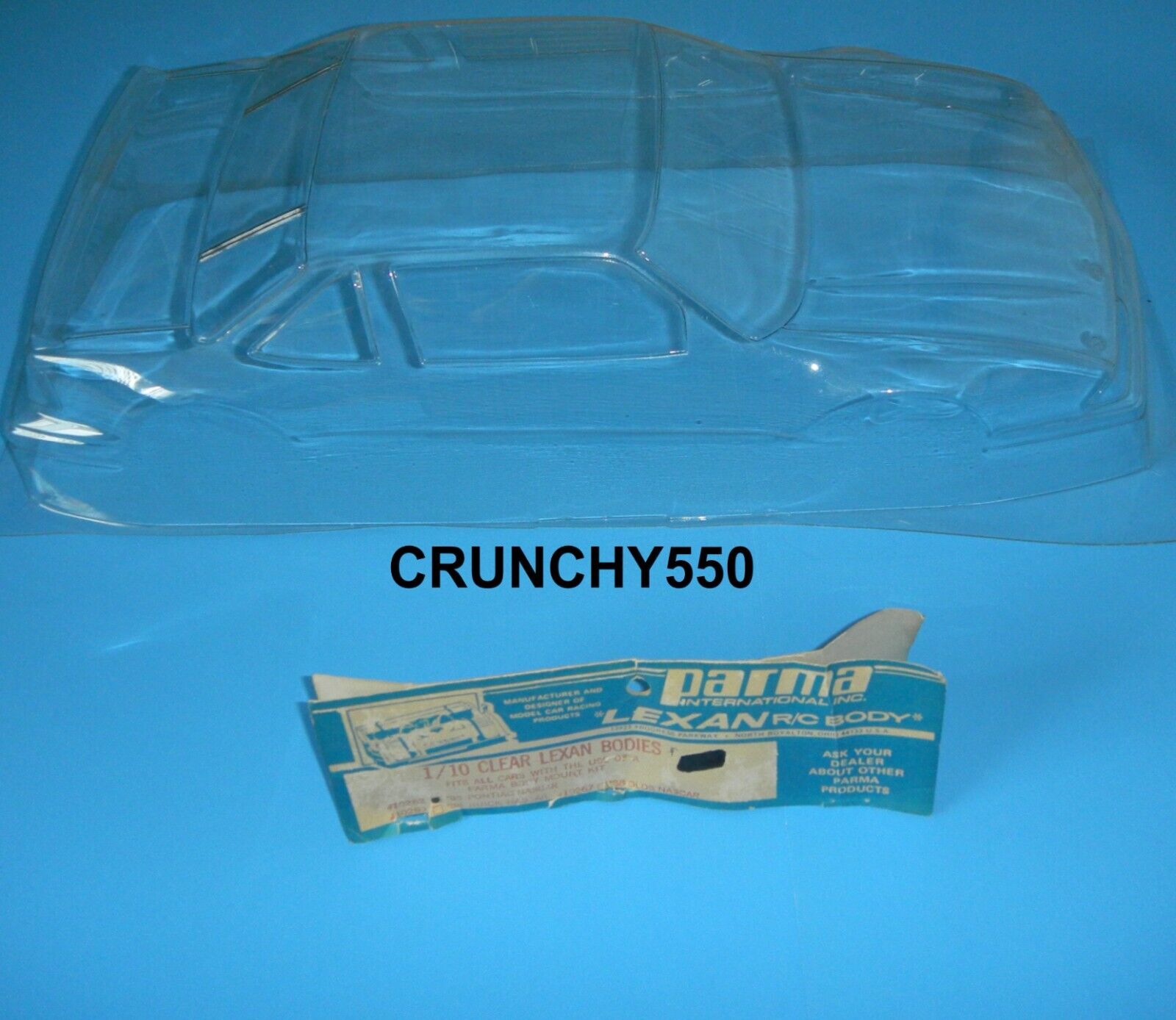

Thanks Jeff! I had seen that car on another platform, and I really do like it! I did not know the body was a Parma, so I will look into that more. I did find that Parma also had a '88 Pontiac, but I haven't dug deep enough into dimensions yet. The hood on the Pontiac also has lines / curves to it, which may not be so awesome with the grid. That Lebaron hood is just a flat canvas, so would be much easier to work with. There probably isn't a perfect body out there, so may have to decide where to start compromising.
Parma Pontiac '88 body. Photo stolen from Crunchy550.

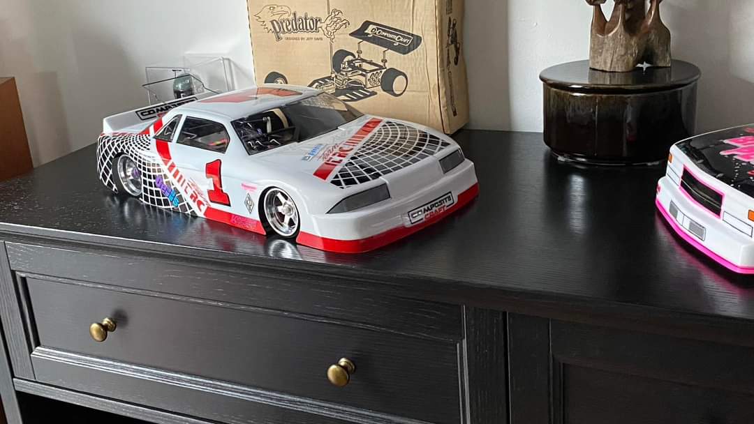

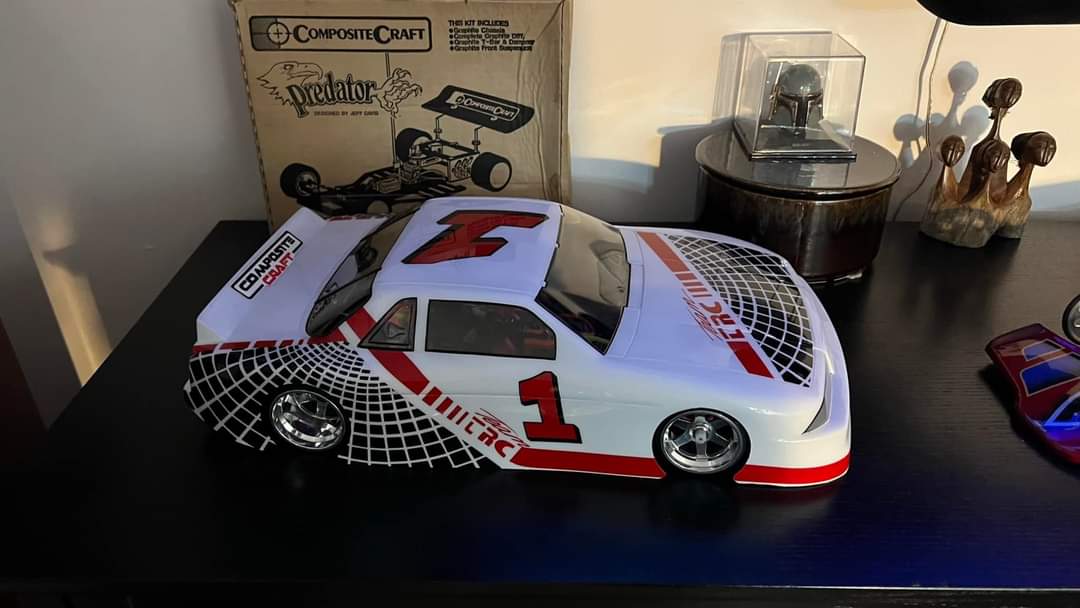

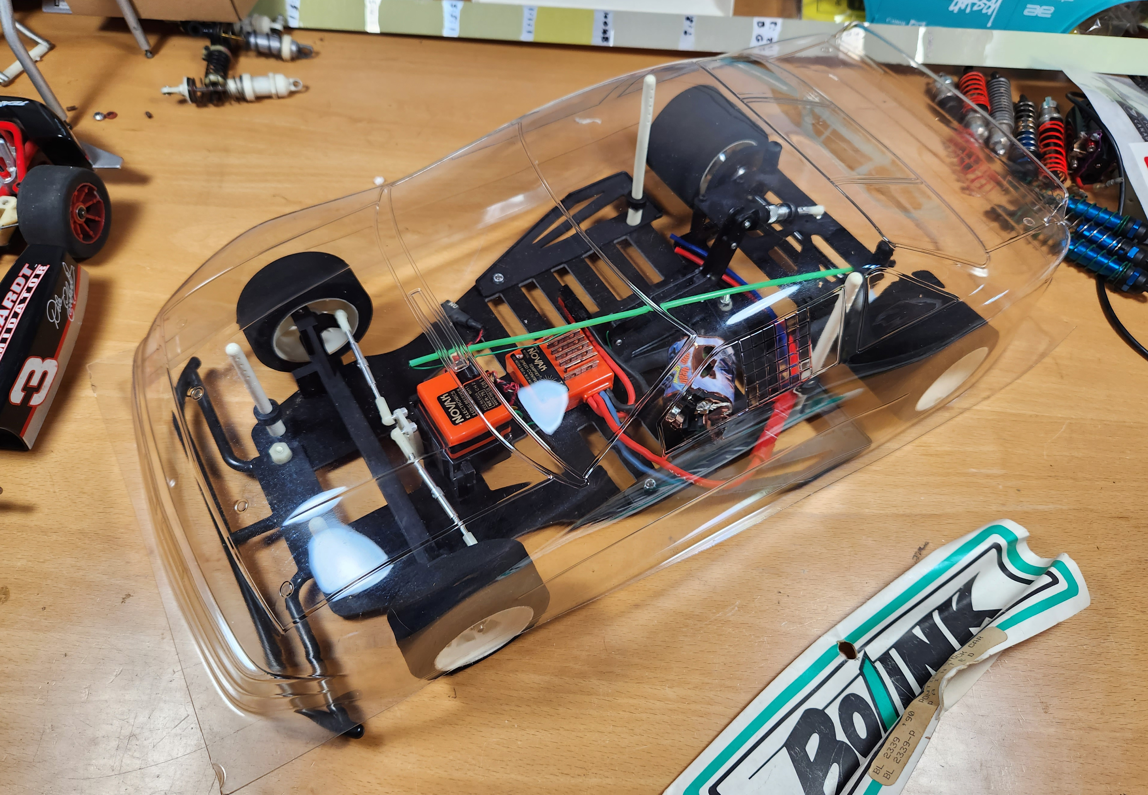

Went to go see my hobby shop guy this morning, and as usual, he had the goods. A Bolink 2339 '90 Pontiac looks like it is going to fit like a champ! May have to work on the location of the rear body posts a bit. There is even a decal set for this body on ebay. Now I have to get to work on the custom graphics, and I am not a graphics guy at all!

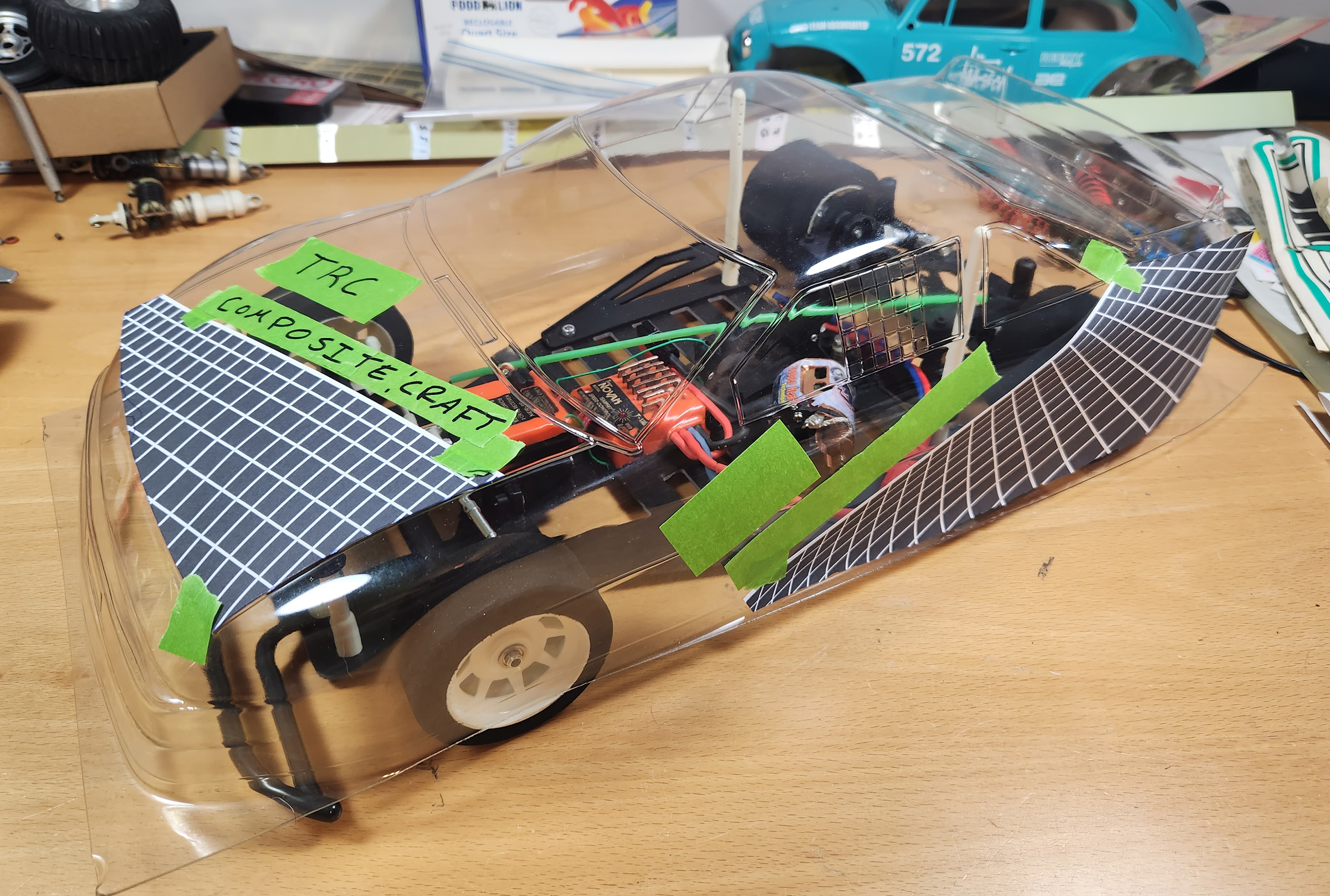

Started playing around with the grid patterns today, and got them close enough I think. The box art car is way out of whack in regards to proportions, so just have to use it as a reference.
