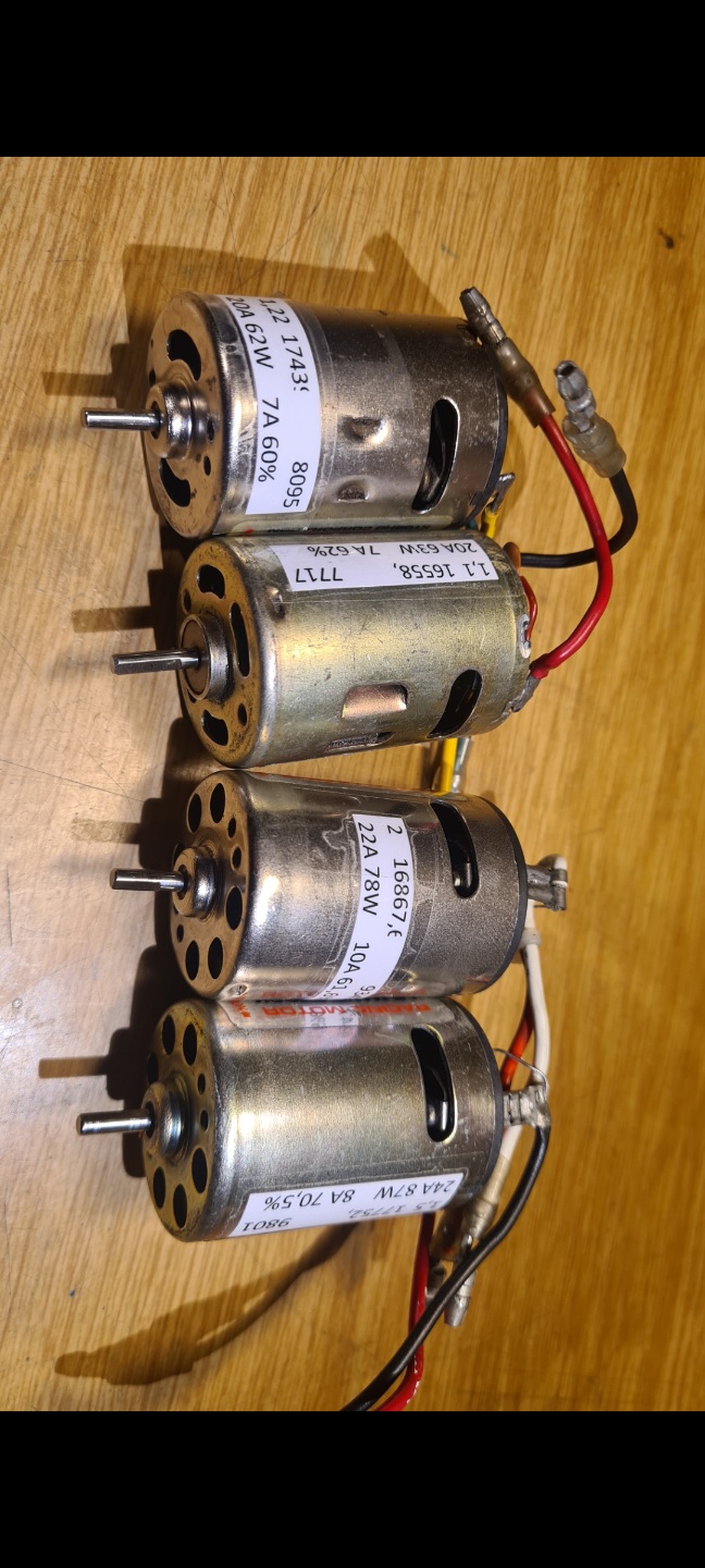

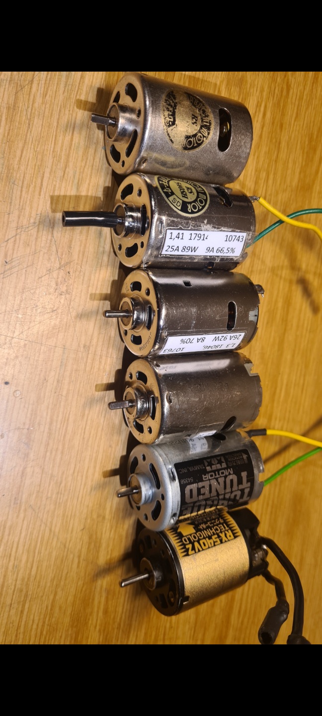

Measured a bunch of my 540 class “silvercan” motors to see which one performs best in case of efficiency, wattage, revolutions under load... not all of them are brandnew, but the data helps me to select for some vintage-projekts so I just want to share this, perhaps somebody is interested..
Similar to Tamiya also the Kyosho Le Mans Stock 05 ones have severaI designs. Don´t remember exactly which one came with what kit, the “6hole” ones seem to be the strongest. Perhaps someone got a timeline (or a further version)?
For comparison tested two motors before, a Tamiya Technigold and (Mabuchi) Torque Tuned.
Conclusion (for me): No load speed is irrelevant for comparism.
Johnson´s have a bit more output than the Mabuchi´s, the 6 hole LeMans are in-between.
