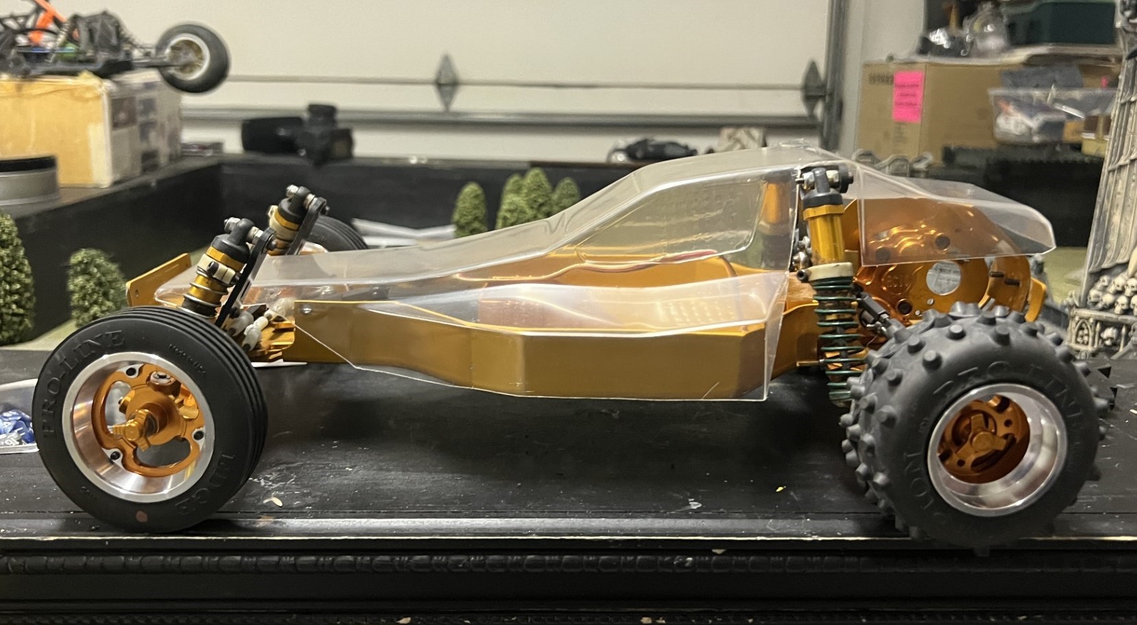

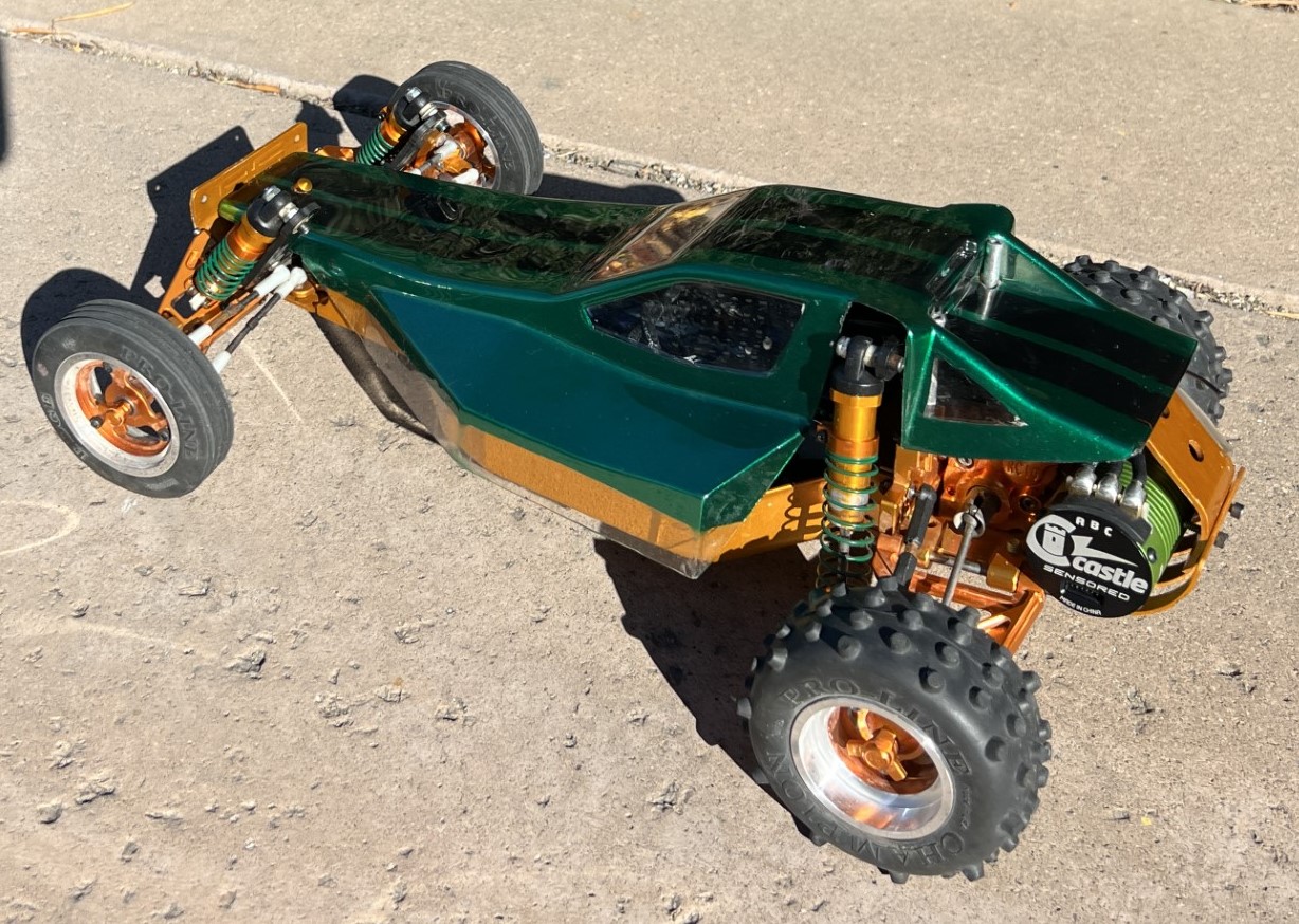

I just restored my RC10 Championship Edition (B Stamp) that has not run since the early 90's
I swapped out most of the parts with matching aluminum, and still have the original parts (some broken)
I did a simple paint job to show off the gold pan.
I thought I would share with this community.

Welcome. Are the aluminum parts Dhawk? How do you like them? Good fits everywhere? Any plans to add the nose tubes?

Thanks,
Yeah, I used the Dhawk and on my first attempt I struggled with the dog bones... but eventually got it to all fit and work.
I had issues with the nose tubes… I have them, but they are bent, torn, and I seem to have better luck running without.
Also, I was worried about the weight at first, but with the brushless motor and a big battery, it’s really, really fast.
I think the turnbuckles are now the weakest link.
Oh and I think the aluminum wheels might night be as strong as plastic… there gunna bend… but they look cool 😊

You've got the rear arm mounts on the wrong sides. FYI.

What a beauty! Green and gold always go well together. I love the gold arms to match the chassis.
