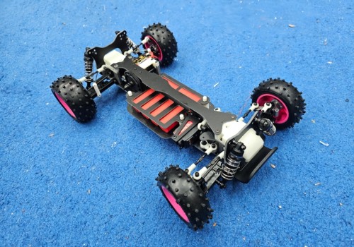

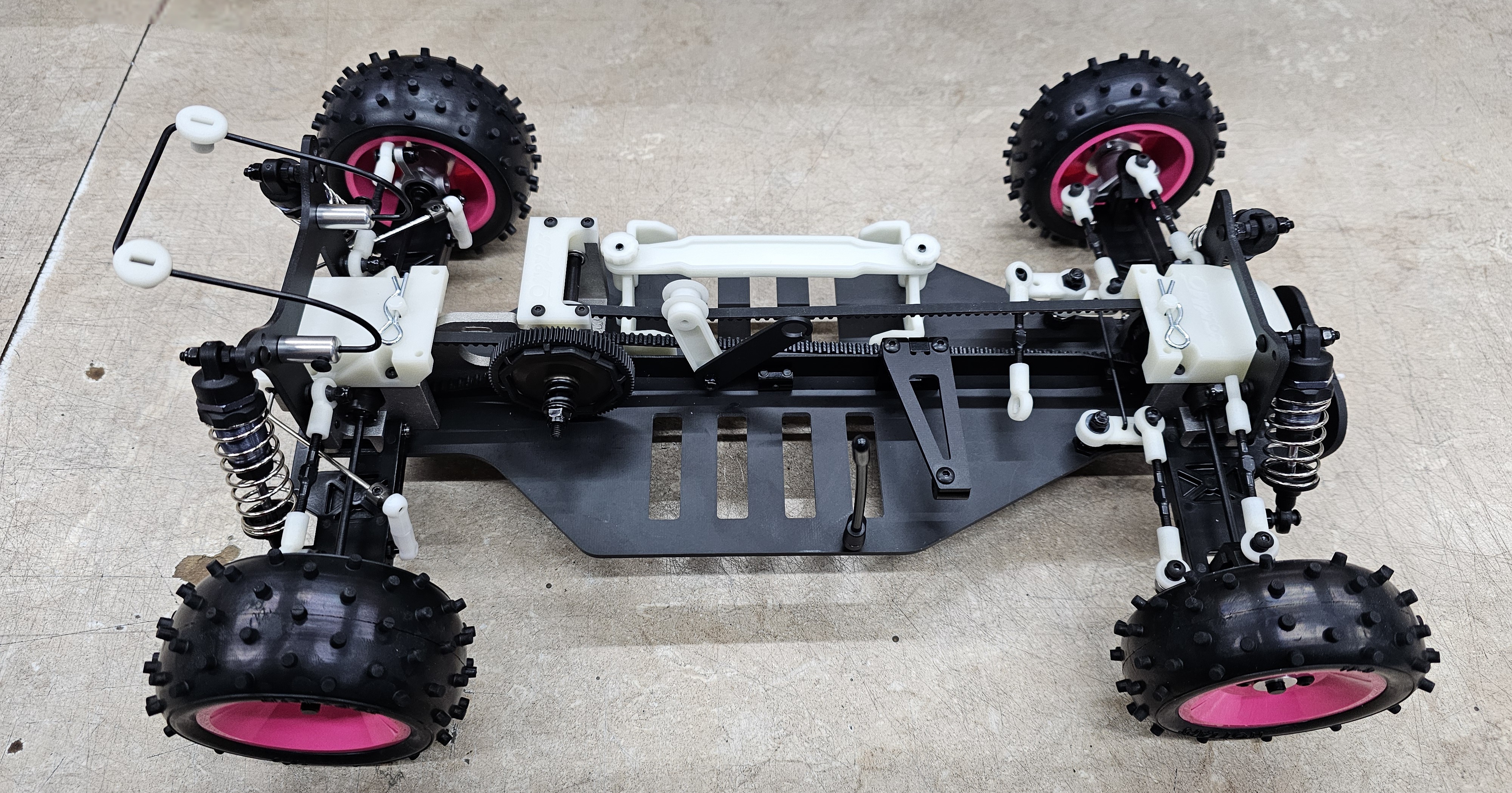

Wow what a great build. Nothing too tight or too loose. Everything there, although at times I was thinking man an extra eclip or screw here and there wouldn't hurt haha. The spine is very weak, 1mm thick g10 and flexes like crazy. First thing on the drawing board will be an upper brace. They used yr4 style covers so no drilling needed to add a brace. Highly recommend the build, but I can't wait to see what we come up with for it. I'm thinking my first will be the 89 Masami chassis.
I will say, not much is compatible with original as far as chassis and layout. The towers are taller, the chassis narrower, the bulkheads completely different in mounting, motor mount is shifted, etc. LOTS of changes.

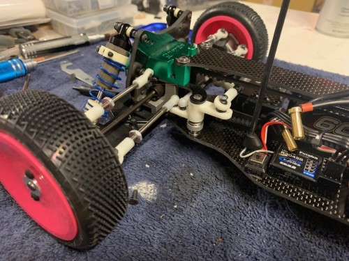

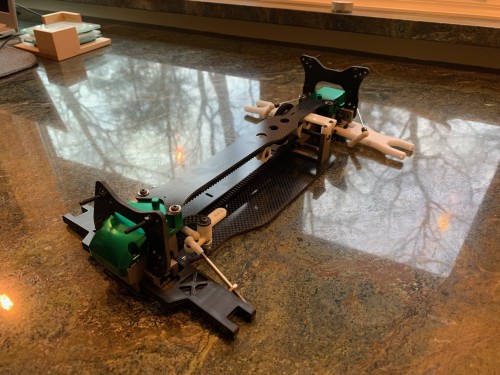

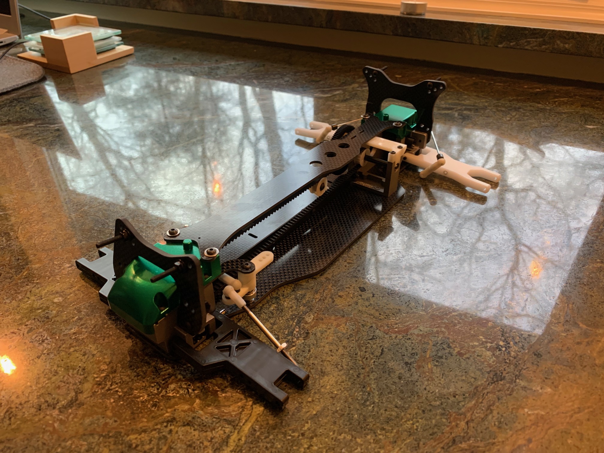

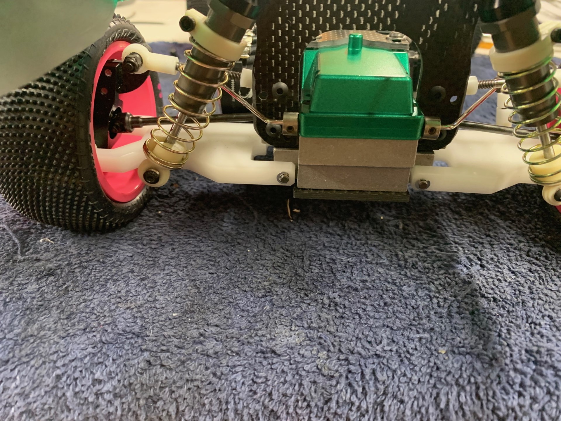

Chipping away at mine
I have a 89 worlds conversion kit that I got from Fan RC that I am using on it, most of it fits after I re-drilled the chassis using the new one as a template. if you go this route make sure you have a dremel tool! it isn't pretty but who cares since this car has undertray
the dogbone length is funky, normally the kit uses the 422 length which is too long for the re-re diffs so I ordered a set of 421s.

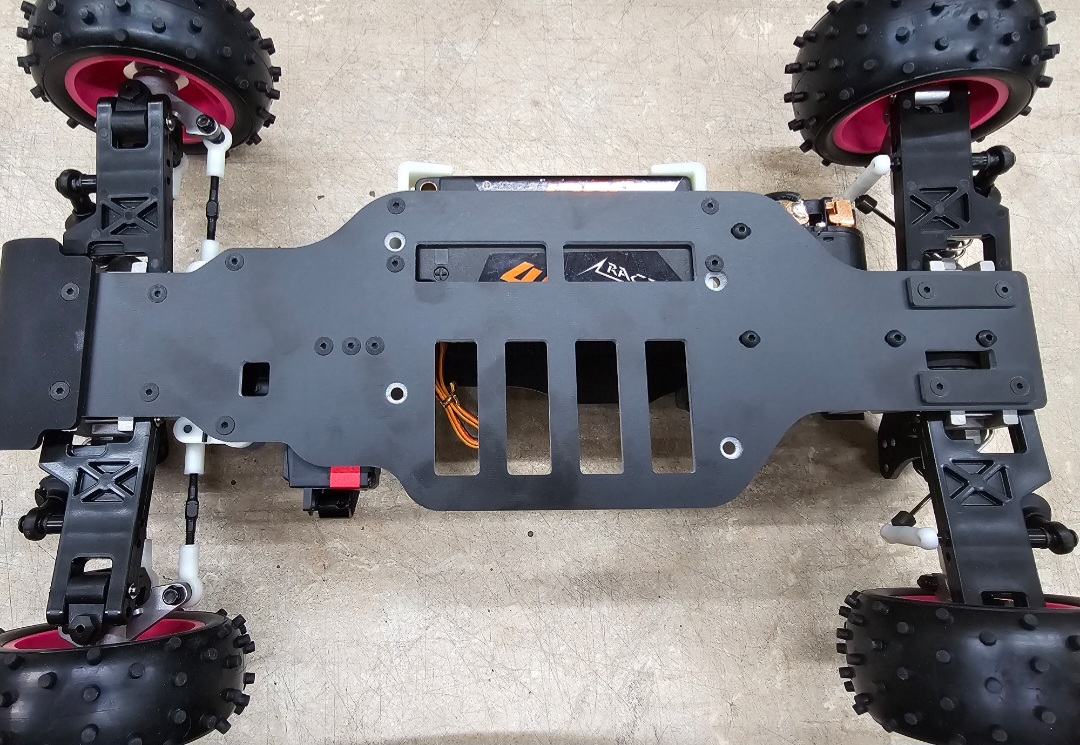

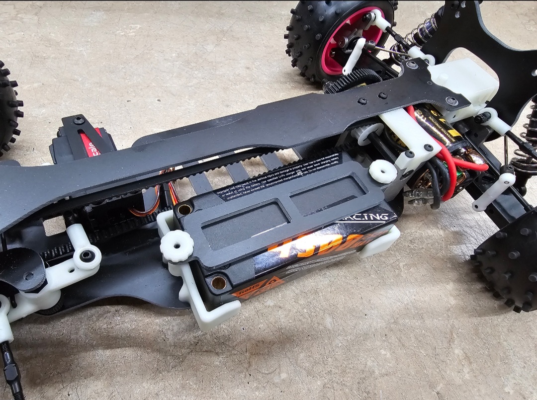

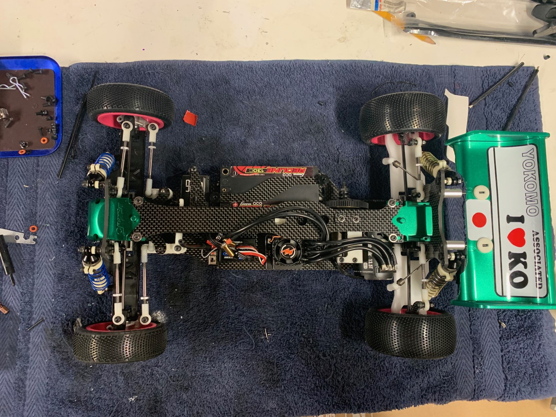

Here is mine with our 89 Masami conversion added. Not a lot of room with old school cells for sure. Tried adding the lipo to the other side but just not enough room even with the shorty servo. Ended up leaving it in the stock rere location.

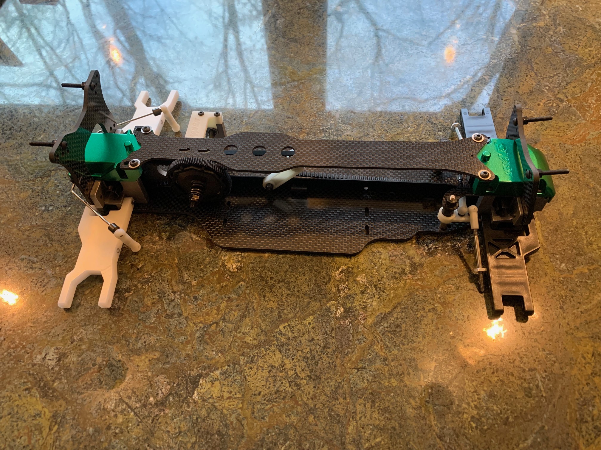

Mine is almost done, just have to finish the body.
