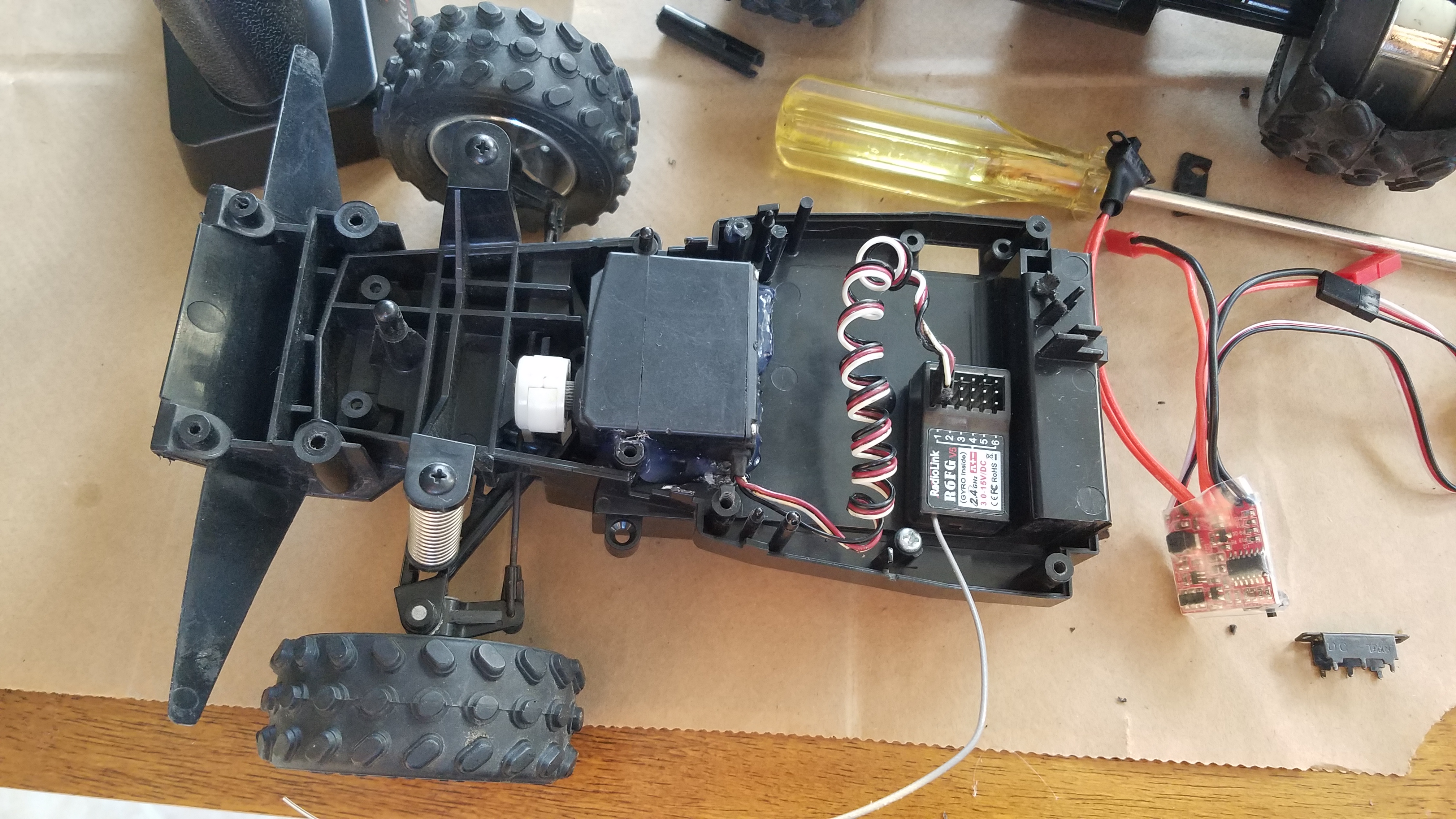

I've had this Tyco Bandit on my garage wall for something like 2 years. I randomlly decided to do something with it today. The goals for this build are: $30 total investment, and 3 hours or less of work to get it moving under it's own power.
Total Spent - $24.15
Time - 0:00
The first step is disassembly. I got margainally further than the pic shows, but I'm not messing with the front suspension. It works fine. This cost nothing but took 11 minutes and 51 seconds.

Like most things in my life, I haven't even started the timer and I've already spent most of my money. The car was $9.99 from goodwill. The esc was $3.25 and the R6FG reciever was $10.91. Both from Aliexpress. On hindsight, I probably could have saved a few bucks by getting an R6F reciever (no gyro), but it a little late for that.Total Spent - $24.15

Then soldered it all together and tested it again. Realized that it cuts power too the motor when quickly applying the brakes from full throttle. I cant say its suprising, considering the esc was $3, but I've used them before and never had issues. Any idea what could be causing this?

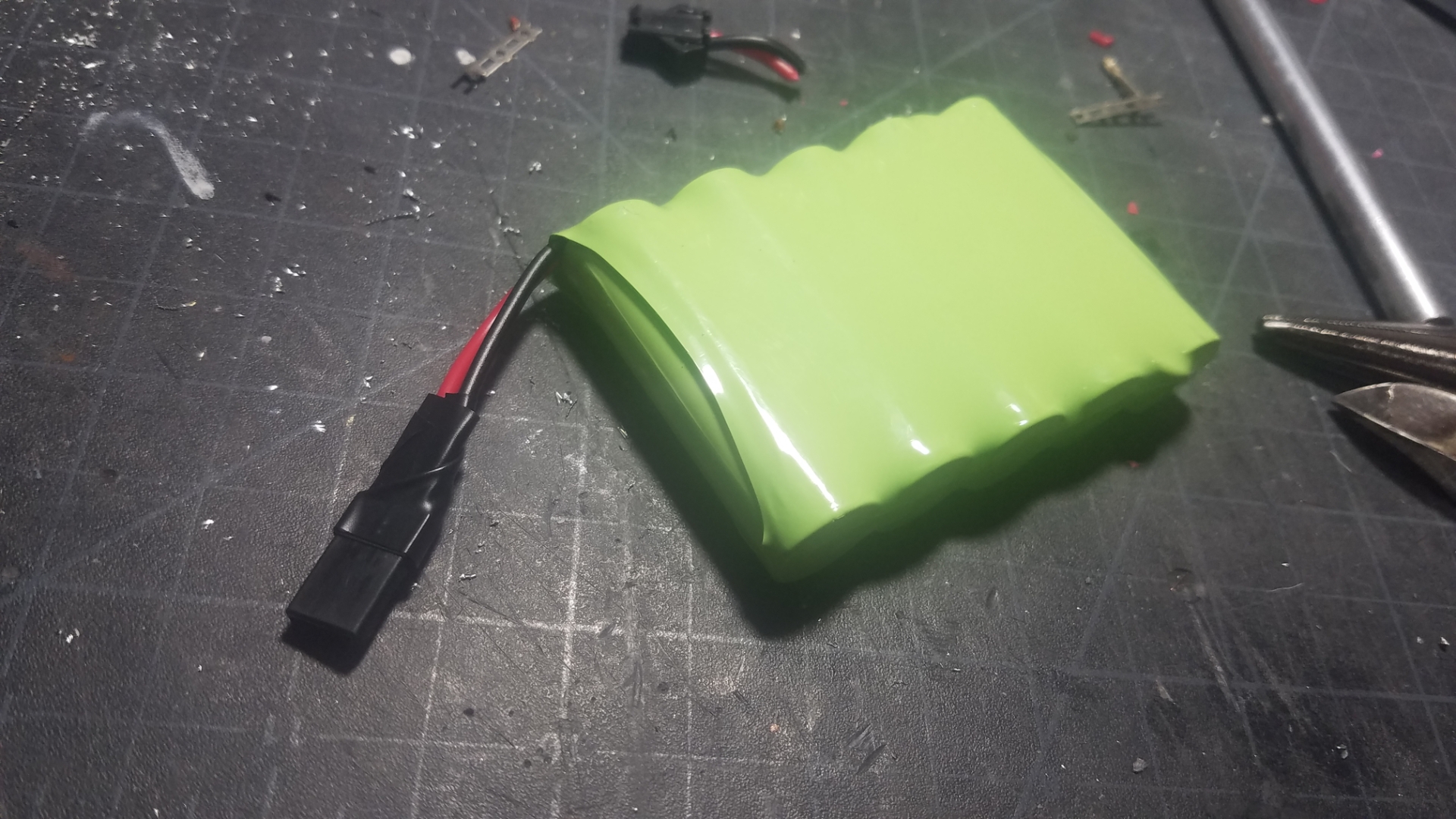

Took a few minutes to swap connectors on this random 6.0v 800mah I had. This battery gave it much more go, but significantly cut down on run time. It also seemed to minimize the power cut issue a bit? Not sure how that makes sense.

ZED32 wrote: ↑Sat Feb 24, 2024 3:31 am Then soldered it all together and tested it again. Realized that it cuts power too the motor when quickly applying the brakes from full throttle. I cant say its suprising, considering the esc was $3, but I've used them before and never had issues. Any idea what could be causing this?
Sounds like a "brown out", from a weak BEC.
