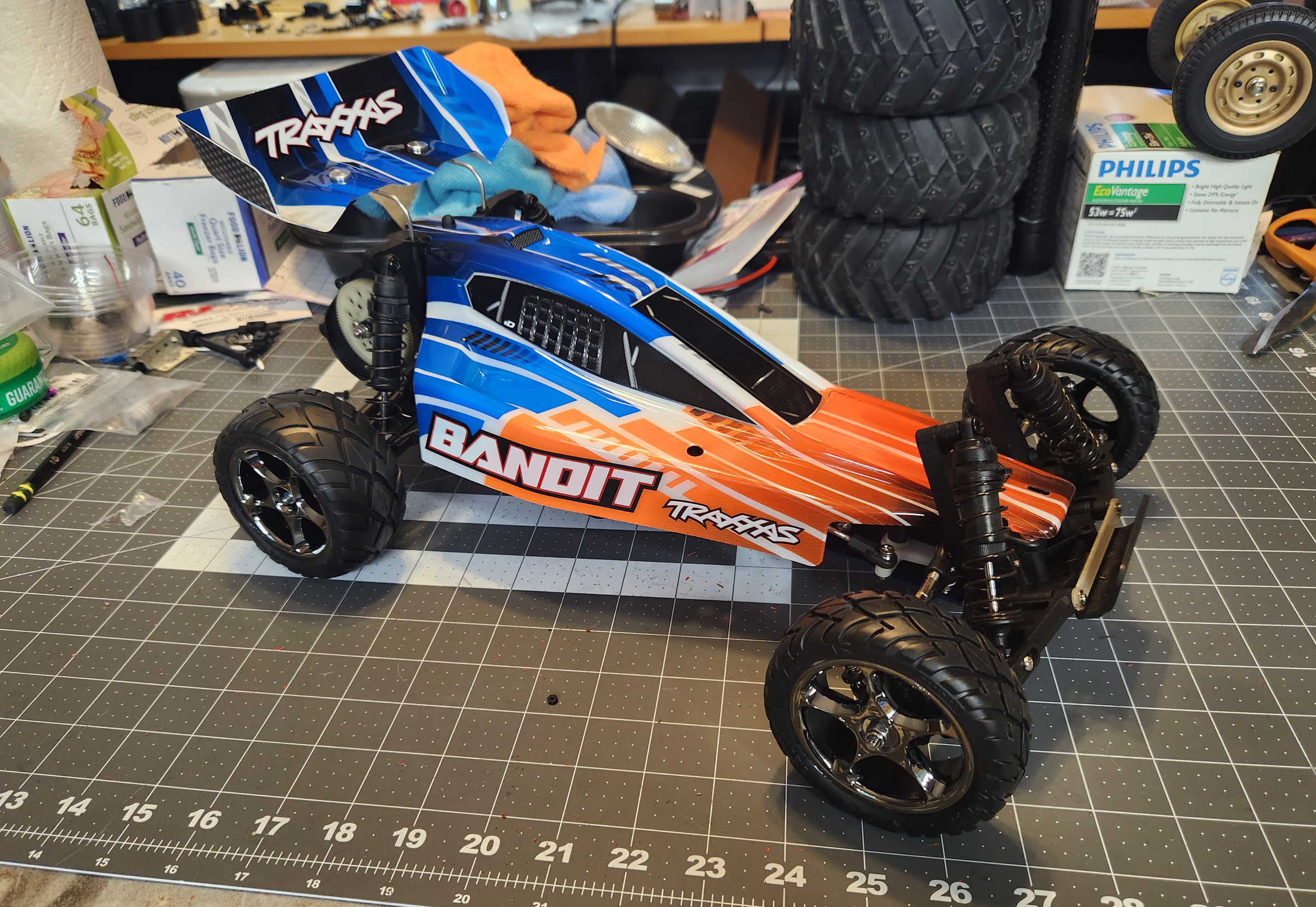

Took the B6 body to the LHS to test fit on a Bandit, and it did not fit. I don't know how MXAcres was able to get one to fit on his. Looks like I'm getting a new body for it then, which is fine. Make rear cab great again. I was around when the transition to forward cab became all the rage with the Proline Bulldog, and now I'm sick of seeing them. It's kind of endearing to see a rear cab on the track, especially one with a big TRAXXAS sticker on the side.
