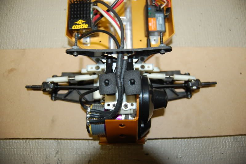

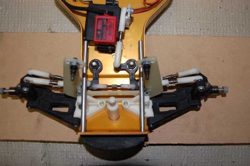

Joey, start by showing a pic of your car's front end from the top-so I can see the steering geometry for bump steer etc, then what caster settings and caster blocks are you running?
and are you sure that your ball cups are very free and will rock back and forth with a fingertip?
Assuming all other things are correct such as free arms, camber links and drivetrain here is where I started my car at on a really high bite track-
(F) 37.5w, #1 pistons, 4 internal limiters, brown springs with RPM lower cups and the upper inside shock mount on an Atlas tower and outer mount on the arm. 25 deg caster blocks- 1deg camber and +1deg toe in 2 bumpsteer spacers on the steering arm and 1 on the bellcrank.

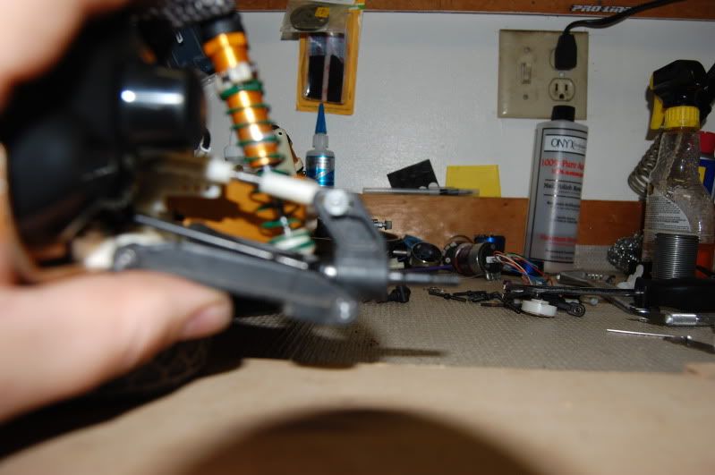

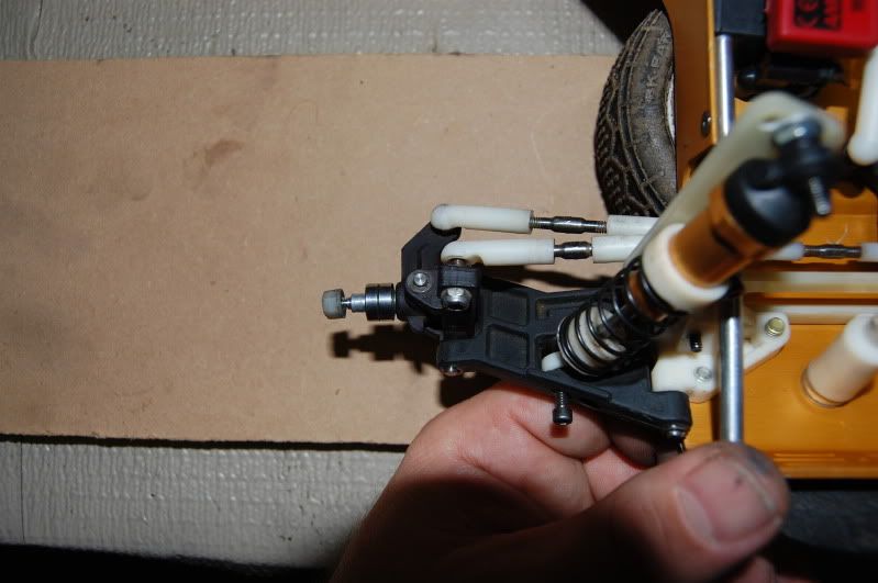

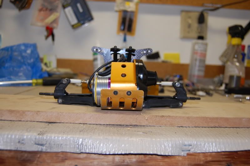

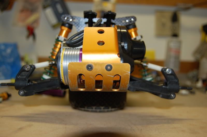

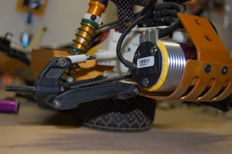

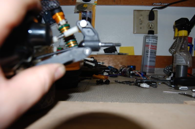

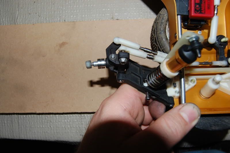

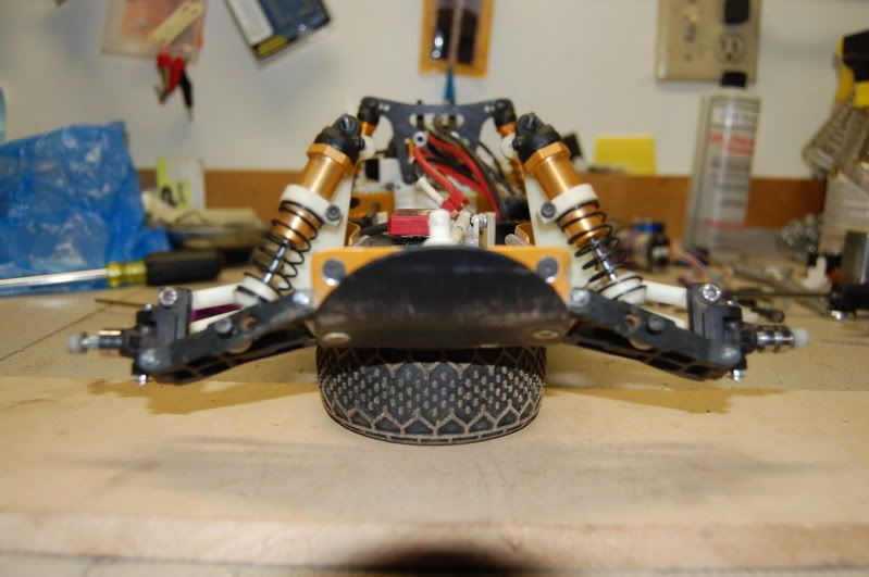

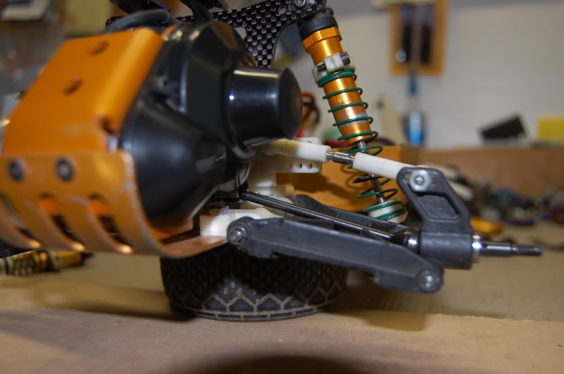

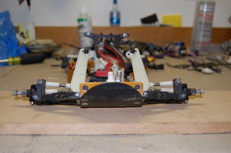

Im convinced its a droop issue.
All suspension arms fall under their own weight, no binding
rear:
rear droop:
front (25 degree castor blocks):
with droop:
--Joey --

bump steer, toe in at top of travel, maybe 1/8 inch or 5-10 degrees (guess)
rear camber gain appear to be almost zero
--Joey --

JK Racing
Posts: 4618
Location: Placentia, CA
Has thanked: 131 times
Been thanked: 243 times
Re: Handling questions - CE indoor high bite clay
Post by JK Racing »
(pardon the VERY messy bench :oops: :oops: )
