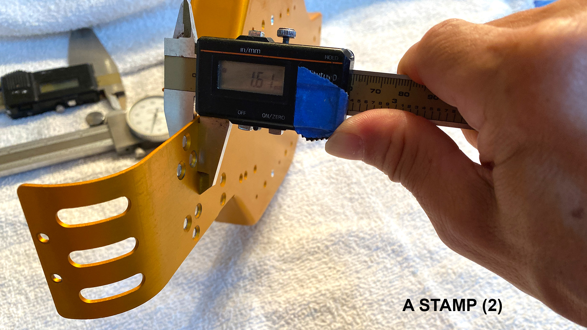

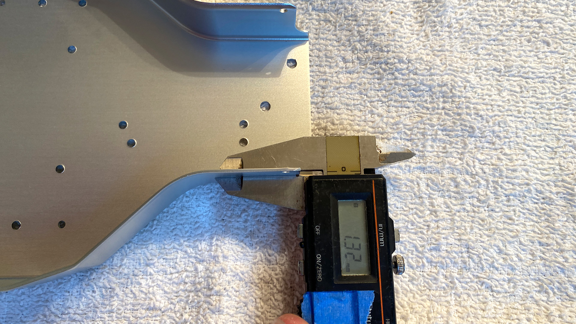

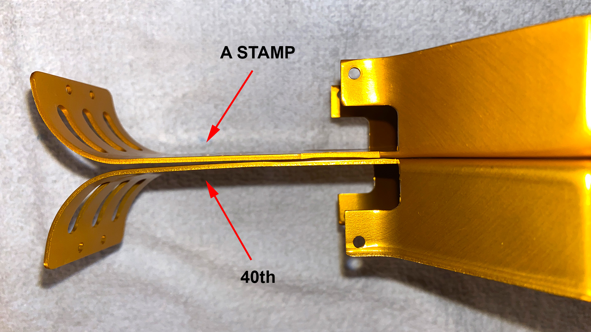

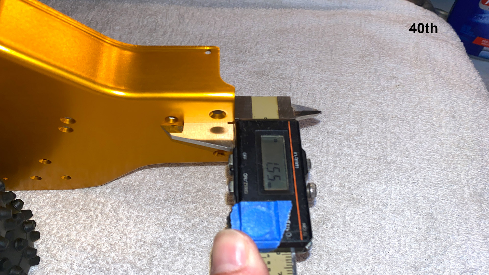

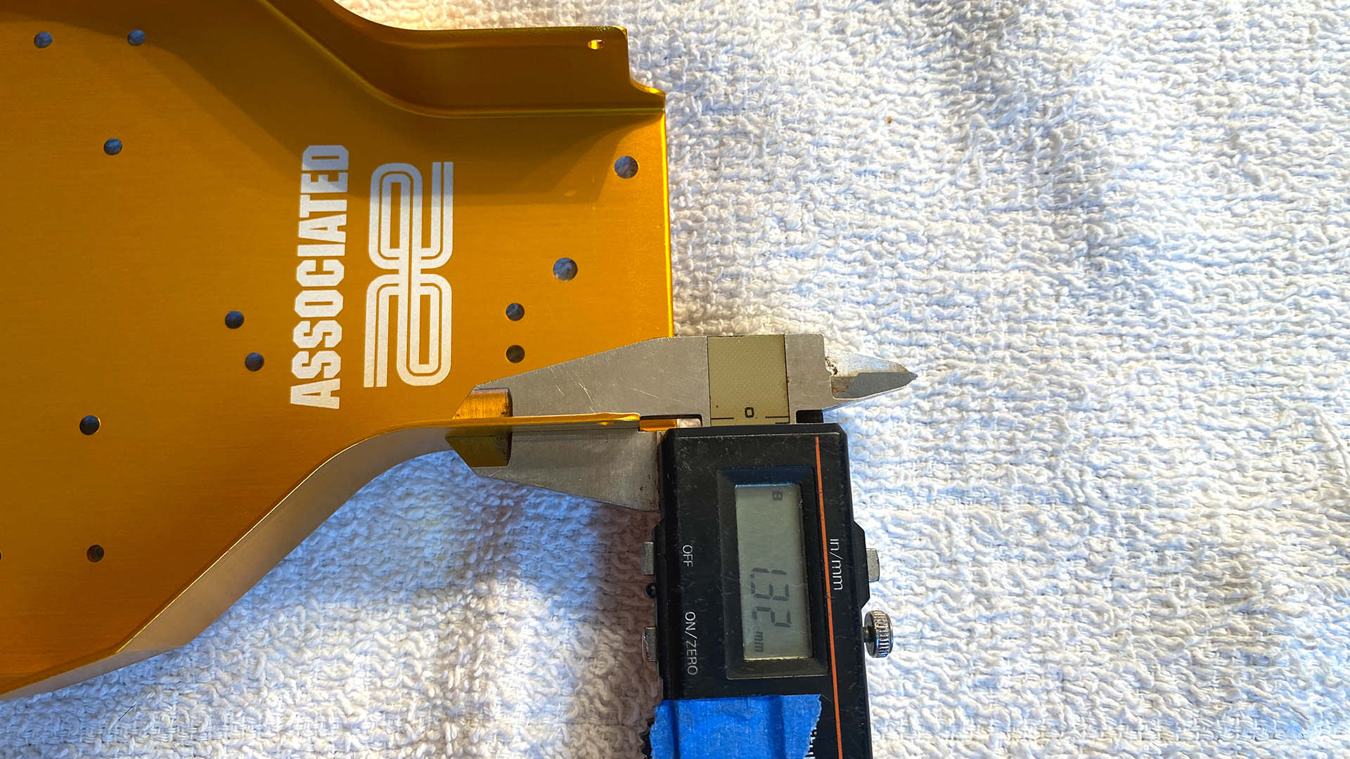

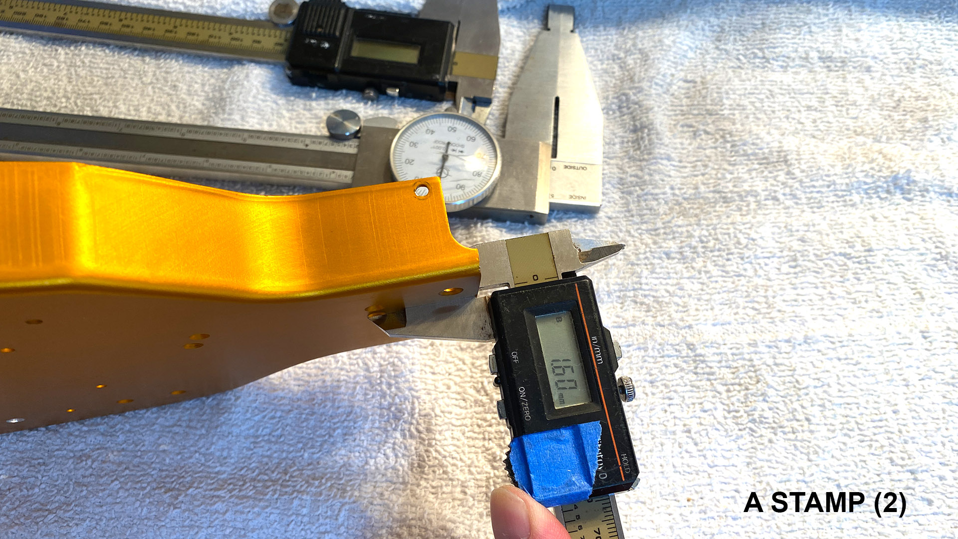

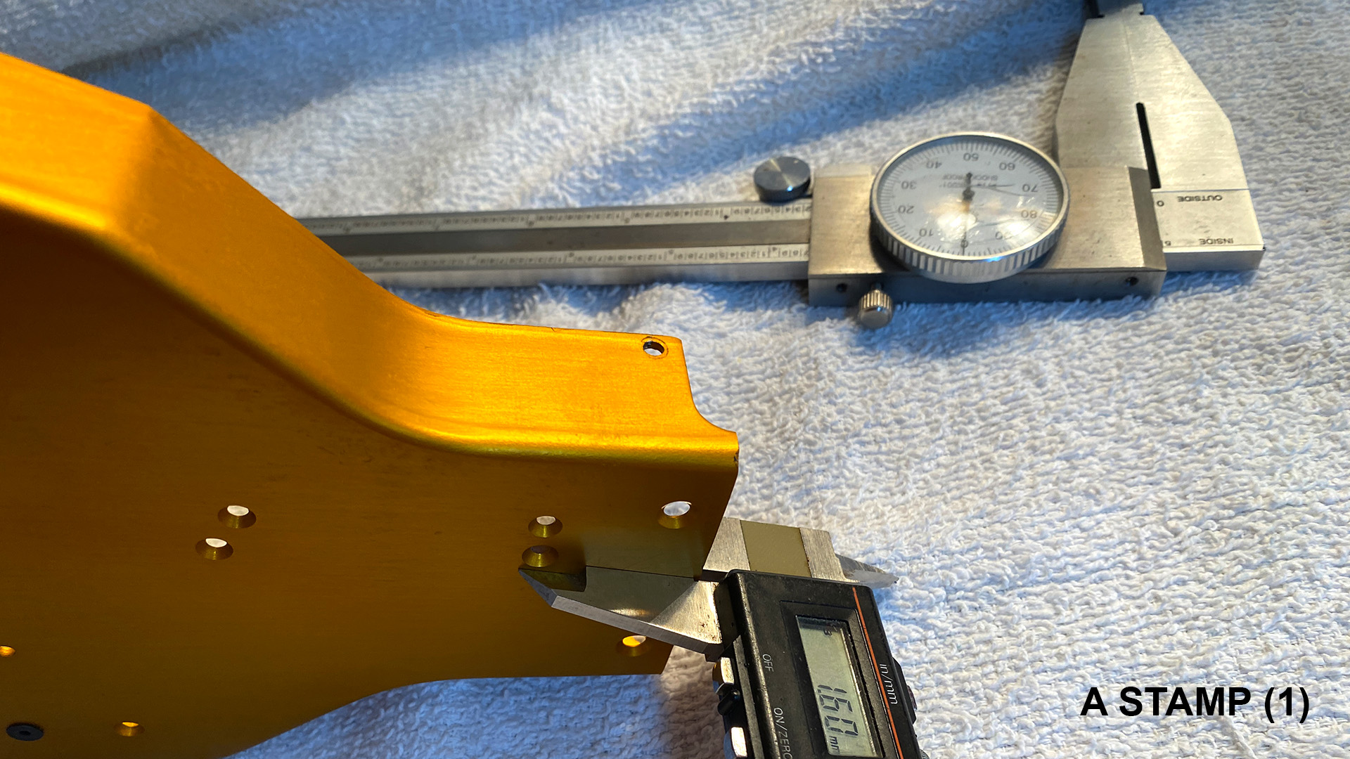

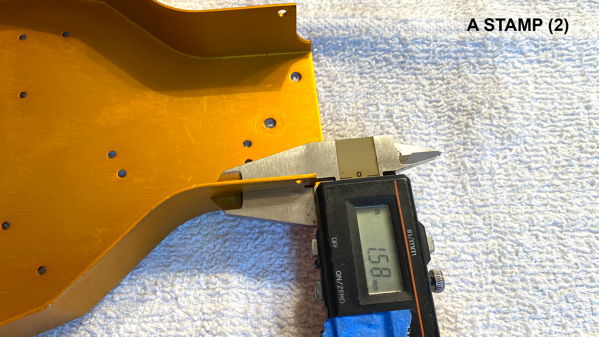

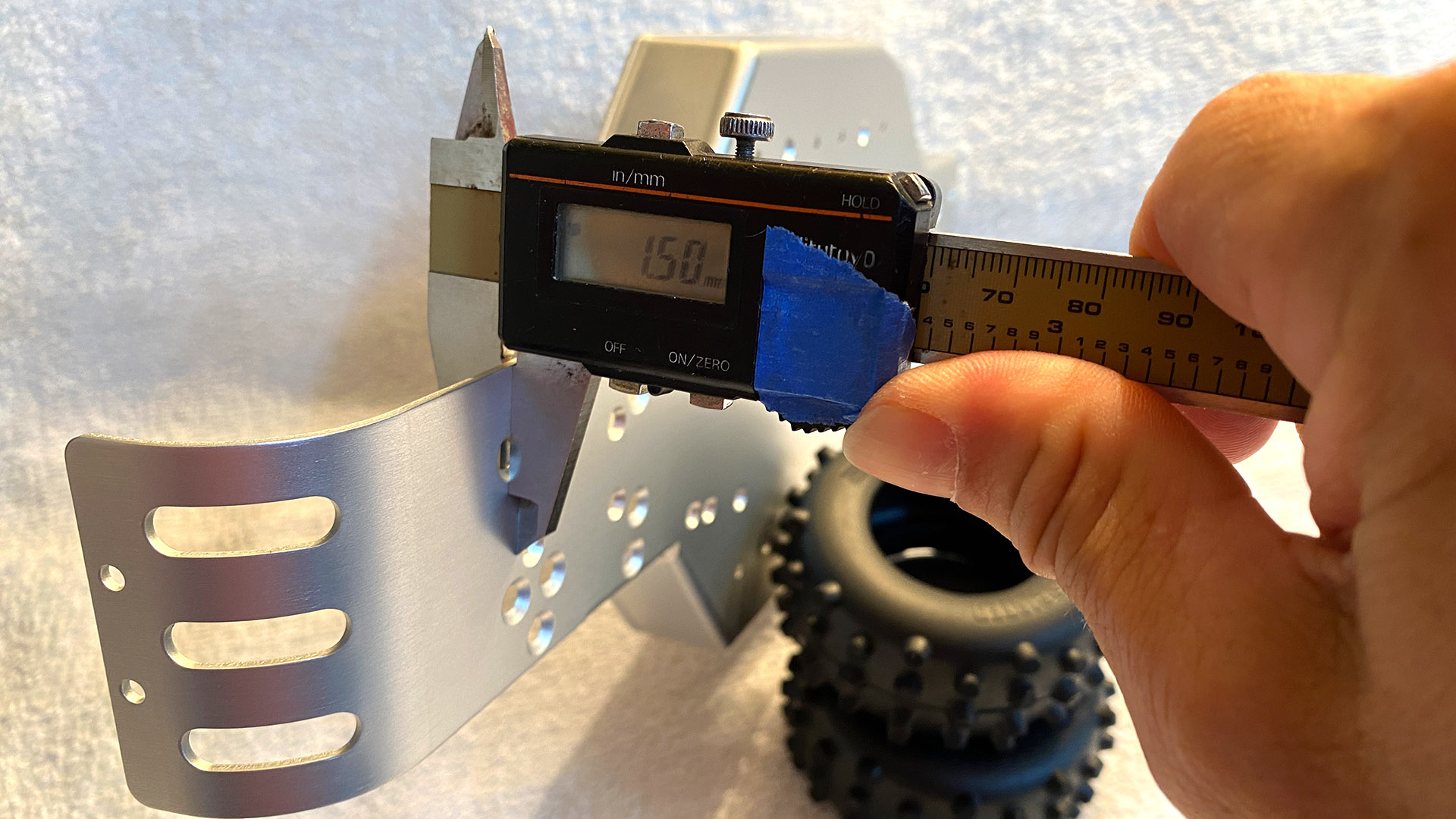

Nice! I'll add my measurements here. Maybe others can add as well. I did find a variation between the old and the new. The original is 6061-T6 aluminum, likely 14 gauge or at worst 16 gauge. I found a differnce in thickness, weight, and ring resonance (stiffness).
Gold A Stamp # 1
Thickess: 1.60/1.62/1.62. Average 1.61mm.
Weight: 172.82g
Resonance: 620Hz (also rings out longer)
Gold A Stamp # 2
Thickness: 1.60/1.61/1.58. Average 1.60mm.
Weight: 171.58 g
Gold 40th
Thickness: 1.55 / 1.54 / 1.32. Average 1.55mm (1.47mm incl. 3rd measurement).
Weight: 159.55g
Resonance: 580Hz
RC10CC
Thickness: 1.50 / 1.48 / 1.32. Average 1.49mm (1.45mm incl. 3rd measurement).
Weight: 154.70g
Resonance: 550Hz
I note the average thickness with and w/o the 3rd measurement as that edge is formed and could be distorted. Also I noted the smallest measurements I could get for the A stamp chassis just to make sure I wasn't measuring a thicker area
Here is a link to the video showing all this...
https://youtu.be/mowc6K13L7Y
So, my vintage chassis are slightly thicker, definitely stiffer, and weigh more than the 40th and CC. It could just be the four that I have, but maybe others can add more data.
