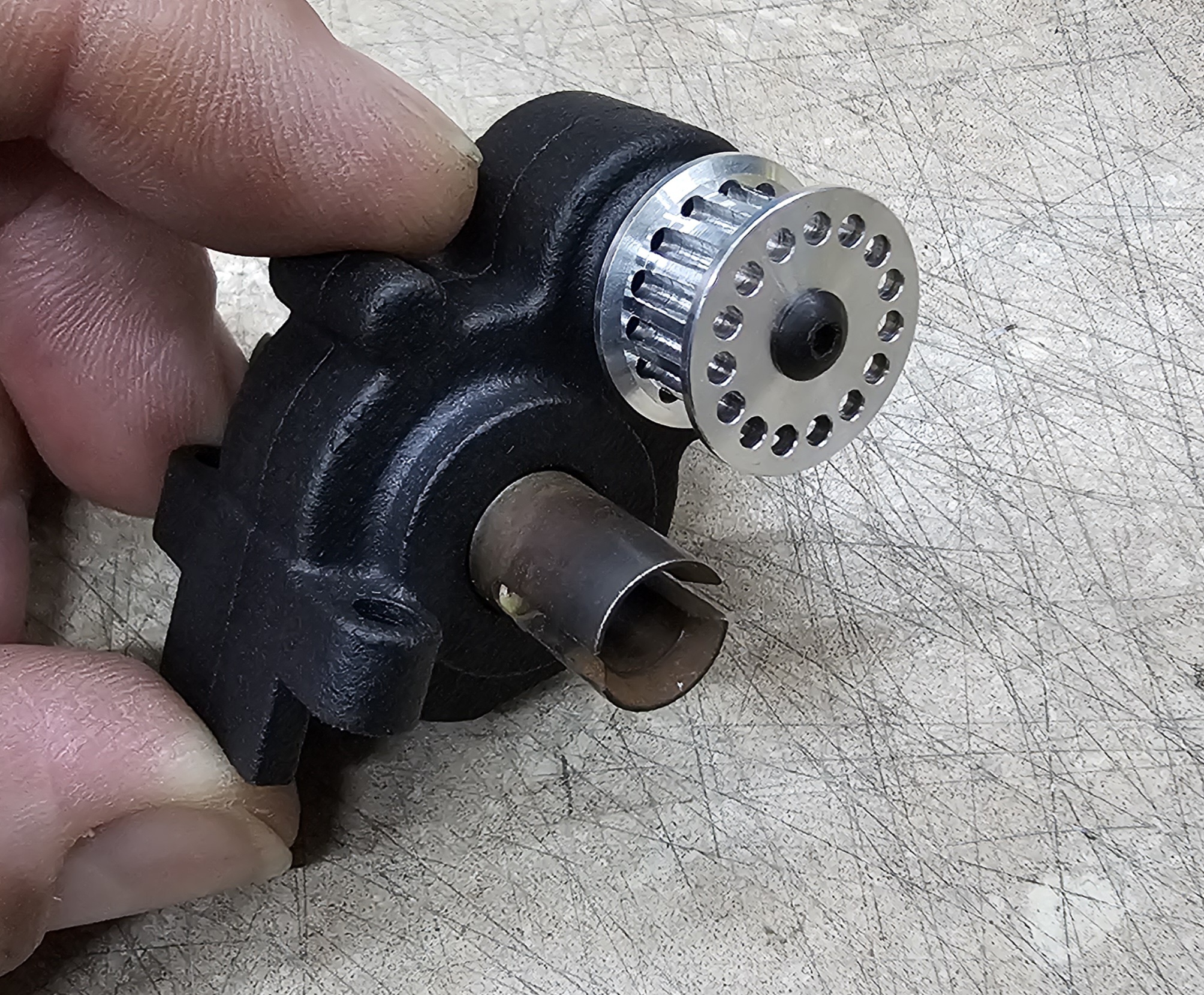

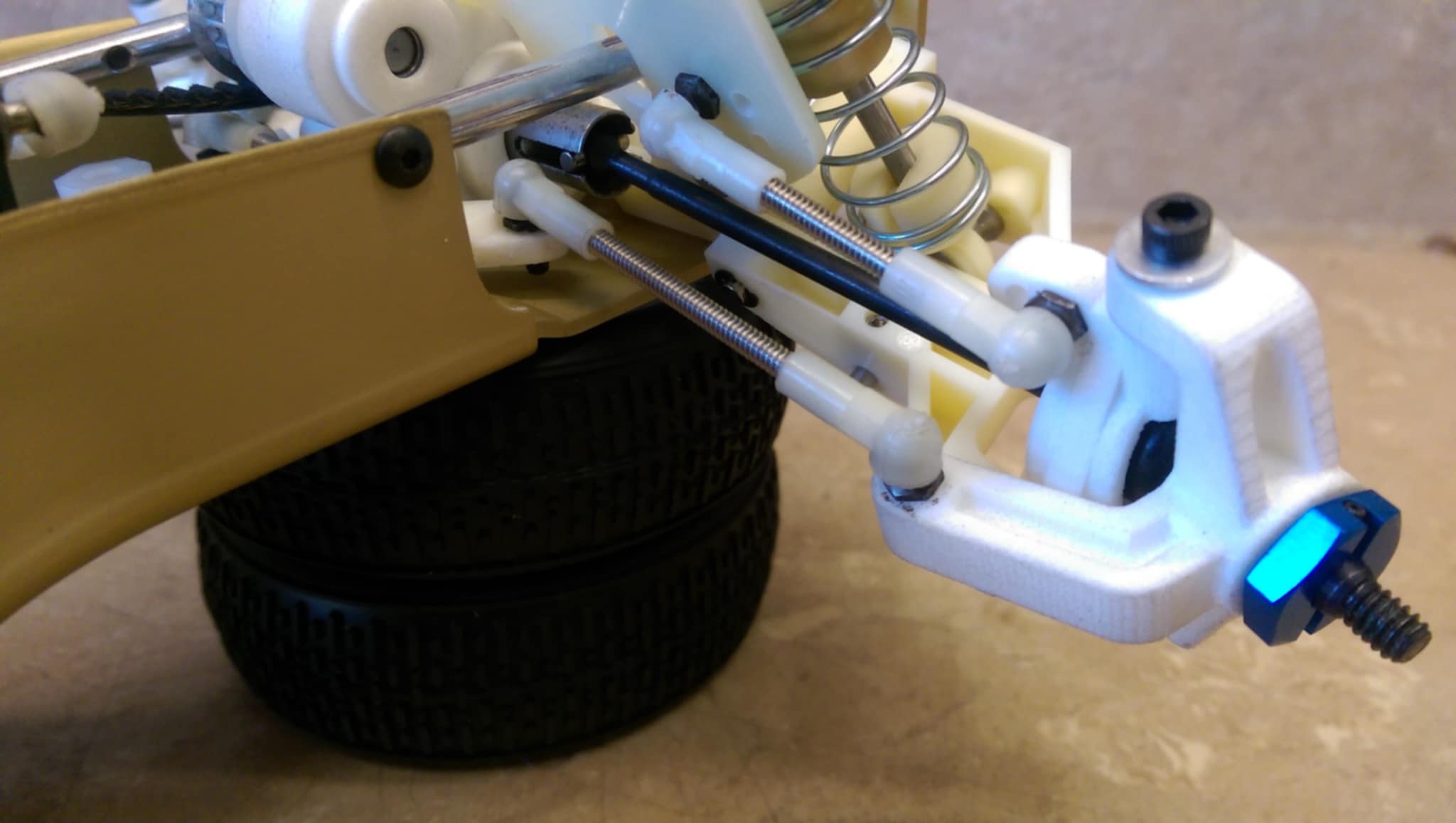

OK OK even I got caught up in the last MIP "announcement". Should have known. So, lets do it again. The Ten4 was good, but the parts are just all out of date. The B44 front axles especially. Materials have vastly improved. Ideas have improved. Announcing the Ten4.1
I started by completely going through the front gearbox. I tightened it up around the gears and we will print them in PA12. The best part, everything I have priced so far will be cheaper than shapeways by a LONG shot. In fact some pieces will be half the price.
So, to start- here is the new shaft, idler, and pulley. The pulley is made in the style of the MIP Mipit but instead of a taper fit they are keyed with a roll pin. One change I am making is to the tooth count. We have room, and the MIP ran a 18t, so we are going to do that as well. The idler and shaft are both hardened. Best part, although this is just the sample before I do a run- the price is looking to be within a few dollars of the run we did 10 years ago. I'm aiming for $80 for a pair of pulleys, shafts, and idlers.

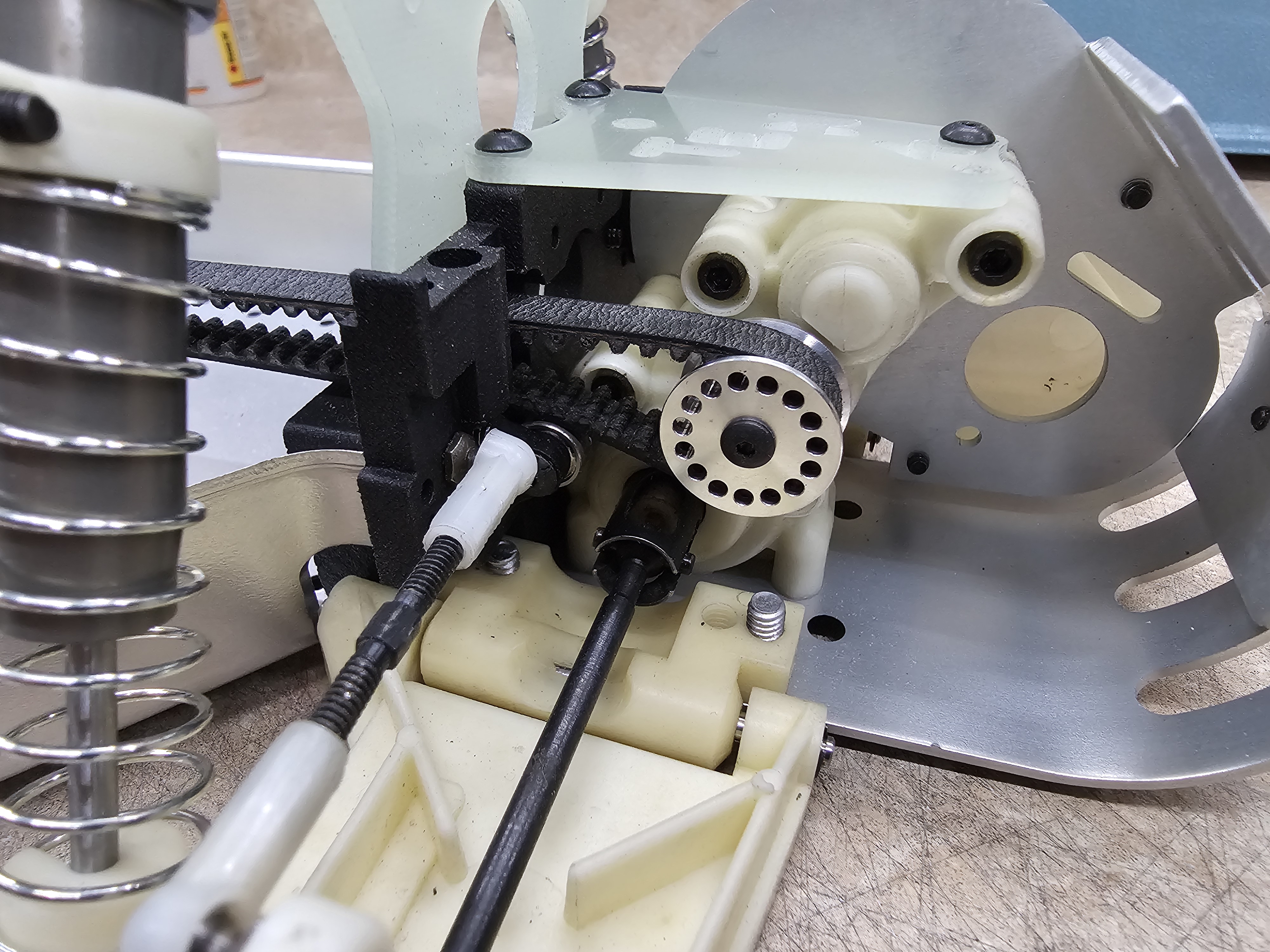

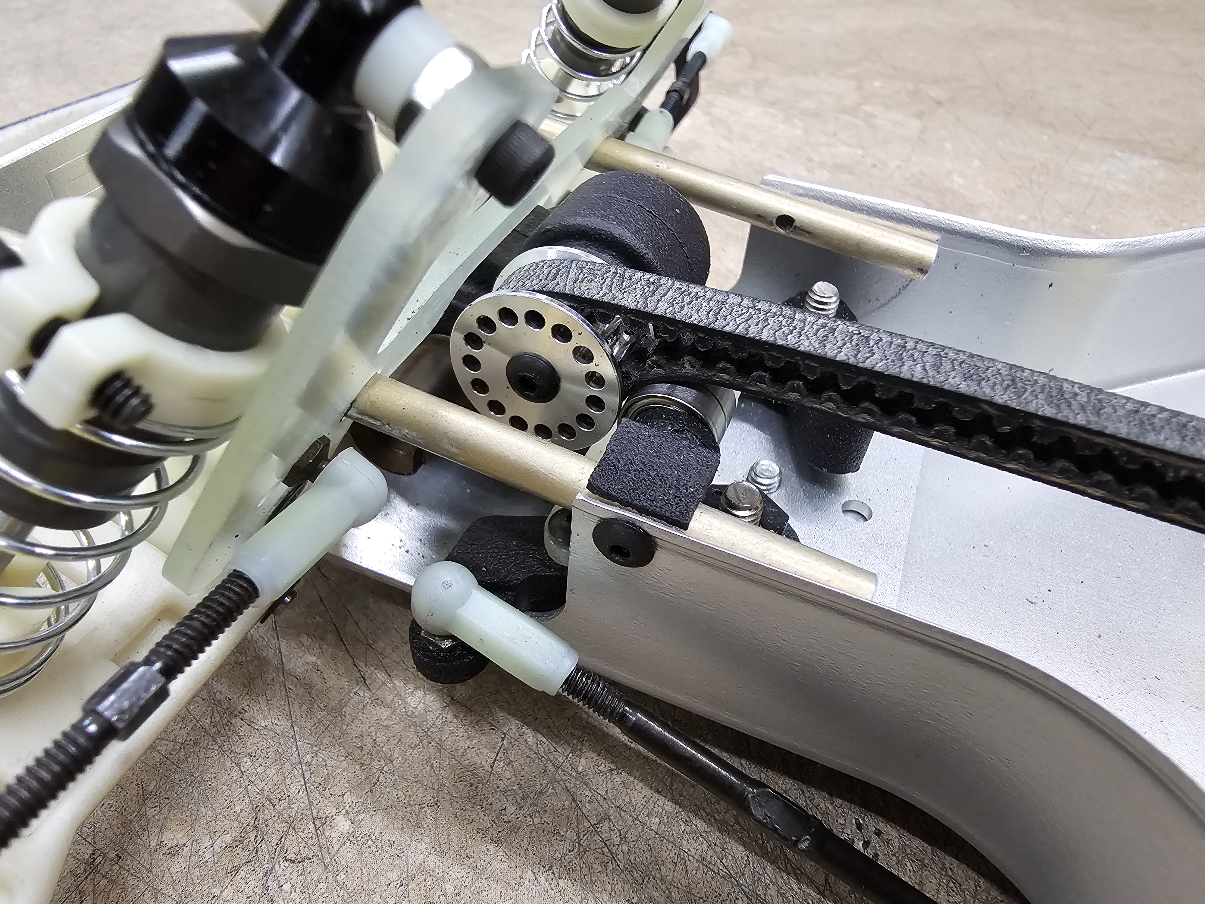

Here is the direction I'm headed on the front end. One printed part. And even that might end up being machined or molded :mrgreen:
Versus here is the old way
