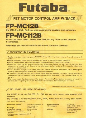

I have a MC-112B also, and found the manual here on RC10talk, but no polarity mentioned about the motor wires.
https://www.rc10talk.com/viewtopic.php?f=82&p=391494#p391494
I know these have reverse, but the potentiometers made me think there was already a bias dialed in for the correct motor polarity.
Is brown supposed to be negative with these vintage Futaba ESC's, or is it blue?
