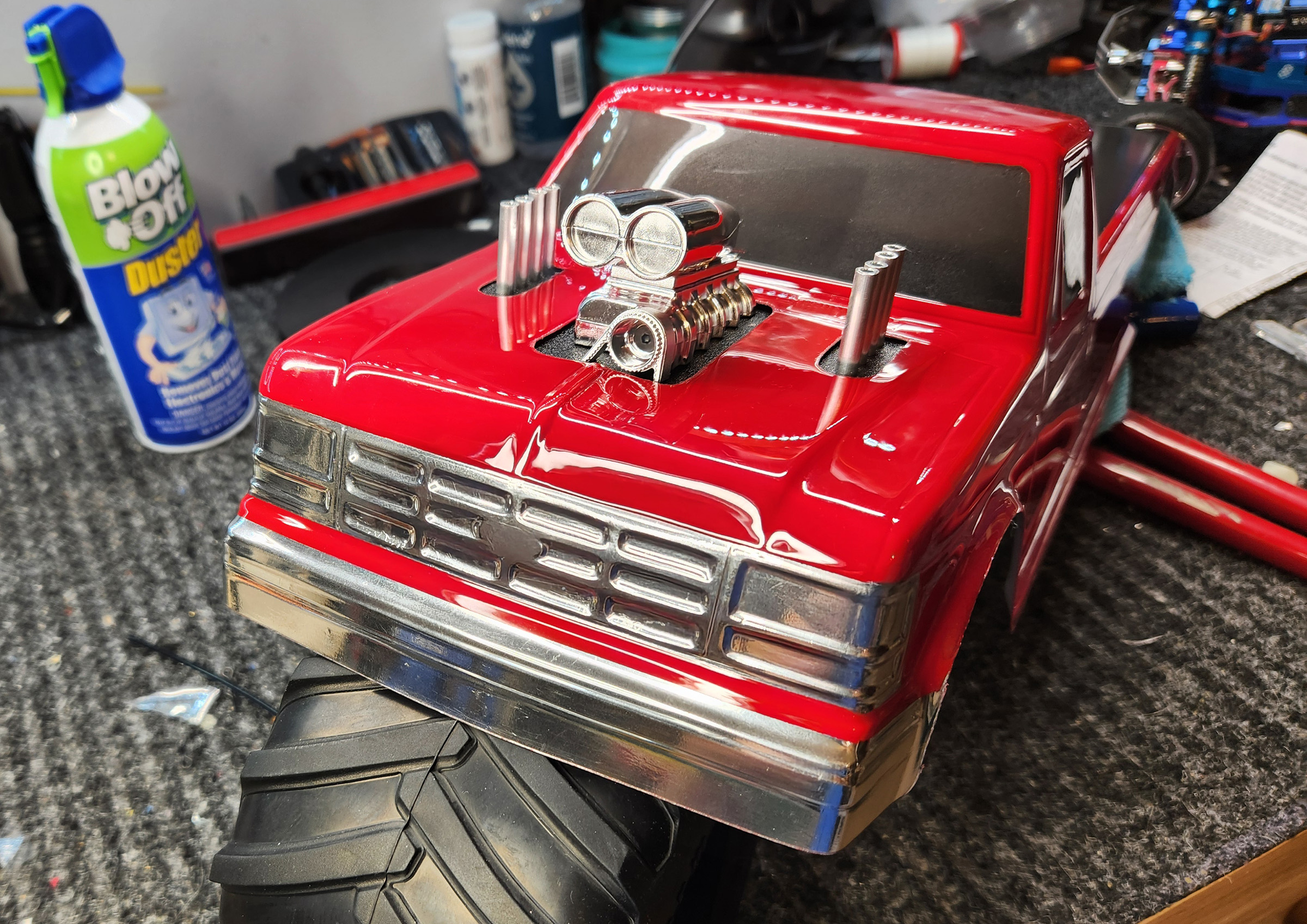

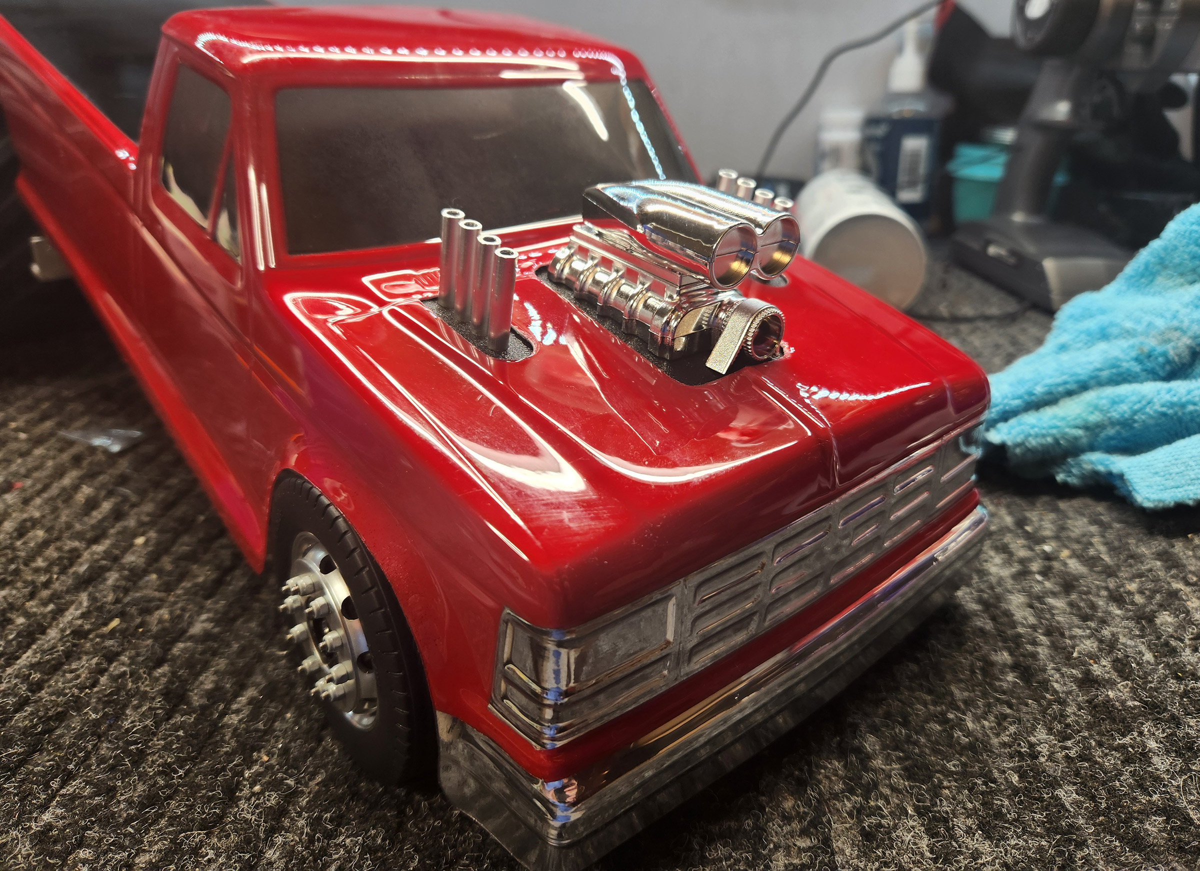

Had a little time today to play with the Spaz Stix Ultimate Mirror Chrome ................ and it is awesome! :mrgreen: This is a couple of pics from my puller, and I did minimum effort on this to say the least. No real prep, 3-4 coats of mirror chrome, and a couple of coats of their black backer (although the instructions say you can use other black backers). The chrome sprays on very thin as expected, and will blow off as you move the body. The chrome paint's purpose is to bring the shine, the backer is there to hold it on to the surface. The chrome paint is ~$14 a can, and the backer ~$8, so cost is an issue, but overall, if I am doing chrome stuff from now on, on lexan, it is getting Spaz Stix. It is idiot proof, proven by me being able to do it.
