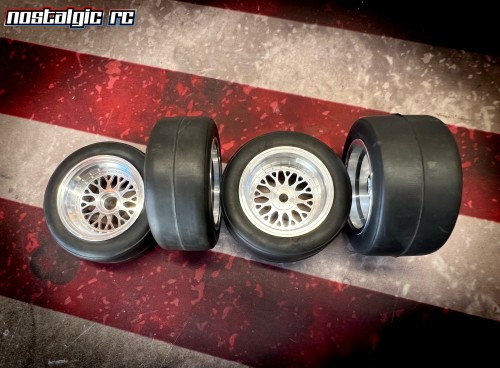

That's a great option with the F104 slicks, looks exactly right. They look like they would fit a lot easier in aftermarket body wheel wells.
F104 tire dimensions:
Front tire x 2pcs. (Item 54198) Dimensions = Width: 30mm, Diameter: 64mm.
Rear tire x 2pcs. (Item 54199) Dimensions = Width: 35mm, Diameter: 64mm.
Stock DS tires:
Front Width: 32mm, Diameter: 65mm
Rear Width: 37mm, Diameter: 72mm
The AE page finally shows a few parts available on the DS page now, but the parts aren't for the DS.

Re: RC10 DS Classic - Build
I agree, those Tamiya F1 tires look great.GreenBar0n wrote: ↑Sun Aug 25, 2024 3:16 pmThat's a great option with the F104 slicks, looks exactly right. They look like they would fit a lot easier in aftermarket body wheel wells.
Stock DS tires:
https://www.associatedelectrics.com/teamassociated/cars_and_trucks/RC10DS/Classic_Kit/parts_accessories/
Although perhaps not accurate for a mid-'90's TA car, I prefer the look of both front and rear tires with the same diameter.
At 72mm, the DS kit rear tires are massive.
Also, Tamiya has a "soft" F104 front tire option: 51399. Same dimensions as 54198 except softer. Might help with understeer.
The stock tires are 72mm, the foams are about 66mm, for the rear. Same wheels with the rivets, just not chromed.
The fronts should be here in a couple of days.
