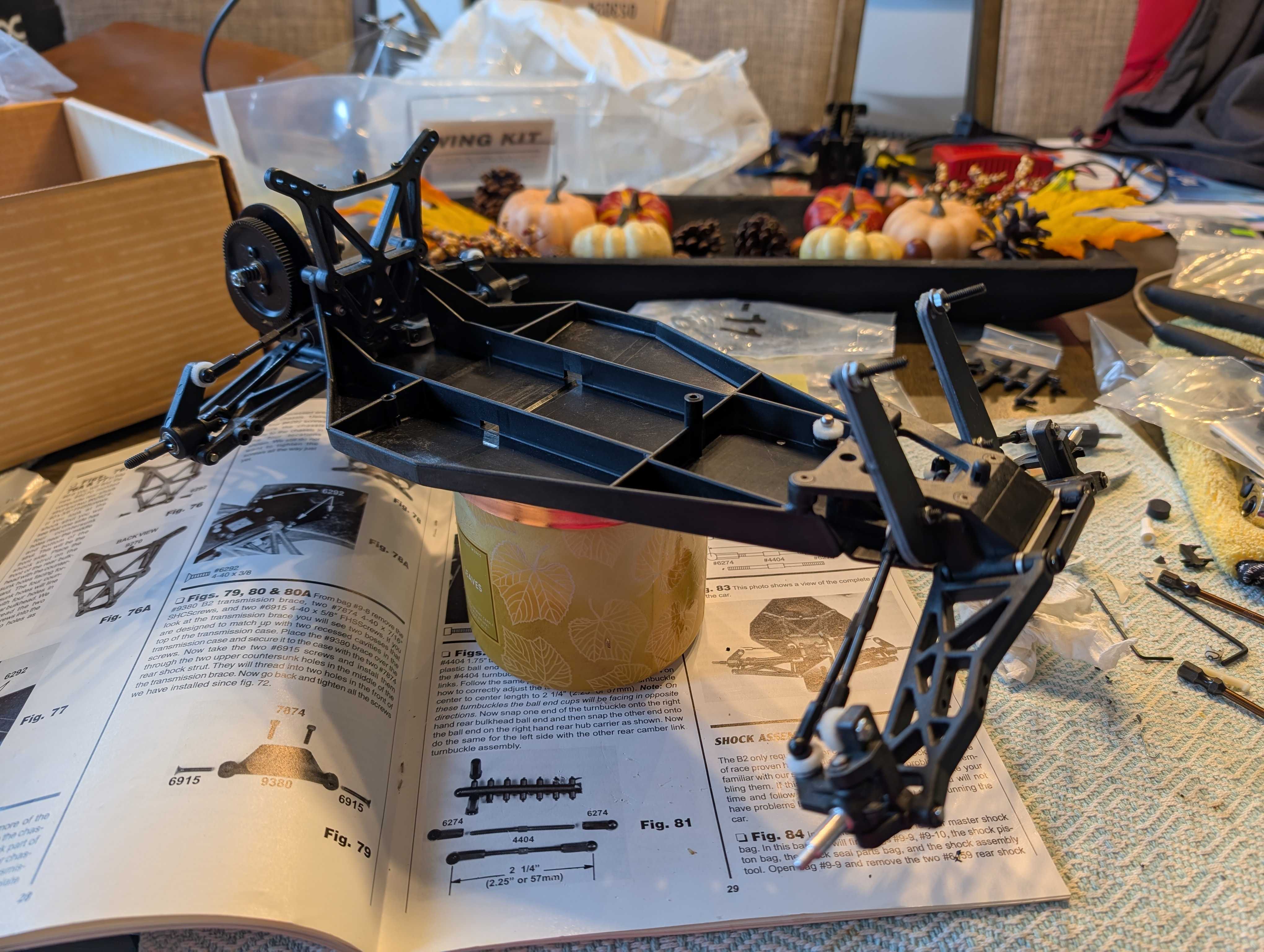

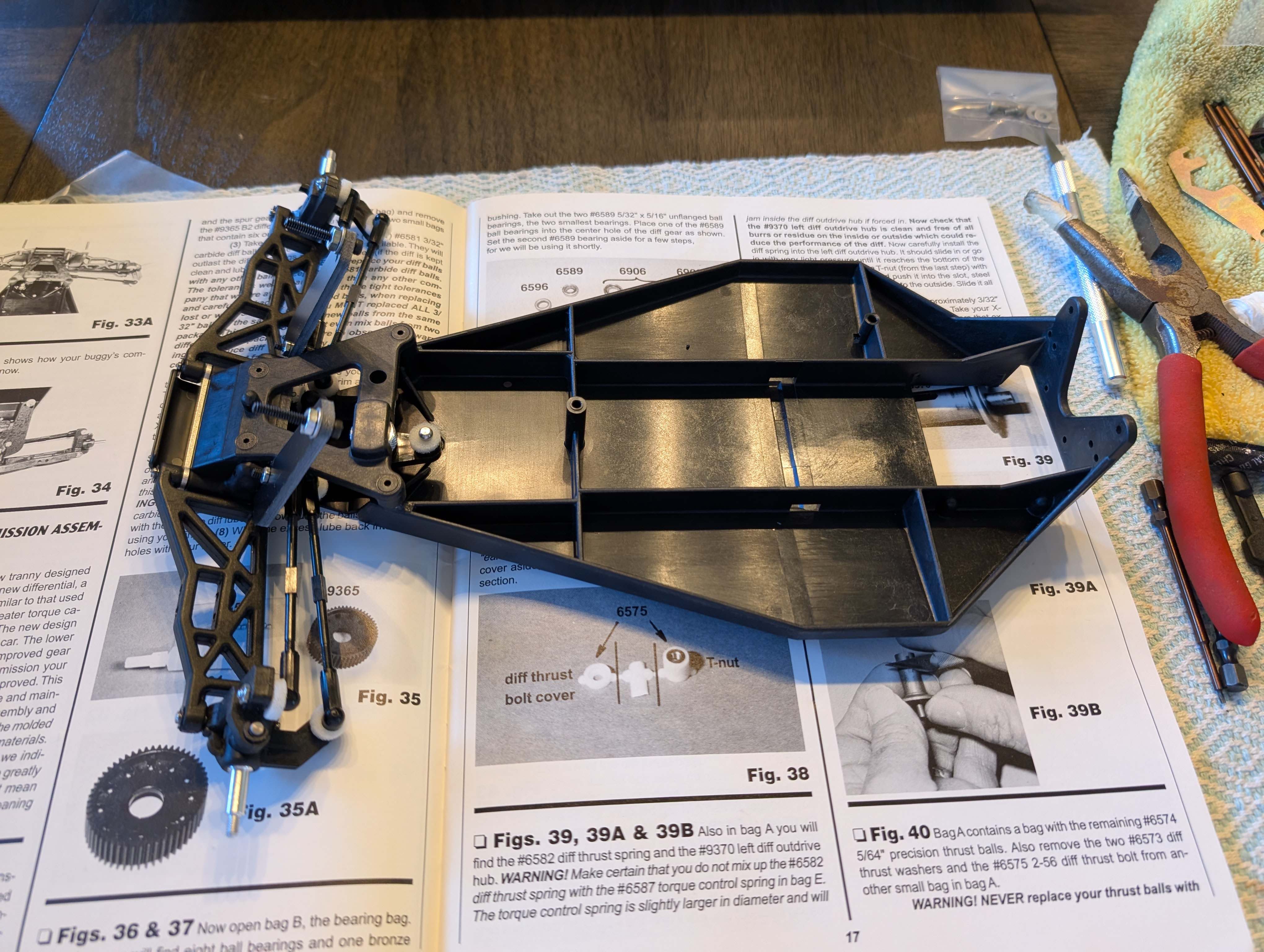

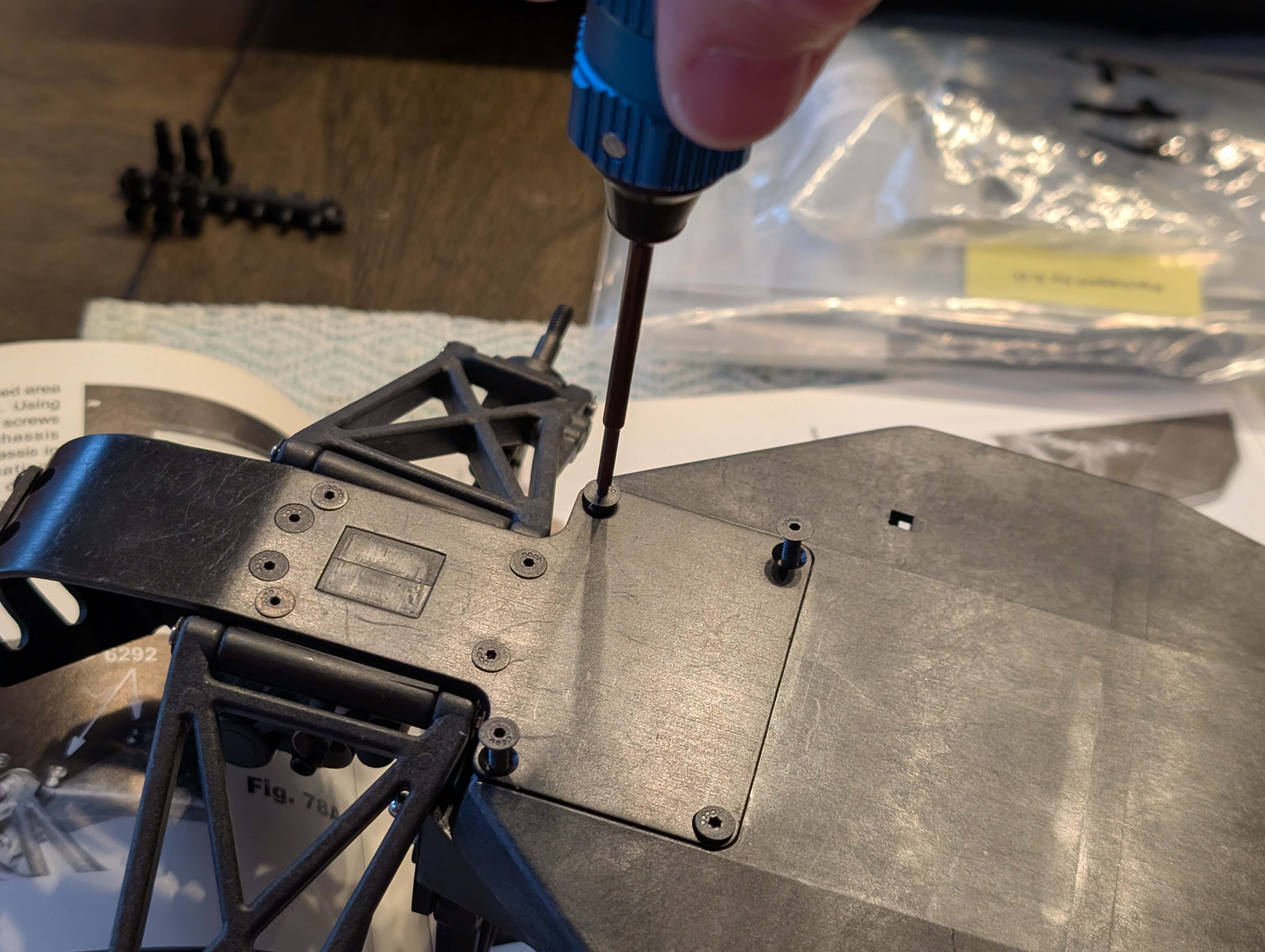

Okay, the build continues.

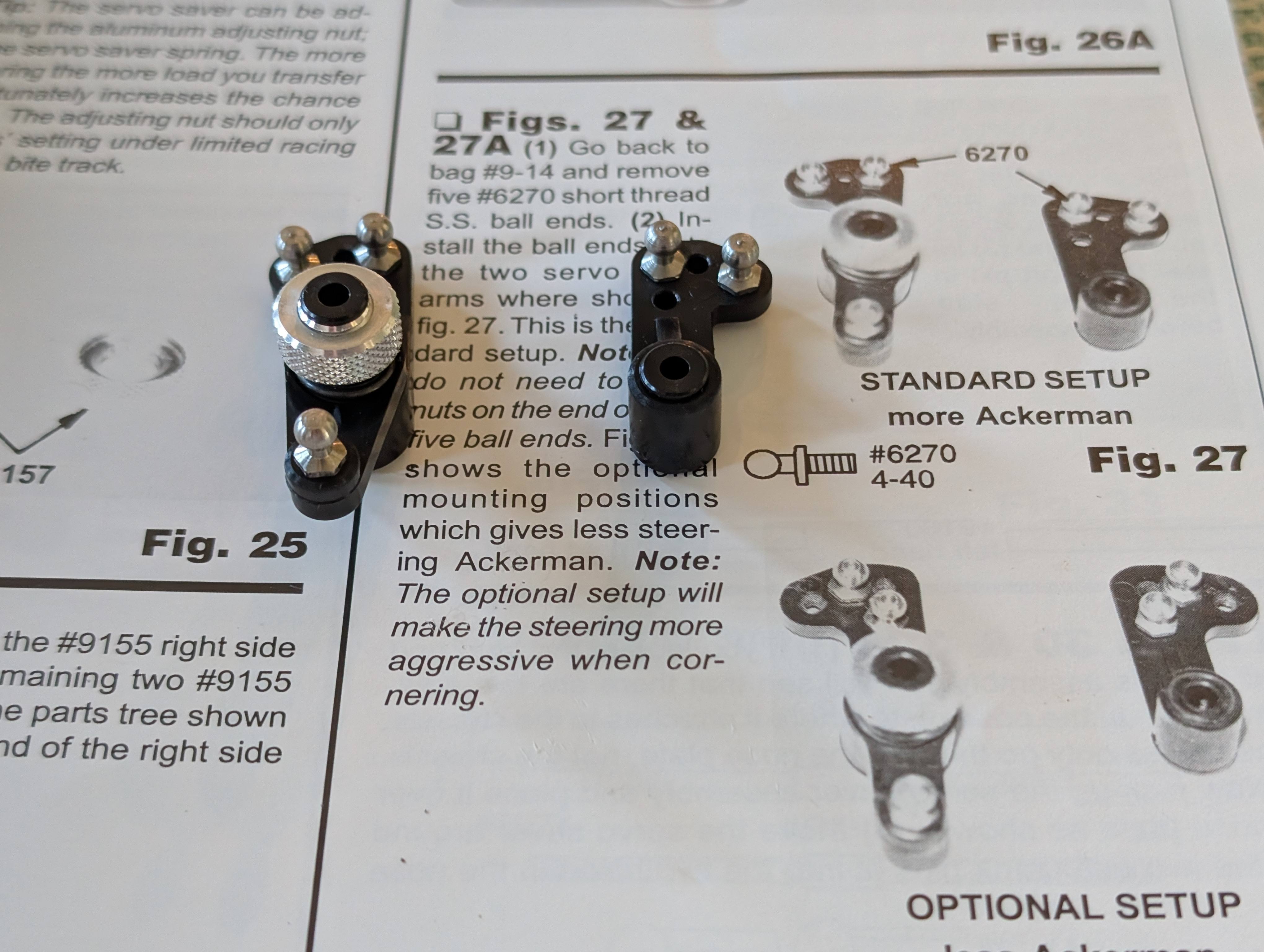

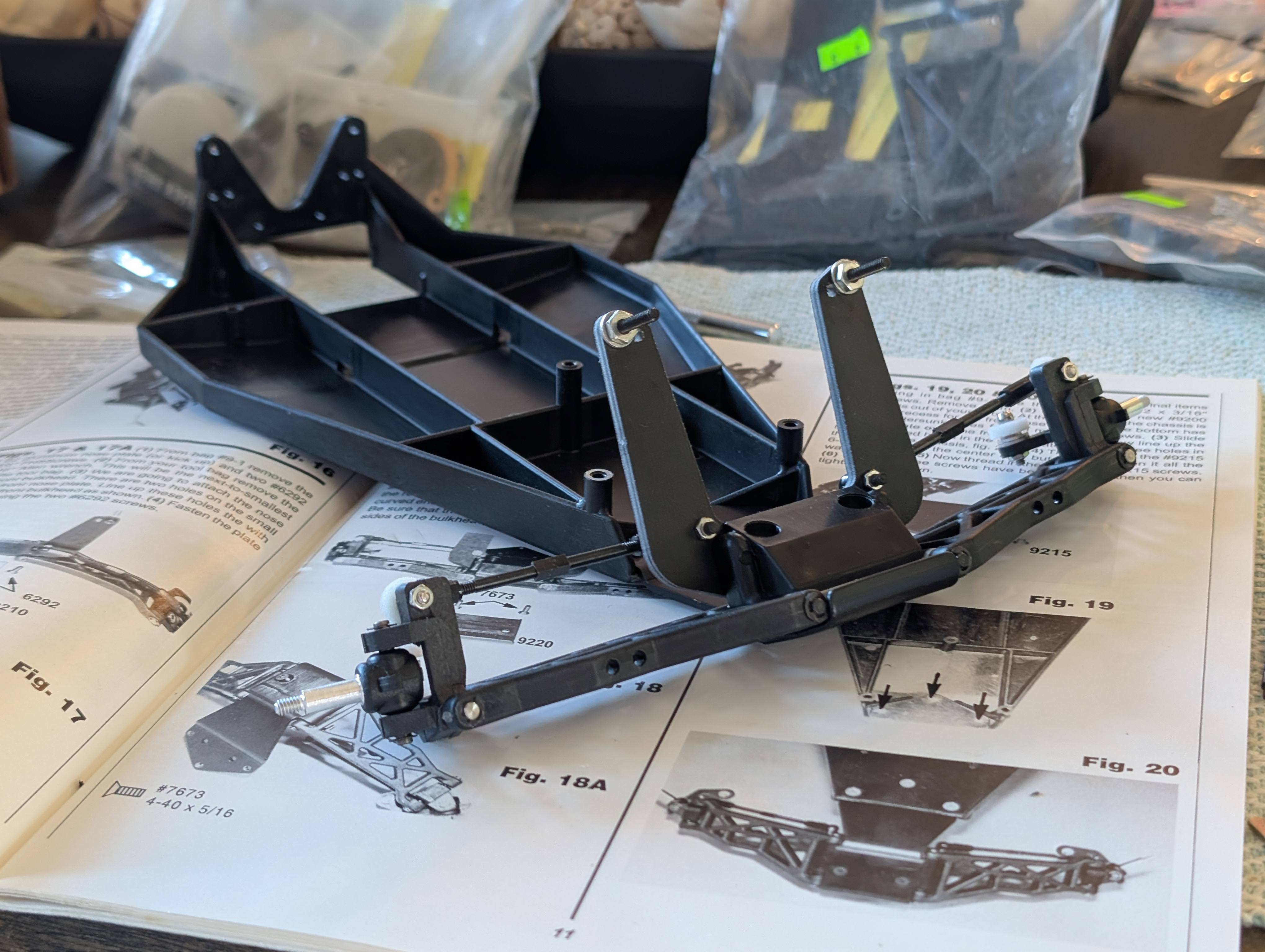

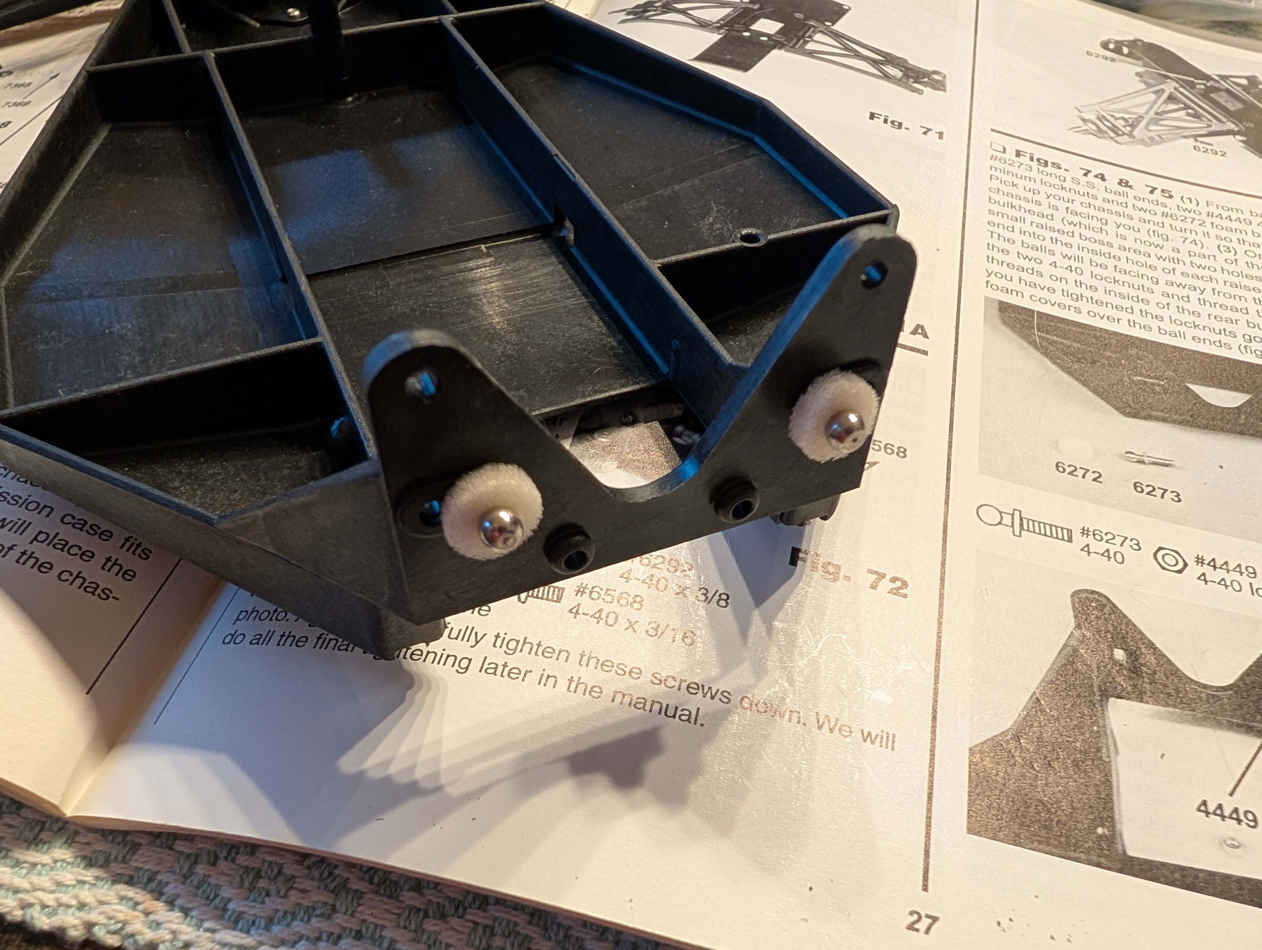

Time to mate this front end to the chassis and begin working on the servo saver.

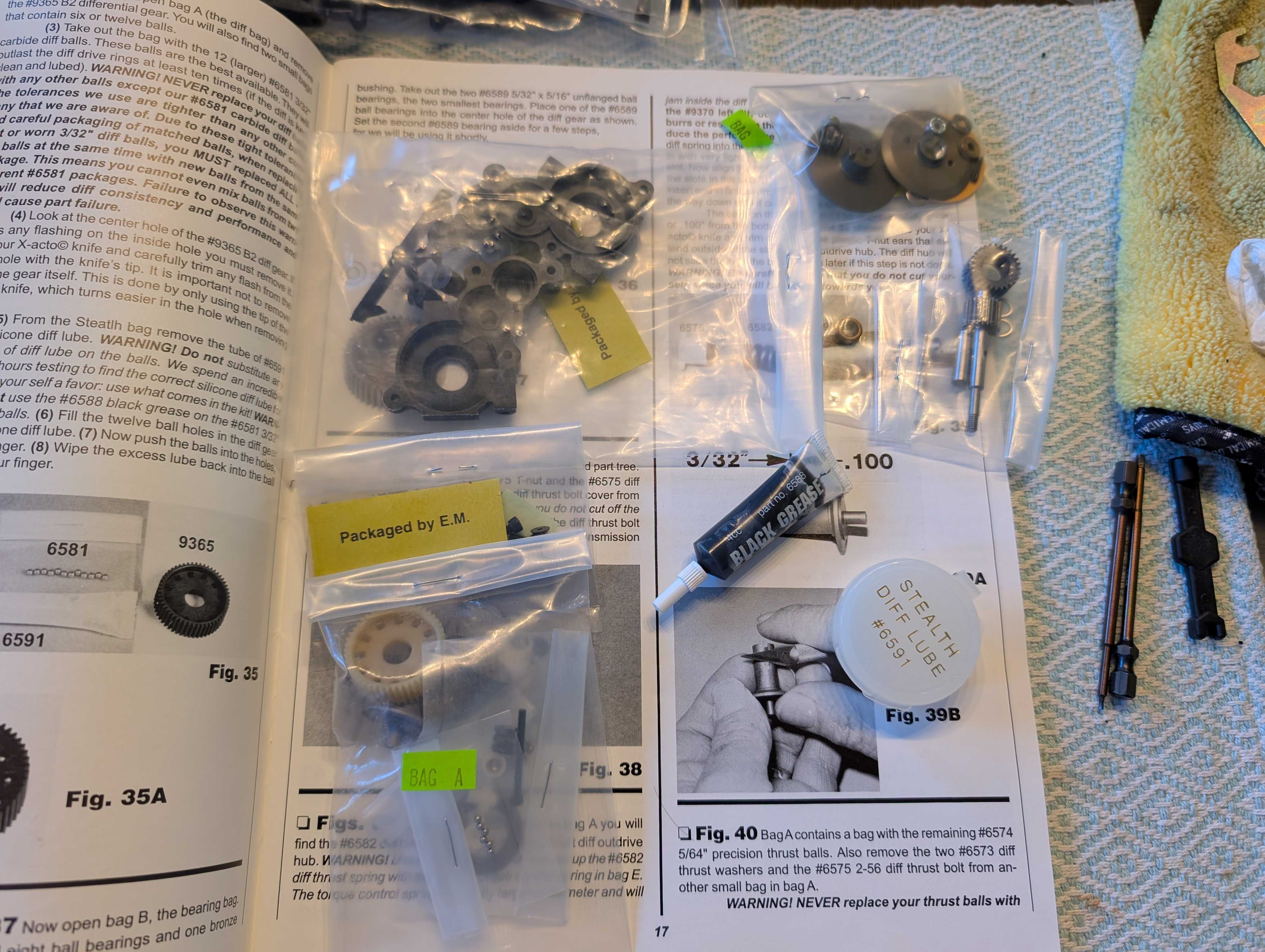

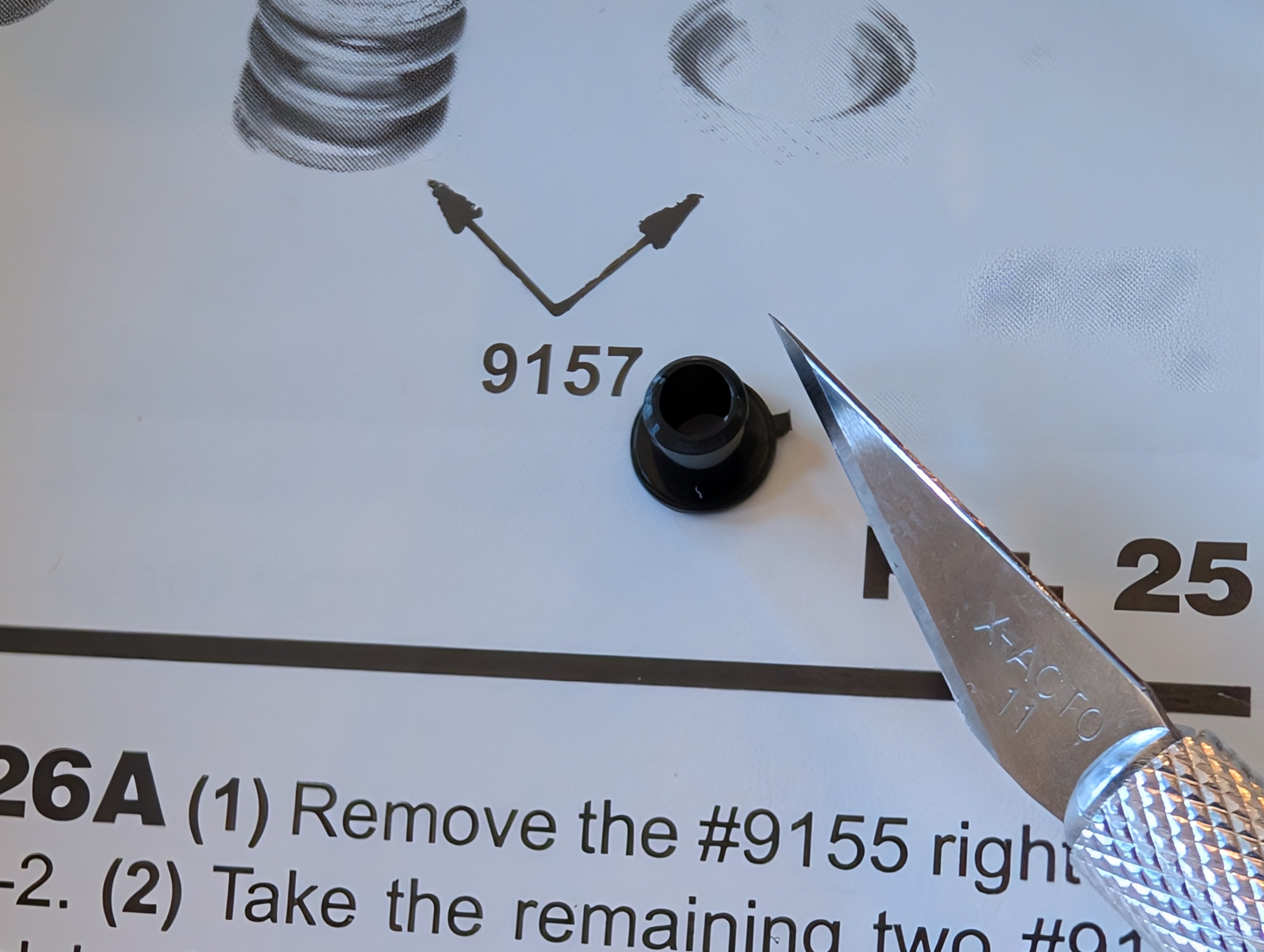

Completing the servo saver, making sure to trim off the extra plastic from the part trees. This is a step I didn't take all that seriously as a teenager when I raced. Aside from being a bit "rough around the edges" I paid for it in trans and shock builds back then. Safe to say I've learned my lesson.
Front end all assembled

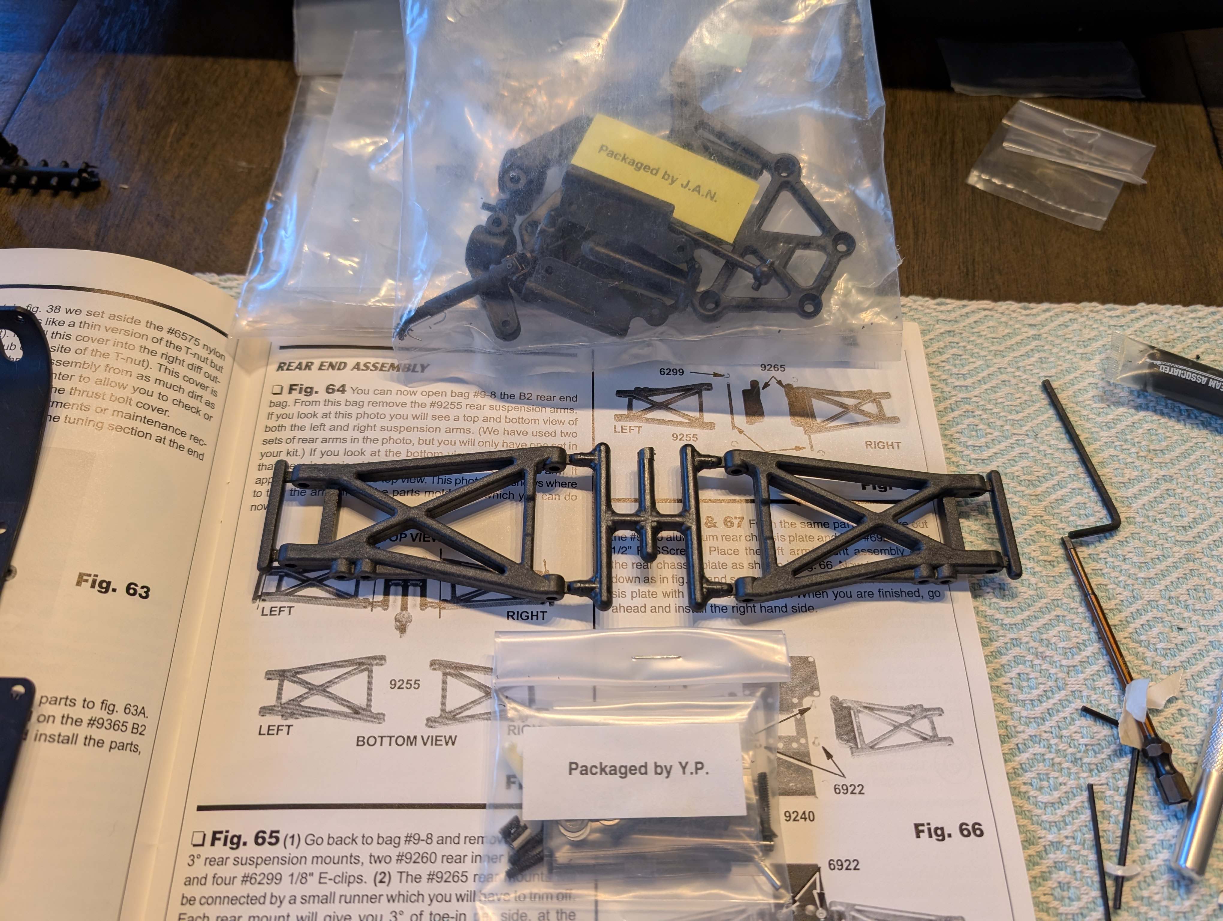

Time to turn my attention to the rear of the car. Always excited to build a Stealth!

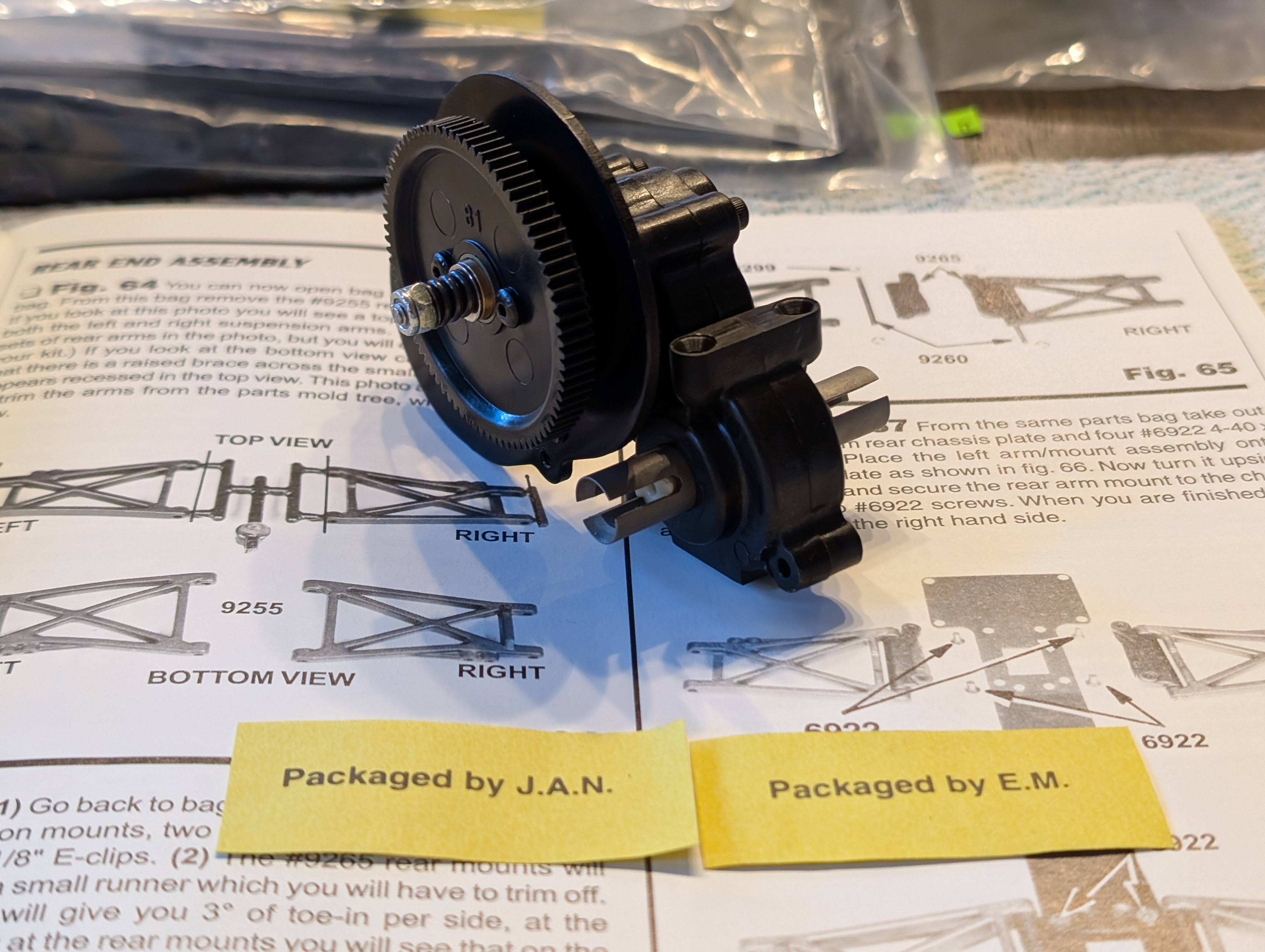

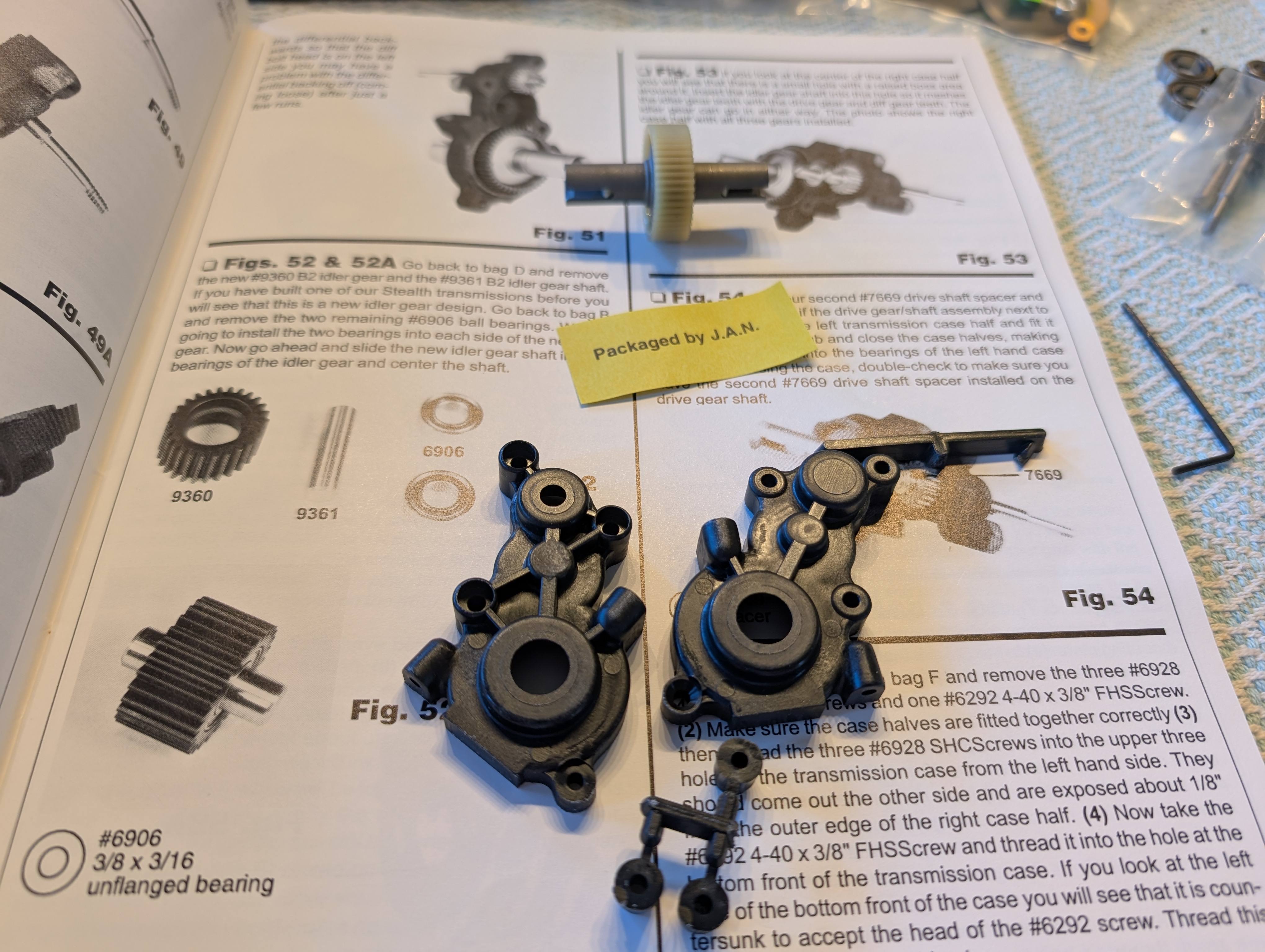

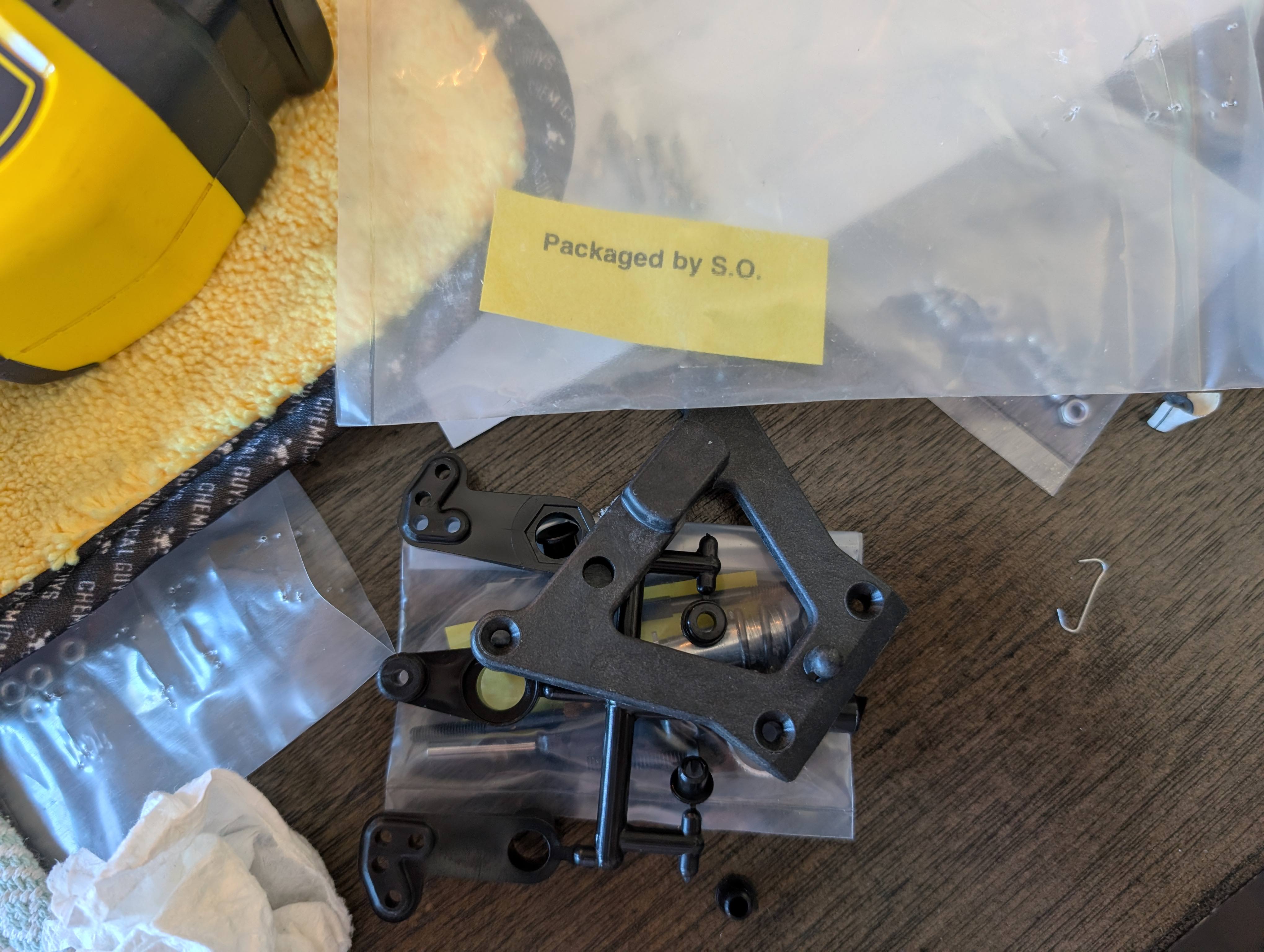

Also, can I just say how awesome the packaged by papers are! So far we have a handful of fine Associated team members involved in making sure everything was in place. Such a cool touch.
More to come tonight!

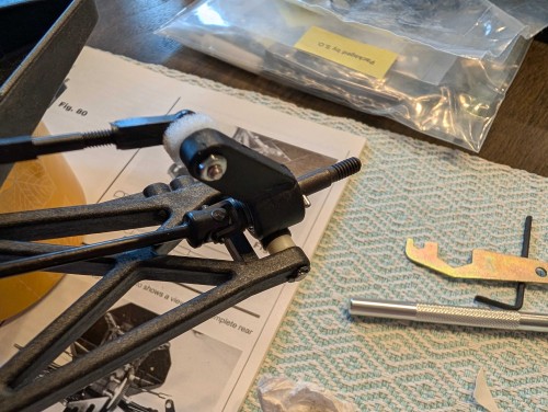

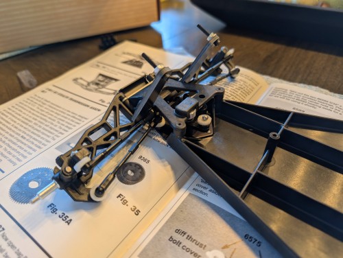

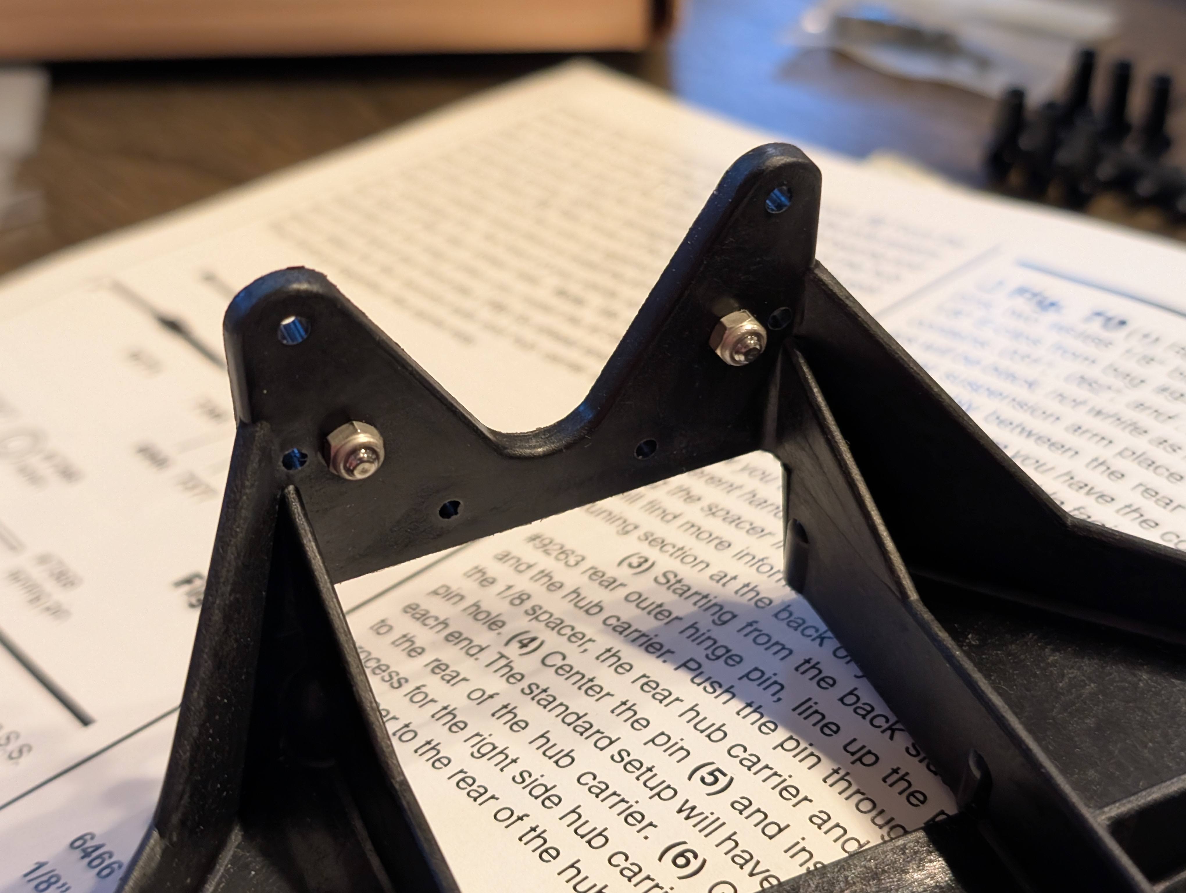

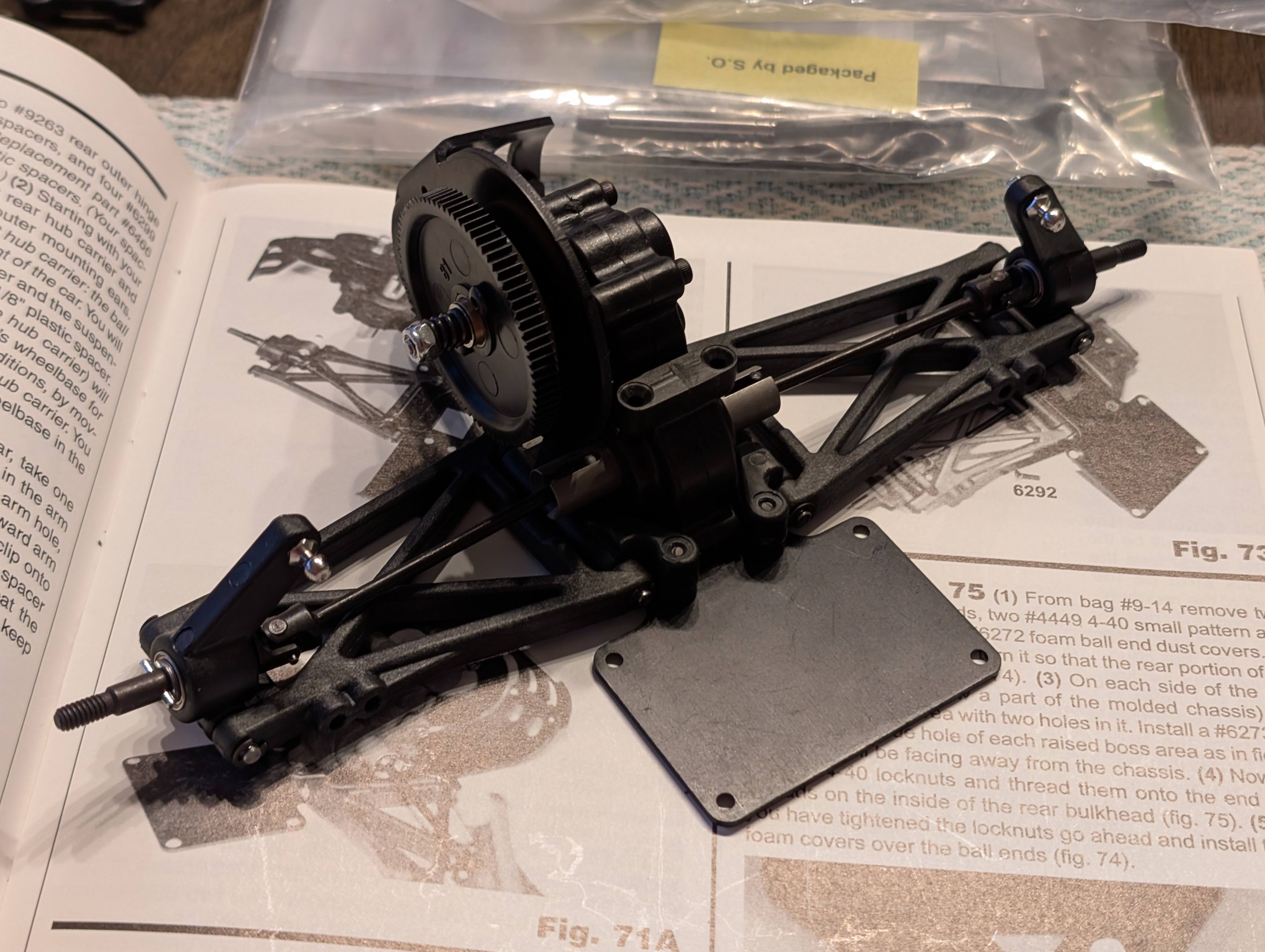

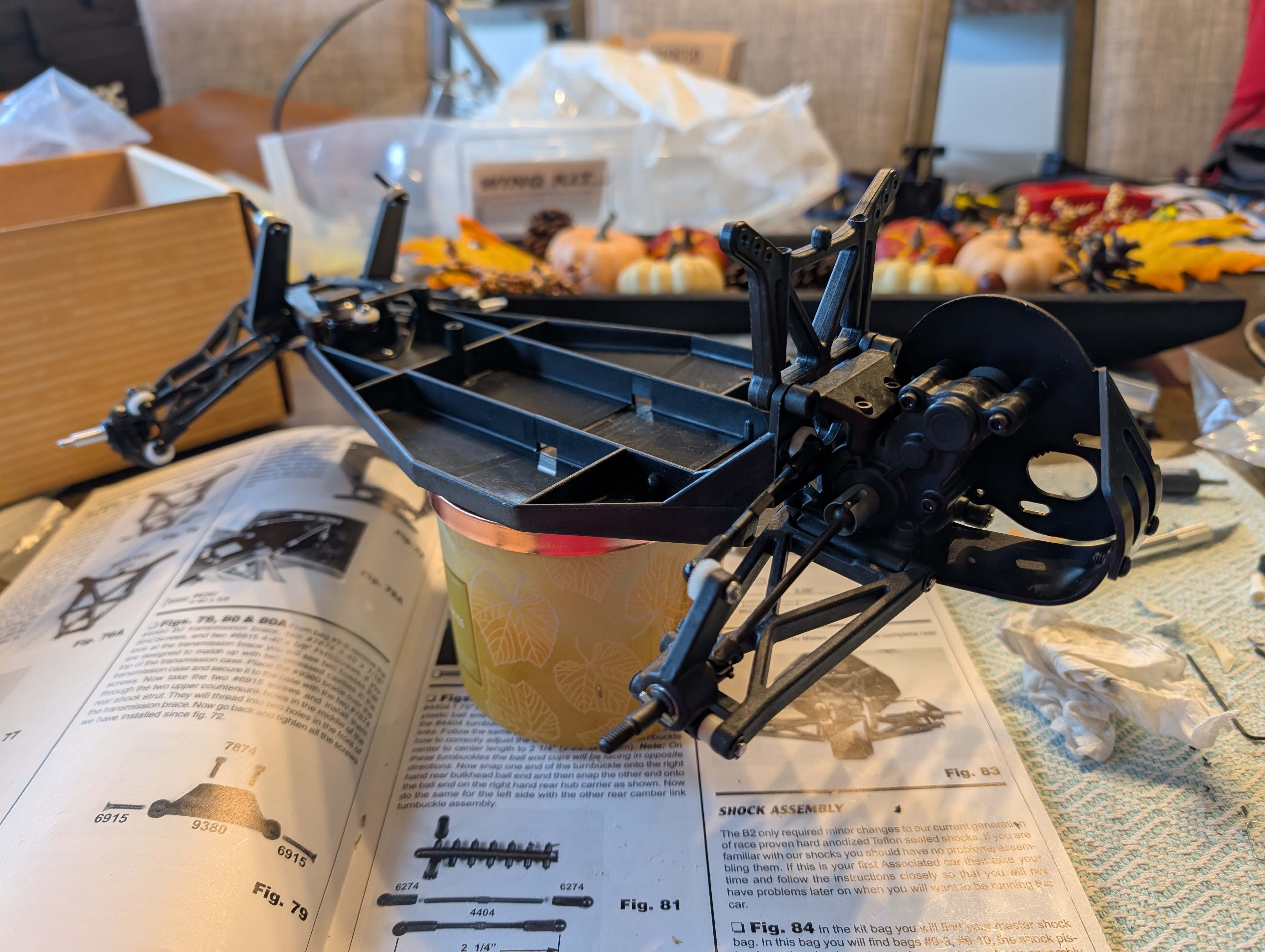

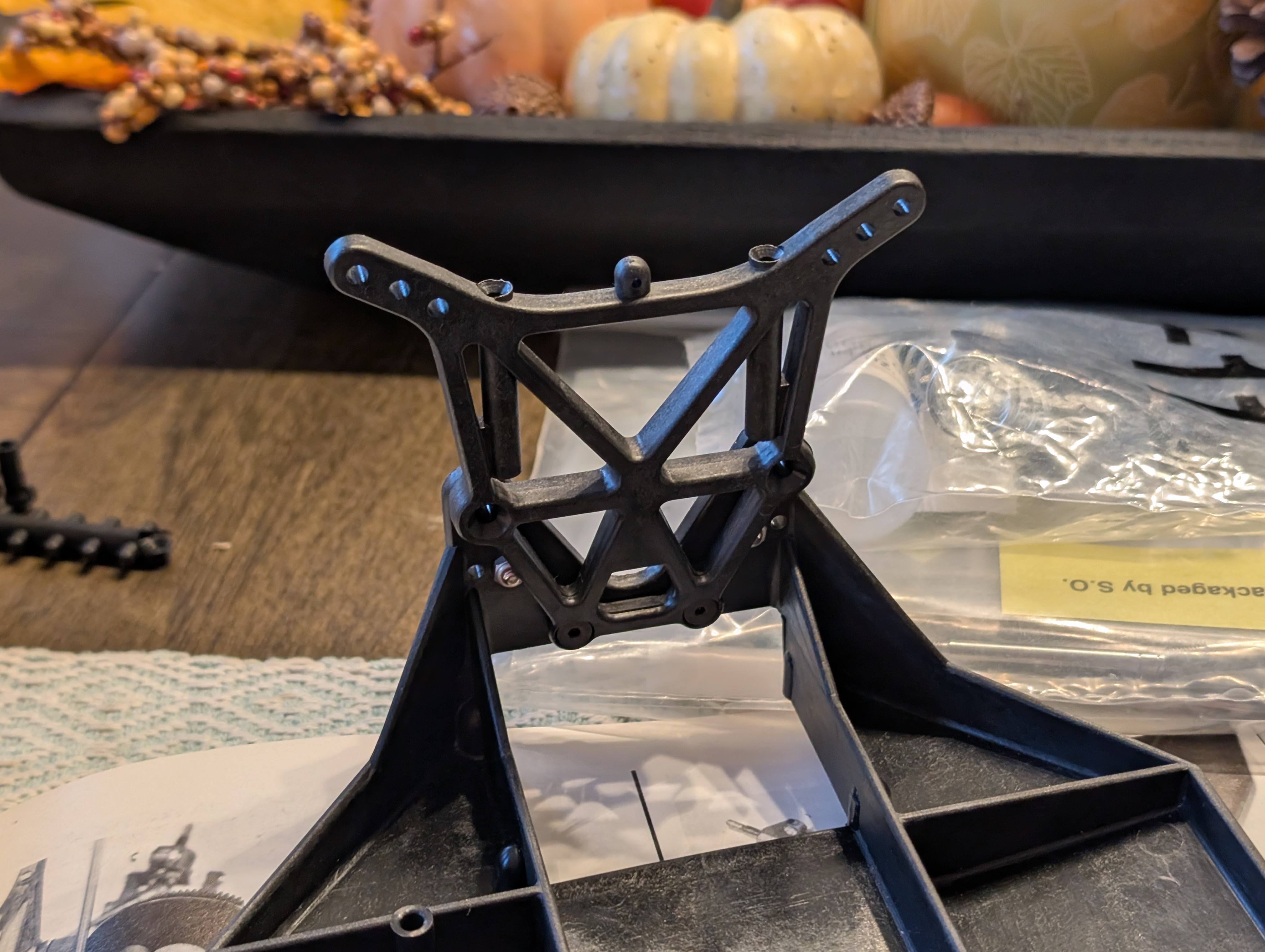

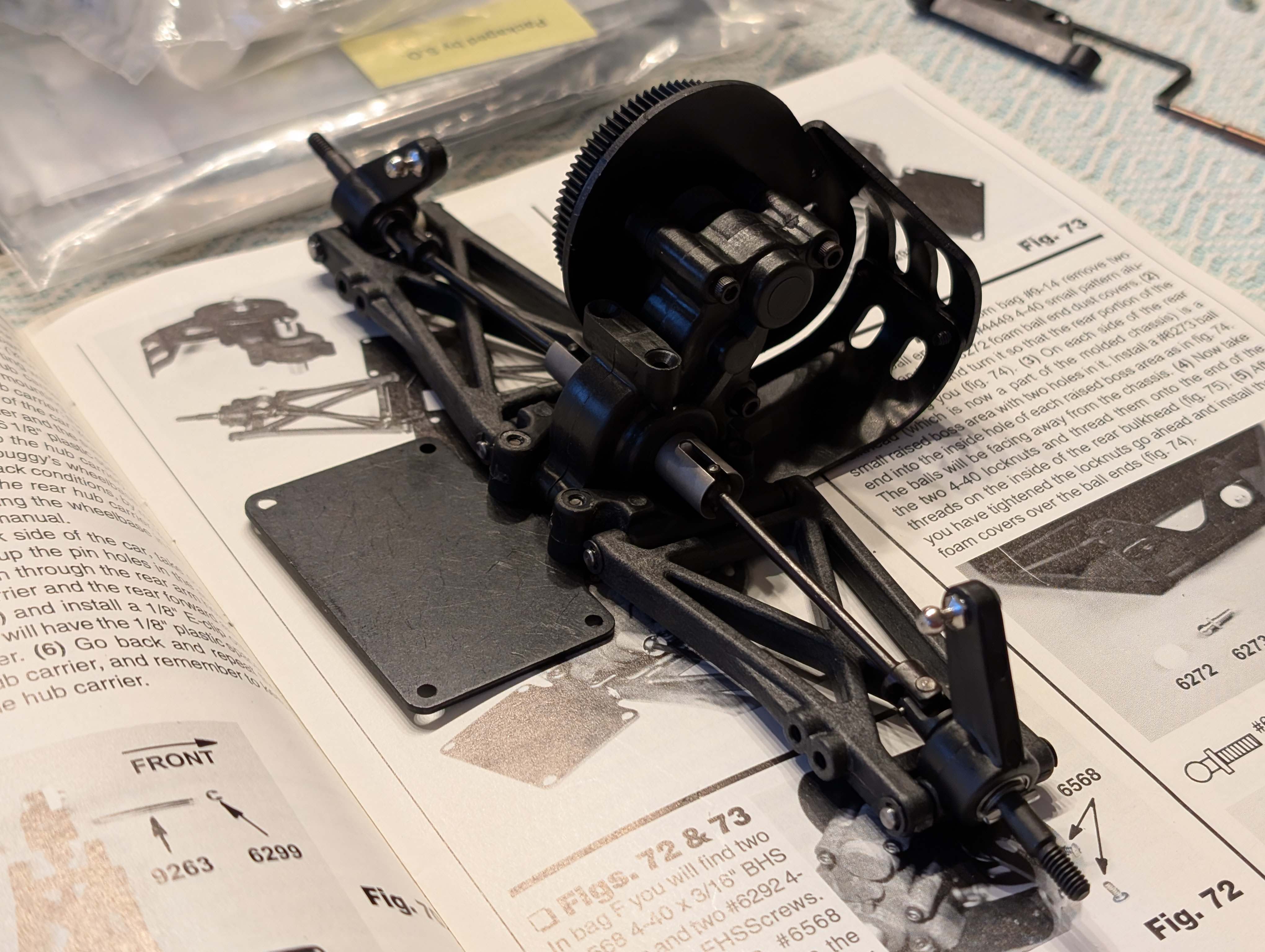

Stealth time! Sorry, I didn't get many photos of this part. I got into a groove and was just wrenching away.

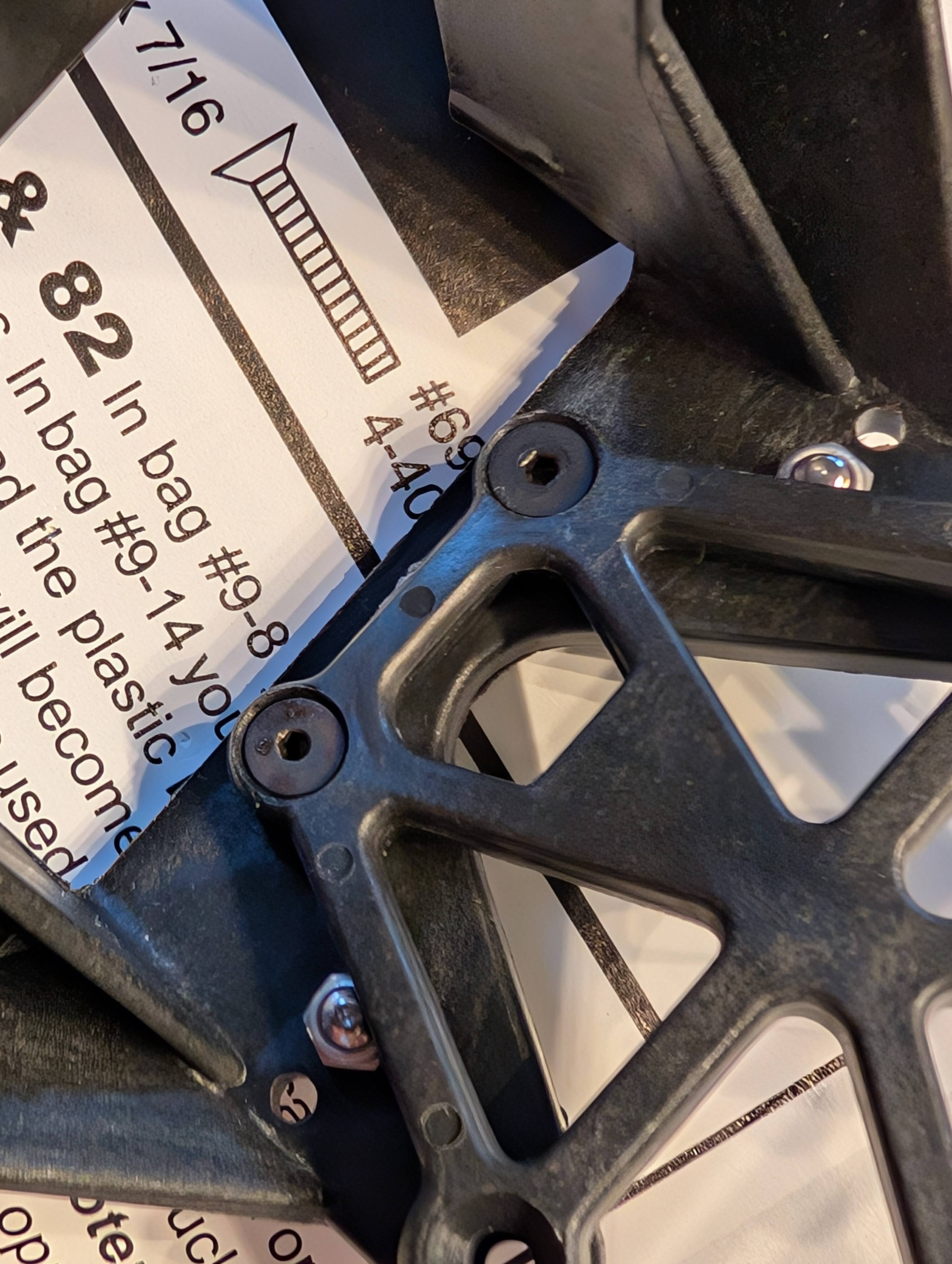

Added the rear arms to the bottom plate and installed the trans and motor plate. Slight change to the instructions here, too.
Getting the chassis ready for the rear. Shock tower up!
Mating the rear assembly to the chassis

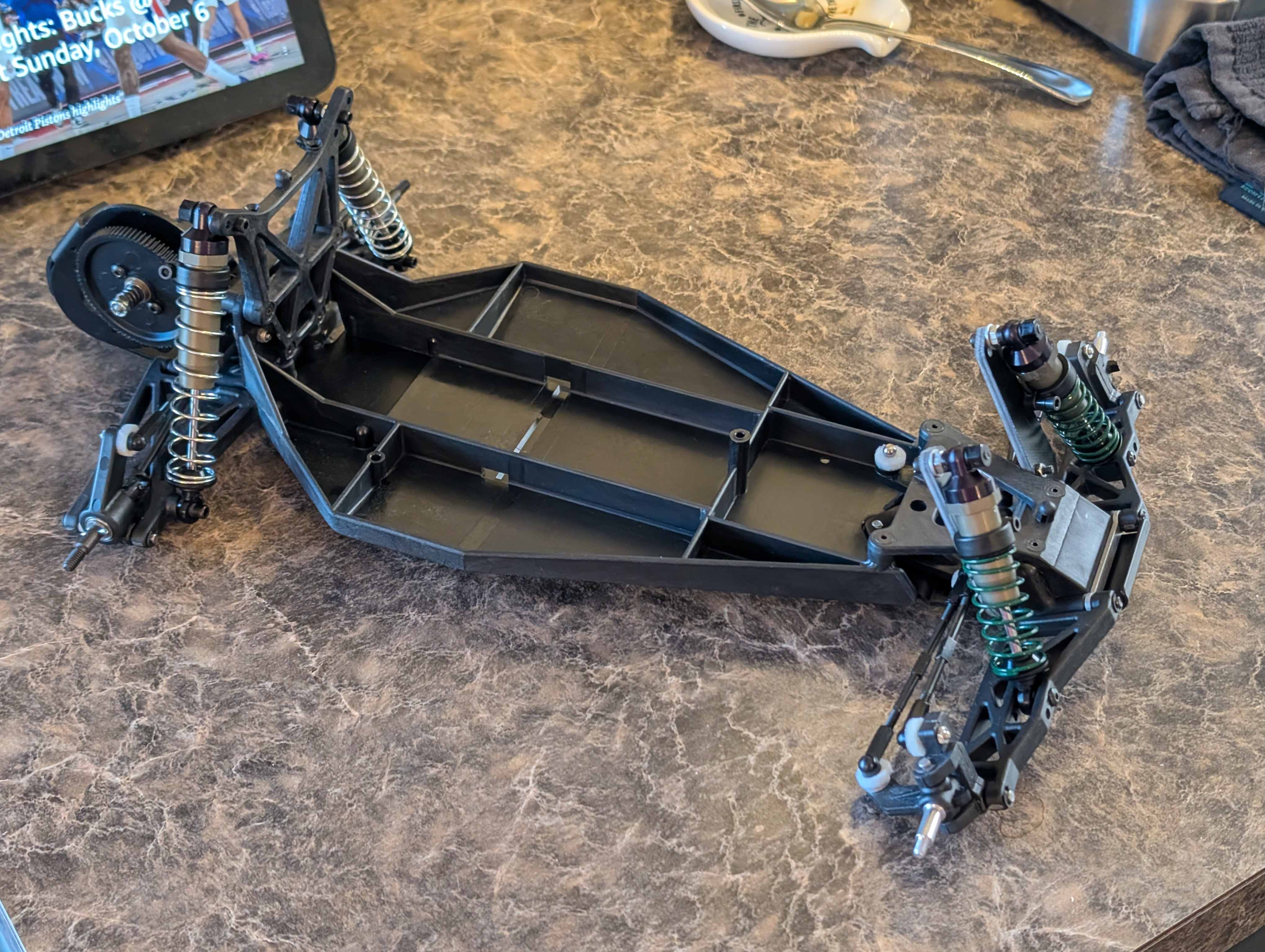

Next up, completed chassis minus the shocks, and then we begin the shock build!

Alright chassis is together!

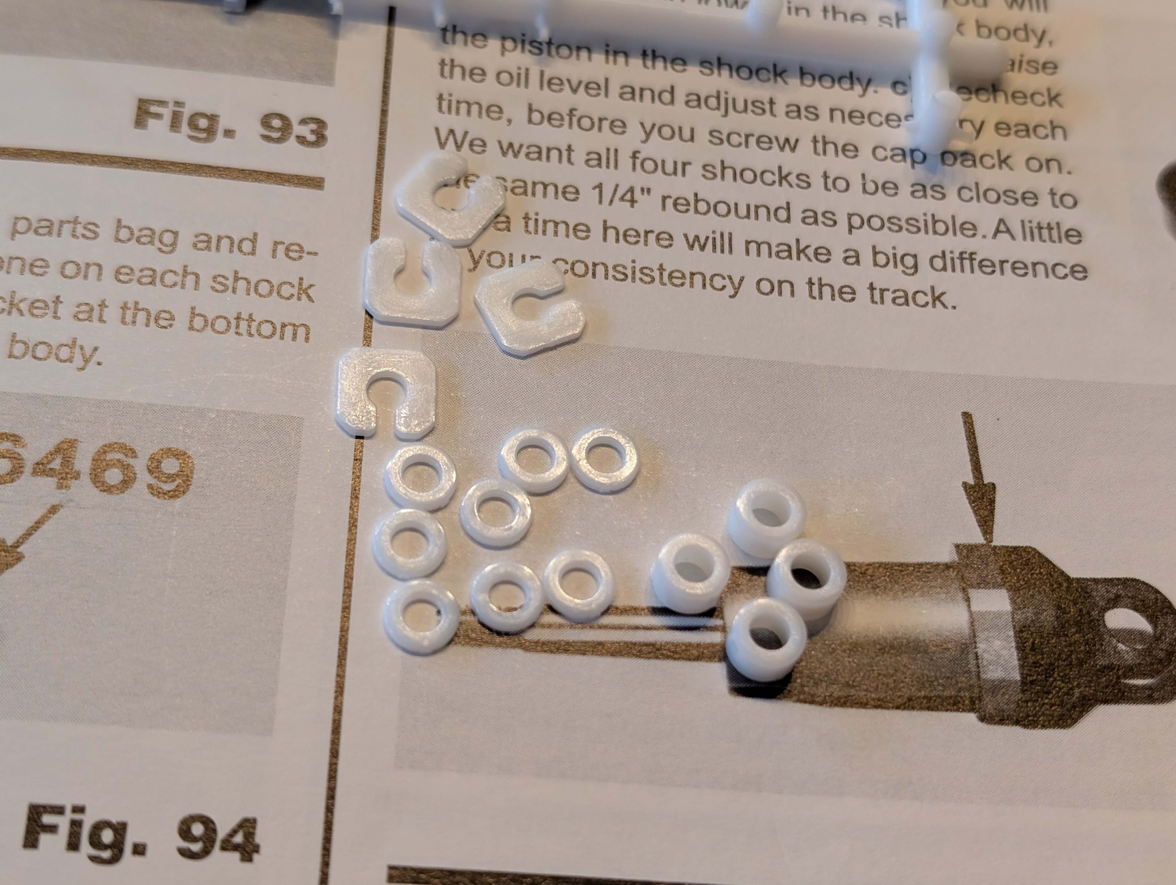

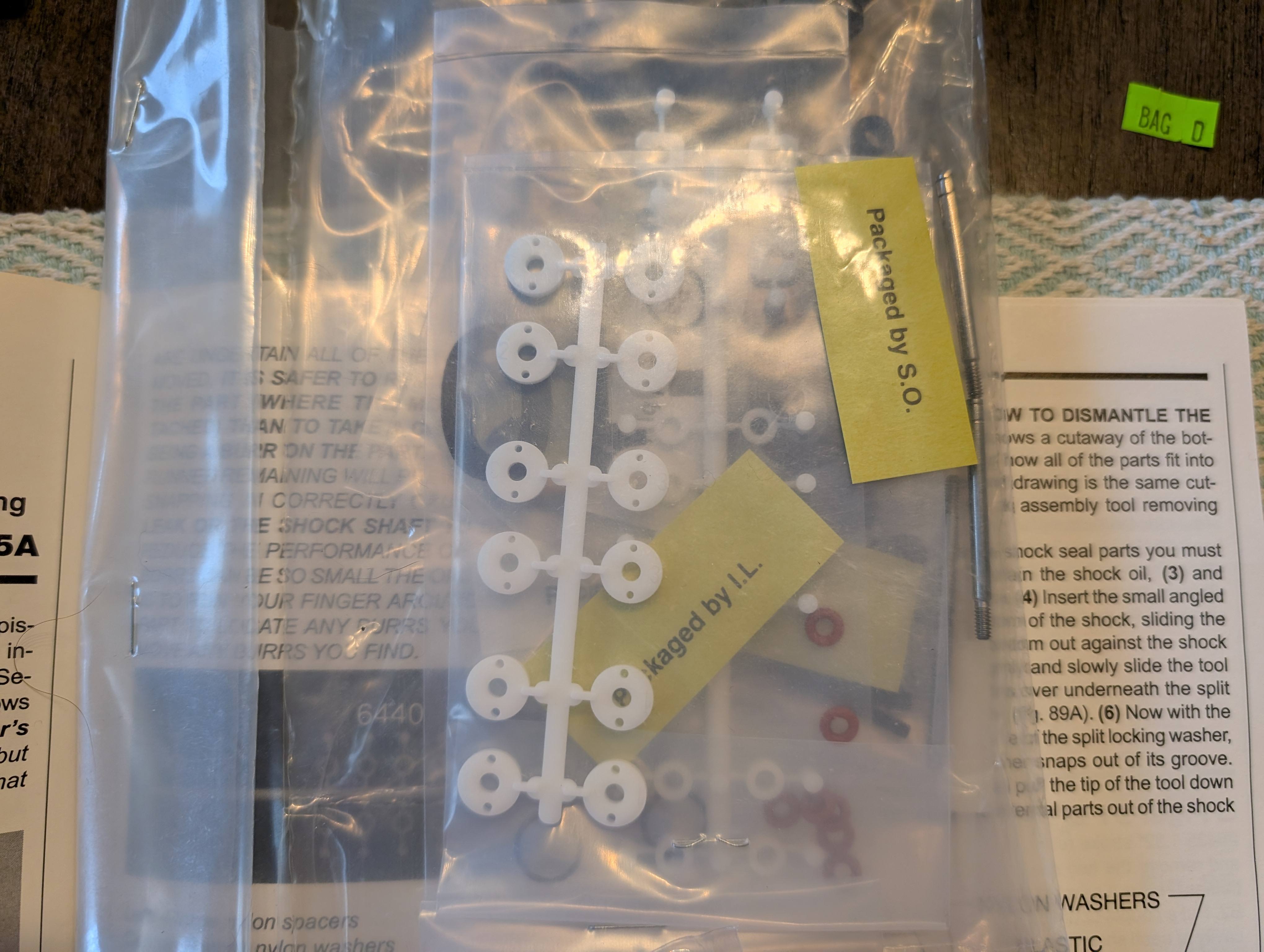

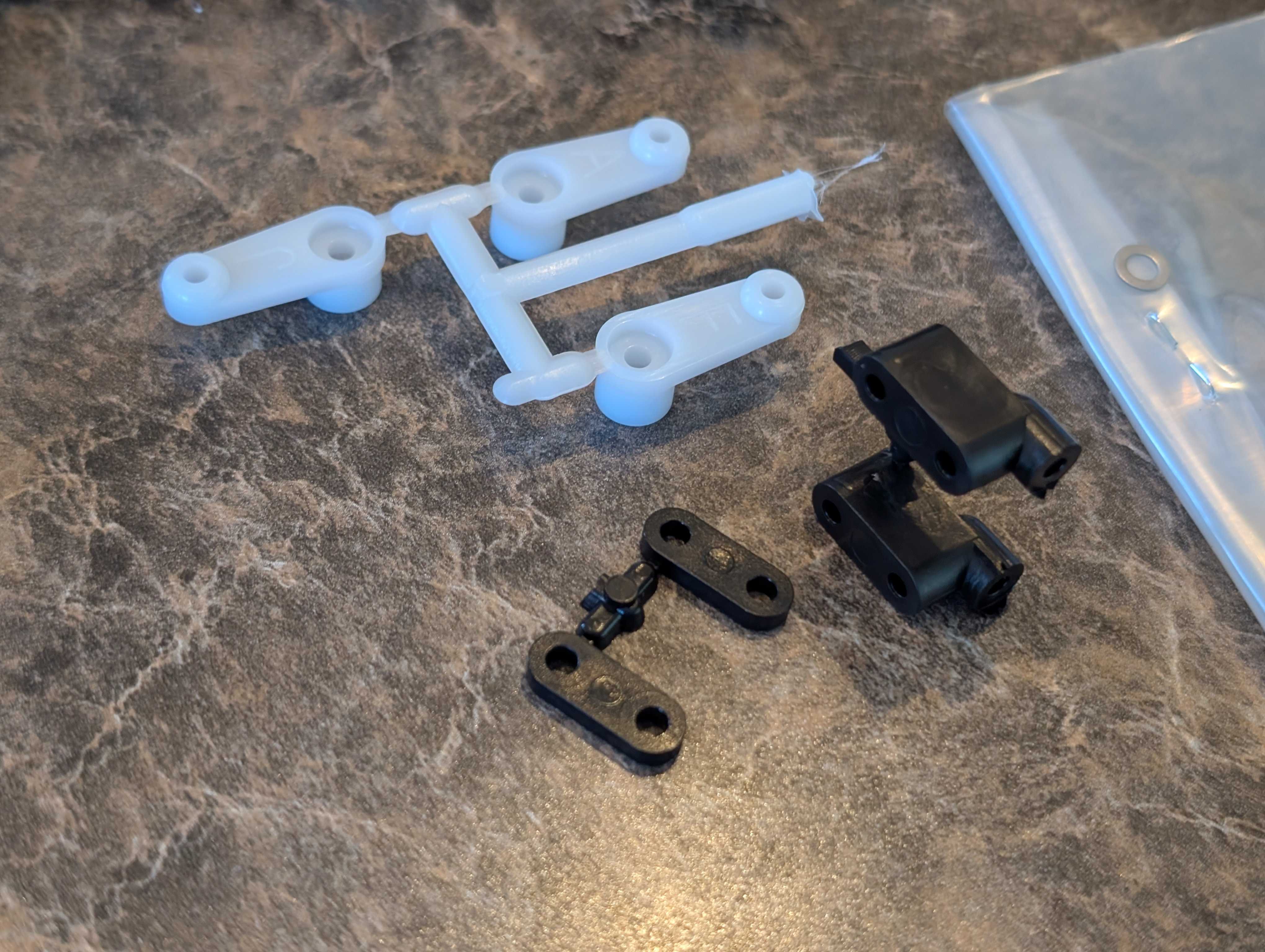

First white part is a silly one, but I dig it! Rear hub spacer. It was black in my later B2 kit back in the day.

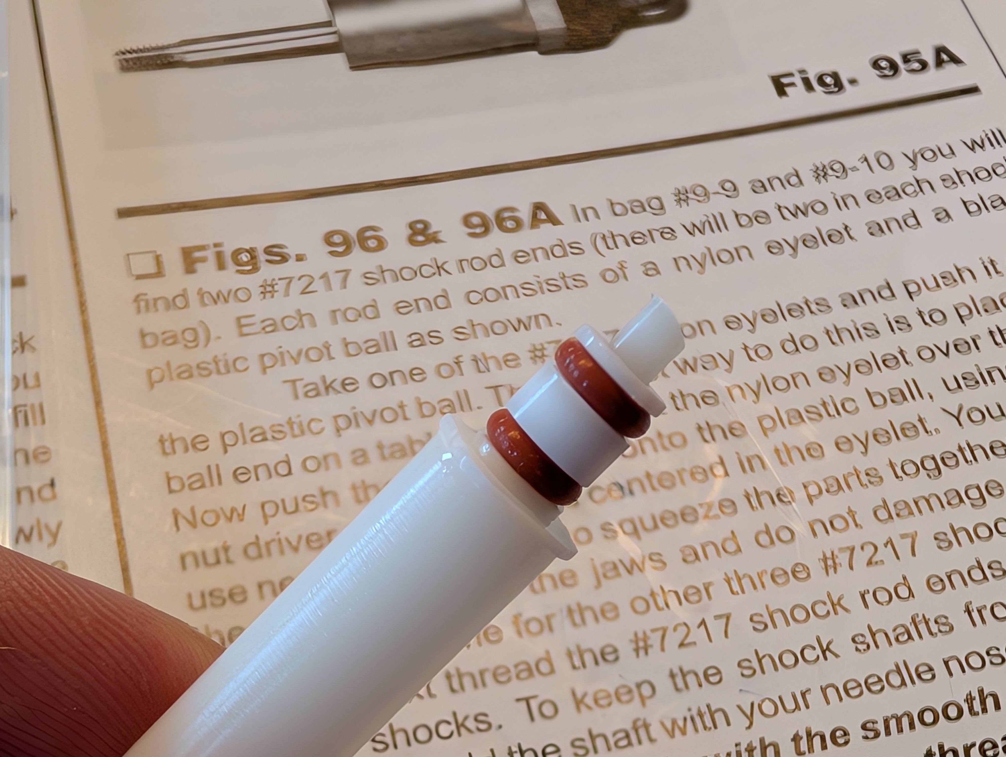

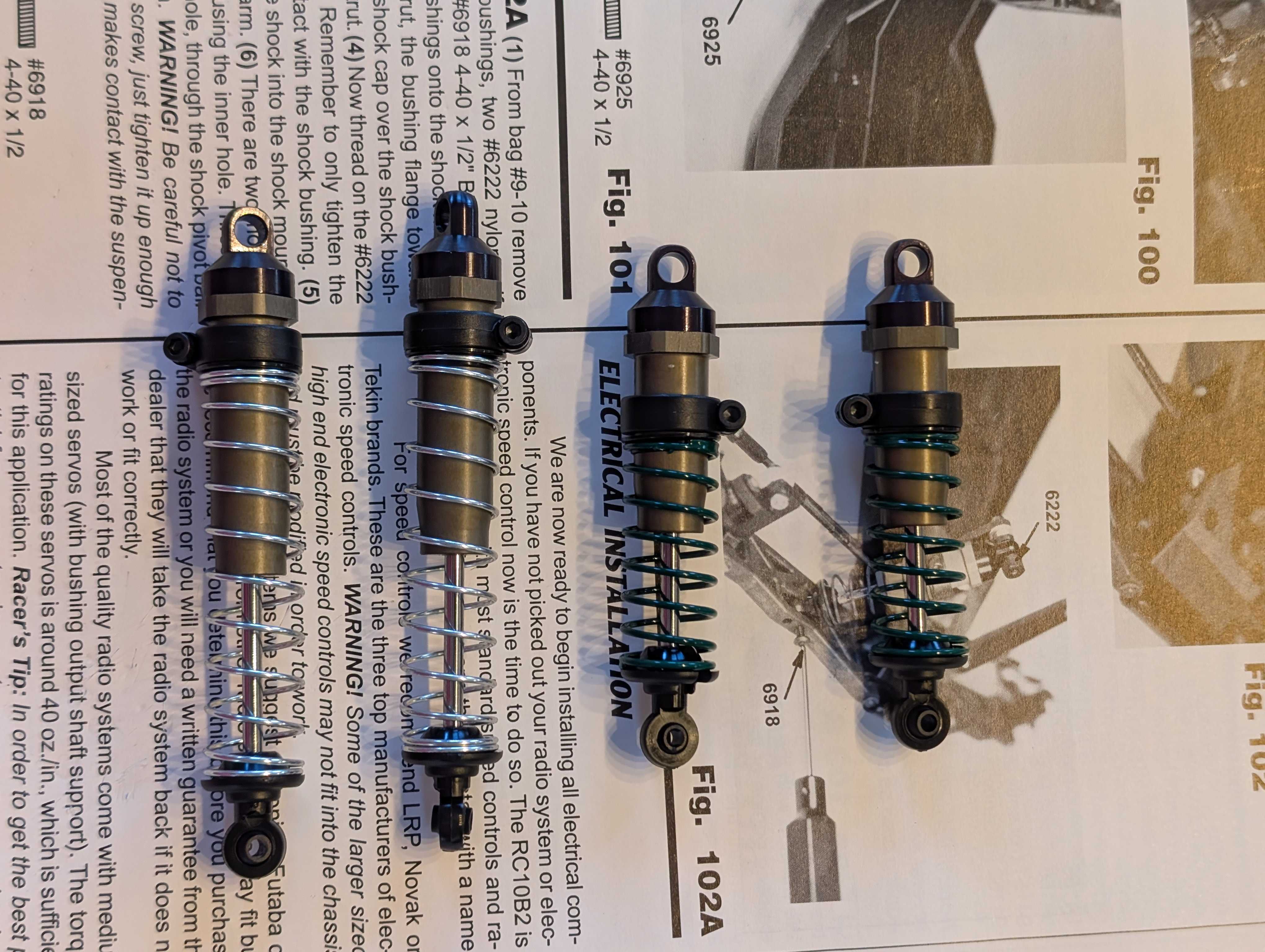

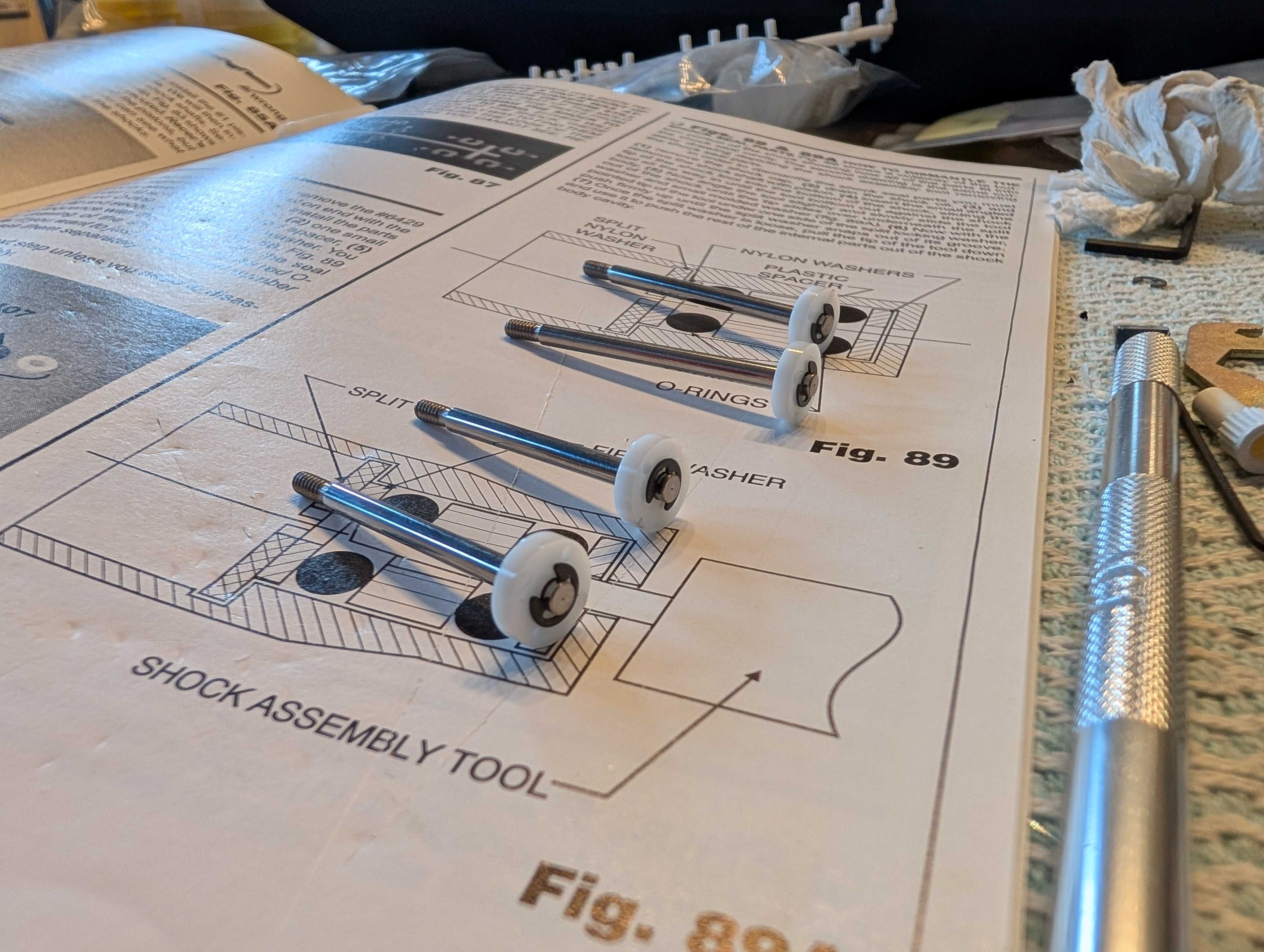

Time to build the best shocks in the industry
All nicely trimmed. Suck it 14 year old me!
Ah, air bubbles...
Would ya look at that!?

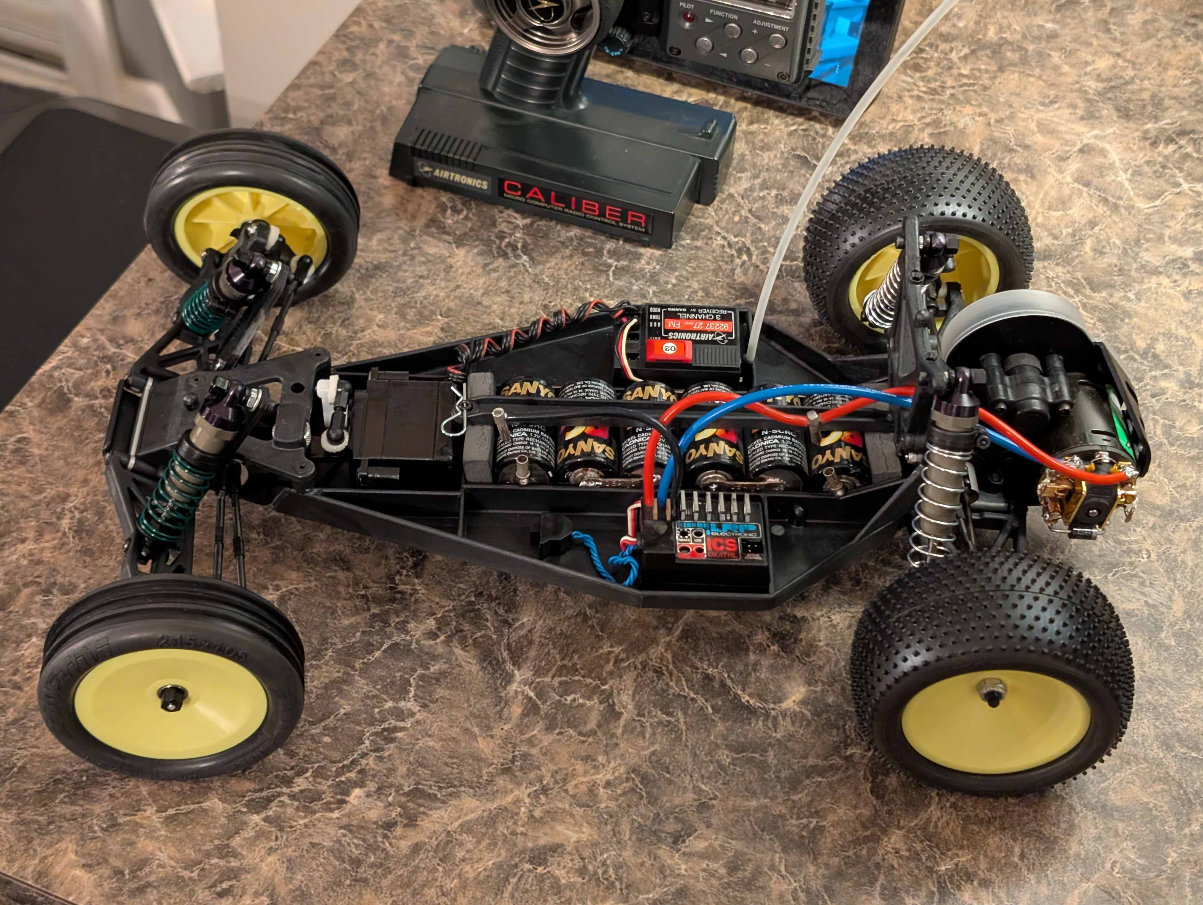

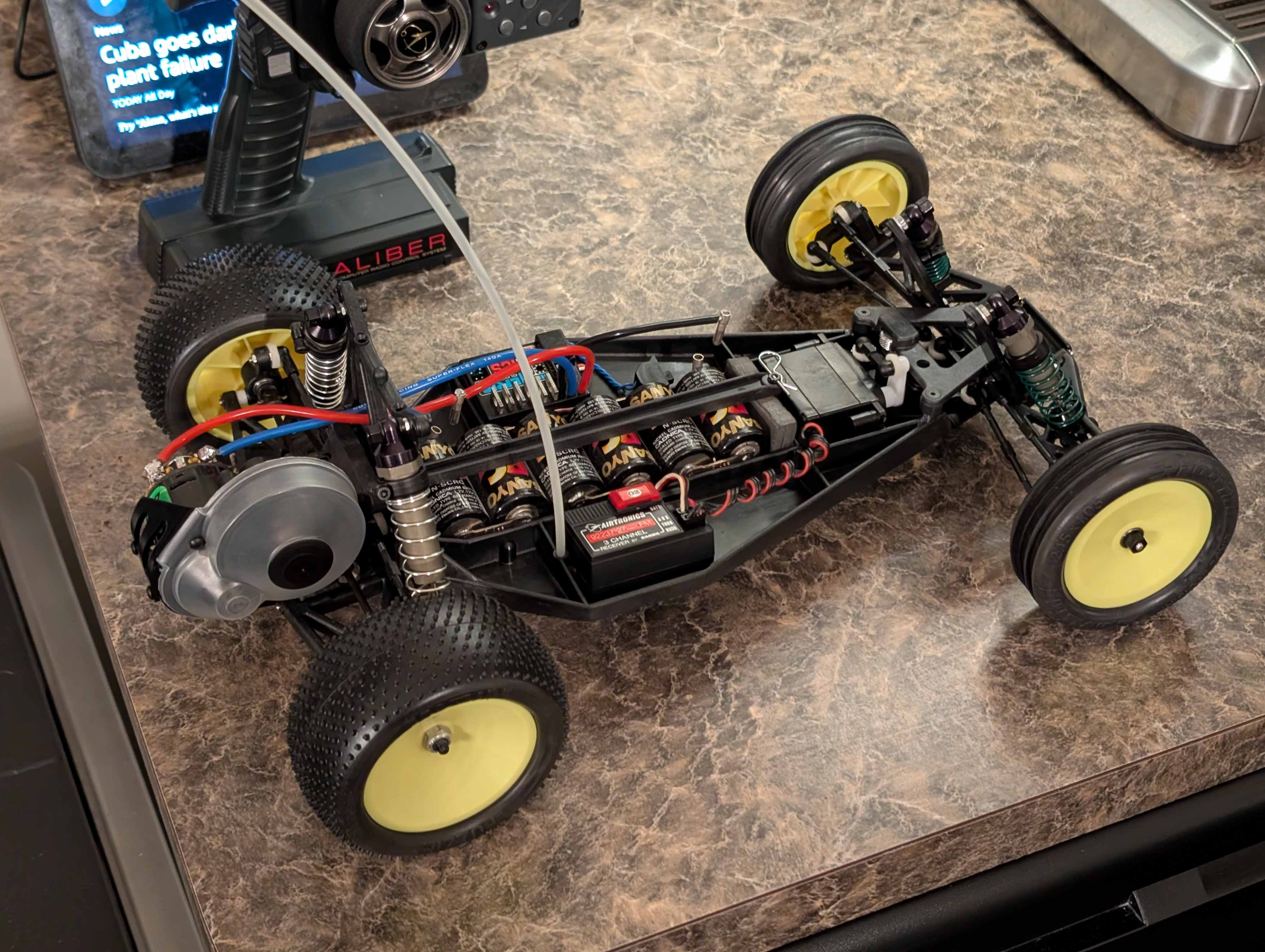

Alright, we're in the home stretch! I'm getting excited and sad as I get close to wrapping this up. I've really enjoyed this trip back in time, and now that I've done my two favorite cars from my time racing, I'm not sure anything else will come close for me.

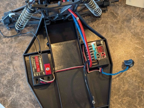

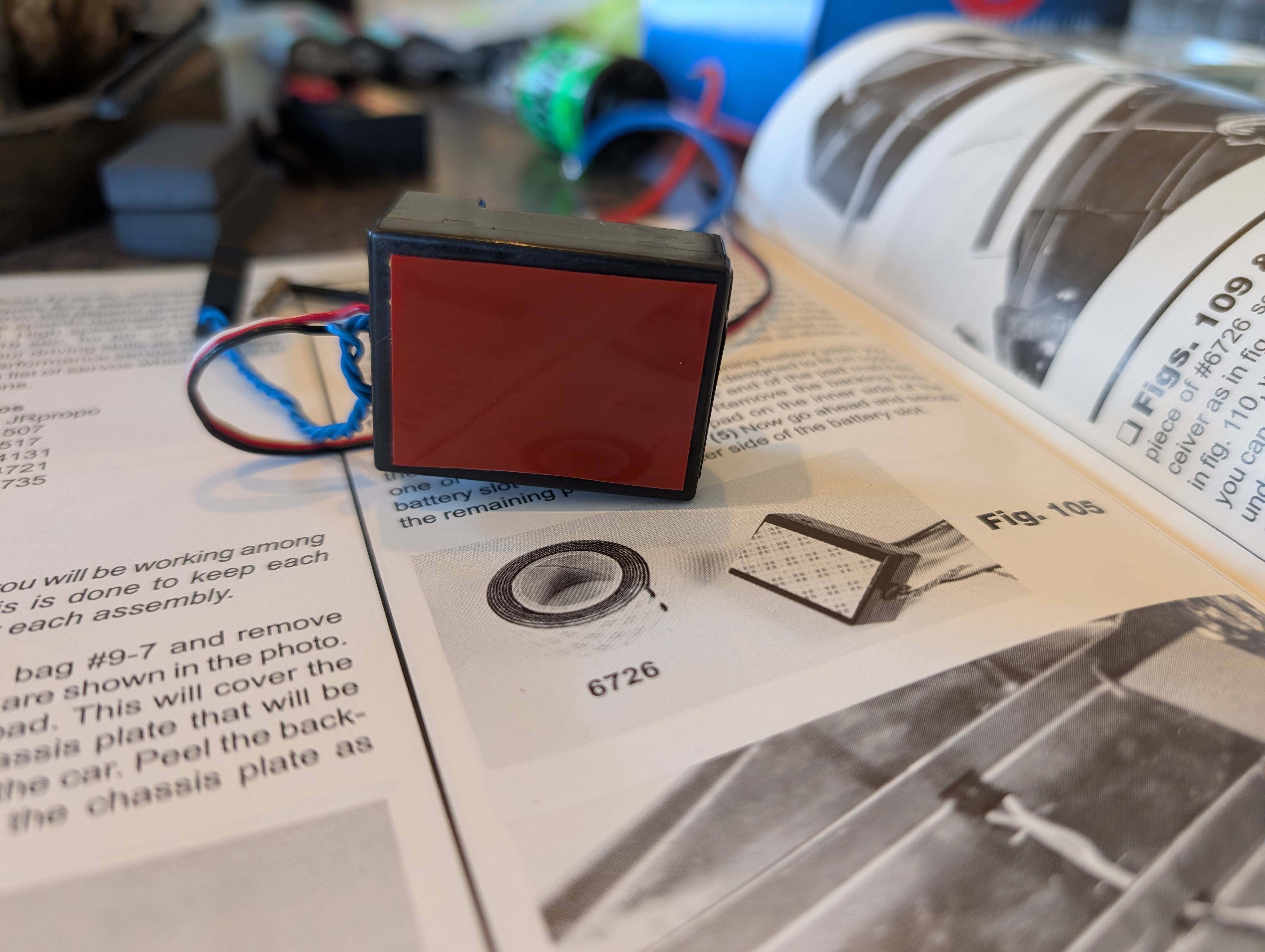

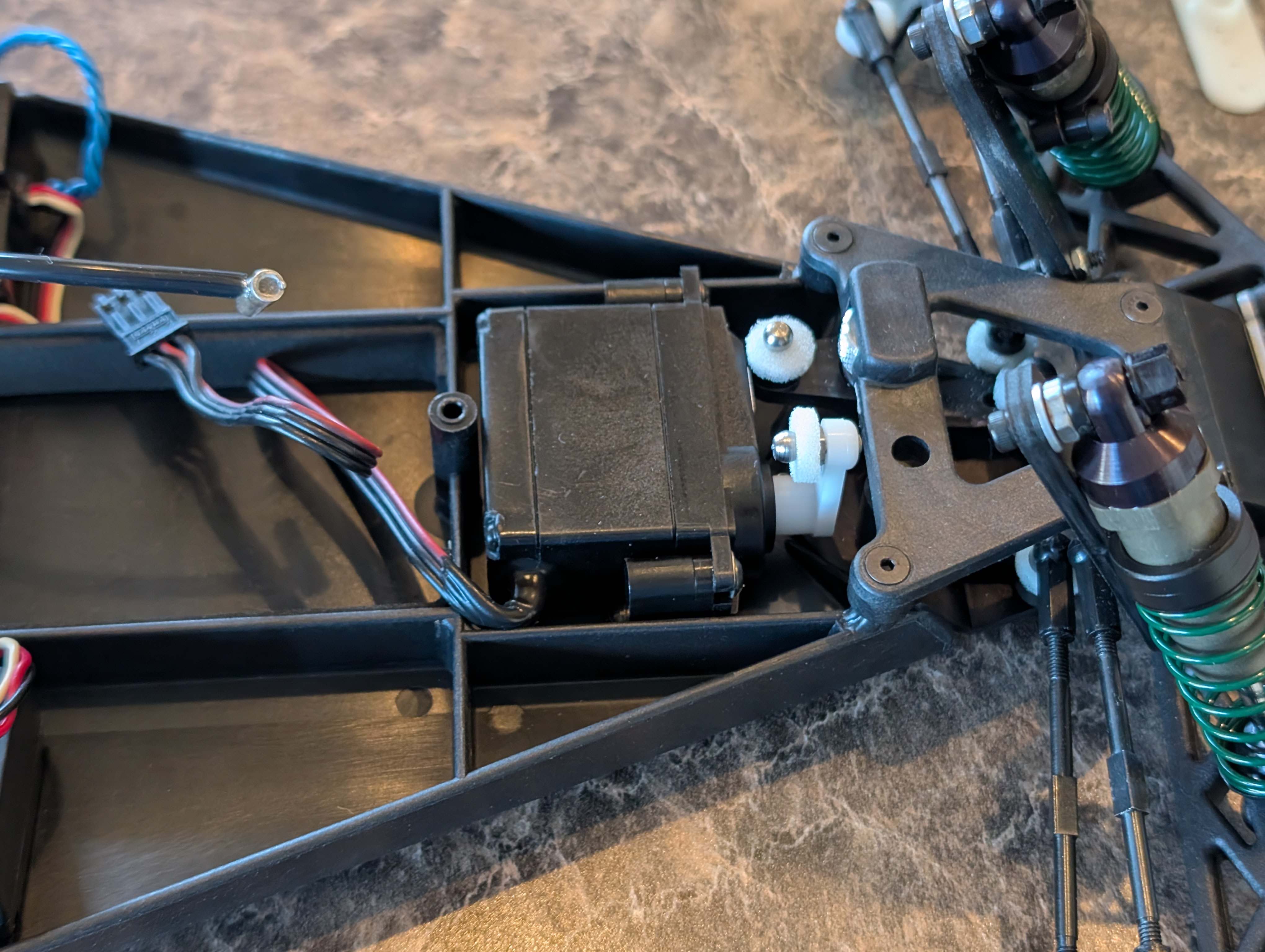

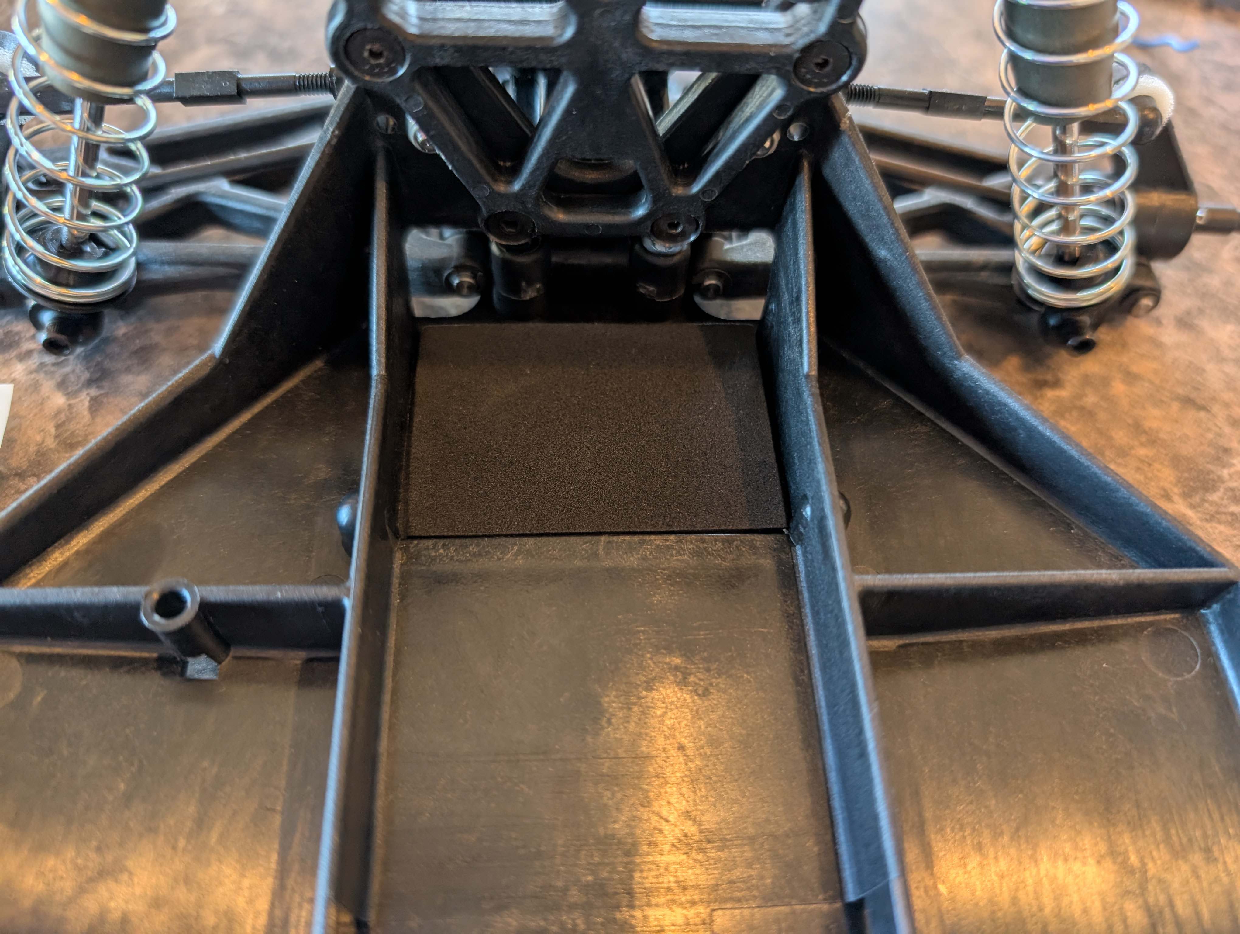

Now that the majority of the chassis is complete, it's electronics time! But first, foam battery pads
I always preferred the Parma style servo tape to what came in the kits, so that's what went on these awesome electronics

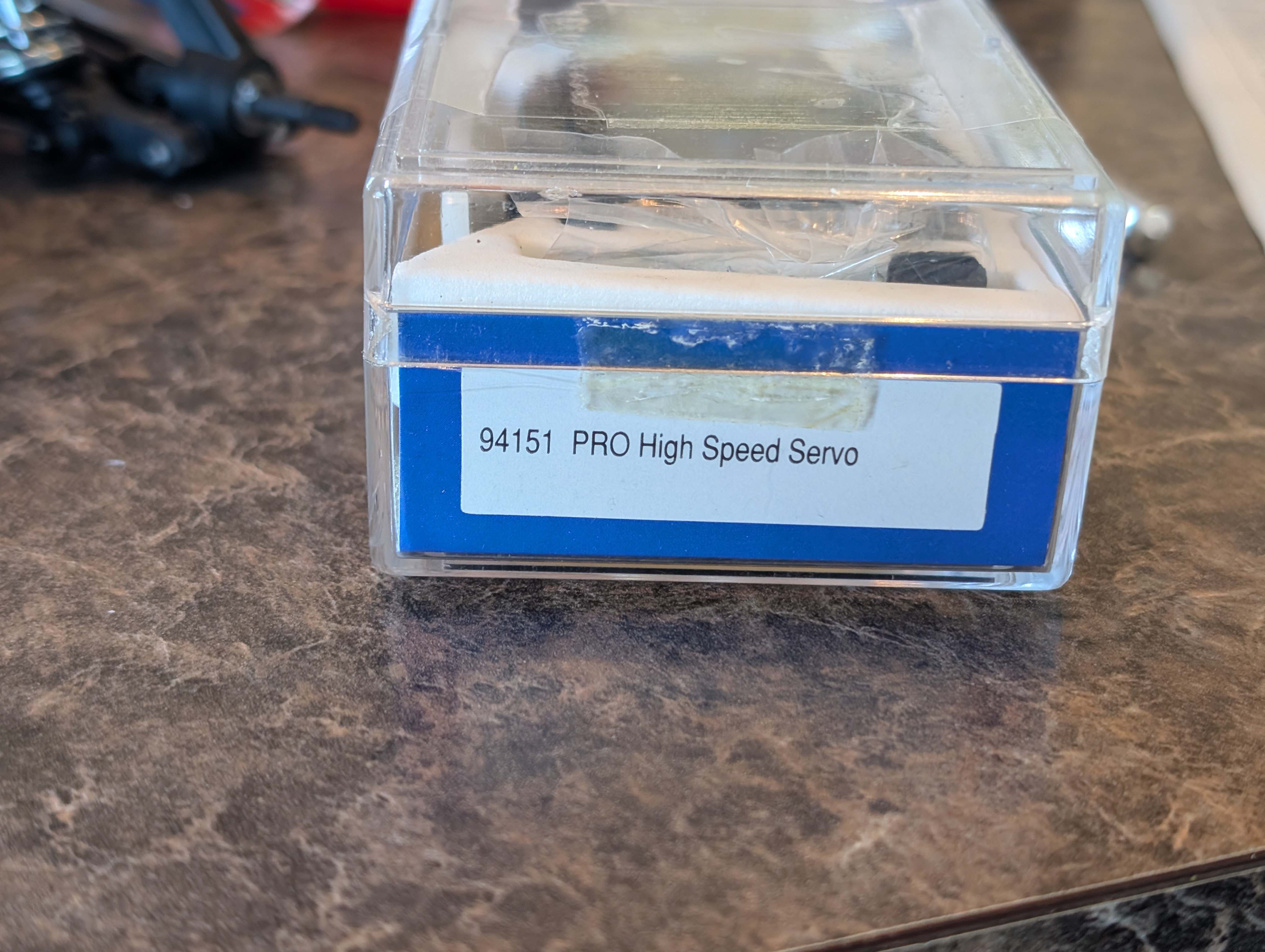

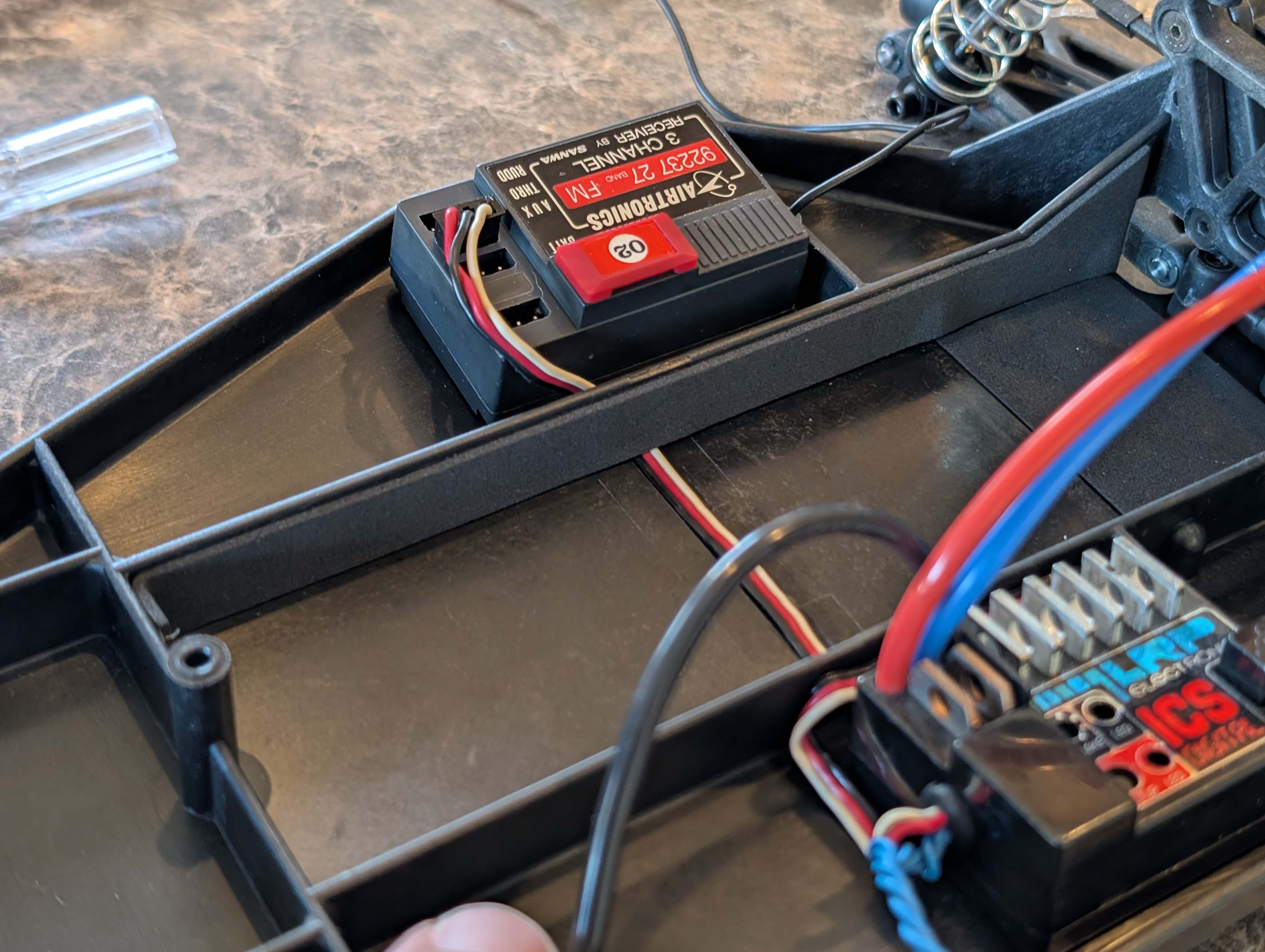

Hard to find LRP ICS, and the Airtronics 92237, as shown in the build manual

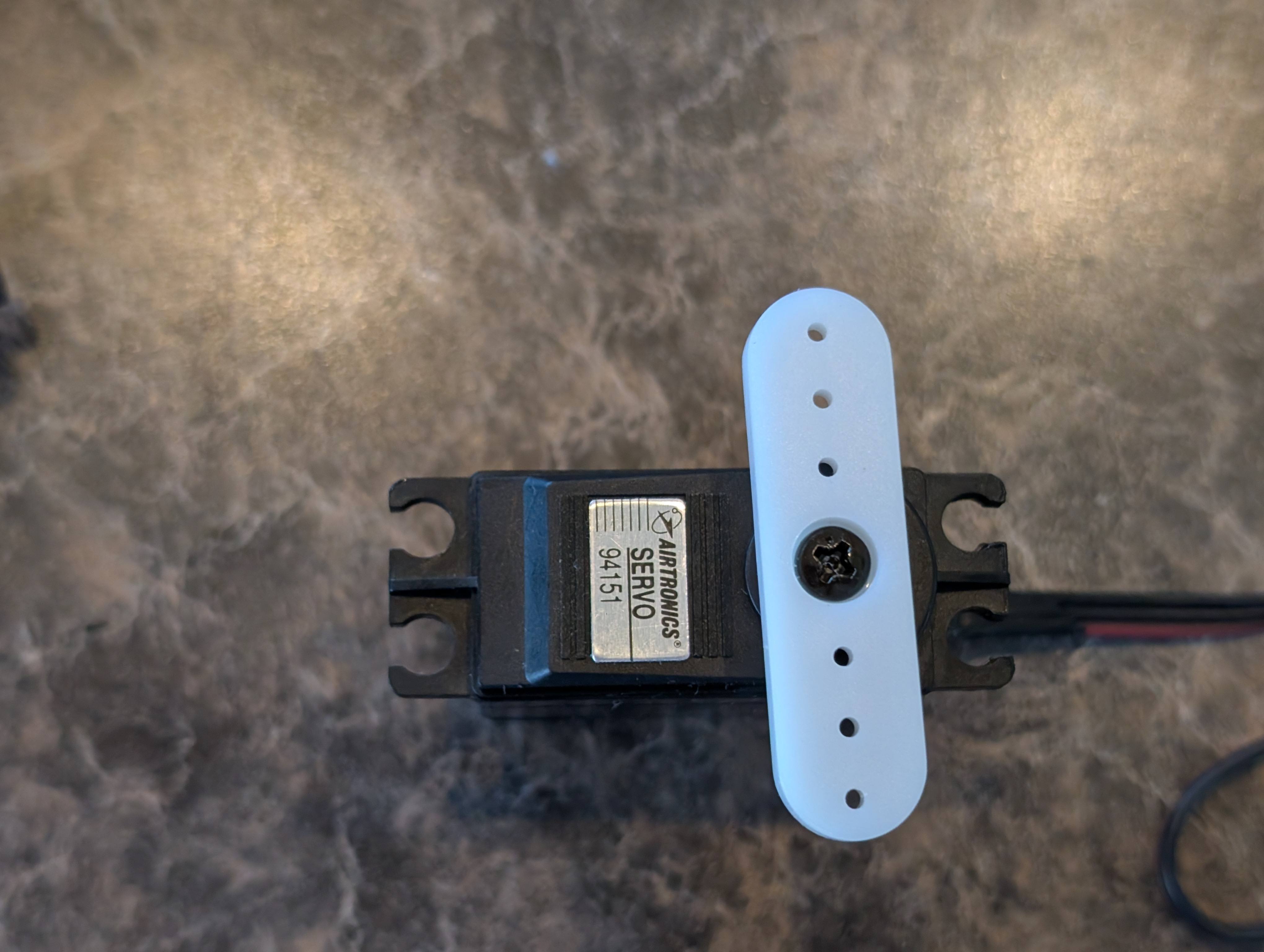

Had to go slightly older with the servo. Found a barely used Airtronics 94151. Did the 95155 ever really exist!? Never had an opportunity to buy one. Maybe someday.
Servo mounts are the original shape. Flat sides instead of the later rounded/curved version found in the late B2 and B3. Not white in this kit, but it did come with the really hard to find white servo horns!!!

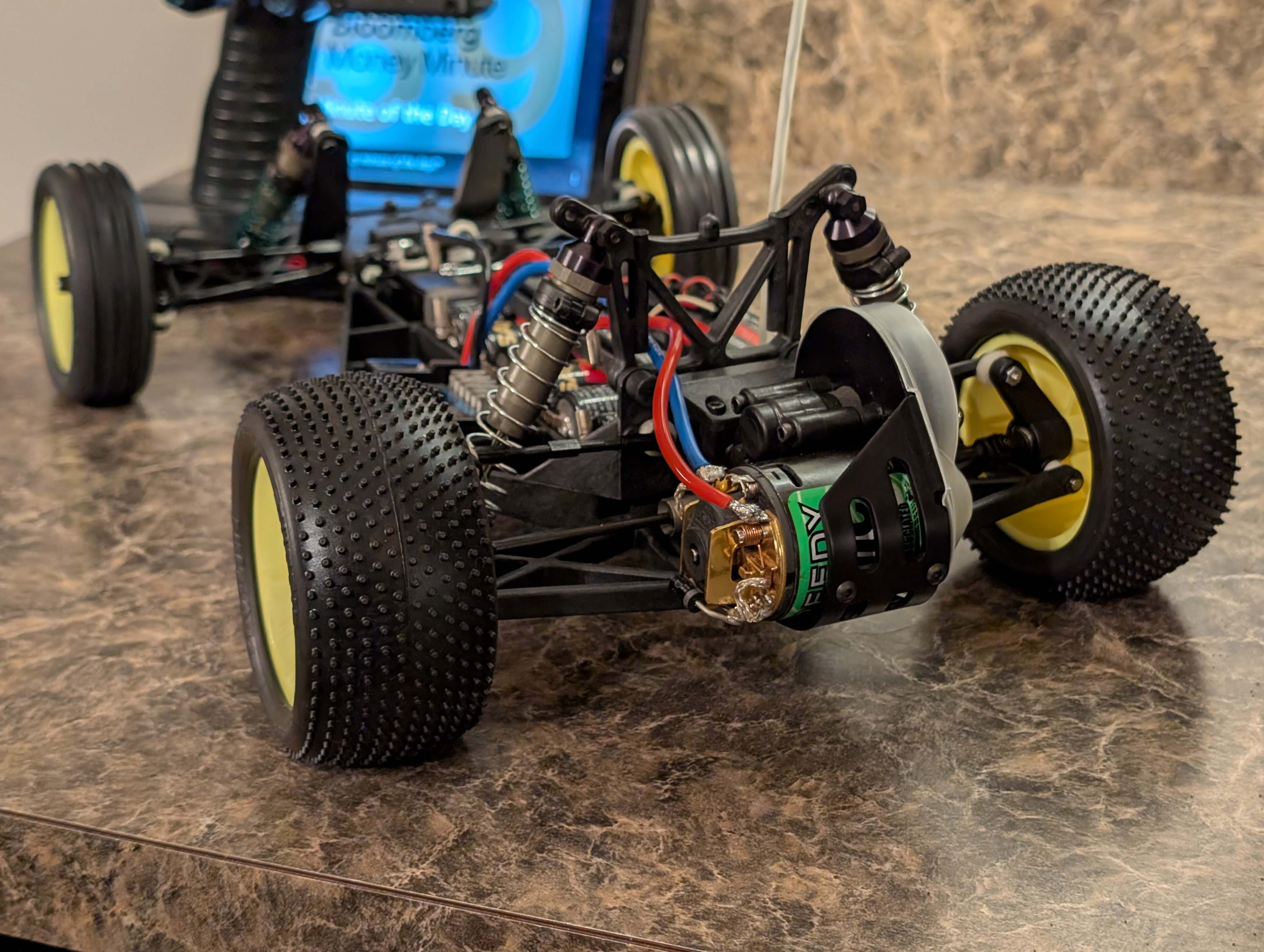

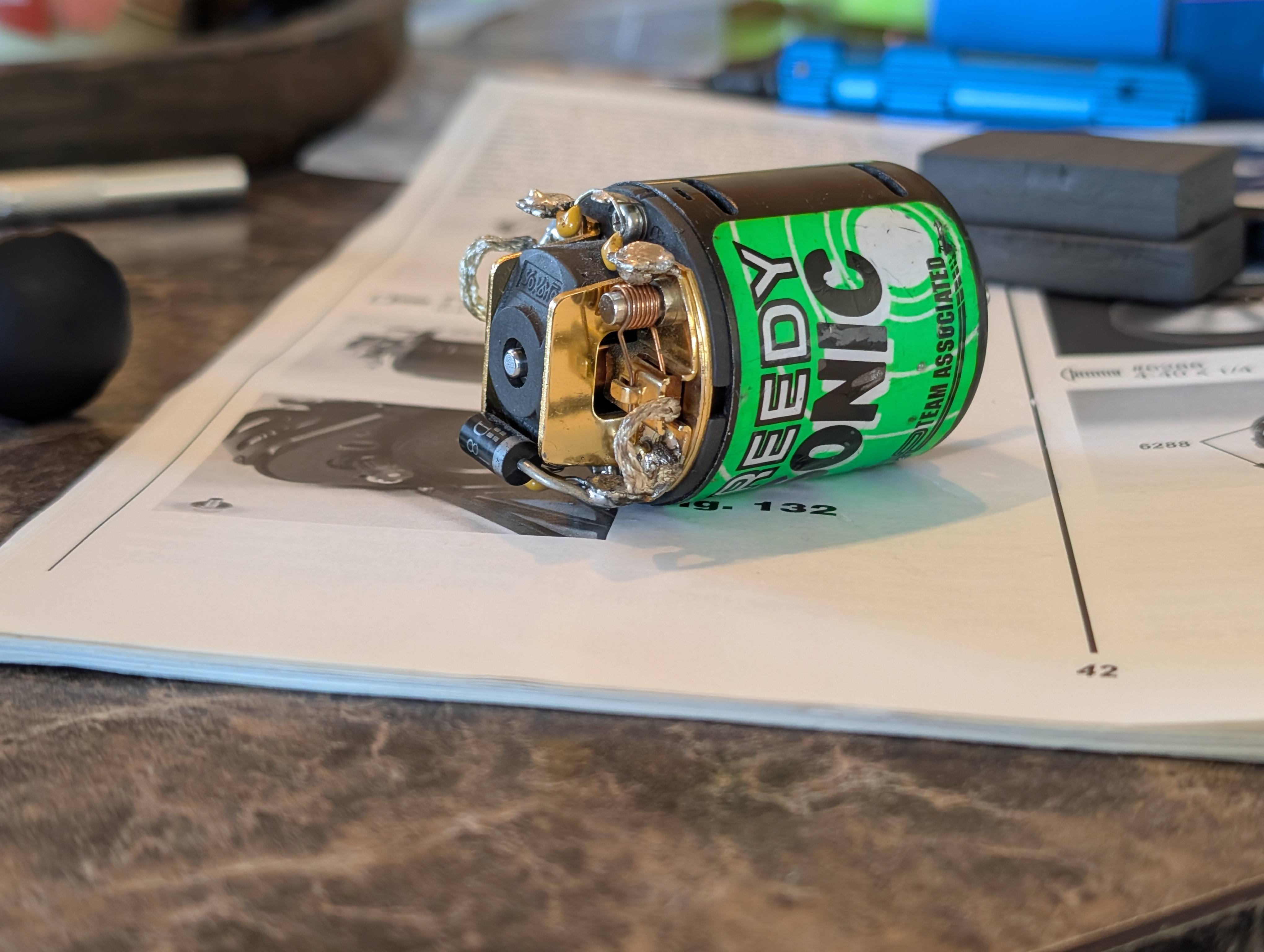

I cleaned up one of my old Reedy Sonics, as finding a new one has proven difficult. Treated this one to new bearings, shims, brushes, and trued the comm in my Cobra lathe.

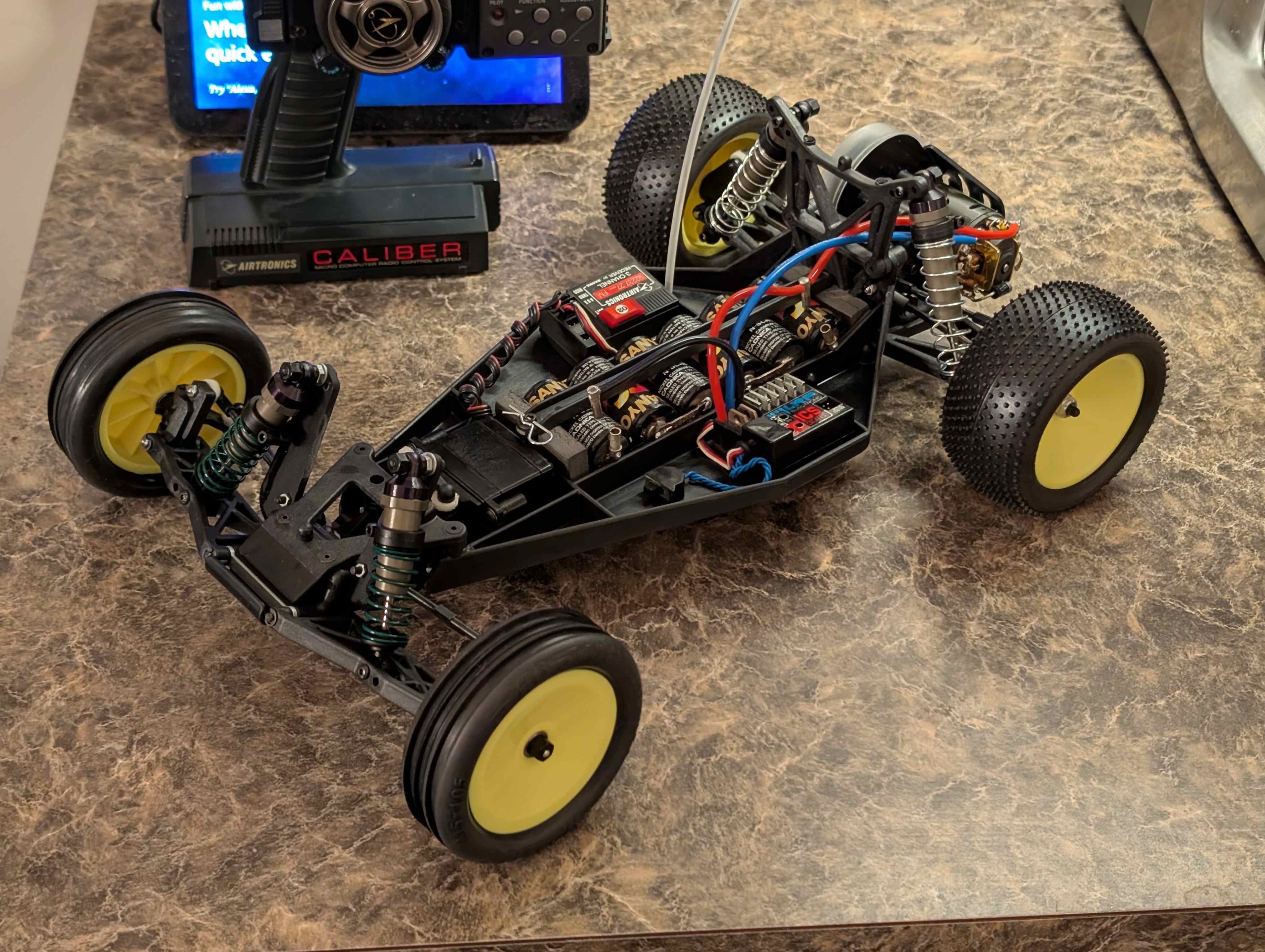

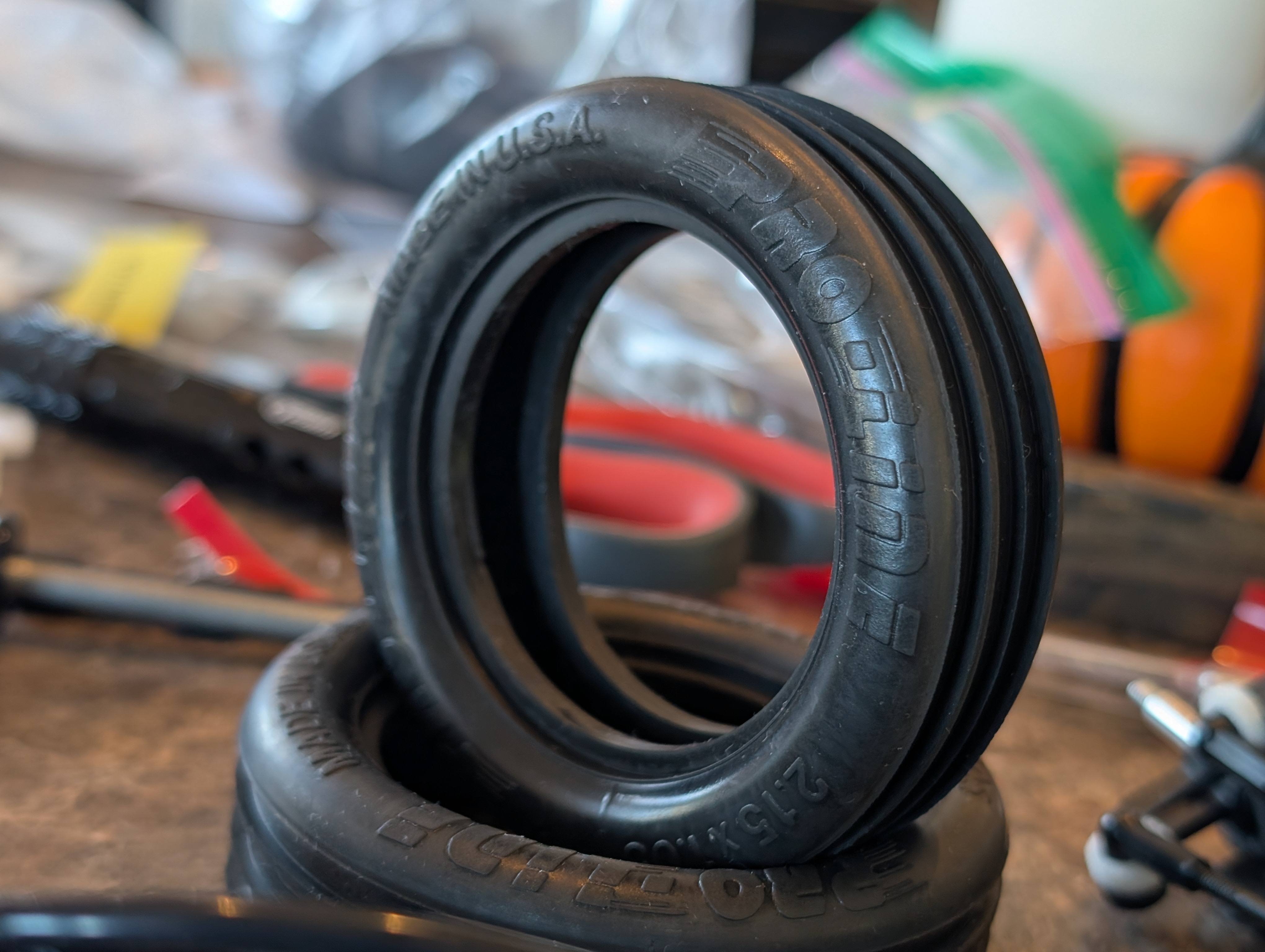

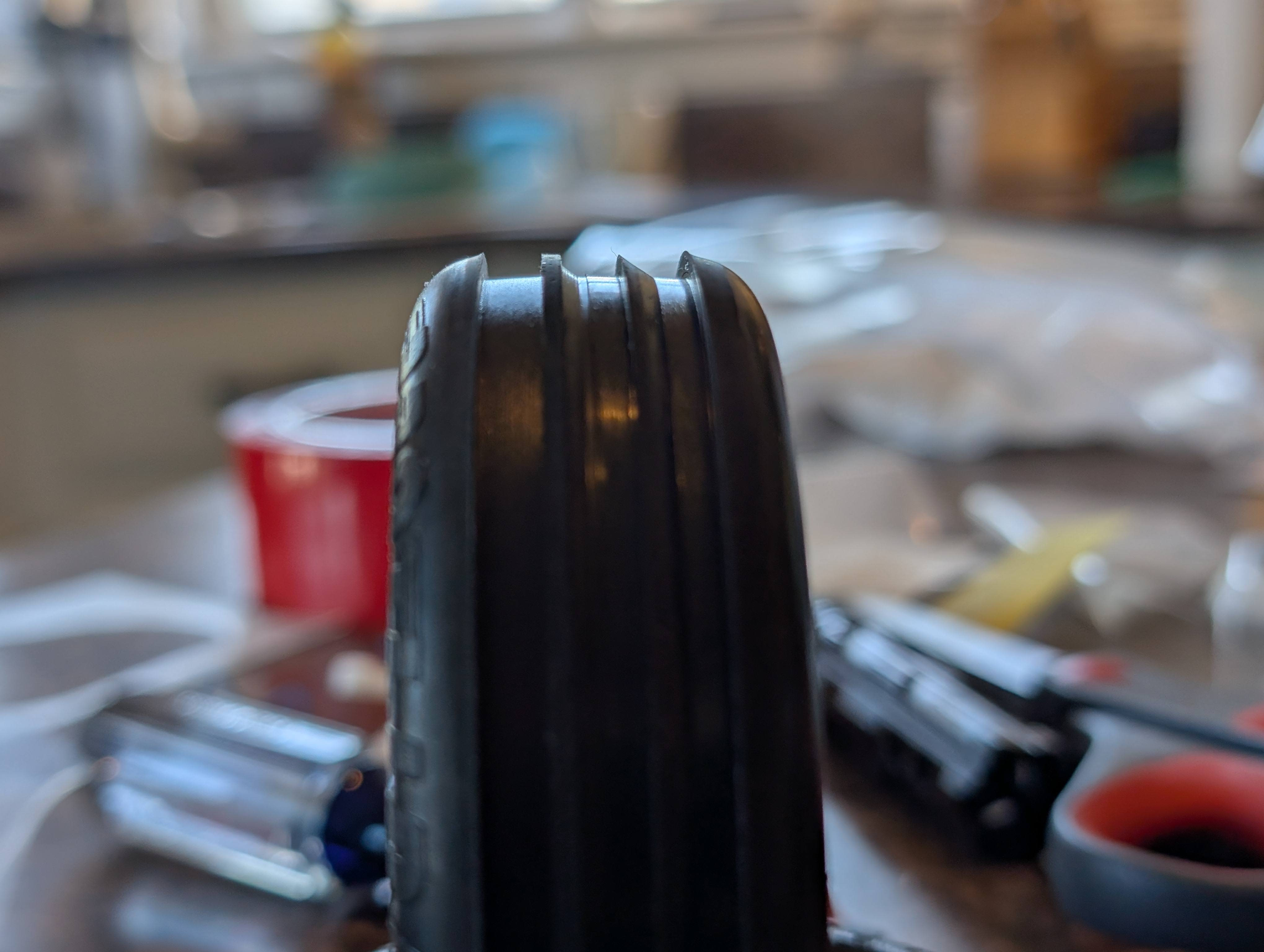

I must keep running into post picture limits. Just needed a few more to wrap up today's progress. For the tires, I have to thank @jcwrks for trading me for the correct fronts. Rears will prove to be a bit more challenging, but until I can track down the Flat Stubbies, a set of XTR Pro-82's will take their place

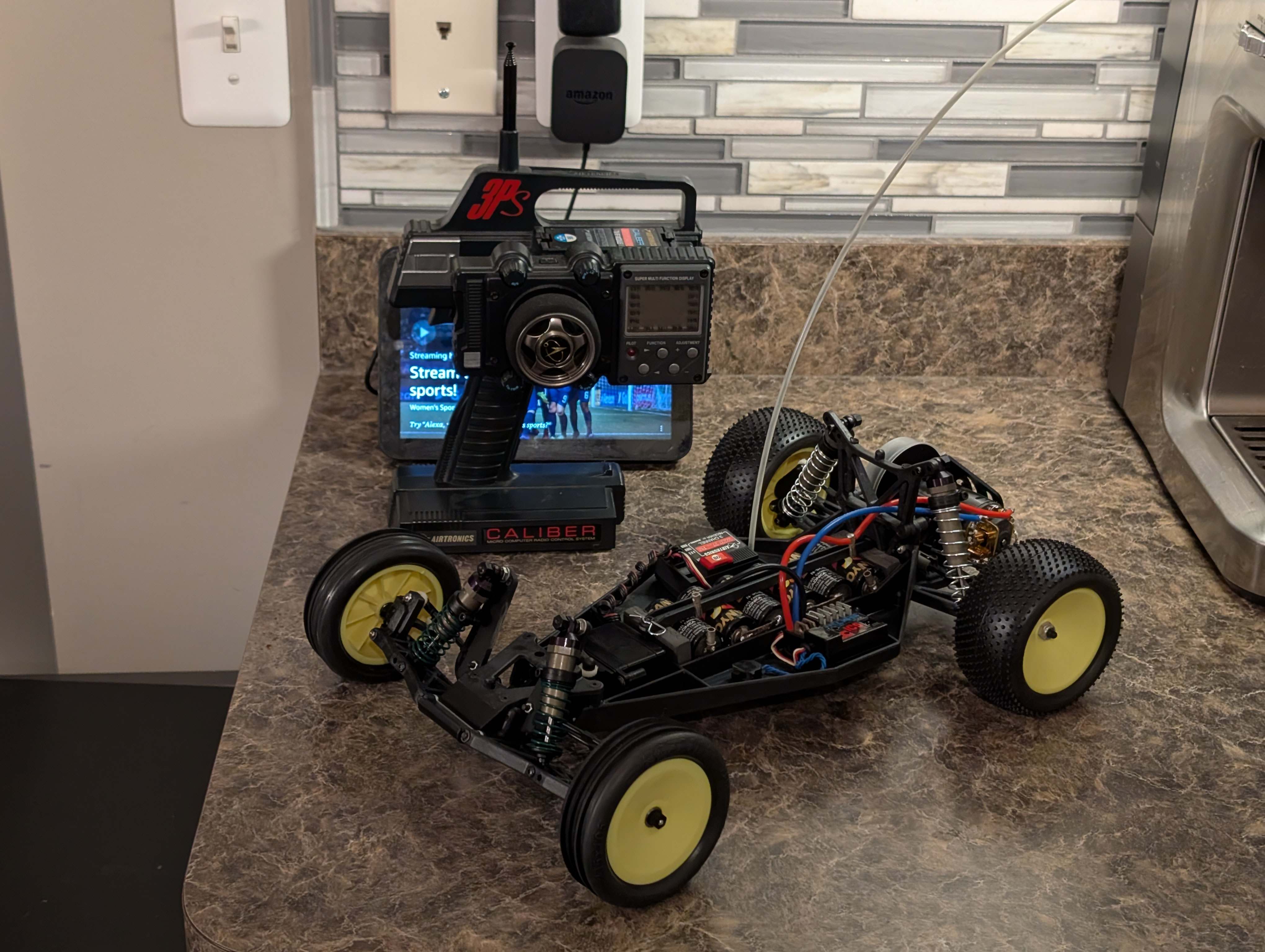

And here are the wheels and tires on the car
All that's left is the body. I just received the stickers from MCI to complete a box art body, so expect that in the coming days!

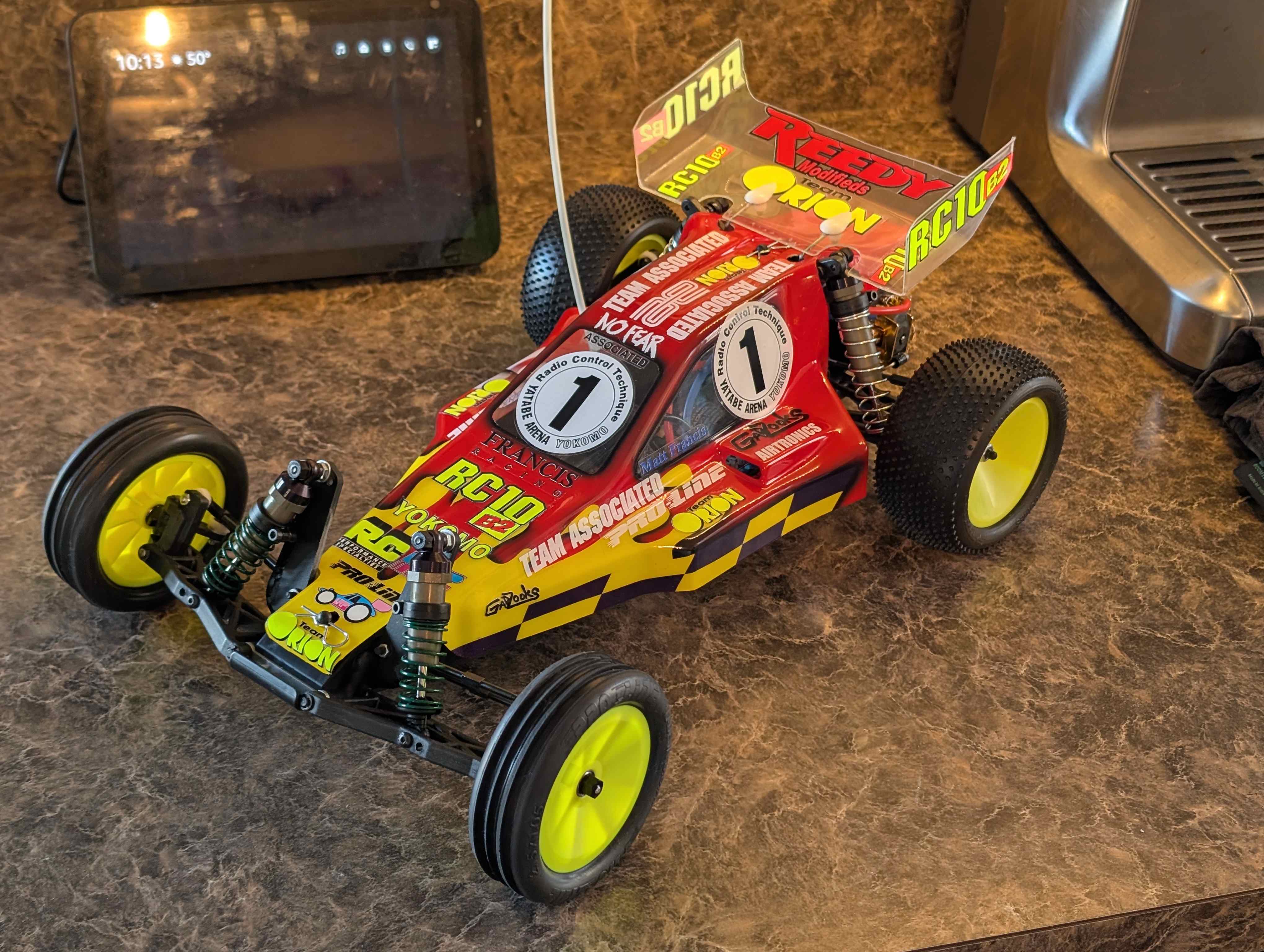

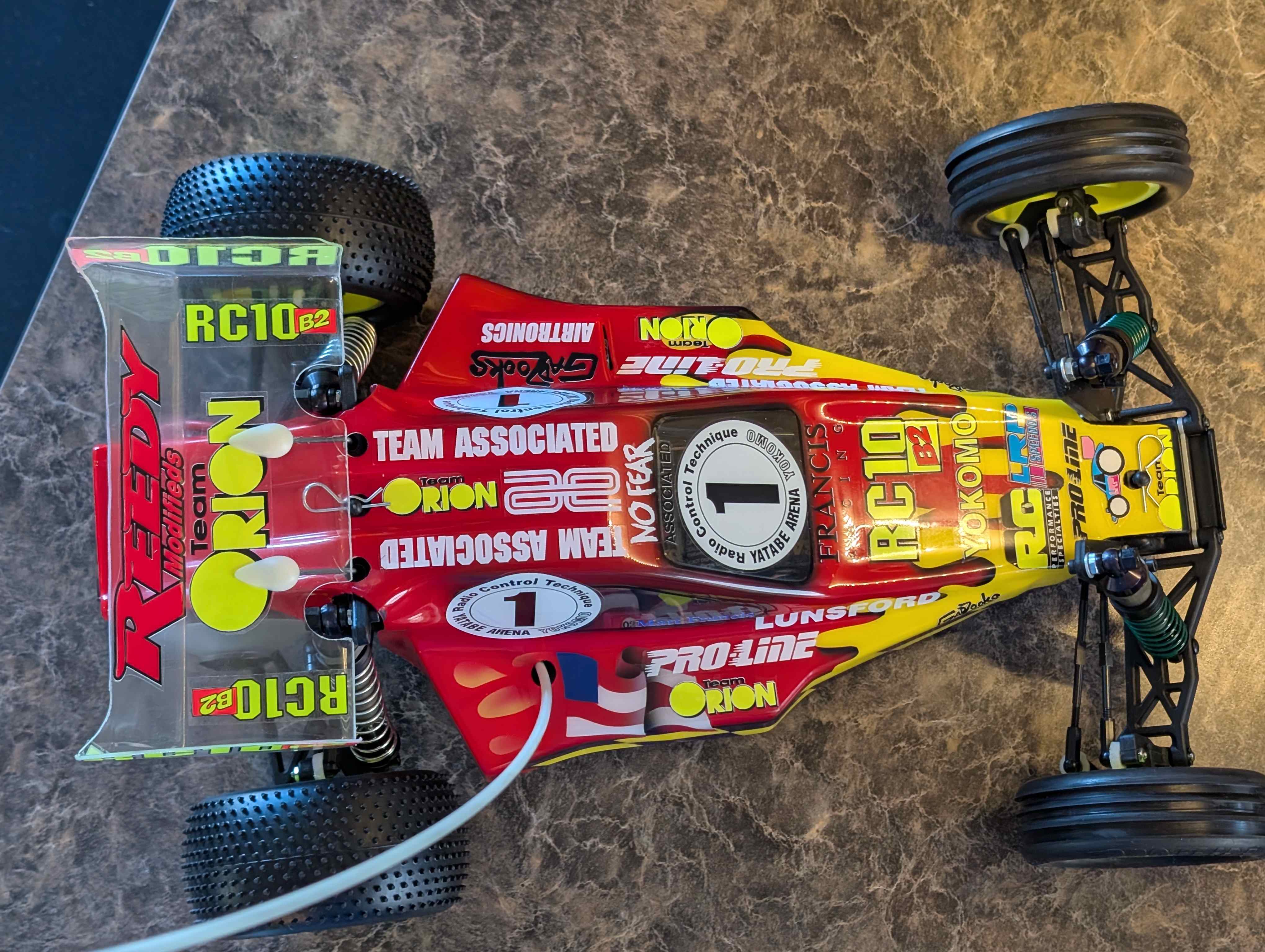

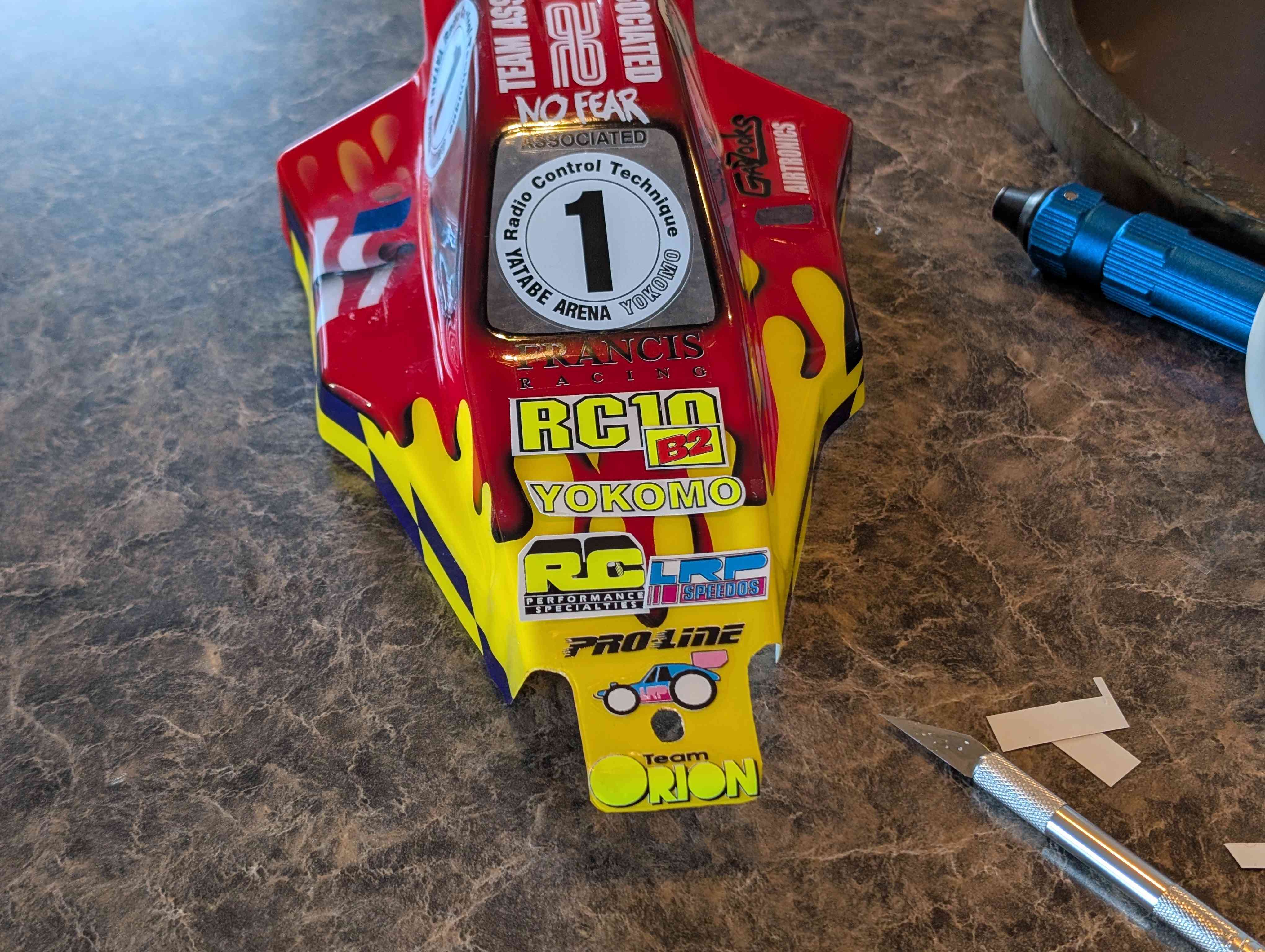

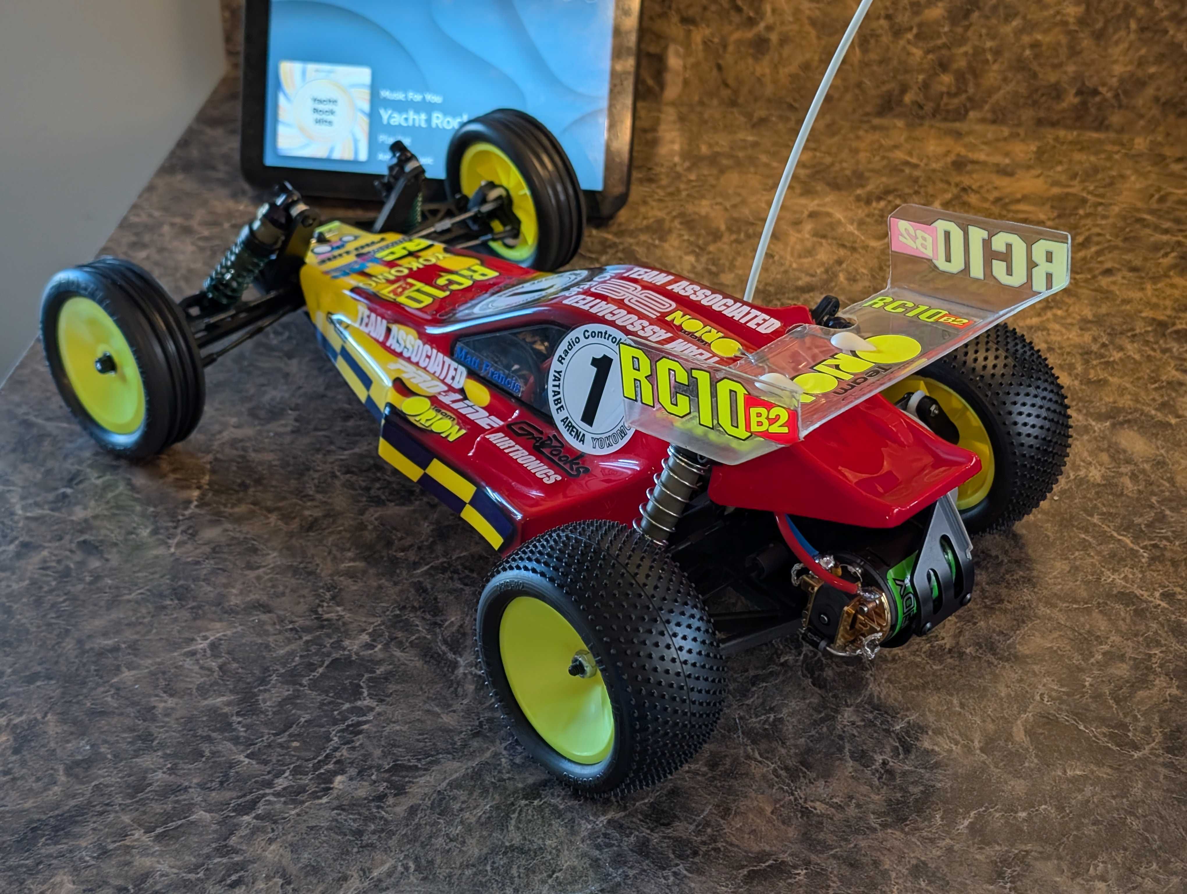

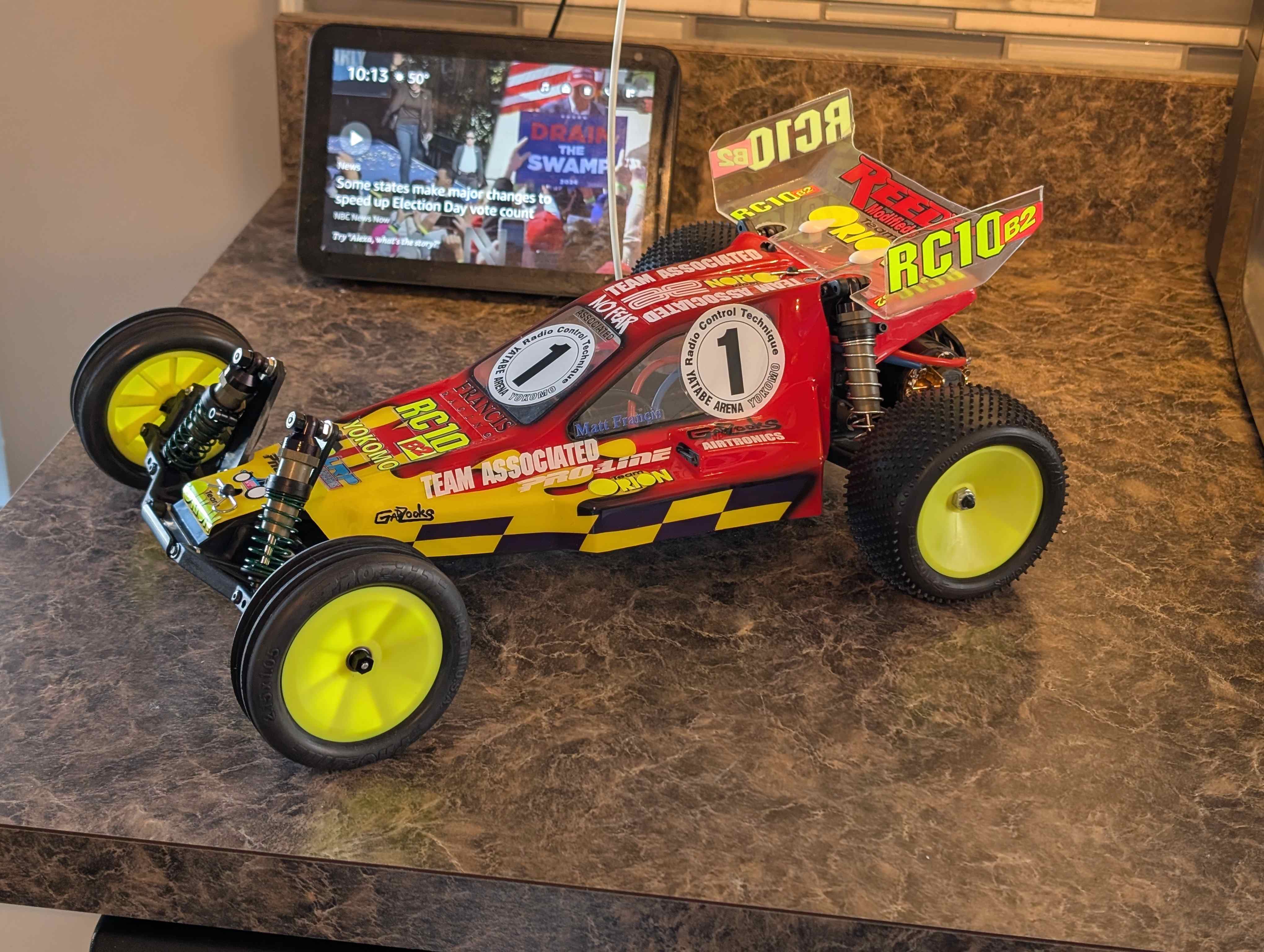

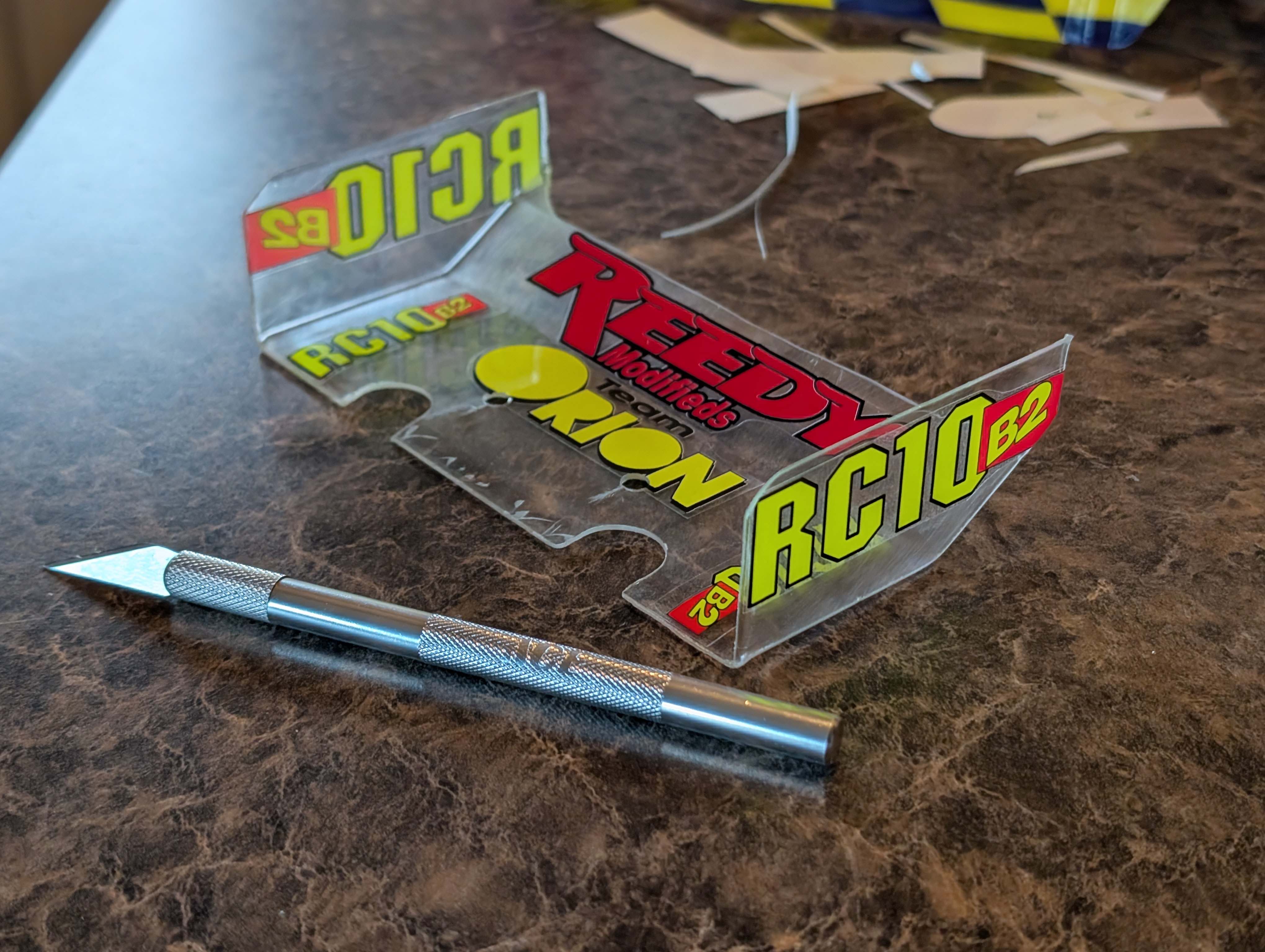

Alright, everyone, this is it. Woke up this morning motivated to get the body done. This is a body I had on another car, so it isn't perfect, but the paint was close enough to the box art/Matt Francis design, that It was worth putting on this ride. I removed the stickers that weren't correct, and between what came in the B2 kit, and what MCI has to offer, we have what we need!
Here are the stickers

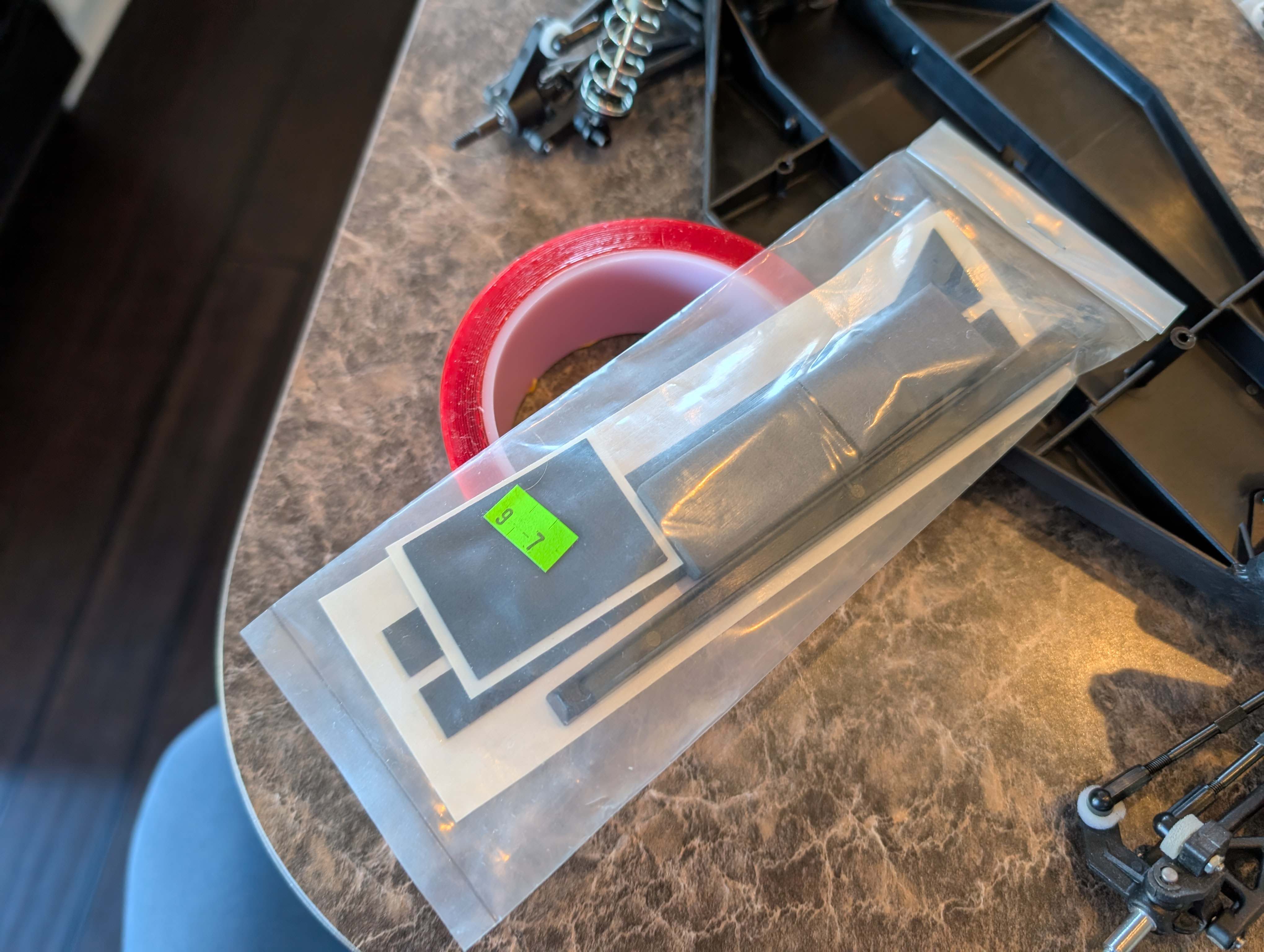

Doing the wing first
Test fitting to the body

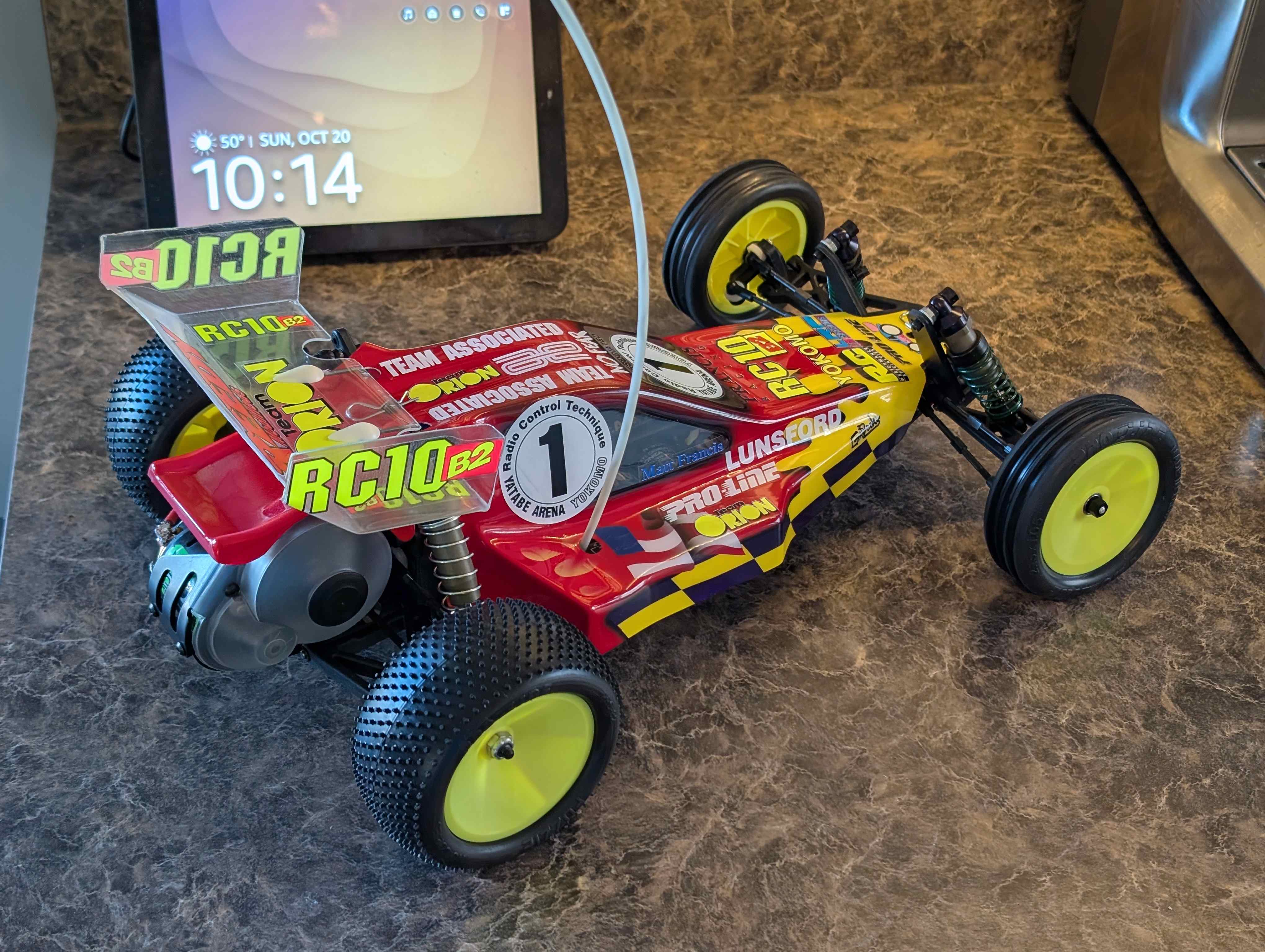

And...the finished product
Original box art car, the inspiration for this build
IMG_6866 500_J66UTESb3D.jpeg (56.16 KiB) Viewed 3095 times
Thank you to everyone who followed along, or will enjoy combing through this build in the future. Most fun I've had on a build in a long time. This car is also fully functional. Just drove it around my house haha! I'd also like to thank everyone who owned this kit, for keeping it safe and unbuilt all this time

One last post. Thank you to these wonderful Team Associated employees for packaging this thing so well nearly 30 years ago!
