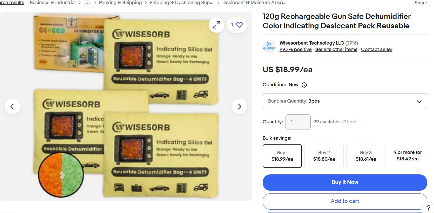

My filament dryer arrived today. I'm shopping for economical rechargeable desiccant packs to drop in the zip-lock bag for long term storage.
I've found these on ebay:
Over $6 each so not exactly cheap. Bulk silica beads in plastic jugs (i.e. 2lb) can be purchased for less but I'd still need to divide the beads into smaller containers for use in the filament bags that are porous and micro-wave safe for recharging. Using packs should be more convenient.
