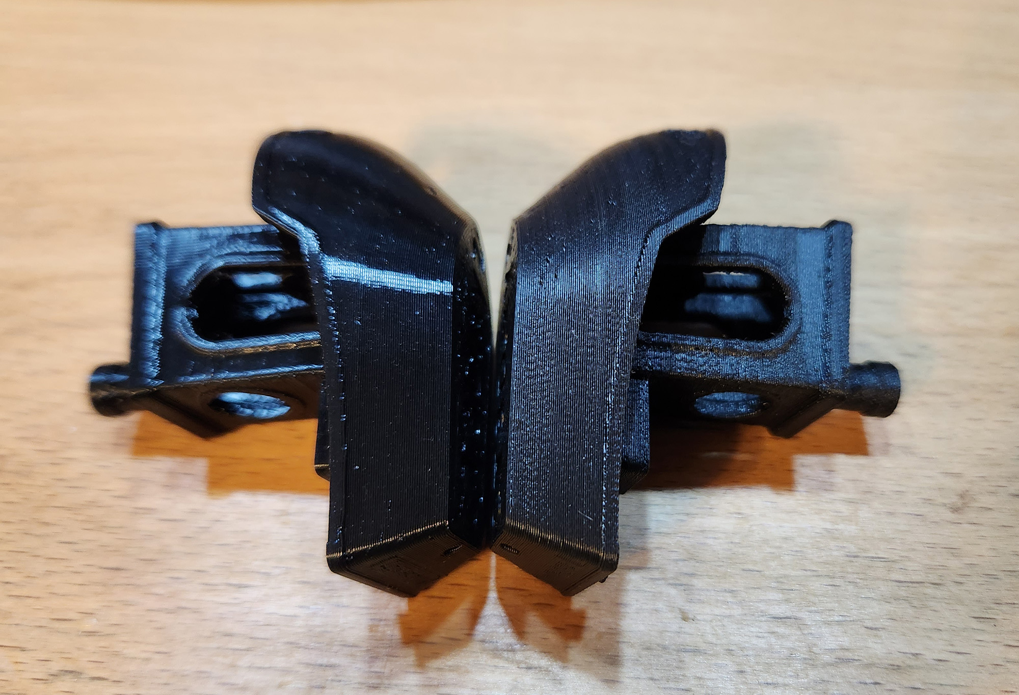

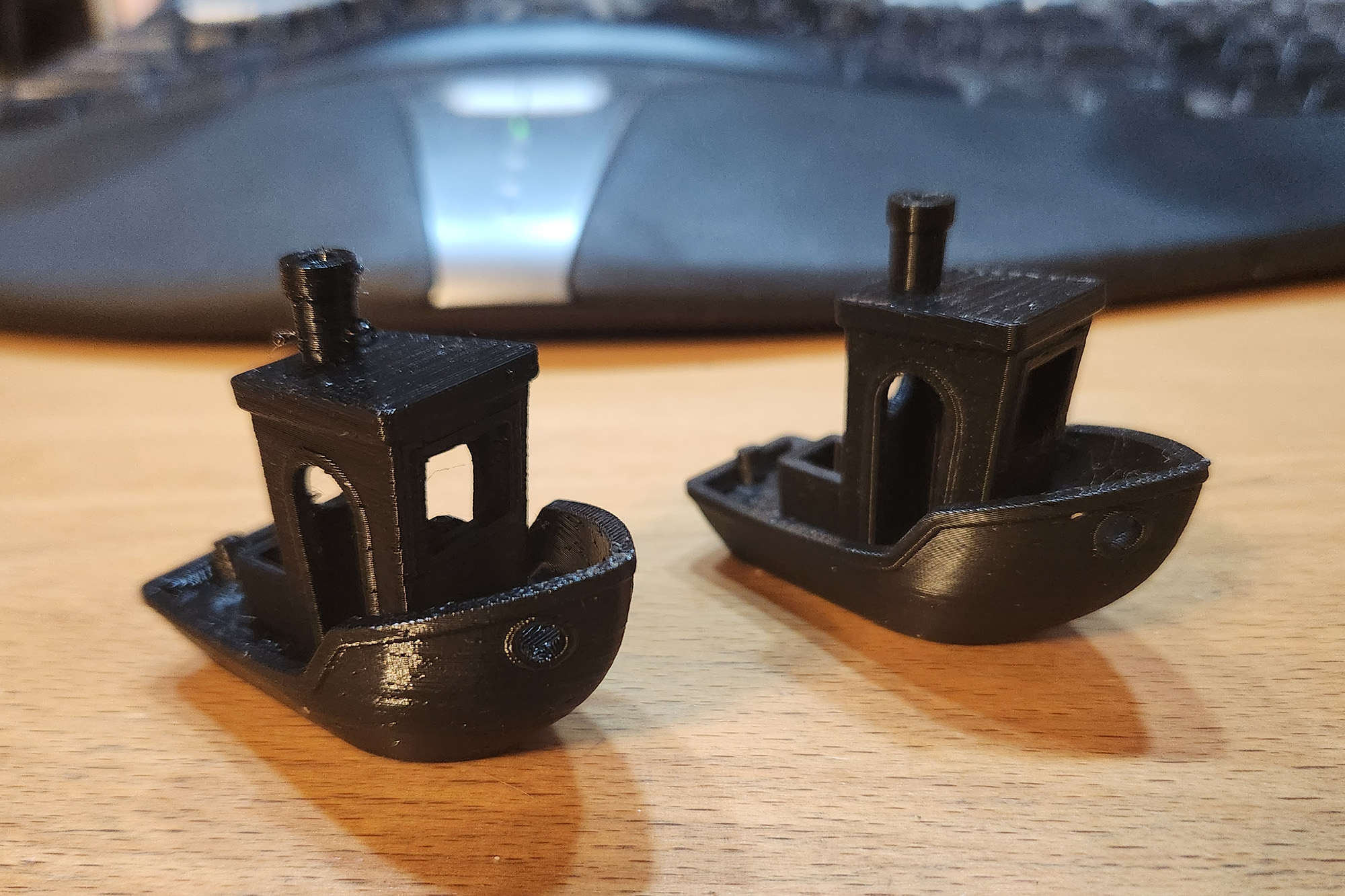

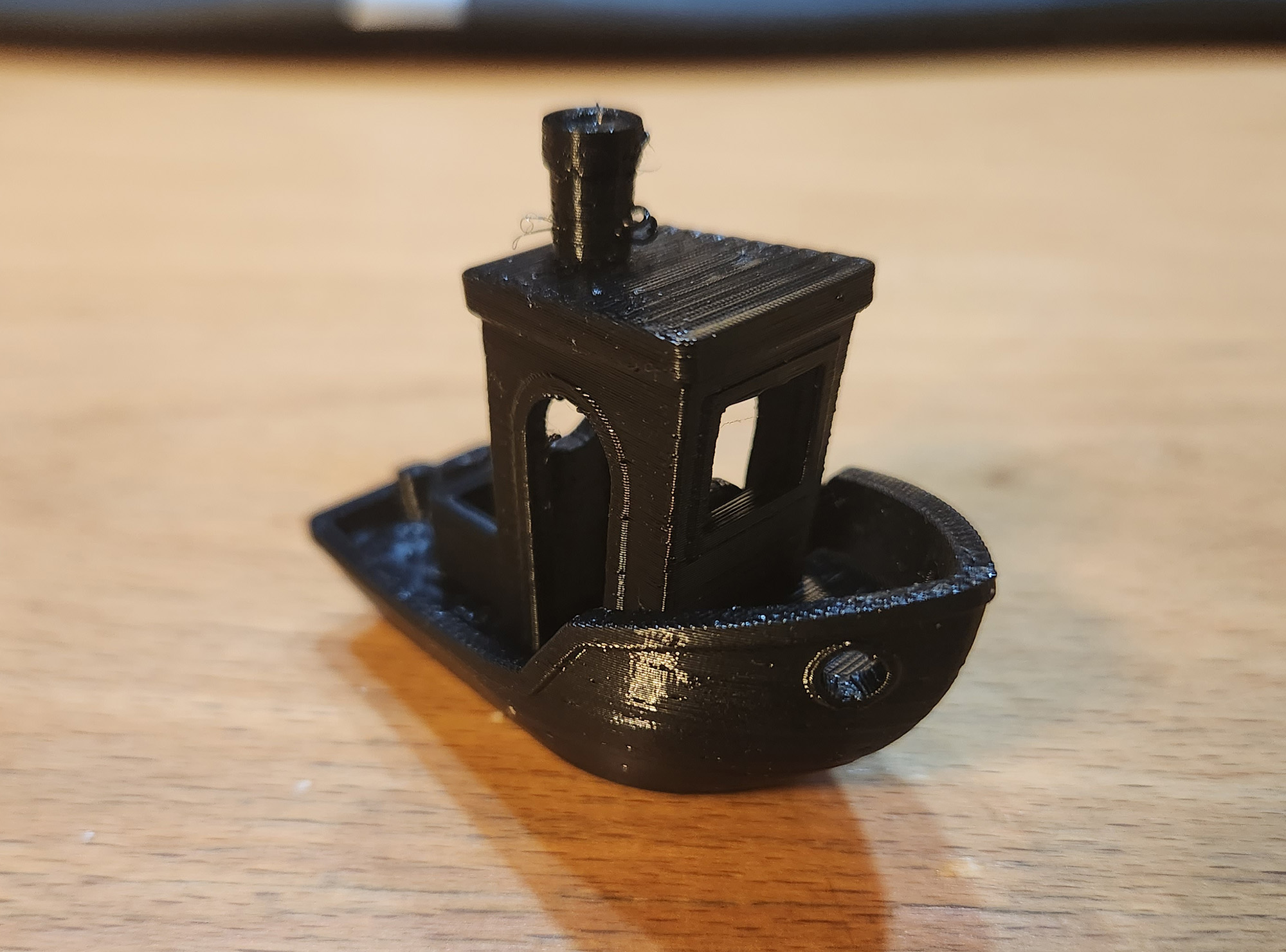

I am hoping there is someone out there with some TPU experience that can help me out. I have thought of a couple of items that I would like to make that would have been typically made of simple black rubber. No sheen, just black rubber. I picked up some Overture Black TPU, and I am okay with the printing (the pictured is literally first print so nothing is dialed in), and I am not super impressed with the "rubbery" squishiness of it, but I really hate the gloss. They advertise it with an RC tire next to it, and it is flat black, and it is no where near that in real life. It is much more glossy than the PLA I typically use.
So, anyone a TPU expert and can recommend a filament that will look a bit more like rubber?

Thanks guys! I think I will give the TPE a try, and the eSUN is on sale, so might as well. I will report back.
- morrisey0
- Posts: 1804
- Location: Richmond, VA
- Has thanked: 87 times
- Been thanked: 1853 times
Re: Looking For A Flat Black TPU Filament
SO SO SO much better!!
The sheen, the shore, the ease of printing right out of the box! Loving TPE over TPU!
