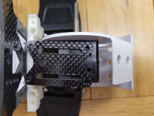

So maybe you just need a slightly longer trans top brace?

A buddy was using that gearbox at the VONATS and had alignment issues with the motor plate and the chassis, they didn't line up at all. I don't know that he had everything else right or was missing something different.

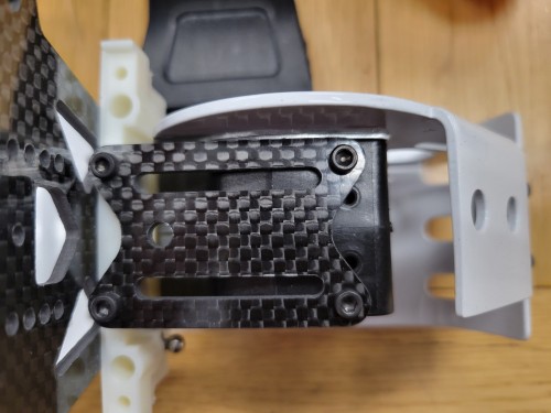

So Reggie I figured out your buddies problem, the motor plate needs to be shimmed out by about 1mm.

Yep, that looks like his did. I'll pass that along. Small price for the 2.6 internals though-

Finally got all my tranny alignment issues sorted. Got my bent chassis sorted and my drive line sorted.....I think.
