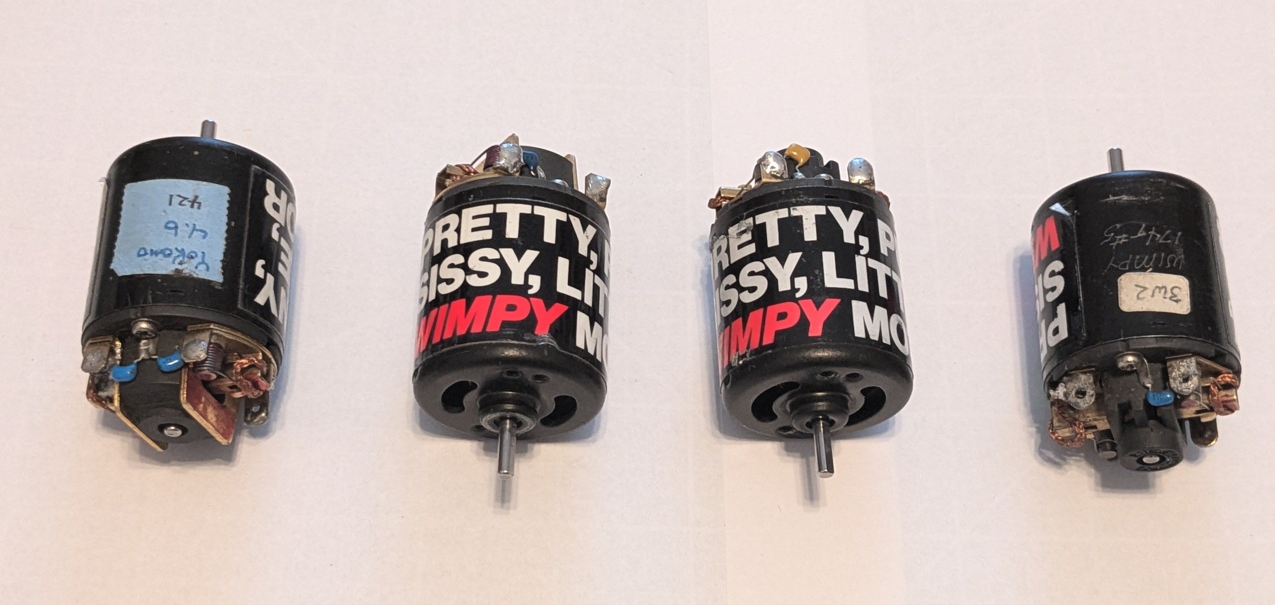

For modifieds, Wimpy used both Air Supply and Yokomo parts.
- jcwrks
- Posts: 674
- Location: San Angelo, TX
- Has thanked: 171 times
- Been thanked: 393 times
Re: Ultimate Vintage Brushed Motor Reference Guide (Discussion Topic)
I did mention primarily, but it's also possible that the one with the Yok endbell was swapped. The can could match the air supply ones.Frankentruck wrote: ↑Wed Oct 30, 2024 9:34 am For modifieds, Wimpy used both Air Supply and Yokomo parts.
The TX SKUNK
- Frankentruck
- Posts: 3810
- Location: Texas, USA
- Has thanked: 2605 times
- Been thanked: 2979 times
I read primarily and was providing examples of both Yokomo and Air Supply Wimpy motors. The left 2 motors are both Yokomo and the right 2 are both Air Supply. The quality of the group these motors came in makes me doubt that any endbell swaps occurred. Many Air Supply cans are Yokomo cans without the Yokomo stamp (early Yokomo cans had no stamp either).jcwrks wrote: ↑Wed Oct 30, 2024 10:48 amI did mention primarily, but it's also possible that the one with the Yok endbell was swapped. The can could match the air supply ones.Frankentruck wrote: ↑Wed Oct 30, 2024 9:34 am For modifieds, Wimpy used both Air Supply and Yokomo parts.
- Posts: 34
- Joined: Thu Mar 16, 2017 3:36 pm
- Has thanked: 29 times
- Been thanked: 18 times

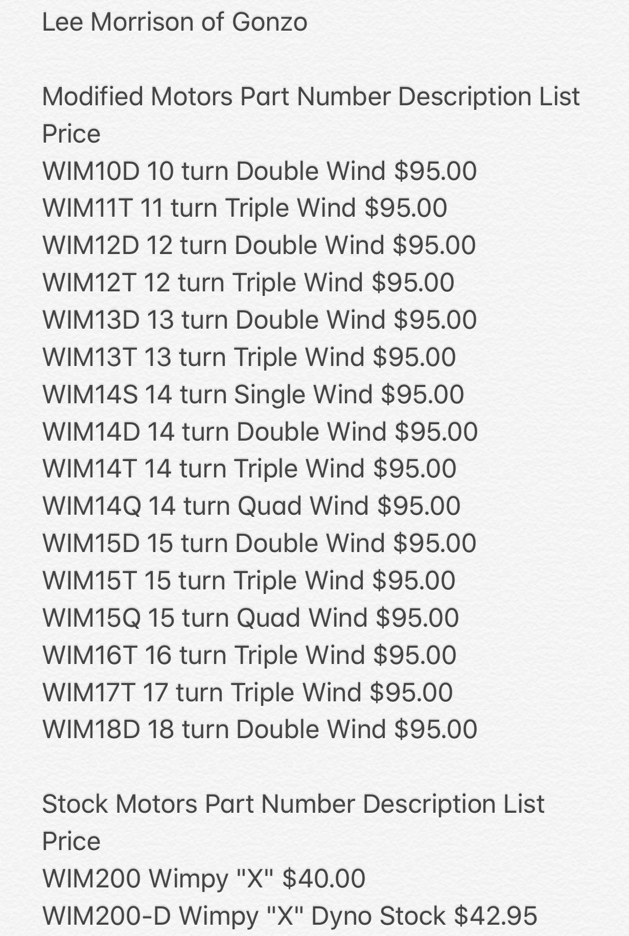

these my friend are not any Air Supply tear downs by TRD I would know.
As for the motor in question
Its made by Gonzo and is a trinity teardown
1987 Gonzo
Pretty, Sissy, Little, Wimpy, Motor
Modified
WIM10D 10x2
WIM11T 11x3
WIM12D 12x2
WIM12T 12x3
WIM13D 13x2
WIM13T 13x3
WIM14S 14x1
WIM14D 14x2
WIM14T 14x3
WIM14Q 14x4
WIM15D 15x2
WIM15T 15x3
WIM15Q 15x4
WIM16T 16x3
WIM17T 17x3
WIM18D 18x2
Stock
WIM200 Wimpy "X"
WIM200-D Wimpy "X" Dyno Stock
- THEYTOOKMYTHUMB
- Posts: 7133
- Location: Evansville, IN
- Has thanked: 3699 times
- Been thanked: 1980 times

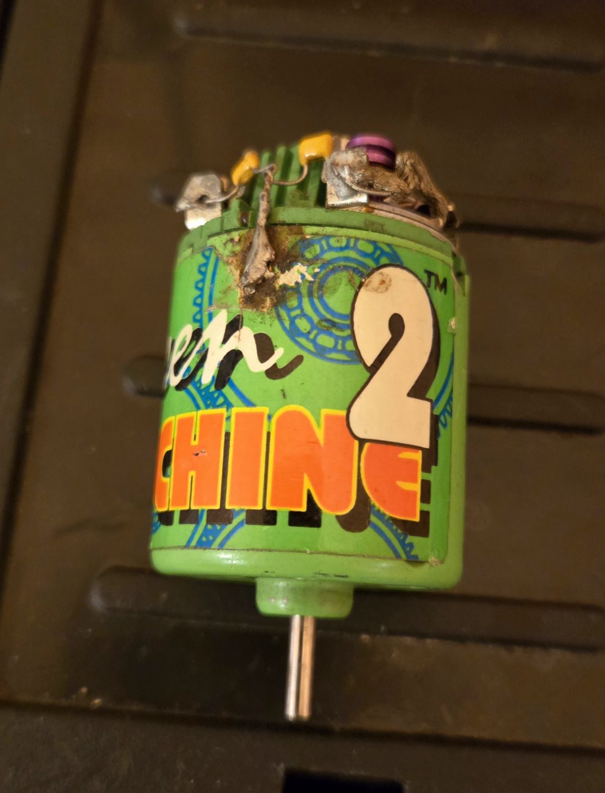

So back to the original question, does anyone know if Gonzo/Wimpy labeled made any green motors, or is it a mislabeled Green Machine 2? Oddly enough, I ran across a GM2 digging thru some motors yesterday. It would clean up pretty nice if the previous owner had put their capacitors on the other side.. .
- R6cowboy
- Posts: 1483
- Location: Mendota, IL
- Has thanked: 871 times
- Been thanked: 903 times
That's just irritating as hellTHEYTOOKMYTHUMB wrote: ↑Fri Nov 01, 2024 7:15 pm It would clean up pretty nice if the previous owner had put their capacitors on the other side.. .![]()
-Jerry-
