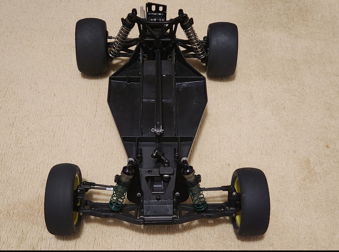

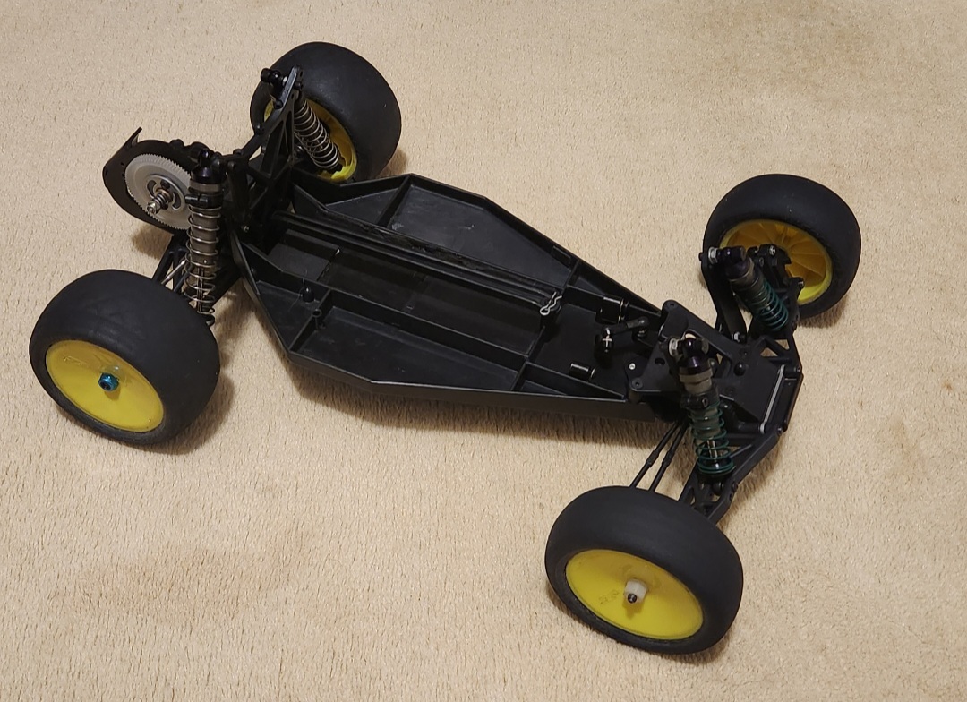

Some of the slightly more modern cars have definitely been fast on the vintage race circuit- the XX looked super smooth and I thought about building one...but I have way more AE and B2 parts....so here will be the start of the B2.4-

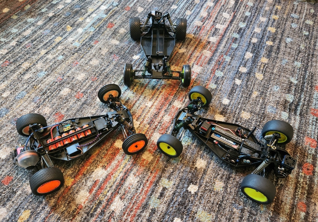

Yeah, I have my Swiss cheesed B2 from my teens, and the late one on the bottom I built in 2012 from SNIB when I was quitting smoking and the "Faux Pro" all carbon one on the top from around that same time...but none to race....until now. Scr8ps B2 was super smooth on track, so was Mark Baldwins and a couple local pros, so I really wanted to try one

NIce roller. Lots of different suspension combinations you can go with between front and rear b2/b3 arms, all the different width front axles, and b4 front caster block and b4 rear hubs.

Unlikely that I'll have this up and running by our Jan race, but maybe lol, the T2.4 is done other than a steering mod and B6 ball cups... and the Pre Pro SE 21.5 car is still only 75% there... Plan is big bore shocks, hex front and rear conversion (once I find Assc9881 axles) moto obscura front arms, Factory Works towers, that's probably all it will need. I'll have to figure out a rear fan mount too.

With modern hex wheels in the rear, if you use shorter B2 rear arms, you will need B4/B44 rear hubs, B44 length driveshafts (~63mm), and wider T4 hexes. If you use longer B3 rear arms, then you'll use B4/B44 hubs, B4 length driveshafts (~65mm), and narrower B4 hexes.

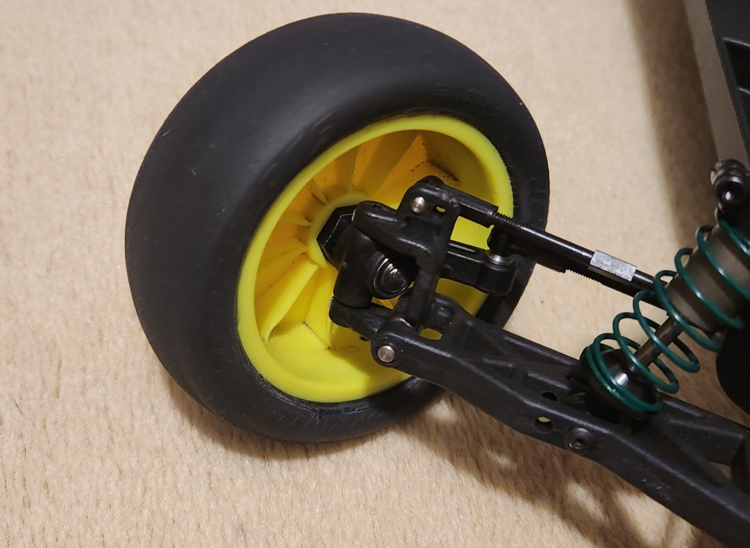

Ok, just added some of the .4 components for a hex conversion that would use our B6.4/B7 tires and wheels. Geometry stayed the same other than hub depth. By the time it was all said and done... I'm going to keep the standard setup. Maybe I'll play with it more next year right side is hex, left is stock

Been up since 3, nice cold with chest congestion going on today...so I did a little work. Bleeder caps, RPM quick clips basic suspension package (F 35 #2 green, inside lower/upper 5mm cups, 24mm--- R 30#1 silver, outside lower/upper 0 mm cups, 22mm) and just making sure everything is free, changing out ball studs to 3mm.

I was going through some stuff to sell, and thought this would be a fun pic. Stock B2, built from SNIB- All race full carbon built from all NIP, and the B2.4 racer

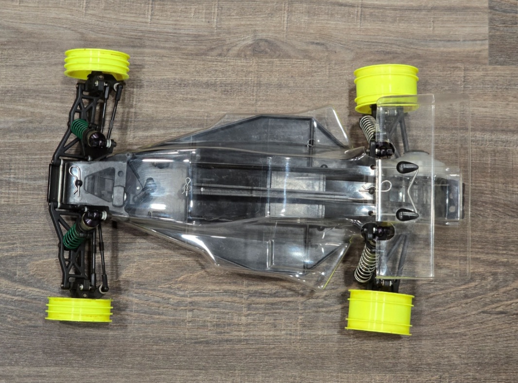

So this racer went a different direction than I had initially thought- nothing fancy, pretty much h a stock B2 composite parted buggy, with fancy RPM preload collars! And a few minor things learned from modern buggies like steering link equal length and such. Shakedown run and tire tests tomorrow-
