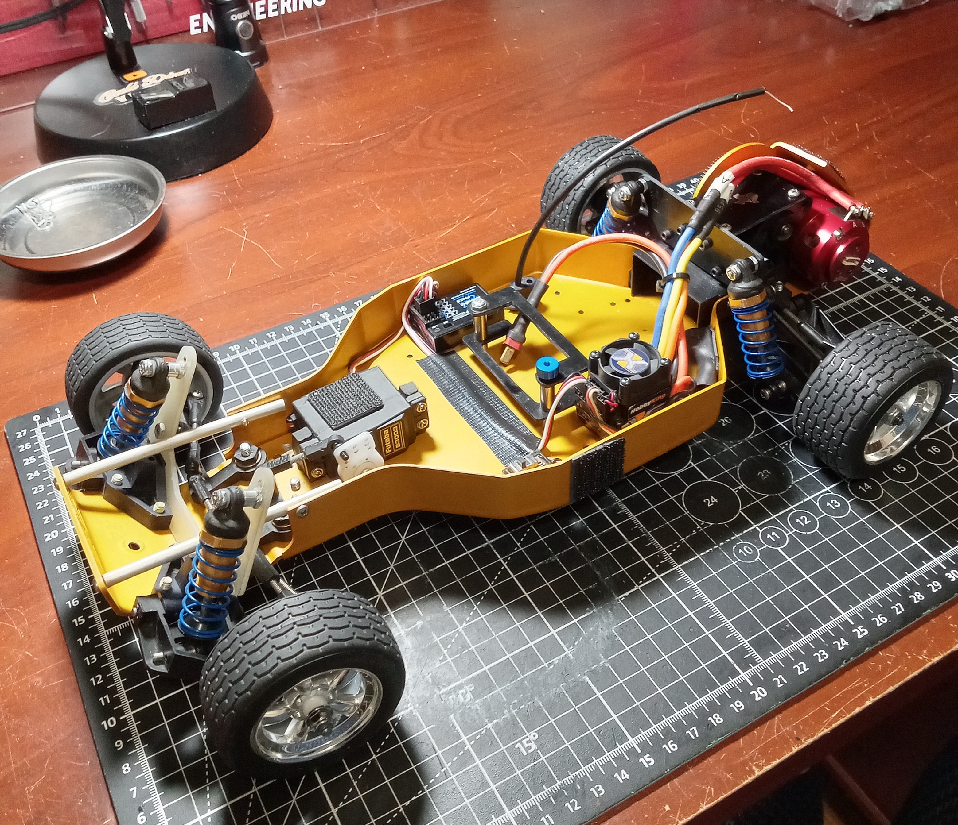

Original 6-gear street basher, using "bargain basement" electronics..... Turnigy Trackstar 10.5T with adjustable timing, Hobby King X-car 45A ESC.
The older I get, the faster I was.
https://www.youtube.com/watch?v=pyGKBTUJ-L0
