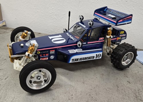

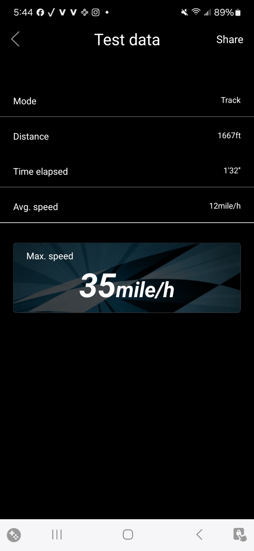

Hey guys, just signed up and it seems like the 40th builds posts have kinda fizzled out. But I just finished mine and burned some rubber and thought for sure she was hitting 40. Bought the GPS thing and although it feels gnarly fast, it's apparently only 35.

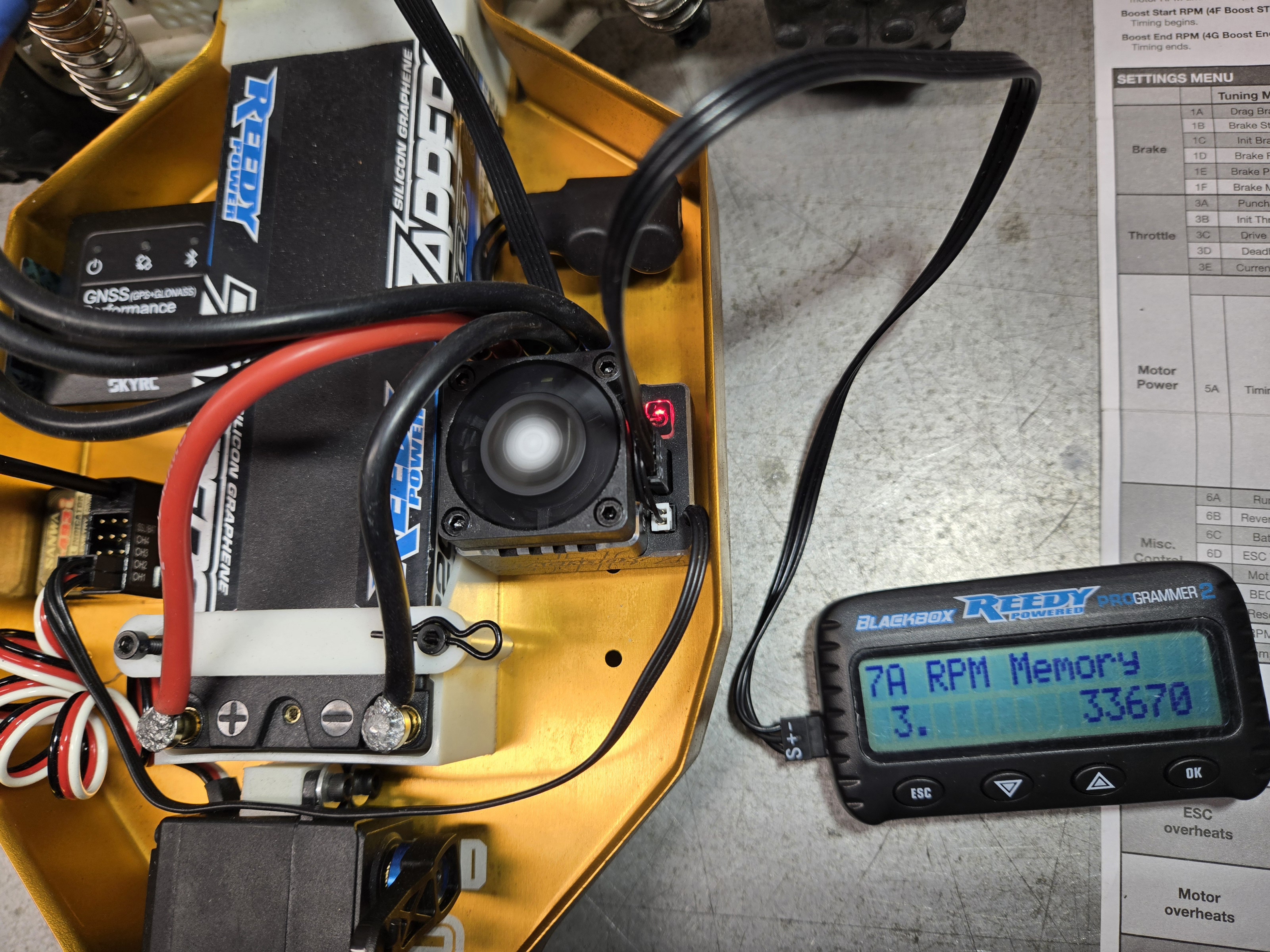

Modern electronics-wise i guess my question would be how to program the esc settings, adjustable timing, etc. And if those adjustments can get me faster?
My last car was my og rc10 35 years ago. Not really understanding the settings instructions for the ESC
Setup:
Stock 40th build. Reedy SP5 10.5 brushless motor, 20t pinion, Reedy 610R Blackbox ESC and Zappers 7.6v 8200mah 2s lipo. Blackbox programmer reading on first run said it hit 33,670 RPM and GPS said 35mph.
Have not adjusted ANYTHING yet. Is there 5mph to squeeze out of the ESC settings I guess is my ultimate question......thanks.

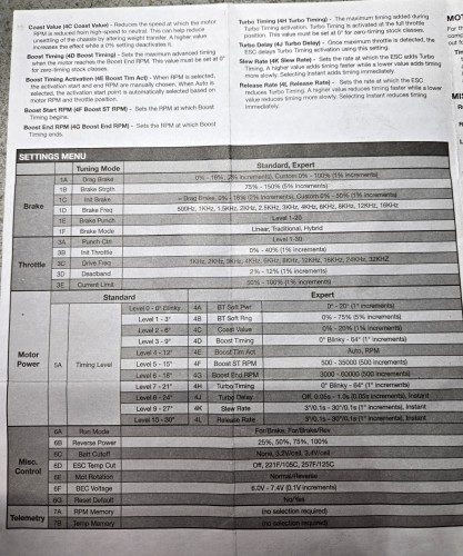

Add dynamic timing and you'll be hitting 50

In its simplest form "boost" timing ramps in more timing up to full throttle, "turbo" ramps in further timing beyond full throttle.
Without overly complicated explanations this is a good basic rundown that I found online

Esc has a fan. The programmer recorded max temp yesterday at 35*c around 95*F after about 30 mins of full throttle passes. Not sure how hot the motor got.

I'm hesitant to mess with esc programmer but I think I'll give it a try. Sounds like the turbo timing is where I should start.?

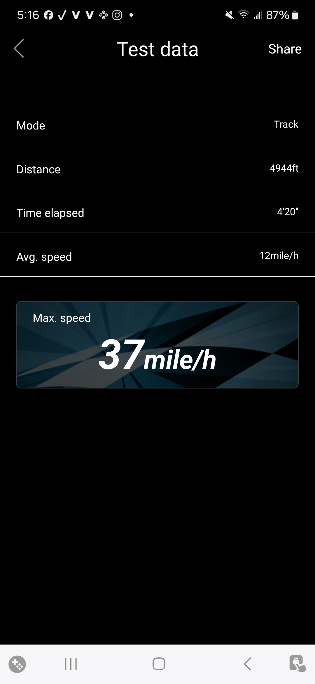

And yes, sky rc GPS performance tracker thing. (Still trying to figure out what settings like track or drag on the app and how to read it)

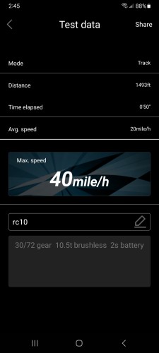

Went into esc settings and added 5* on turbo timing.....
Got to 37....
Motor at 102*F after 15mins of full throttle passes. (Temp gun)
Keep going on the timing? Am I pushing my luck?
Got to 37....

Re: Help me do 40+
Add a little bit of boost timing as well.
