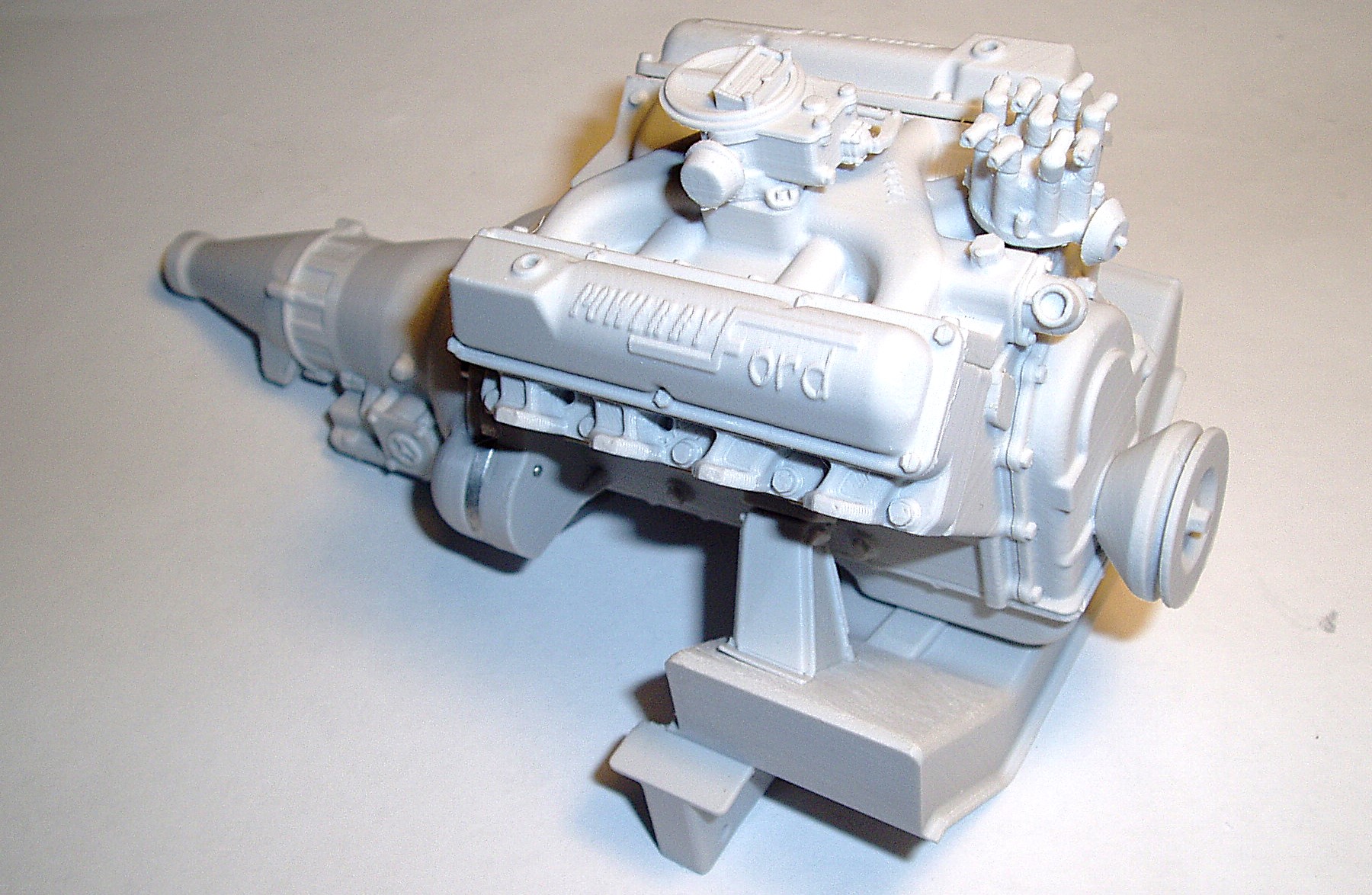

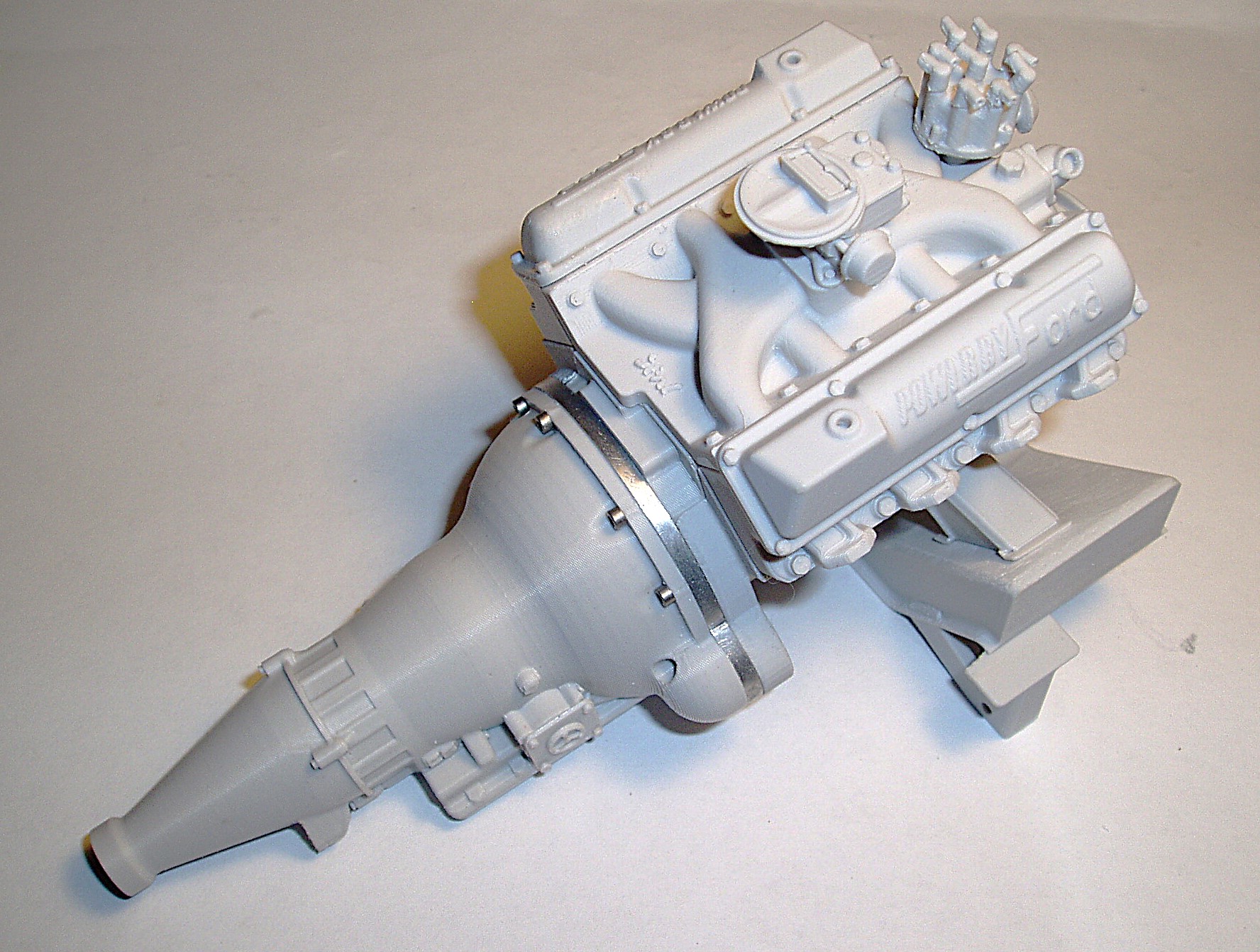

Anyway, here's the "engine" I'm working with.
It's pretty close to an actual Ford FE (big block) and only requires some minor tweaking. :)

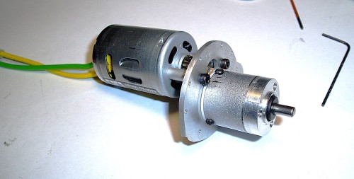

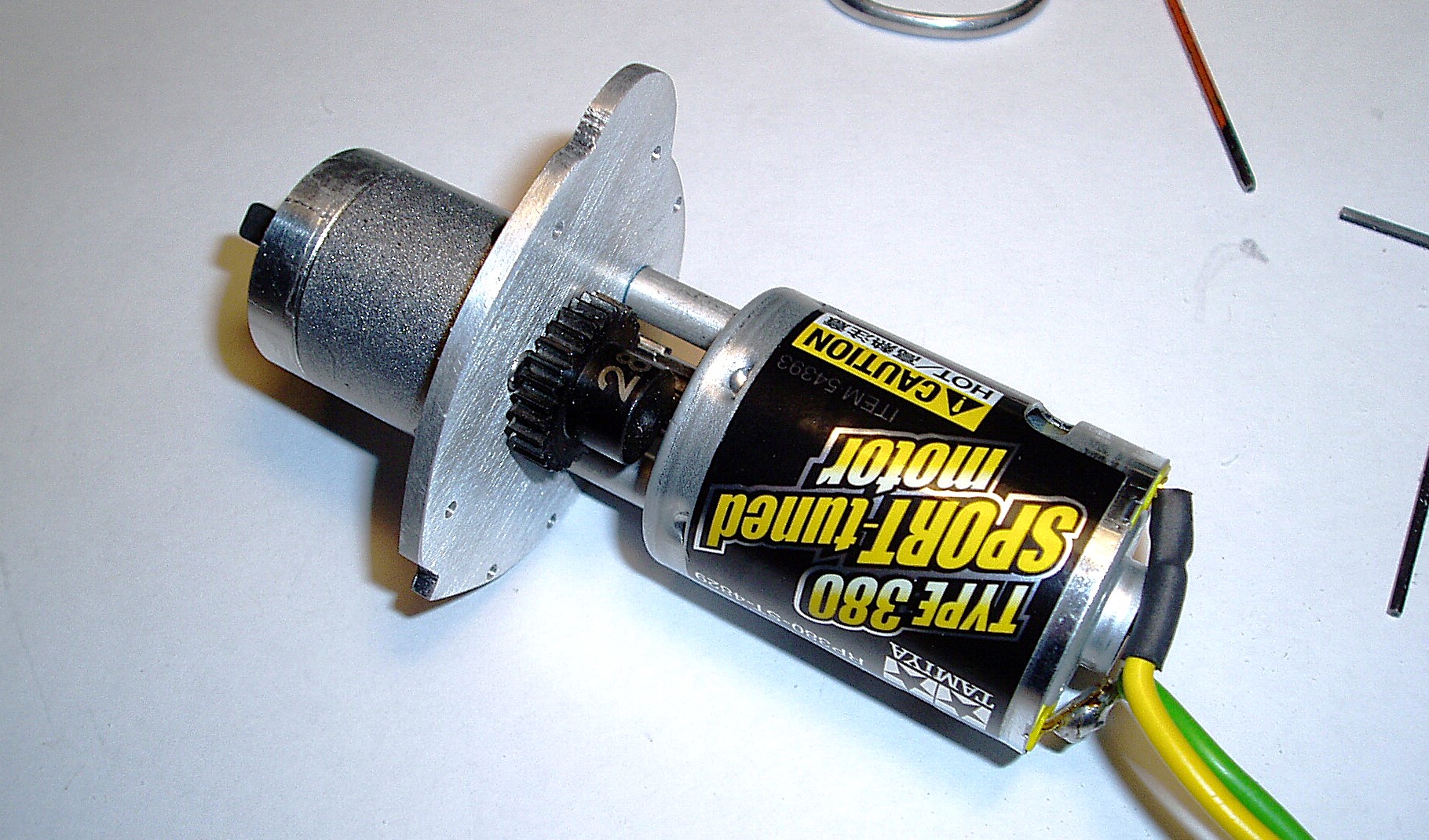

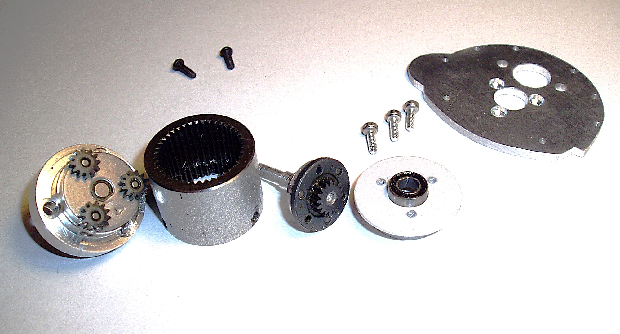

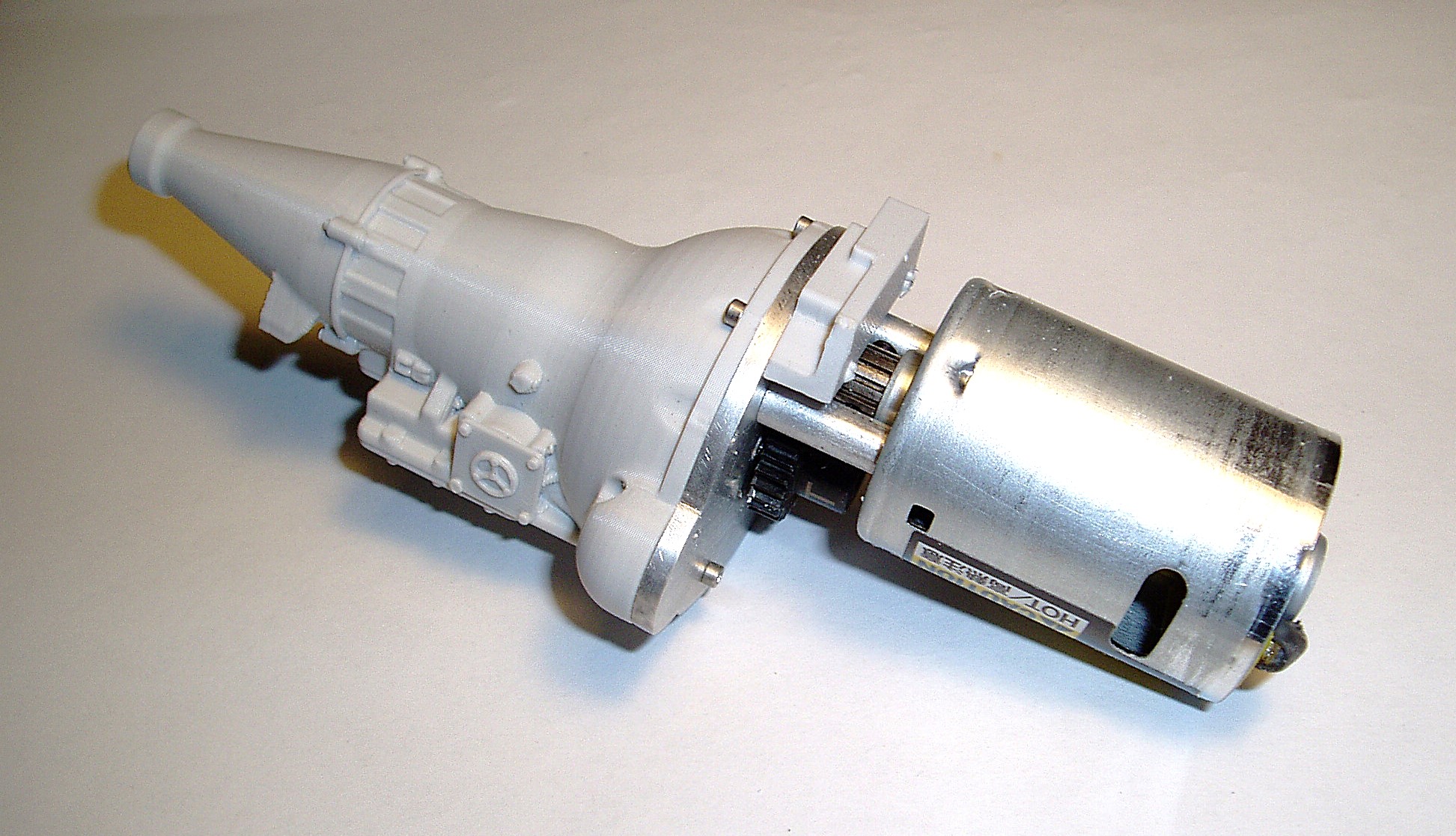

Well, the stepper motor finally arrive and the autopsy revealed a 3-stage planetary set. Each gear set is 3.56:1 (the cube root of 45.2) so I've gone ahead and modified the transmission to use only one gear set:
I needed to turn an input shaft, make a bearing carrier and a motor plate. The bearing carrier is printed because I didn't have metal bar stock large enough to turn this part.
Anyway, I'm using a 14 tooth motor pinion and 28 tooth spur gear for a 2:1 primary gear ratio. This will yield a 19:1 FDR (2 x 3.56 x 2.67) - perfect for my application.
I wasn't able to use the include stepper motor so I'm using a brushed Tamiya 380 motor instead.
It's close but everything fits inside the 1:10 scale C6 case and FE engine block.
It's just a work truck so I'm running a 2-barrel carb. :wink:
