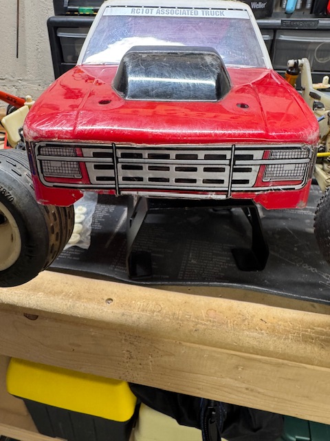

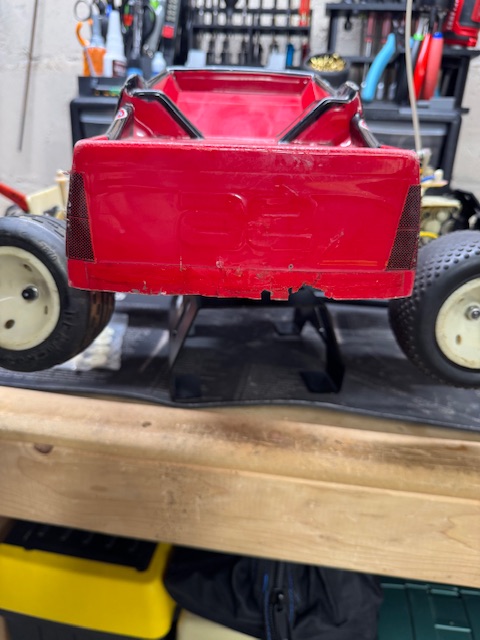

Again I am not looking for a great deal guy or a price guide. I am looking at a good looking car for a restoration. I have been in the hobby for almost 40 years so I have a running idea of the “value” of these cars but to me they are invaluable and worth millions. I am a habitual collector with an addictive personality. I want to know everything about these models. I’m also asking questions because I’m curious to see if my “vintage Tamiya” experience also rolls over to vintage AE and other companies because I know some of the materials used are similar but not exact in some cases. So I am not looking for a price check per say or to “bait” anyone. I’m looking for a pat on the back or a smack in the head. I edited my first post so nobody feels uncomfortable.
Does anyone see any parts that aren’t stock? Front A arms?

Looks like a very nice 10T sport with light to medium use. With the intention of cleaning it up and running it, you are going to get lots of enjoyment out of it. It does look completely stock to me with an upgraded rpm bumper (IMO must have for a runner since it covers the front nose plate and inner portion of the arms) and newer T2 front arms (previously may have broken the original white front arms). There were lots of variations of the 10T sport trucks all the way up until the T2 sport came out, with all white plastic and natural fiberglass towers to some having black arms only (zebras). Some had the GT front tower that GomachV pointed out to eventaully all black plastic and shock towers also. For what you have comin in the mail, I'd just swap in either white front arms black rear arms so they match. Only other thing I throw in is a set of bearings if it doesn't have them already for piece of mind since it'll be a runner. Lastly, you could upgrade the electronics to an affordable hobbywing justock brushless combo too. Otherwise, keeping the wiper arm and a brushed motor in there would be truly box stock.

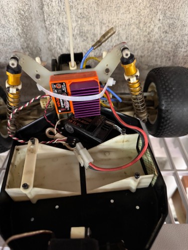

If you are going for period that msc looks really nicely setup. It looks like a truck that will be lots of fun as it’s arriving

Tye msc is most definitely coming out. As is the airtronics equipment.

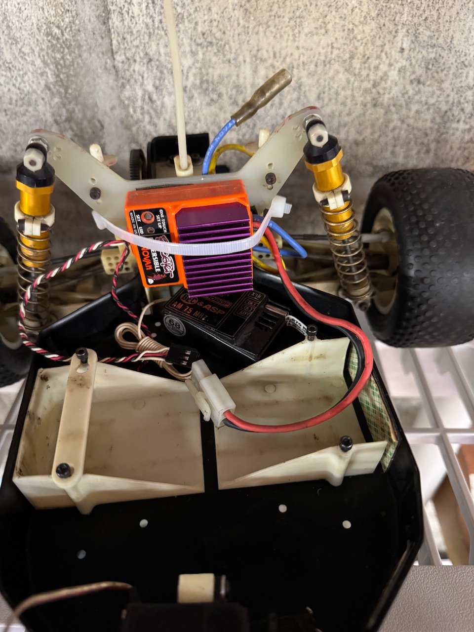

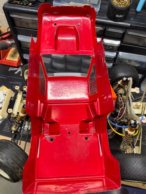

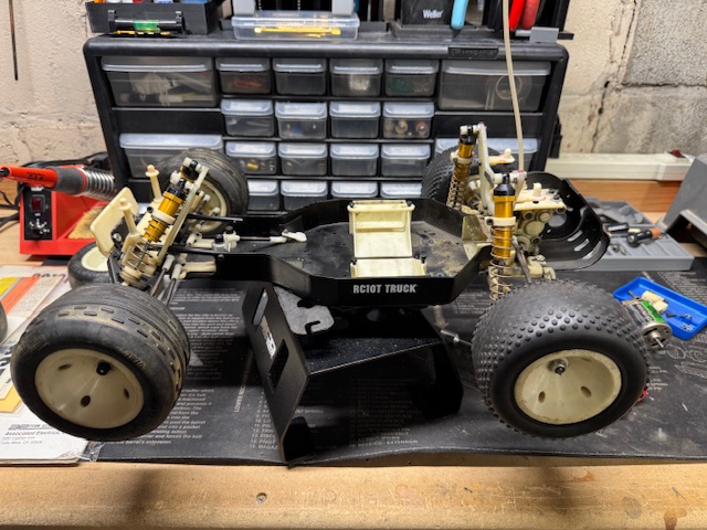

It’s here. Before tear down shot:

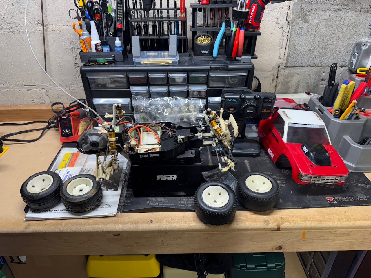

Post by Brendan2904 »

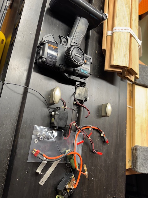

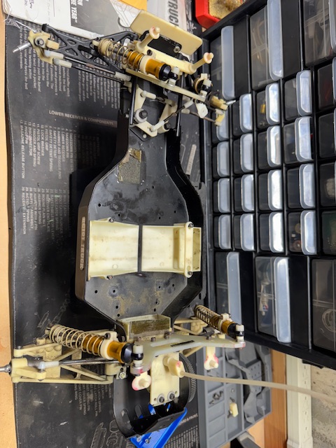

After tear down shot.
The radio is 27mhz so it has to come out.

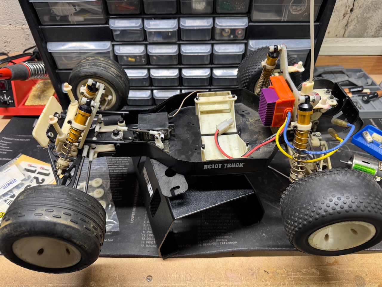

Finally a mock up without the receiver and motor see how things should look after replacing the a arms and cleaning the chassis up good.
My kingdom for some real servo tape!!!!!

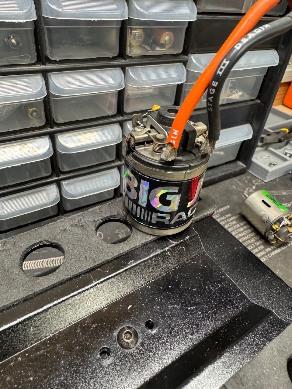

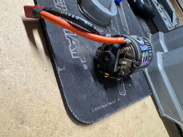

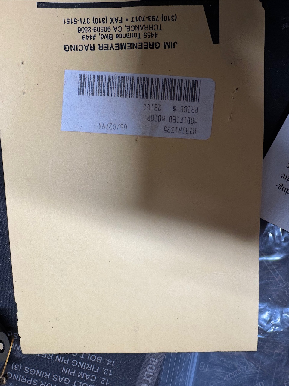

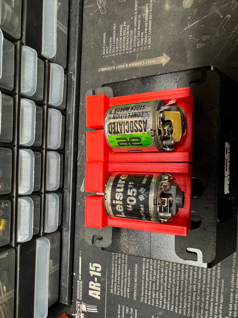

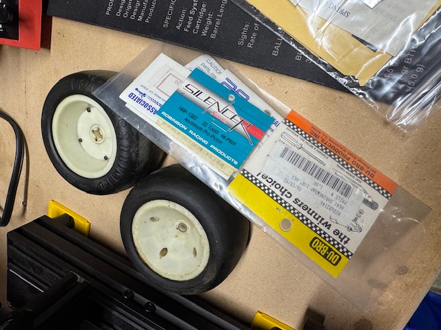

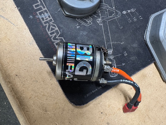

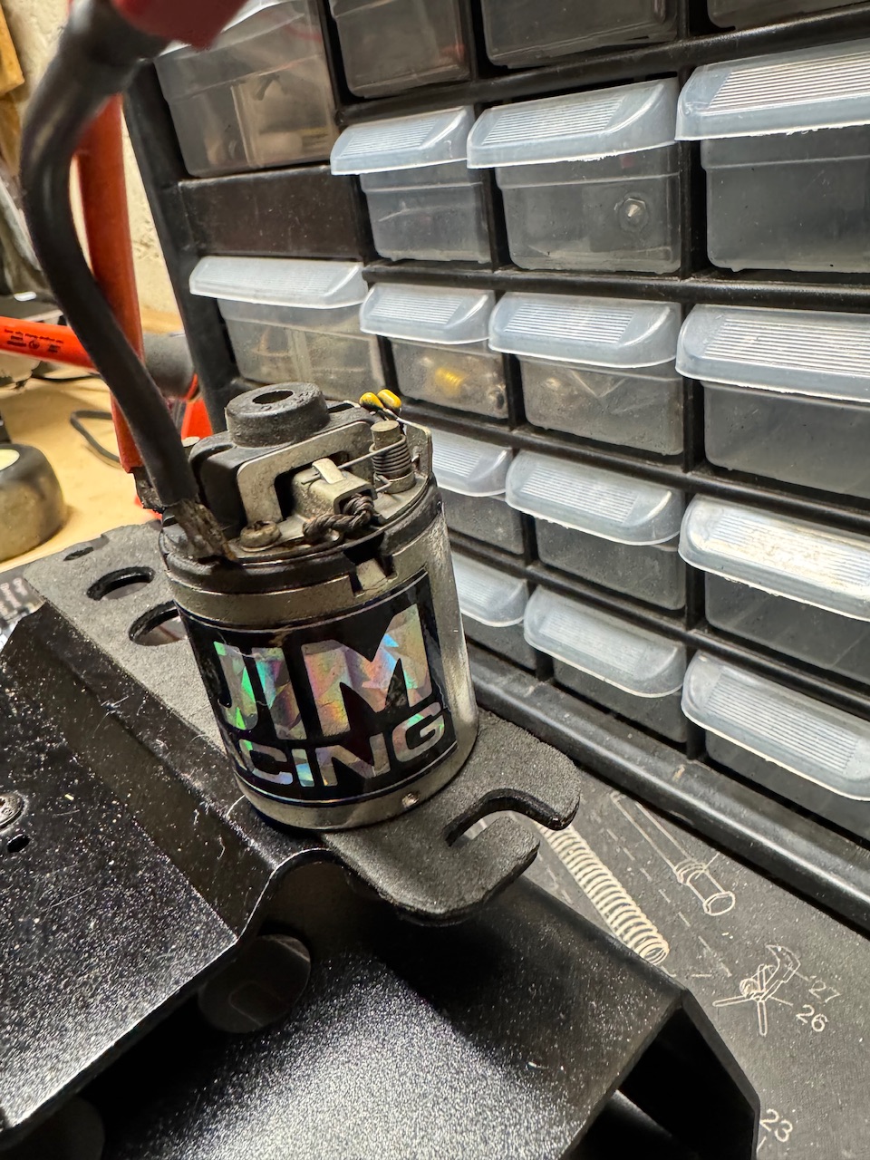

The big jims motor had an envelope with it. Not sure what it has inside of it. When I get home from the hobby shop I’m going to dive into all of the little pieces and bags.
