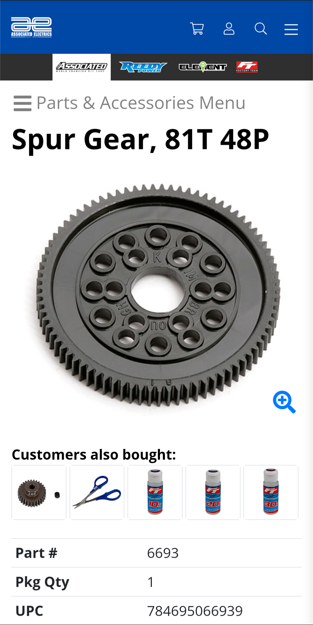

Ok, I did come across that. WIll the diff balls fit in those holes? I thought those were mounting holes. Thanks for the reply.

Those are diff ball holes that get used as mount holes when the gear is used on a Stealth slipper.

If your LHS has a standard Kimbrough, it is the exact same gear. Oddly enough, it is cheaper in Associated packaging.

Also, if you upgrade to 12 total carbide diff balls in the kimbrough gear you will have the best diff/slipper holding set up. Remember, that poor gear has to serve as both in a 6 gear trans.

This is the Kimbrough 48 pitch spur gear, just sold through Associated.
https://portal.associatedelectrics.com/teamassociated/parts/details/6693/

Thank you!! Are these the correct carbide diff balls?
https://portal.associatedelectrics.com/factoryteam/parts/details/6619-ASC6619-ft_carbide_diff_balls_1_8_in/

Yes

Any 1/8 diff balls will work. For normal use, I use the cheap RJ Speed ones.
Once Associated stops selling diff rings for the six gear (or out of stock), the RJ Speed ones work as well.

I used these https://www.mcmaster.com/9528K11/ $4 for 100 they seem to be fine for light running and bashing.
