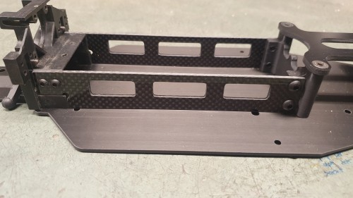

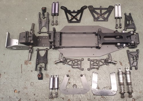

I placed an order from Fibre-Lyte for a couple of towers and braces for some ongoing projects.
Took the opportunity to have them cut the chassis sides in carbon, pricing was very reasonable.
The chassis rigidity compared to the 3D-printed sides is massive. The 3D-printed versions was PLA because that is what I have. I could have ordered printing in stiffer material, but the carbon option came so I went that way.
I have also realised that I´m missing some parts to be able to build the rear end like on the JJ car.
I put all the options on the table to have a think on how to do this.
I could build a JJJ Pro or perhaps a JJJ SE. Let´s see.
