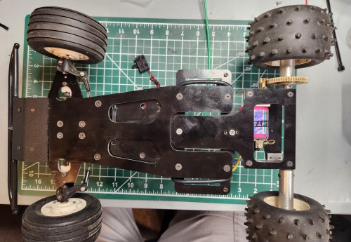

This is the foundation.

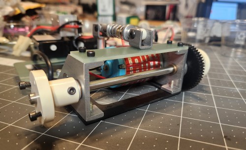

Broke everything down, cleaned up everything as best as possible, and then sat down to day to start assembly. First to put together was the rear pod, and this is where the cheating starts. Right off the bat, I didn't like the main chassis plates, so new black versions were ordered from factoryworks.com I was fine with this addition of black, because to be honest, I liked the mix of green and black on my O/R, so a nice mix was fine for me. And then when I go assembling the rear, I really cheated and went with a later shaft and differential set up, with black hubs, off a later version. I went this route because TBH, it was new and sitting in front of me, and was cleaner than the original parts ended up.
Then add on the main plate. This actually takes a little bit of artistry to get everything lined up, and proper spacers are installed and such.

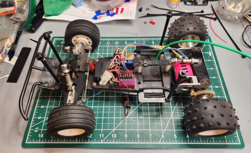

Got the front basics on.
Then shocks and such added.

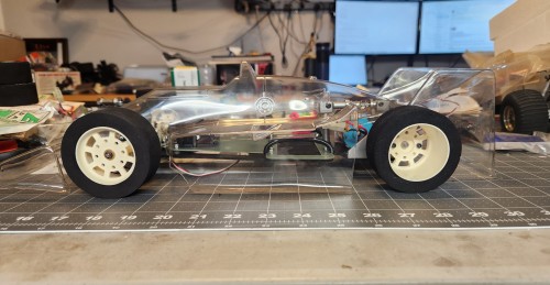

I had already checked out the stash of bodies, and found a NIP Bolink Indy body, and the body actually lines up with the posts of the chassis, so that was the choice. Problem with the body is that the front arms now stick out, and TBH, they aren't all that pretty, so now there is a chance that black front arms will be installed soon.

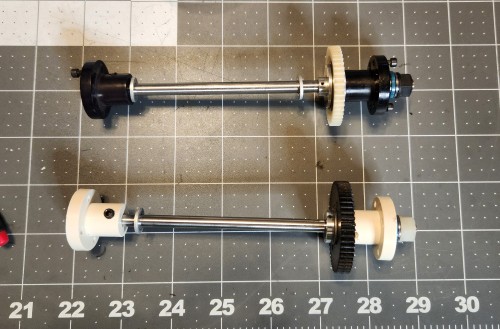

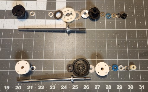

Well, I felt guilty about being lazy on the rear driveshaft / diff set up, so I cleaned up the original set and got it installed. There isn't a lot of difference between the two, but I just felt like the car should have the earlier style that it came with.
Later on top, earlier on bottom.

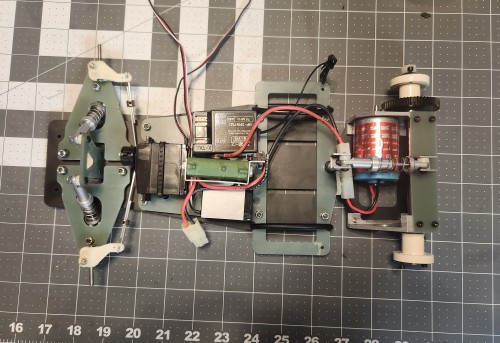

Then I started thinking about electronics. I picked up an old NIB AristoCraft / HiTec "Challenger" system, with two servos and a non-BEC Rx, a few weeks ago from an estate sale, and since I wanted to run a MSC on this, that system just spoke to me to be used on this car. The problem is that the Invader radio plate doesn't have all that much real estate to begin with, and then when trying to top that with an Indy body, you kill quite a bit of the vertical area also. And yea, the Bolink MSC set up is a brick.
So yea, trying to fit all this with a batt pack just wasn't going to happen, so I got lucky and found a NIP Aristocraft BEC circuit on ebay, and that is on the way. That is MUCH smaller than a batt pack. Even with that, it is tight on the radio plate, but I think it will all get there just fine, and the body will fit.
One of the things that bothers with this set up is that everything is in one spot, but the servos have 10" leads on them. I am all about spiraling the wires, but not that much. So, I did the research and found out exactly what Molex plugs and pins AristoCraft / Hitec used, and have some coming in so I can shorten up the wires quite a bit.

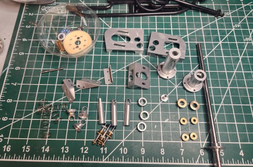

I am missing all of the before pics of the truck complete. This is the day that I got it. It came in a lot, but the M/T was the main truck I wanted. The seller told me that he had never run it on the ground, only did "vrooms" in the air. This seemed unlikely to me, but after inspecting it, I think that story is mostly legit. There was grime on the spur gear, and a little grass on the chassis, but no visible scratches or any damage on the undercarriage.
I started into teardown yesterday, and got all the G10 cleaned up, and ran all the aluminum and brass through the ultrasonic and then the tumbler overnight, so a lot is already ready to start building. So far, I have found one incorrect nylon spacer installed, and all the rubber spacers are shot from being overtightened and split, but so far that is all that needs to be replaced. I am planning on putting this together with 95%+ of what it came with, chassis wise. Even the fasteners look pretty good, so most of those will be reused.
So, what makes the M/T look like, and ready to go out and compete with Blackfoots (Blackfeet?), Sledgehammers, Double Dares? Well, nothing really.

Good choice! Now you have a proper early setup - really like it with the predominant Schumacher spur.
morrisey0 wrote: ↑Mon May 12, 2025 8:35 pm Well, I felt guilty about being lazy on the rear driveshaft / diff set up, so I cleaned up the original set and got it installed. There isn't a lot of difference between the two, but I just felt like the car should have the earlier style that it came with.
