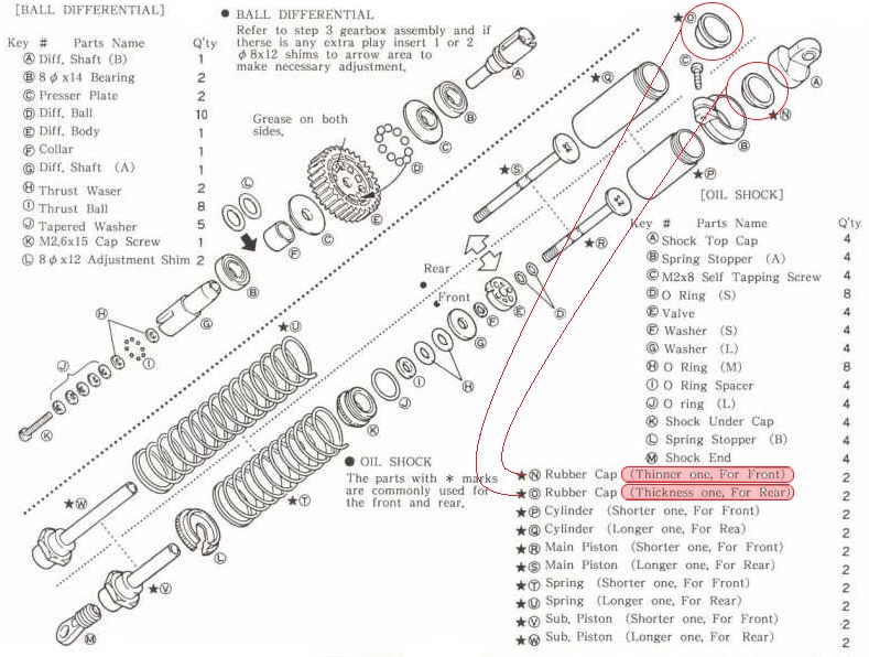

I noticed a torn shock diaphragm (rubber cap) when rebuilding the platinums.
Haven't ordered replacement yet but when reading from the Mid SE manual
The first 2 lines show the larger caps in the smaller shocks and the smaller caps in the larger shocks???
I know there are numerous misprints in the manual, is this just an other?
Seems as if the thicker ( taller/larger) should go in larger shocks or am I missing something here?

A little more research and...
This looks more like the intended set up than the assembly manual's description.
This pic is what I assumed to be correct, just can't believe every thing you read.
Chuck
Chuck

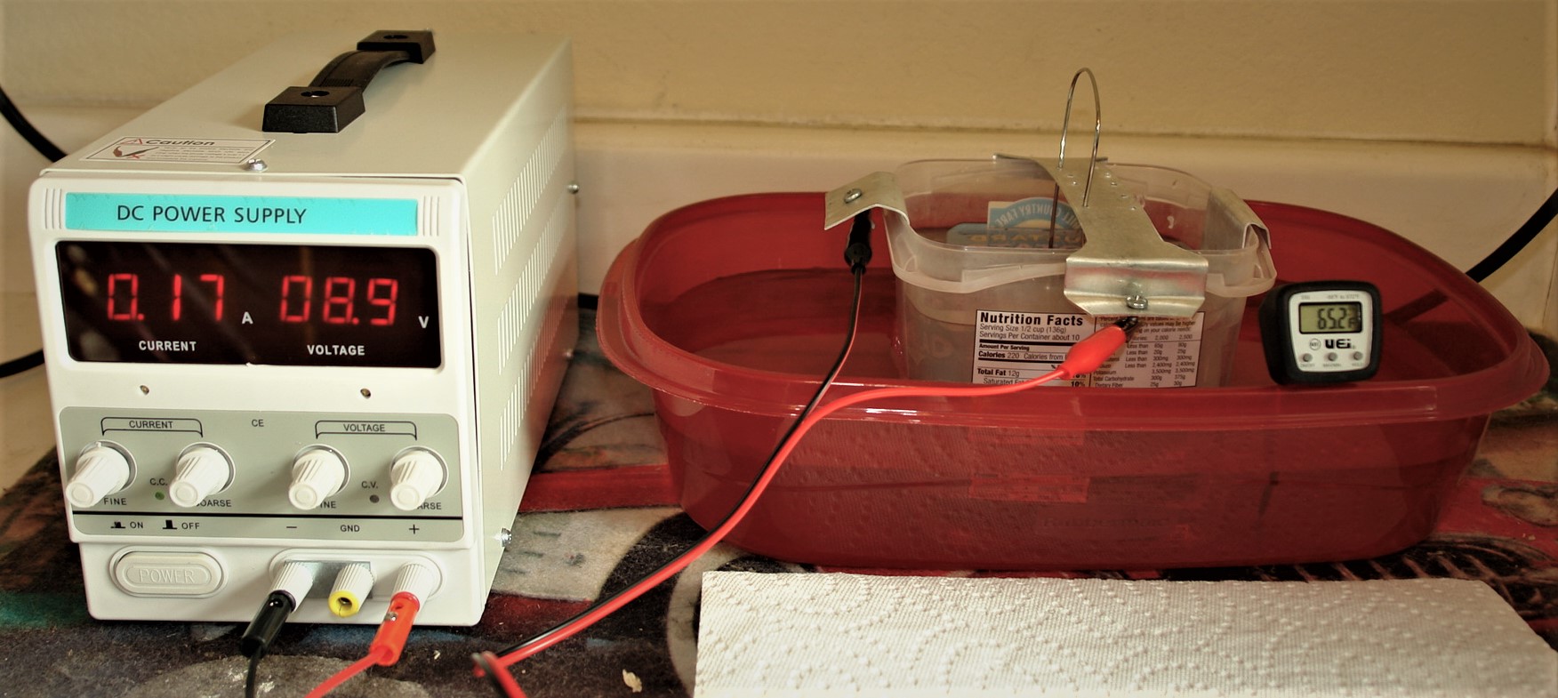

First attempt with a power supply and not the battery charger I had been using with mixed results.
This power supply allows constant current ( CC ) output as well as constant voltage ( CV ) modes.
CC is what is needed for anodizing aluminum.
So far it is seeming to work OK.
The aluminum being anodized was not perfectly polished, just a quick job to see possible results.
More to follow.
Chuck
More to follow.
Chuck

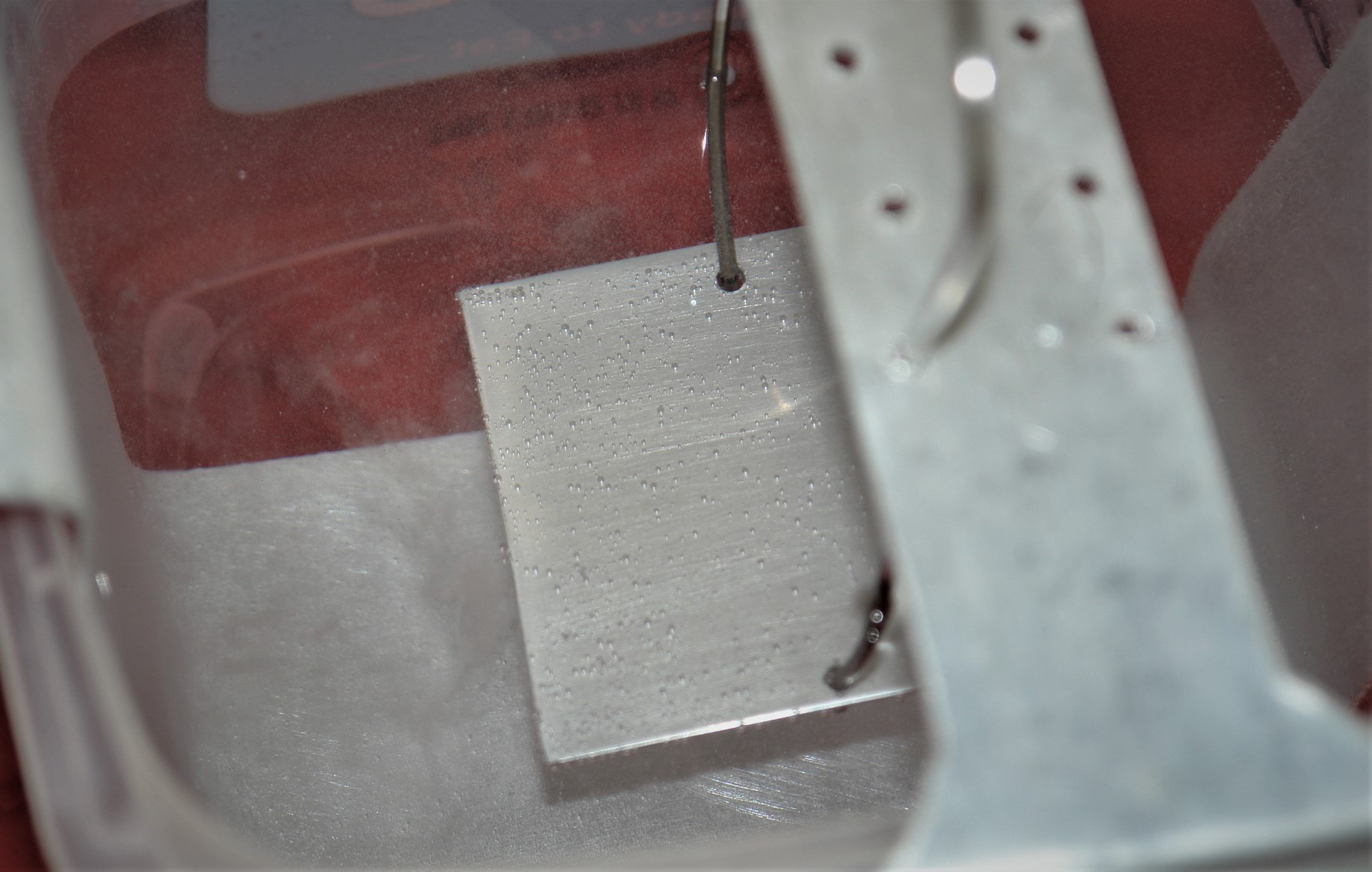

First anodizing experiment did not go as well as I wanted.
Basically the test piece lost it's glossy appearance.
So I decided to change some of the basic 720 rule settings. https://caswellplating.com/720.html
Initially I thought the thickness of the anodizing would be best at 1 mil.
After a lot of research it seems a thickness of .2 - .5 mils will allow a glossier finish, yet not quite so durable.
This is what most anodizers probably shoot for. Glossy and reasonably durable.
I settled on .4 mils and a current density of 4 Amps/Sq Ft.
The lower current density decrease the peak voltage but increases the anodizing time.
Somewhere I think I read higher voltages can lead to a less glossy finish. But that was my reasoning.
The prep work is everything.
After sanding and polishing, cleaning all remaining residue is key.
Starting with my "go-to" cleaner warm Simple Green in an ultrasonic cleaner I found it had discolored the polished aluminum.
After repolishing and cleaning again with Simple Green the part would not pass the water break test. Water break testing is a simple test to check for the parts cleanliness.
Successful cleaning was accomplished with Dawn dishwashing liquid and a soft tooth brush. No staining and passing the water break test.
Results are pretty good so far with the new settings.
It just takes a lot of time, patience and a watchful eye.
Chuck
