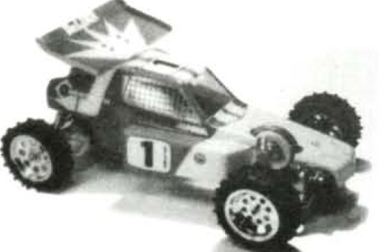

gomachv wrote:I stopped by RC Plus today with the bullet and talked to Ron. I knew it was going to be fun when he said "oh, look a Bullet. Those things were a pile of $&%@!" Lol.
Hah, that's a great little anecdote on the Bullet's handling, and again surprising to hear of another possible owner. I personally figured these cars never made it out of A-Main's shop. ;)
Would be great to find an original chassis even if it's only for seeing how off the repro's measurements are.

His feelings about the car were not really that the car was a pile, per say, but rather based on what the car did to racing. He said they were very much a fast rolling roadblock.
Modern tracks with these things will be interesting to say the least :lol:
Are we thinking that body is similar to the Mears body? Or is there something closer?
Lastly, I have sent the pieces to J-sou and he is going to make us some files that can be used to cut all the carbon parts. 8) the last and hardest part will be the chassis, and only difficult due to the odd angles which kind of make the car. The plates are so narrow tho, it will be easy to make quite a few out of minimal material

"A fast rolling roadblock" fits with how I want to build my Bullet. :mrgreen:

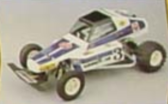

The body on the ad car is a Parma Chenowth Frog body isn't it?
Posts: 12336
Been thanked: 3919 times
Re: A-Main Bullet Fwd 4ws RC10 conversion Tribute build
Well poop. I think your right- which is going to be another hurdle.
