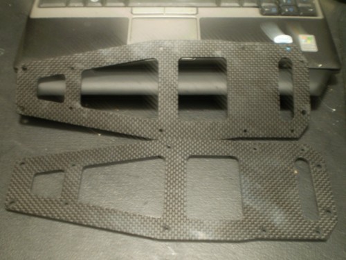

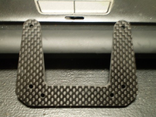

had new shock towers and upper decks made up in 3.5mm graphite, came out beautifully.
waiting on new shock springs and time to reassemble and practice

nicely done.did you have someone make them for you? the radio plate design looks good as well.
what did they cost you to make? i remember someone on ebay was looking to get around 50$ for the towers.

dynotech made them up for me, chad's work is top notch and perfect and flawless, takes pride and it shows.
towers were a little more than that but at least i can get replacements anytime i need, that other guy that sells the towers never sells them anymore
the top plate was based off a JG fiberlgass tower

Re: Ultima Buildup
tops!
did he put some partnrs on these so we can order them easily?
for the top plate: when I mounted my JG fiberglass plate to the turbo ultima chassis I had troubles getting the rear screws into the bulkhead. Didn't mind that as it fitted with some effort, but later I found the chassis had bent up just in front of the rear bulkhead because of this. It kind of changed the camber to almost neutral on the rear arms
How is the fit on yours?

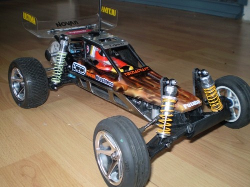

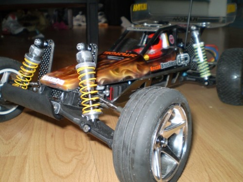

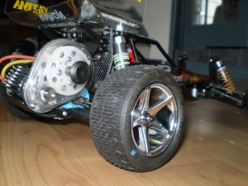

Re: Ultima Buildup
Well built it up and tested it today, runs absolutely perfect.. suspensions is perfect, spent about two hours swapping oils and pistons and springs to get the right consistency i was looking for..
The A&L Tranny runs great also. having a problem figuring out gearing for the 17.5 motor, but working on it... right now im running a 90tooth spur and 25 pinion... anyone had suggestions let me know... might go down to a 87tooth spur..
Parts i Used so far are:
HPI 5 Star wheels (fronts are Cut)
Jconcepts Tires
3Racing LazerZX5 Shocks (lime 75 kyosho springs rear, and yellow 60 kyosho front springs)
Kyosho RB5 Front Spindles, Axles, Carriers.
Tower ST-15 Front Shock Tower
Tecnacraft Turnbuckles all around
RB5 Balls & Hard Gun Metal Ball Cups
Custom Front Hinge Pin Support
Custom Titanium Turnbuckles all around.
Andy's Front A-Arms
Dynotech Custom Front Shock Tower
Dynotech Custom Rear Shock Tower
Dynotech Custom Top Plate
Tower ST-15 Front Bumper
3Racing LazerZX5 Aluminum Steering and Custom Graphite Steering Rack
Futaba S9551 Narrow Servo
LRP Sphere ESC
Novak 17.5 Brushless
Orion Battery LIPO
Spektrum Reciever
Original um18 body and original um16 roll cage cut around shock tower.
LazerZX5 Wing Mounts
Original Ultima Rear Arms
RB5 Dogbones & Clamp Axles from RB5
Losi Rear Wing
A&L Ultima Tranny & Heatsink Motor Plate
Kimbrough Spur & pinion
Integy Motor Heatsink
Tower ST-15 Rear Hub Carriers
Robinsion Adjustable Rear Toe-In Peice (tower st-15 works too)
Associated Rear Motor Plate Custom Bent to Protect Tranny and Motor
