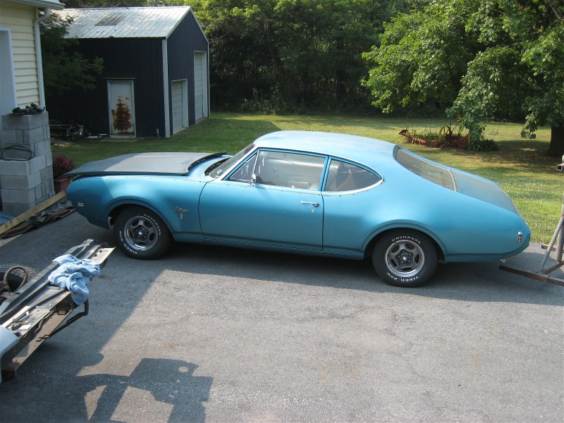

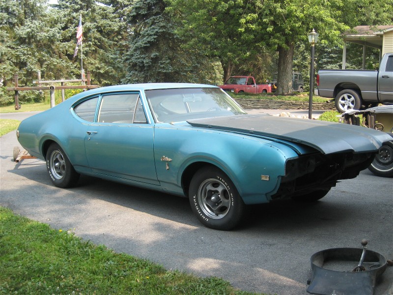

i know some other members are into real cars, old and new, so i thought i'd get a build thread started for my 68 cutlass s. here she is now.
for now, i'm not planning on doing much (if any) body or paint work on it. just want to spray the new hood my dad found out at carlisle last month so it matches. i'm just gonna focus on sandblasting the frame, and building up the drivetrain, brakes, and suspension. i'm really into the pro-touring style cars.......... old car, modern suspension, big brakes, etc. there's a TON of different manufacturers out there making parts for the GM A-bodies, and every one saying their stuff is better than the rest. so, i've been doing a BUNCH of reading trying to figure out the best route to go to give me the performance that i want to get out of the car, but not kill the budget. not an easy thing to do. the rear suspension i have pretty much figured out, except for what sway bar i want to go with. that'll depend on how i build the front. but i'm still undecided so it's gonna have to wait. but here's a start on the parts list:
engine/trans/rear - the car already has a 350 olds rocket that was recently rebuilt. so, that will find it's way back in the car after a good cleaning and a new coat of paint. for the trans, i'll be using a 200-r4 overdrive trans out of a wrecked 87 monte ss i bought 10-12 years ago. the open rear will also be swapped out for a chevy 12 bolt (i hope) posi w/ 3.73's. with the overdrive trans, it'll be fun to rip around town, but cruise nicely out on the highway. :)
brakes - as much as i'd LOVE to to run some 13" baer or wilwood disc brakes, it's just not in the budget. so for now, i'm just gonna go with a stock disc brake kit in the front, but also in the rear. right now, it has 4 wheel drums, so putting ANY kind of power disc brakes is gonna be a HUGE improvement. 68's are supposed to have dual piston front calipers, but i'm gonna go with the single piston kit. they became standard for GM in 69, and the price difference between the single piston kit compared to the dual pistons is like $400.
front suspension - i'm leaning more towards this front end kit from sc&c. it utilizes the stock lower a-arm and knuckle.
http://www.scandc.com/suspensions.htm#streetcomp2
i'll be getting the "plus" kit with the taller ball joints.
springs - most likely going with the spc lowering springs from sc&c as well.
http://www.scandc.com/spcsprings.htm
sway bars - up in the air yet. i'll update this later when i figure it out.
shocks - i'm REALLY hoping i can spring for a set of these adjustable alston shocks, but i doubt it. :lol:
http://www.scandc.com/varishocks.htm
rear suspension - back here i'm going with this trailing arm kit from umi performance, as well as the rear chassis braces.
http://www.umiperformance.com/catalog/index.php?main_page=product_info&cPath=2_32_42&products_id=328&zenid=66voh3k9vnuqgboh3rk0kssj27
http://www.umiperformance.com/catalog/index.php?main_page=product_info&cPath=2_173&products_id=286&zenid=66voh3k9vnuqgboh3rk0kssj27
wheels/tires - i'm not sure about tire sizes yet, since i'll have to see what the ride height turns about to be, wheel well clearance, etc. but i'm gonna be going wit these wheels from summit. the ones i REALLY want are just too expensive. $2,000 just for rims is not in the budget. the summit wheels will give me the size and backspacing i want, but won't break the bank.
17x8 fronts - http://www.summitracing.com/parts/SUM-141-7861GM0/
17x9 rears - http://www.summitracing.com/parts/SUM-141-7961GM0/
this is gonna be more of a winter project, so it might be a little while before it gets updated again. but stay tuned. i'm hoping to have it done and ready to go for the big cruise down in O.C. Maryland this coming may. :)
