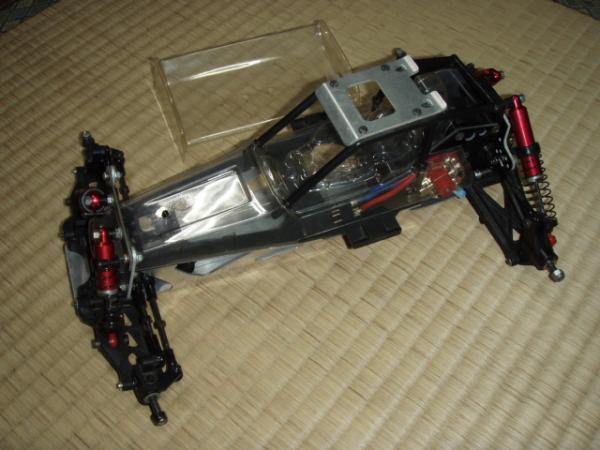

Ultima Buildup

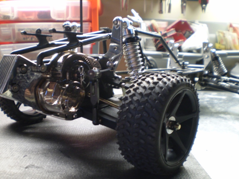

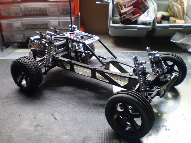

This is the product of a breakup of 2 parts cars, some NIP parts, some Tower Hobbies ST-15 parts, and some custom parts.
Custom Made Radio Plate

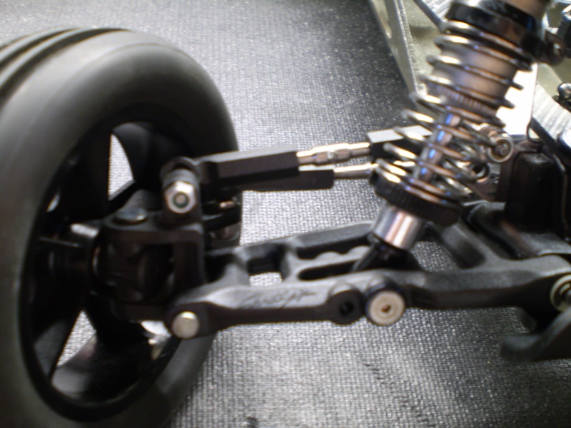

Andy's Front Wide A-Arms
Gold Option House New Universals
Tecnacraft Turnbuckles
Platinum Shocks
Kyosho Original Ball Diff
OT-76 Slipper clutch
OT-74 Alum Pinion
Clear Gear cover
Litesink Heatsink

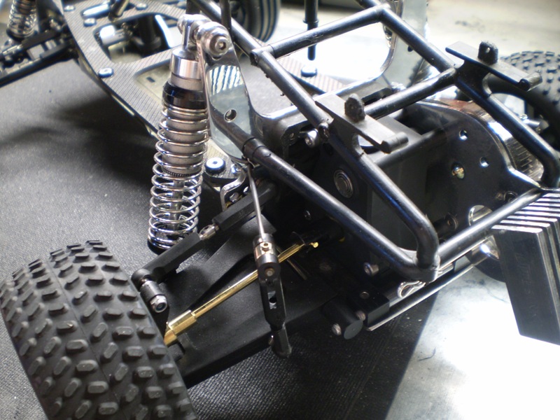

Custom Made Parma Style Rear Sway Bars
ST-15 Servo Saver, Rear Arms, Shock Towers
HPI 5 Star Wheels (soon to be chrome if i can find a single set of chrome wheels that fit, i have 10 sets of rears lol)
If anyone comes across any of these parts, i would be appreciative, just shoot me a PM
-Body (working on getting one from marwan but its gonna be a while)
-Platinum Shock Collars (aluminum prefered, probably will look into custom maybe)
-Front Wheels (HPI Buggy Chrome Fronts)
Platinum Shocks
OT-74 Alum Pinion
Clear Gear cover
Litesink Heatsink

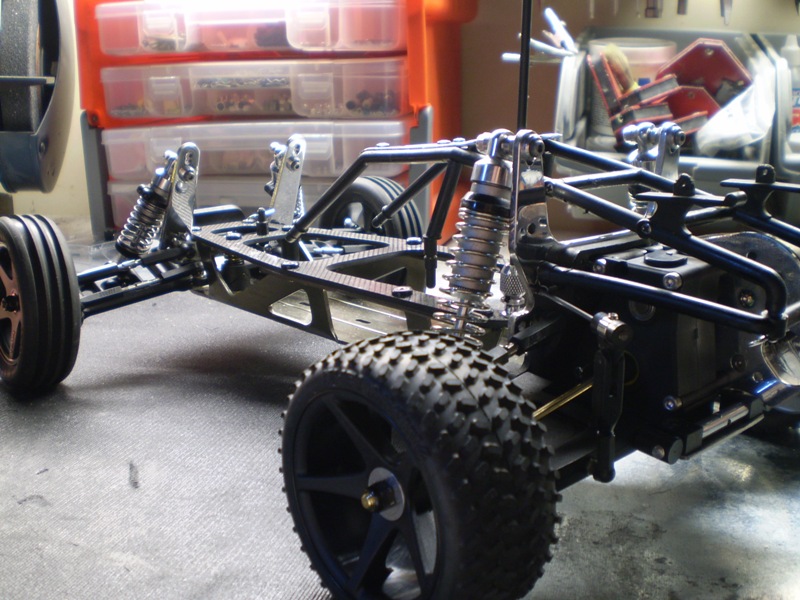

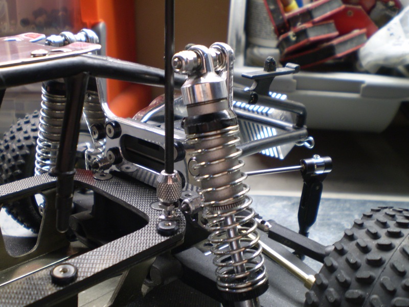

Mike, as usual your stuff is visually stunning. One questions are the shiny bits polished or other? In a couple of those pictures I thought you had dual shocks then I realized it was the reflection or at least I think it was.
This is all very interesting!
- mikedealer
- Posts: 1778
- Been thanked: 3 times
Re: Ultima Buildup
thanks man. it was polished on a buffing wheel, it is a aluminum tower, polished mirror finish, i might have the stuff anodized one day.. not sure yet lol. I plan to right a buffing tutorial soon for RC parts and how to get everything for like $100 or under
it was this originally
http://www3.towerhobbies.com/cgi-bin/wti0001p?&I=LXWZ73&P=7

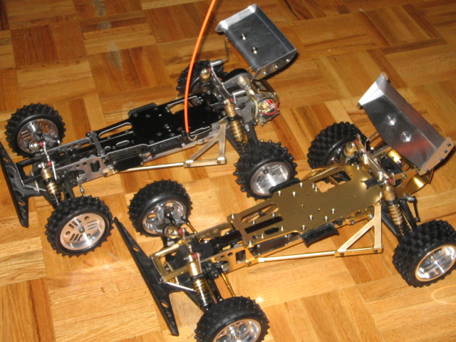

Nice work Mike. Forgive me if it seems like Im hijacking your thread but I wanted to share my Ultima with you.
I had previously done mine a similar way. Infact I think these cars look stunning when done right. I was in a hurry to do mine so never got around to polishing mine - perhaps one day.

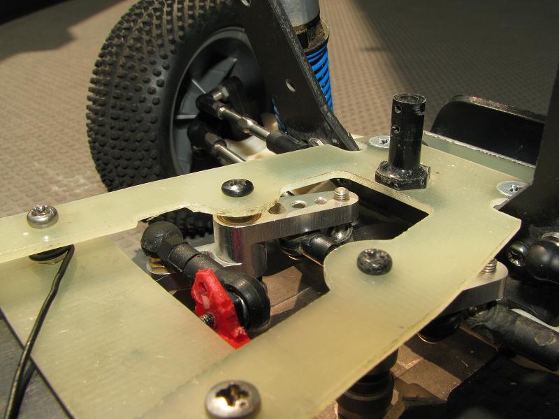

I have the same front arms,gear cover and even managed to find a MIP 48dp ball diff conversion set
. These cars are just awesome! I run my Lipo down the centre of the chassis and got the Lazer ZXR front steering set up so I can use a smaller steering servo which runs side ways rather than length ways allowing room for the battery.
I gave mine a quick run at the St Ives track with RETRO and the boys recently.
I cant believe i was considering selling mine recently...
Also if you ever consider selling one of those radio plates please let me know-

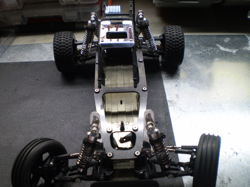

the radio plate i made from 3mm carbon fiber. i found a guy that sells 9x12 sheets for $19.99. i used a scroll saw to cut it out, and a dremel tool to finish it off. its not perfect, but 95% perfect, i could do it better but i did it quick last night lol. if ya want one let me know.. If u wanna dremel out and cut the inside, and drill the holes, i can cut and shape the chassis perfectly inexpensively, the dremeling of the inside was the hardest part lol.

That carbon fiber plate really sets off the build Mike. I never realized how great an Ultima can look (and realistic too)! It kind of looks like an HPI 5b.

personally i think they based the HPI baja off these cars, the roll cage is exactly the same angle, and the roof plate if you look at it is DAMN close lol

The steering was easier to install than I thought . Infact Im sure the ZXR parts go straight on to the Ultima alloy shafts bolted to the chassis. No need to drill more holes or anything
The reason I used it was i had a spare set up lying around and wanted to run the servo sideways to give the battery more room inside the chassis. It works great too.

Instead I thought I'd share this little image I stole from yahoo actions: maybe inspiring for a custom project in the future: PS the resemblance with the HPI is easy enough to explain: it is the same guy that did both cars design.
