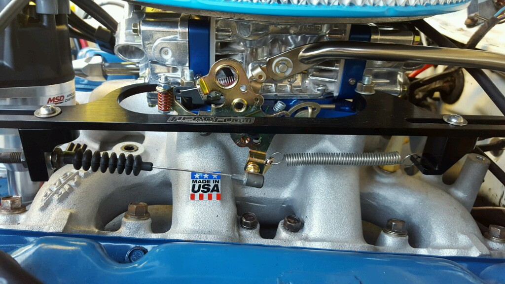

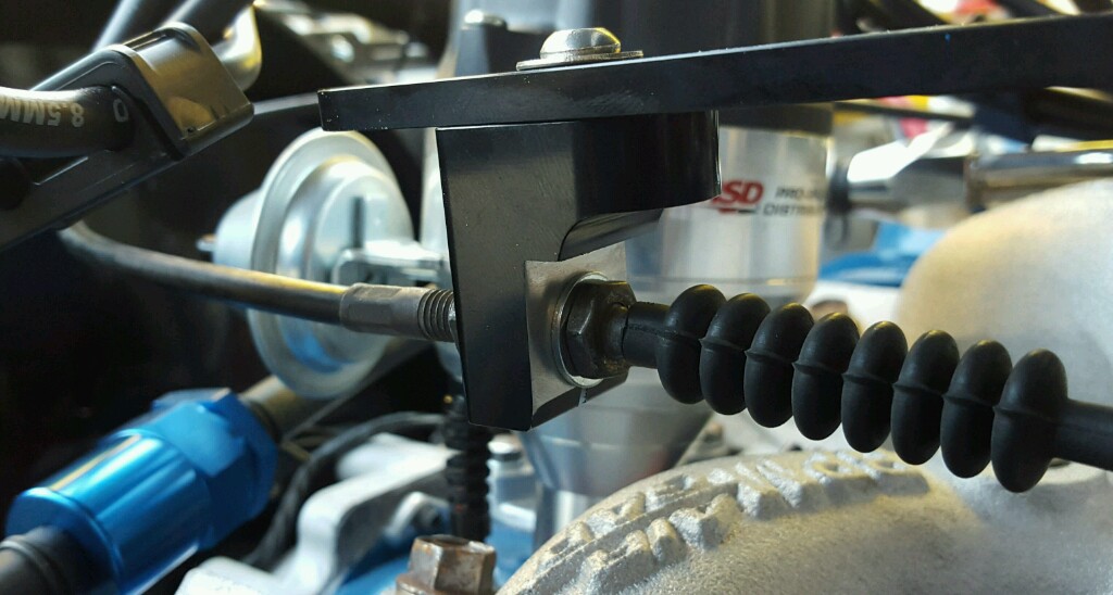

I must say I'm really really happy with the way my modified unorthodox throttle set up worked out.
Being RHD these cars normally pull the throttle from the front of the carb (non Holley). My other Fairlane had the cable rerouted to pull from the back like normal which resulted in a relatively stiff pedal which I never liked.
I had a friend mill down one of the mounts that came with the bracket so the nuts could clamp square. I was also able to use the factory throttle cable with a few modifications. The pedal is nice and smooth and fairly light, if anything a fraction too light. I still have the option to add some more tension or run a second return spring if required.

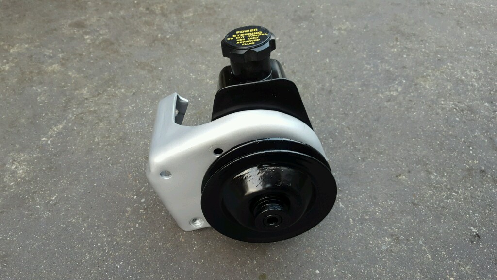

I cracked the $#!+'s with the power steering pump. It's gonna take a bit of messing around to get it to line up properly.

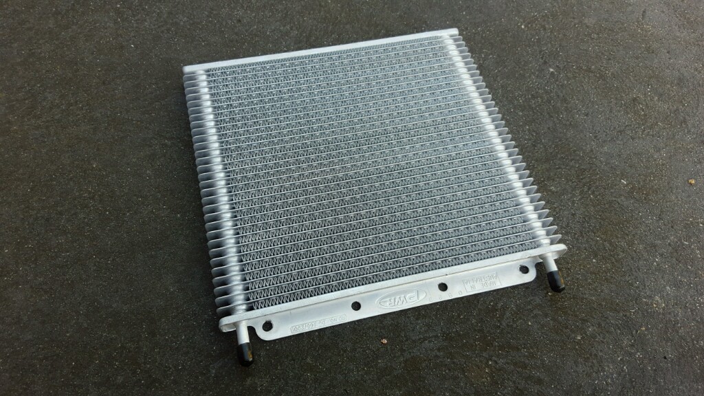

Picked up my 10"x11" trans cooler today, supposed to be the best cooler on the market. Just gotta make up some brackets to mount it now...

you should always run a double spring on the throttle as a safety redundancy. Learned that one from my dad long ago. GM ran a smaller spring inside, with a larger spring around the outside.

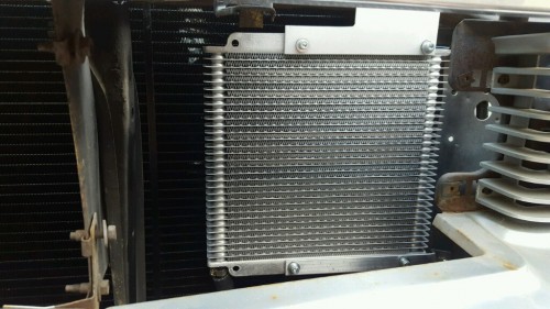

Not much to update except I got the trans cooler all mounted and hooked up. It's mounted using all factory bolt holes and rubber grommets between the brackets for vibration. It didn't look that big out of the car but its like a mini radiator in the car. I originally wanted to mount it on the "outside" of the brackets but the hood latch would have hit it.
My cheap ebay pulley puller arrived and worked fantastic. I was able to pull the pulley off and space the pump closer to the bracket, esentially moving the pump forward in the car. While I had the bracket off I stripped it and repainted it properly. I wanted to get a billet pulley to replace the boring steel one but it isn't something I can afford at the moment. At least it's easy to replace later.

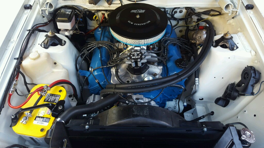

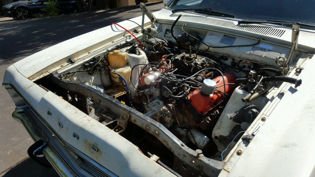

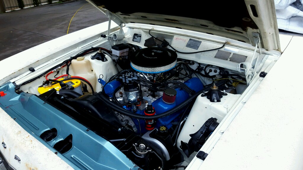

Finally all finished, wired up the ignition and other various things, tested the choke, drained the fuel tank and put 20 liters of fresh 98 octane. Nothing smoked, popped or fizzled so I'm happy.
Before and after.....
